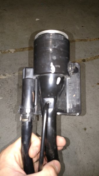

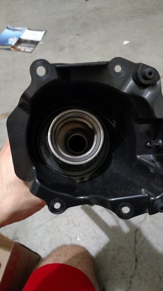

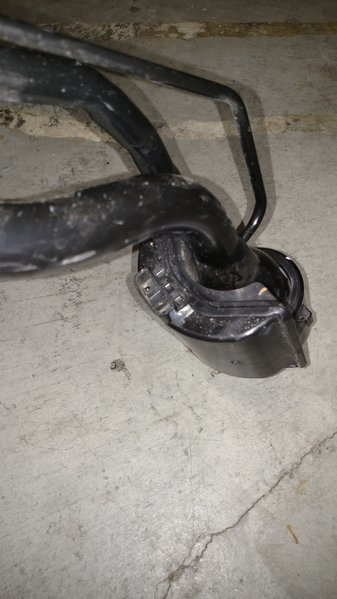

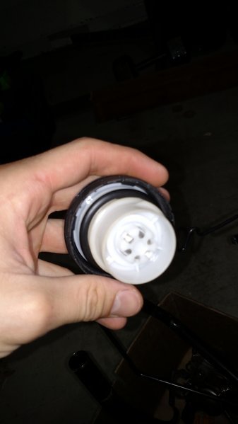

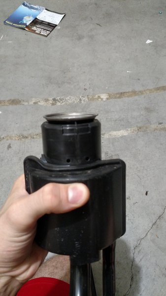

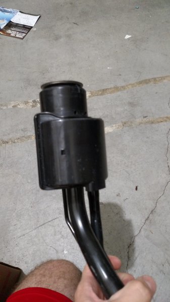

    Here ya go! It's awkward to get pictures off.

    Thanks for the pics. It's amazing how complicated things are on these new trucks. It's hard to tell from the pictures, but I don't see how you could have gotten a significant amount of sand in through there. Water maybe. But I still ask why you and not every other truck that goes though a crossing or a car wash. We may never know.
    I vote for smooth sailing from here on out.
