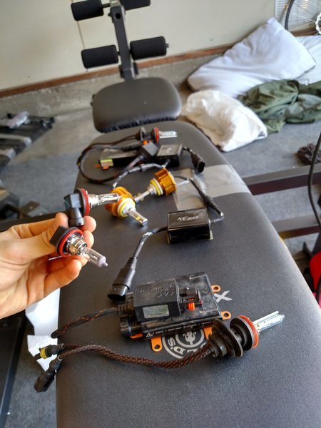

    Well. It looks like they were right. I decided that today I would take out the TRS Morimoto HIDs and harness and pop the stoxk ones back in. I first went easy and hoses lightly then got more aggressive... Finally I broke out the pressure washer and washed the whole thing as normal....
    I even blasted the lights, hood, and engine, brake reservoir area, and the back of radiatior with pressure washer...
    https://youtu.be/a01KwB5Pw3E
    https://youtu.be/JXpqn8_3mYo
    No issues...
    Now time to water proof those lights.
    @TRSAndrew @TRSJimmy
    Never thought headlights would disable a 40k truck.
    My next truck will be a 1970s truck. Lol

    5,652
    2016 Offroad AC
    This is why tech assistance tells us to remove/unhook any aftermarket components before continuing with diagnosis. I love the 2 cent OBD2 dongles and insurance things that screw up the data line and cause all kinds of issues.

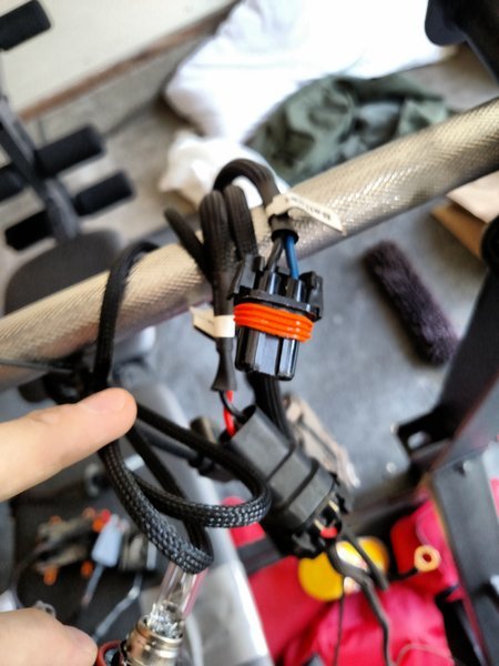

    But, as of now, case closed. ALTHOUGH I have it in writing where they did find more sand/dirt and that the intake screen was covered in dirt. So, that is still a concern of mine, however it is not the cause of our problems.... Lol
    Now time to super seal that HID harness, I'm looking for input from TRD hence why I keep tagging @TRSAndrew and @TRSJimmy
