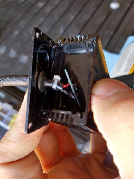

    Possible culprit... The LEDs for the high beams...
    The real issue with all of this, is the ballasts, drivers, entire harness don't receive power when I start the truck, etc.. lights are off. So even if they were soaked and wet, it shouldn't be shorting until I click lights on....

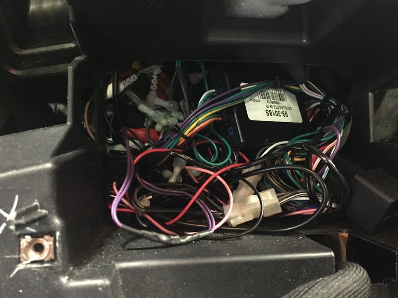

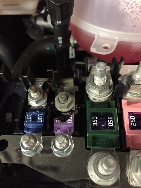

    I love fixing electrical. Had this jewel roll in today
    nv529, Mr. Torgue and T4RFTMFW like this.

    2016 Offroad AC
    And a 2017 undisclosed model that someone forgot to tighten nut on alternator fuse. Oops
    T4RFTMFW likes this.

    Radio harness

    We're back to the salt water thing, tough crowd lol... however the truck fixed itself after salt water, it was the carwashes that completely killed it both times lol.
    I've inspected the entire light harness, and there are no signs of corrosion or shorting, except that wire being melted in the led driver.
    My question still stands, how is a harness that receives no power unless clicked on, causing issues?
    Unless these trucks are sending minimal power or some sort of diagnostic signal.
    Who knows.
    However as I am bored, everything's been filled with silicone, another email to TRS, I'll do the shrink wrap when I install it back on the truck. Of the thousands of people running Morimoto kits, I can't be the only person to ever get something wet...
