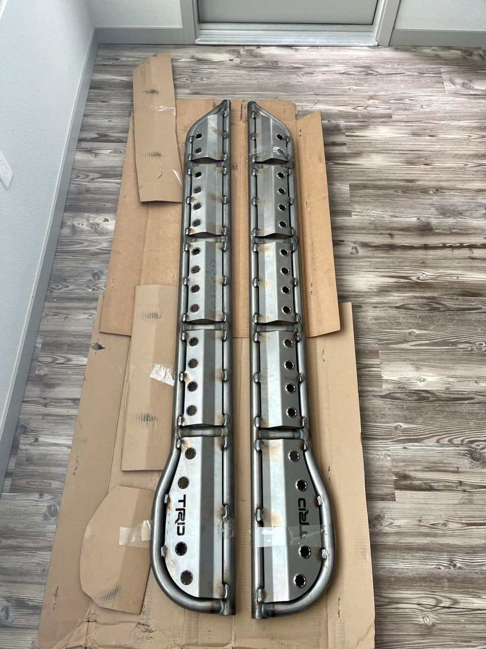

    I have a set of bare steel rock sliders that I just received.
    They'll be used mostly as steps and door-ding protectors (won't be doing any actual rock crawling).
    Also I live in Colorado where snow & salt are very real issues.
    As such, I wanted to go the powder coating route over spraying them myself.
    I am planning on wiping them down with acetone beforehand, but is it necessary for the shop to sandblast before coating?
    I've received mixed answers from different shops.

    Very much appreciate the info! These are weld-ins too, so want to make sure I'm doing it right the first time.
    Also didn't want to jus throw cash away on sand-blasting if there was zero to slim improvement, but it sounds like it's worth a few extra bucks.

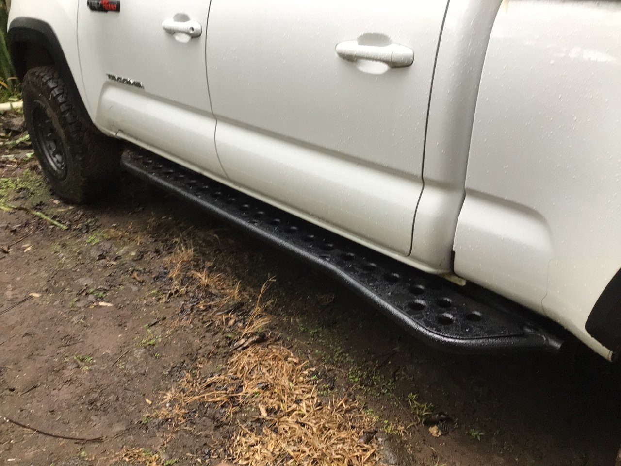

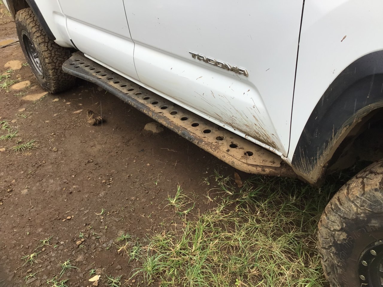

    Also never use Rhino lining materials, dirt and mud stains the lining. I have to scrub them down, then repaint with black spray paint, Rustoleum, just minutes to do with cardboards. Almost every month.
    Every one, power coating is the best way!
    Bottom picture repainted yesterday.

    Weird, mine never get stained. Blast it off with the pressure washer and on my way I go.

    You got Rhino lining and no problems with dirt stain? Lucky for you.
    I live on dirt roads, rains a lot, gets real muddy too. I once borrow my friend power washer, made no difference. Maybe I should paint it brown? Nah.
    I have a small chip, mostly from hitting rocks.

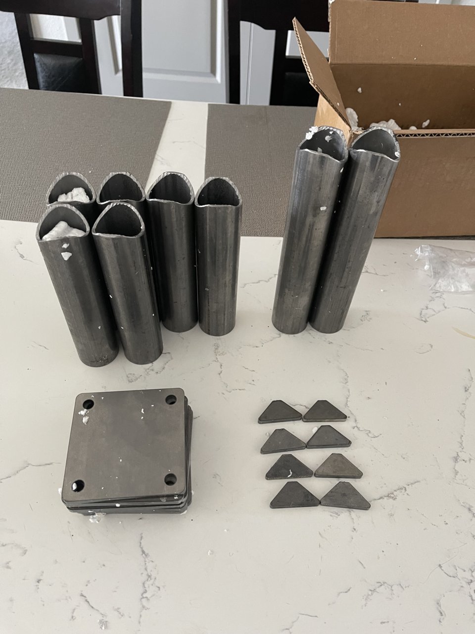

    Just curious, where the brackets?

    Just not welded on yet haha.

    Ok, Glad you have all the parts. I like the TRD logo on the rock sliders!
