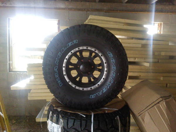

    Wheels & Tires:
    15" x 8" Granite Alloy GA9
    33" x 12.5" x 15" Goodyear Duratracs

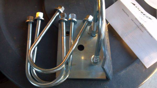

    U-Bolt Flip Kit
    Trail Gear Frame Box Kit
    Trail Gear Shock Relocation Kit

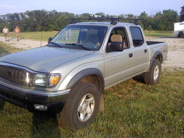

    As it is now:
    I bought my Taco with 58,000 miles, back in 2007.
    Before the mods began:

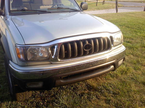

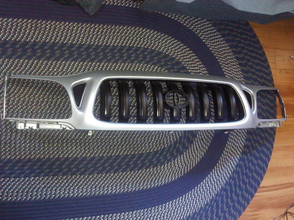

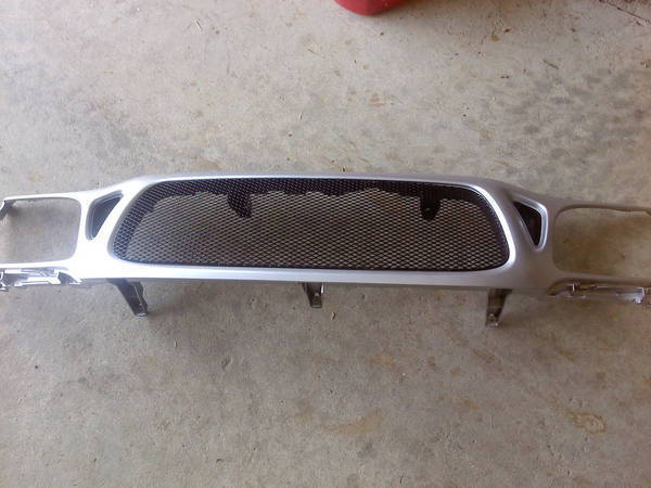

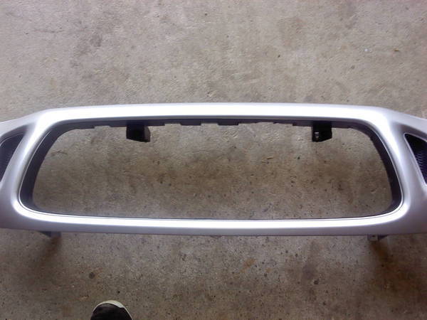

    started my grillecraft with a grille shroud from parts geek
    cut out the interior grille with a sawzaw and grinded edges down flush
    Installed the grillecraft tto the outer grill piece
    Before:
    After:

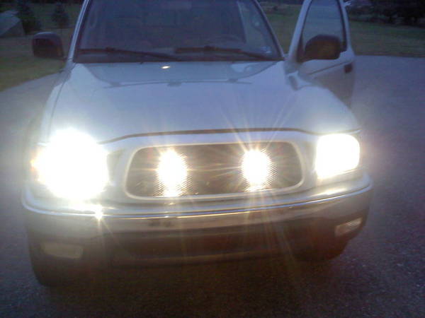

    Installed Hella 500 black magics behind grillecraft

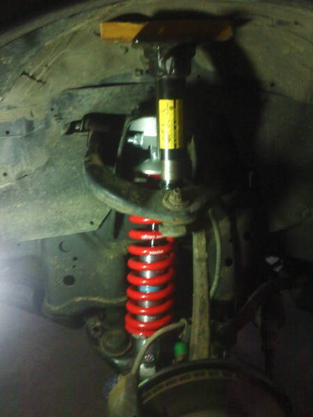

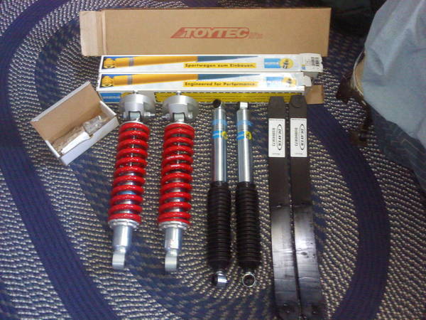

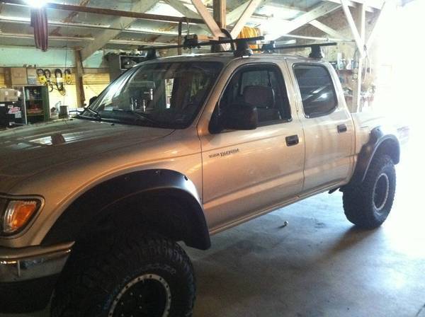

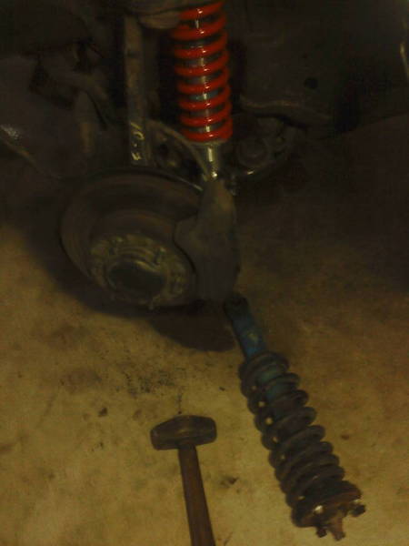

    Got my Toytec Ultimate Lift Kit
    Passenger side Coilover needed a little persuasion from my bfh
    Used the bottle jack for something useful
    Just the front done

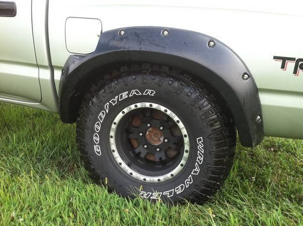

    Got my wheels, tires, and flares... and installed them

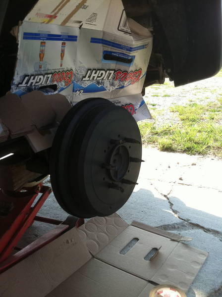

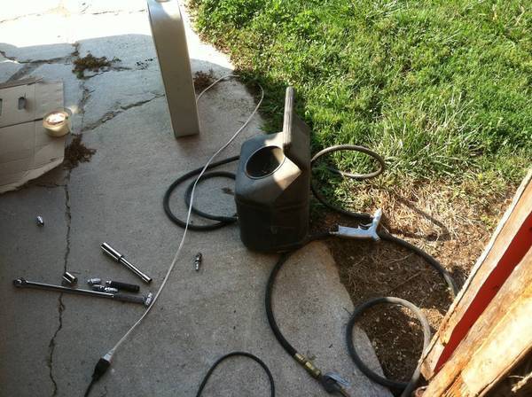

    sandblasted and repainted my rear brake drums

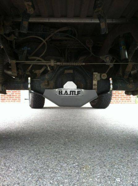

    BAMF rear diff skid color matched and installed

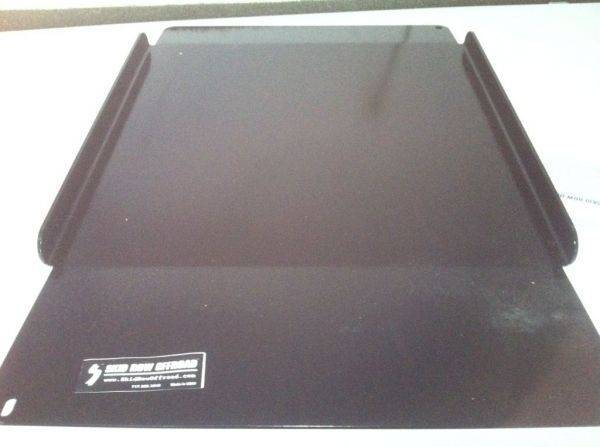

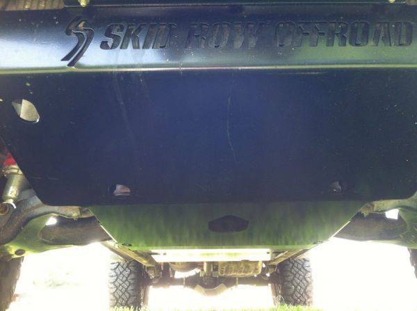

    Skid row skid plates came in the mail from 4wheelparts
    All 3 skid plates installed

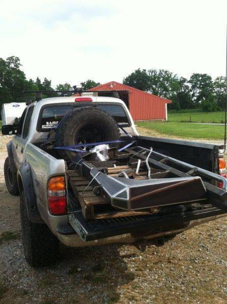

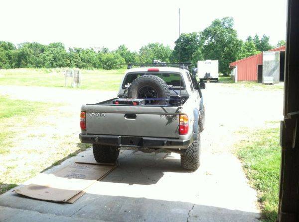

    Received my rear bumper and sliders from fastenal
    Painted the rear bumper with truck bed coating

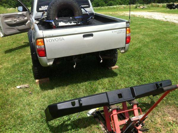

    Stock bumper off ready to install the new one
    Installed

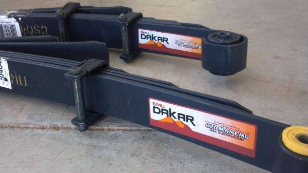

    Added Dakars w/ the D6xl AAL to the Truck

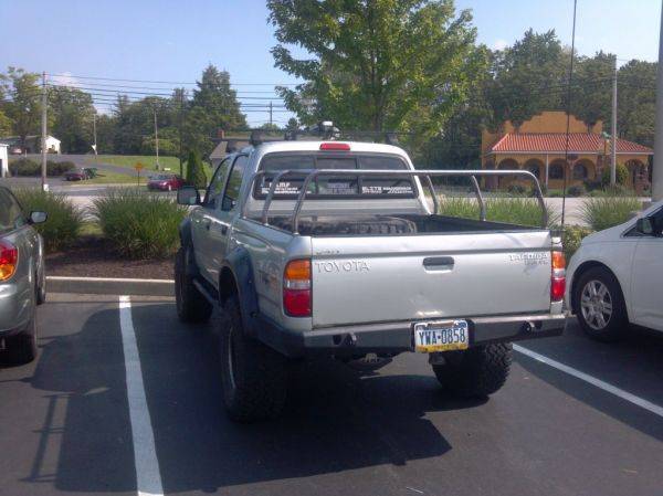

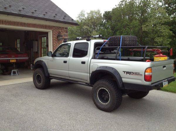

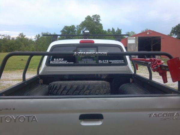

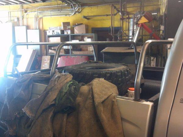

    A to Z Fab helped me build a bed rack for my RTT
    Painted it and added a little advertising to it

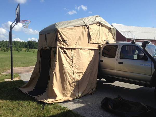

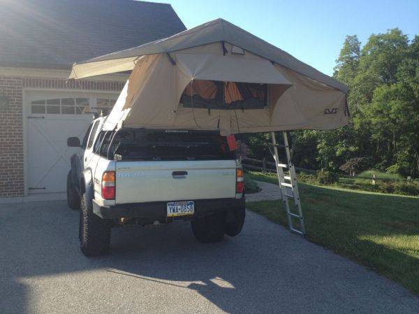

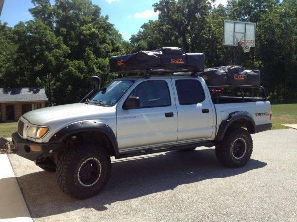

    Installed the CVT Mt. Shasta RTT
    w/ the annex
    how about two tents :cool:

    Steve, Good looking truck...Where did you get the cut out fender flares? I've been looking all over and can't seem to find them for the double cab. Also, do you have more up close pics of how you did the satoshi? Thanks
  3. Aug 23, 2011 at 7:39 PM

    Thanks Mark, I ended up just ordering the flares for an ext. cab i think, they fit great i had no problems with them... i bought them from Autoanything... Ill try to dig up some more pics

    Did you have to do any modifications for the cutouts to fit? or is there any cutting needed? And thanks for the quick response.

    with the cut outs i had to cut about a 1" by 10" piece off of each side of the fender along with the pinch weld mod to make them fit, and you have to drill holes in the side of the fenders to put the bolts in. and i dont have any close ups on the grillcraft but i can definitely answer any questions it was pretty easy to do

    OK cool I just looked at Bushwackers website for installation instructions and believe I will be order a set soon.
    As far as the grill, how did you secure the mesh to the surround?

    Yeah they are definitely nice... I had no choice with my tire combo I would've been pulled over right away if i didnt have them.
    the mesh had tabs on it that you just sent a screw into the inner part of the grille surround
