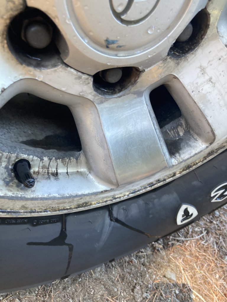

    I had no idea you can just sand these rims. Just dod one spot and I know I need to follow through with a few mire levels of sand paper but this inly took about 5 mins by hand. Any tips welcome. Most of it is in the clear coat. What clear to
    use any tips welcome. I can't really take em off the rims as I don't really have the equipment.

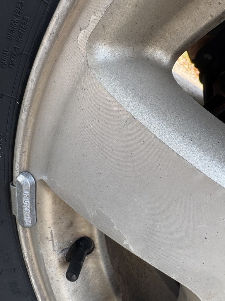

    I have been thinking about sanding
    Typically, the outside facing portion of the spokes are only polished. Then the inr portion of spokes are painted. Then entire rim is clear coated
    Here’s a pix of mine to explain better

    In my case, the inner portion of the spoke not only painted but has a texture
    that being said I don’t think sanding would be a good idea (too much of a risk)

    Now your rim shown will need some sanding on areas where aluminum has oxidized
    all in all
    Your 4 rims look like a big project along with $125 or so in materials
    another option is a Rim Repair vendor
    $125-$175 per rim
