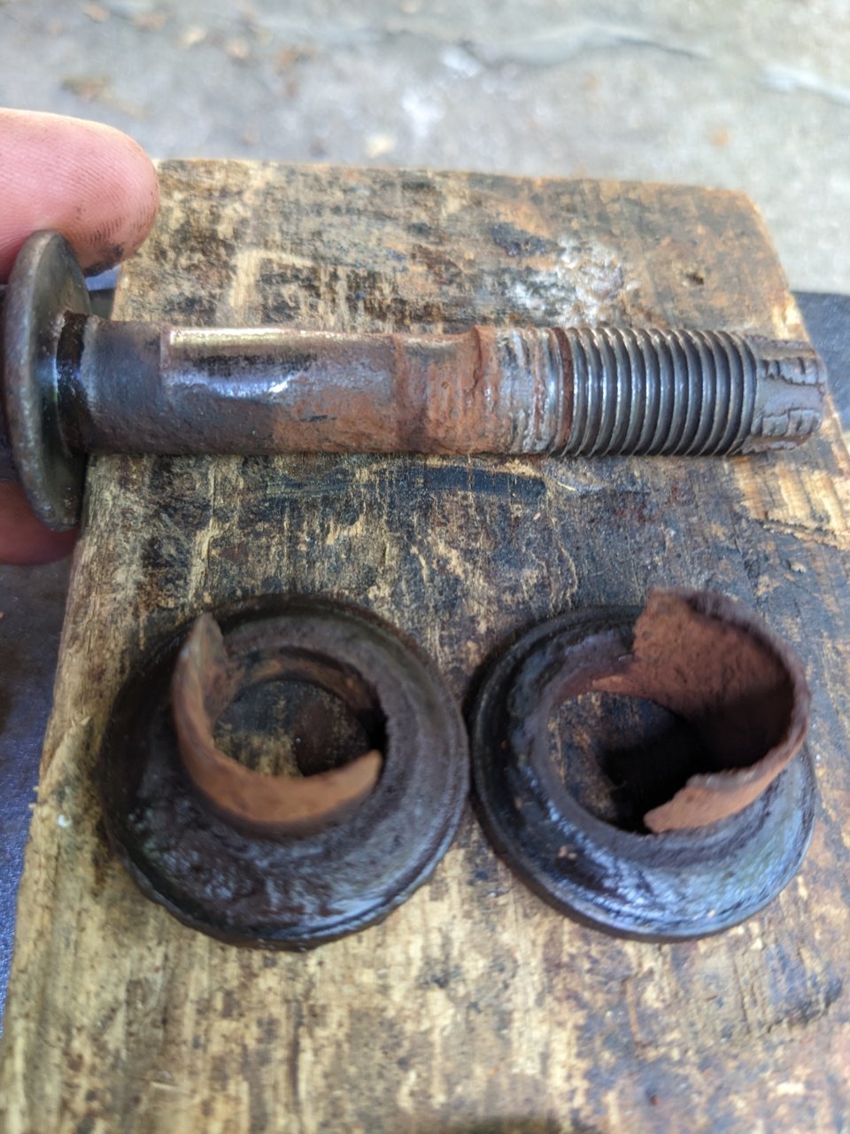

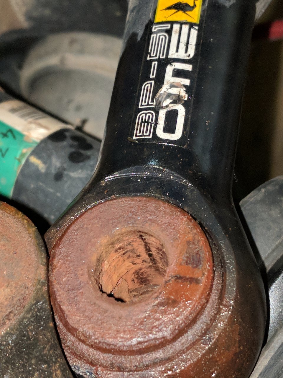

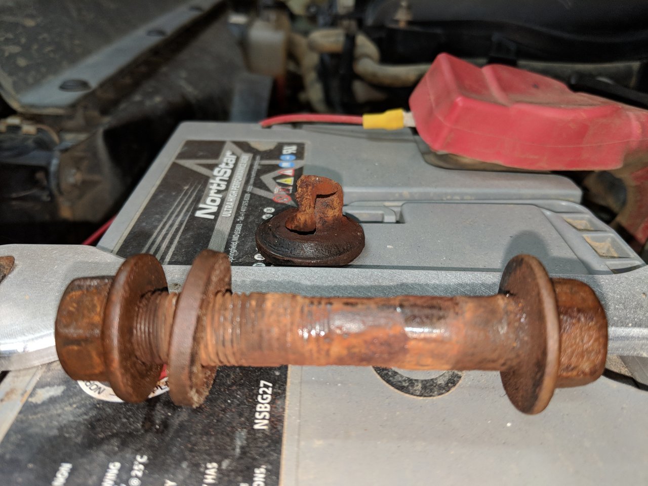

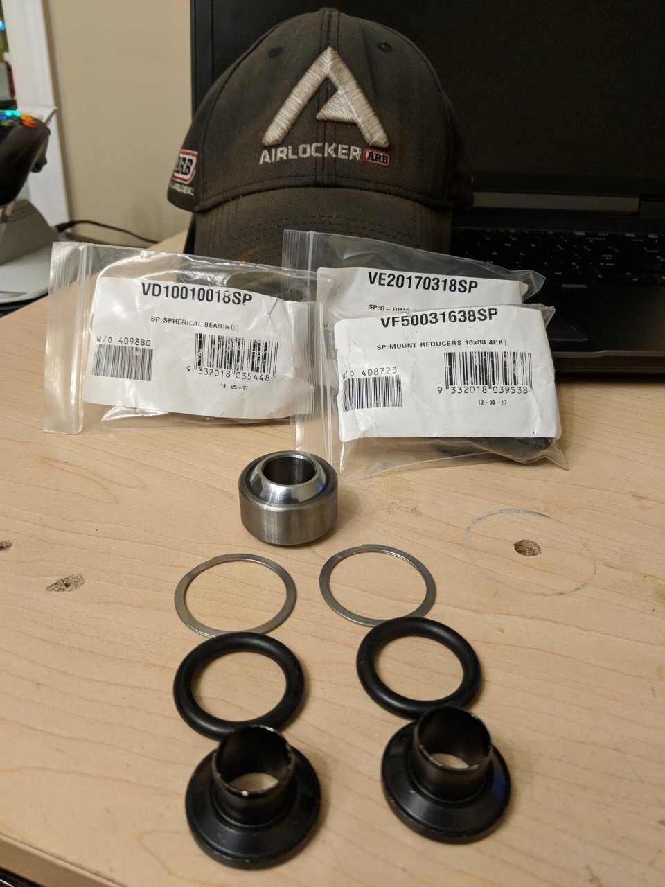

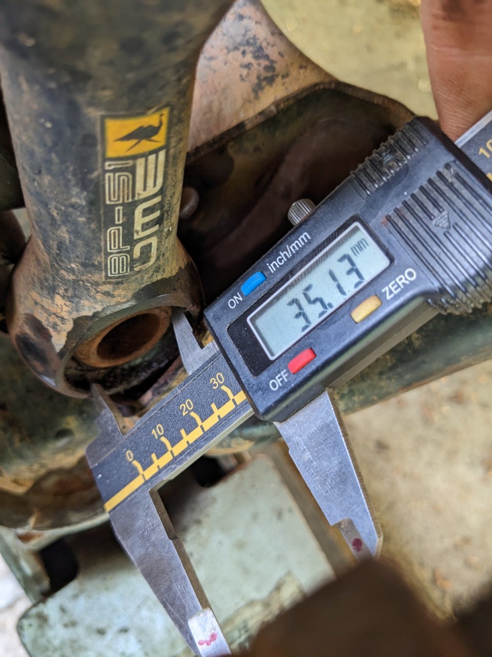

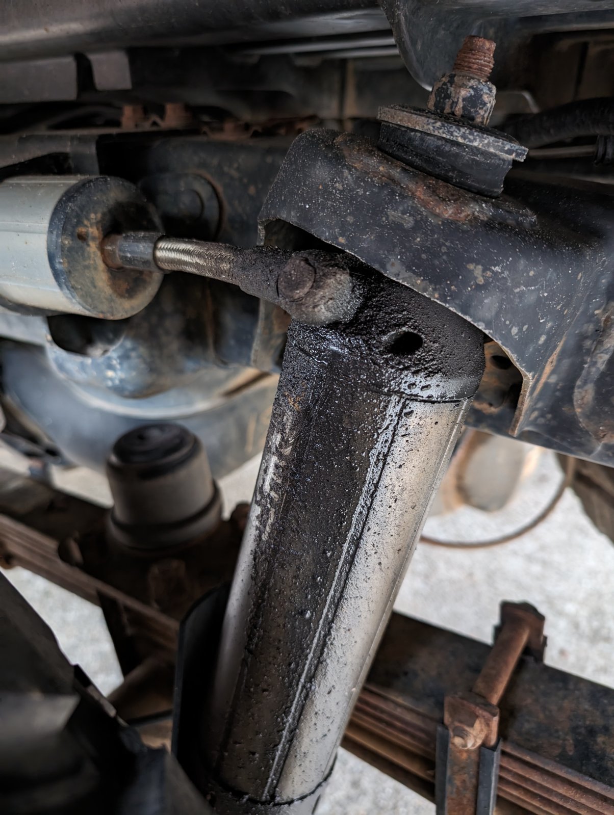

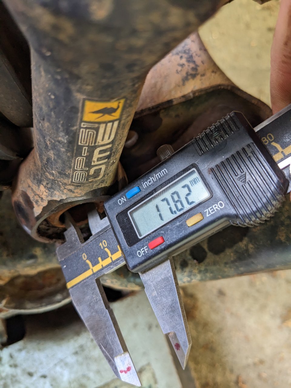

    Bp-51 spherical bearing and reducer replacement time again.. ARB Manual shows for BP5190006L/R; upper mount: VD11010019SP, lower mount: VD10010019SP
    Vkrodends Confirms com18mt, 35mm OD, 18MM ID, ptfe no grooves

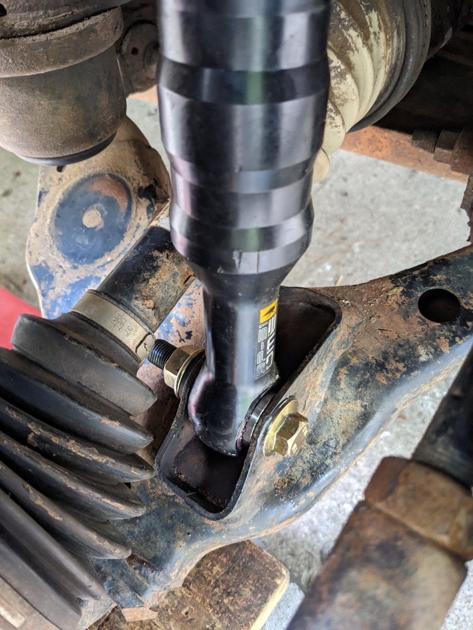

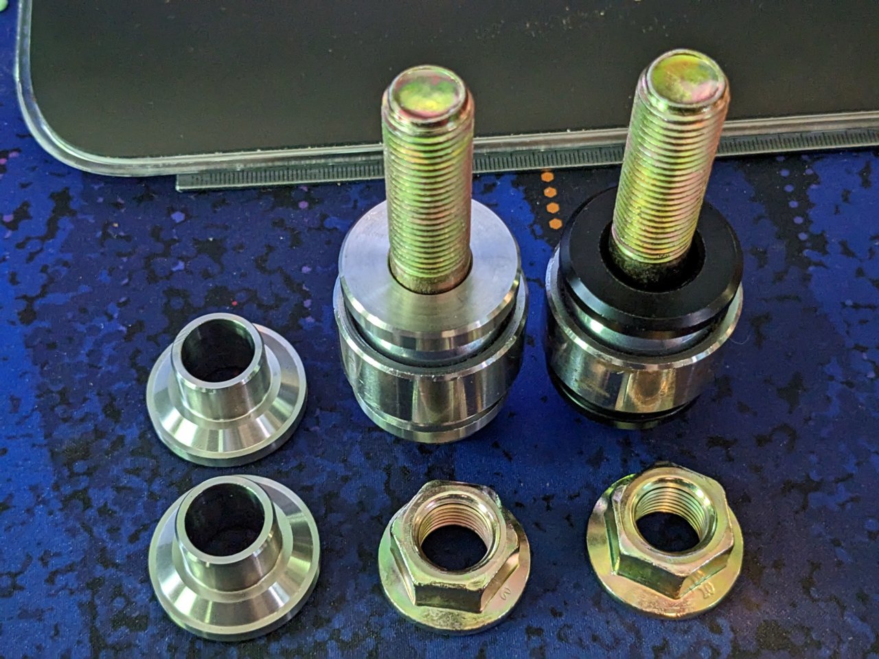

    The new parts, sized correctly. Who thought that fitment was anywhere good enough... The new fit makes me happier than it should.

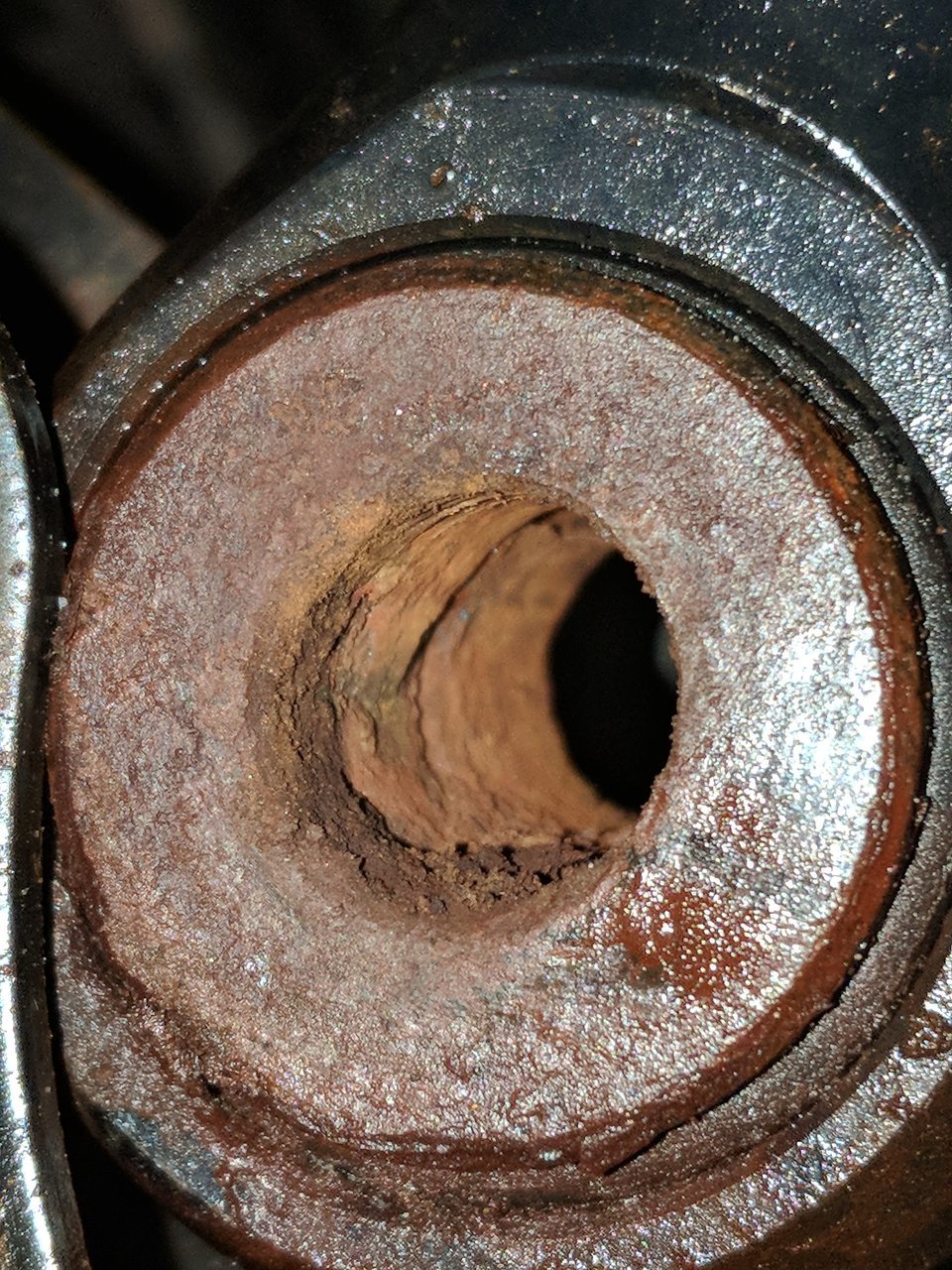

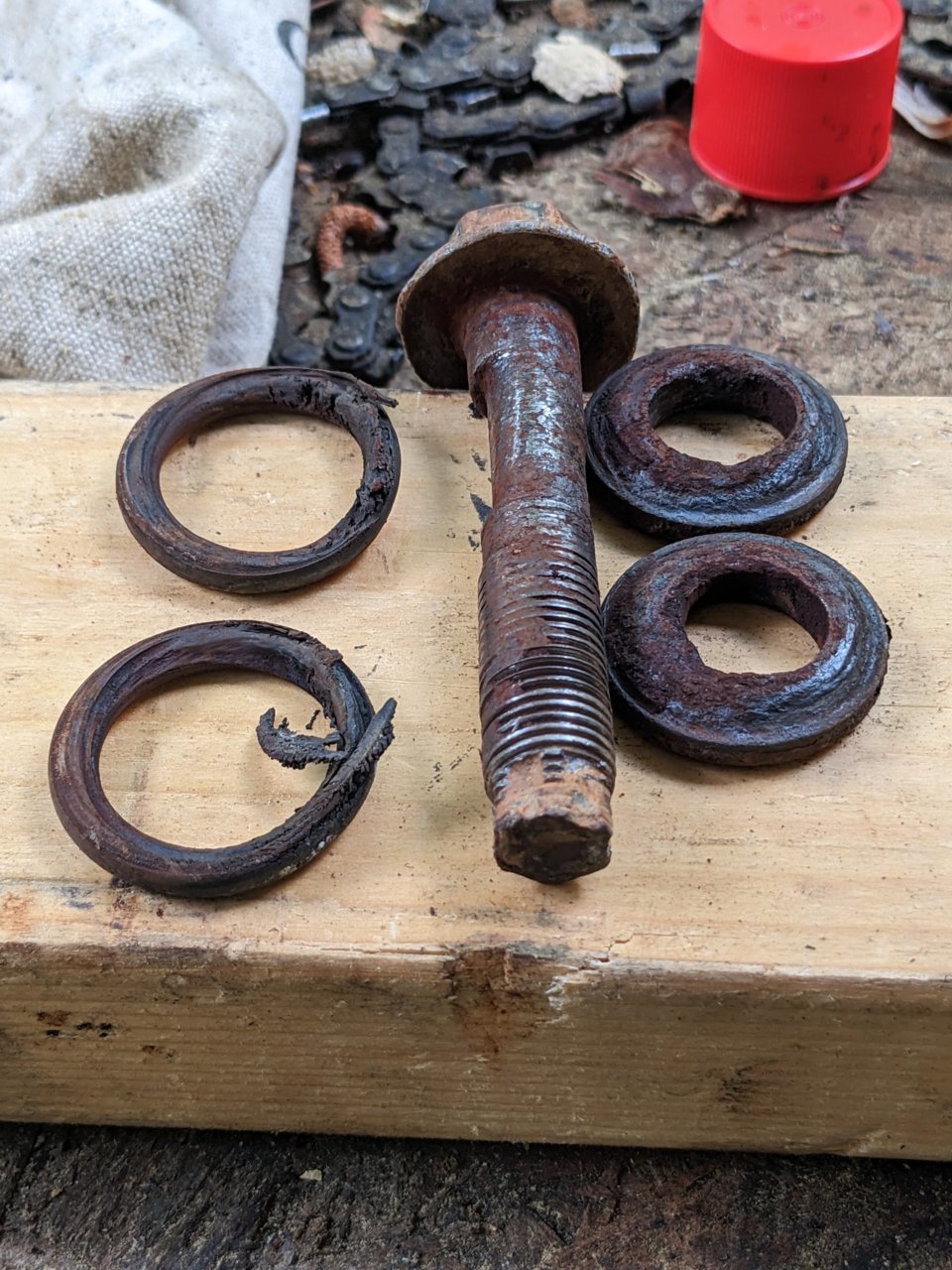

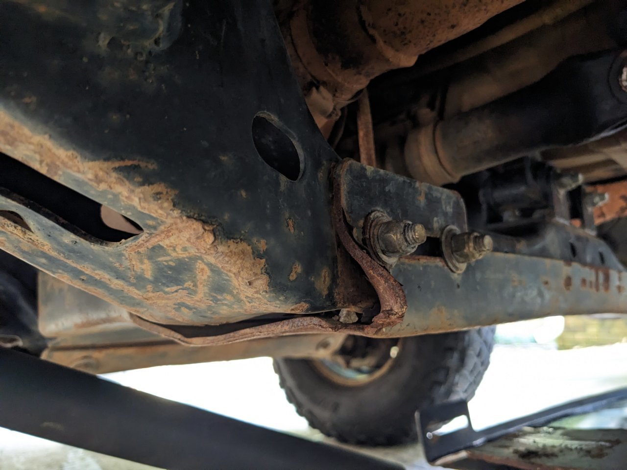

    FUCK... I thought the passenger side was bad... The collars on the driver side spacers is dust sitting in the control arm.
    Final fit

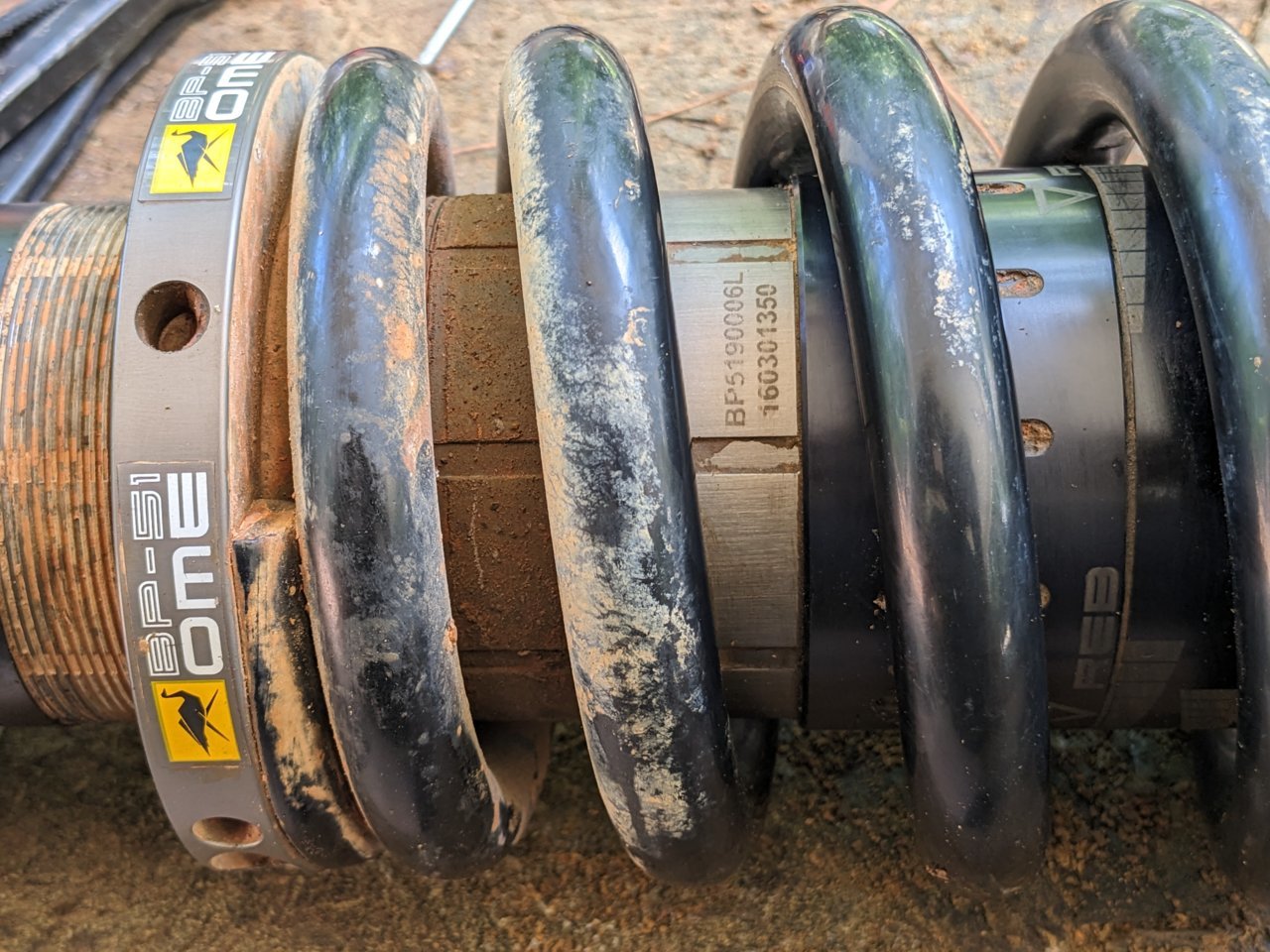

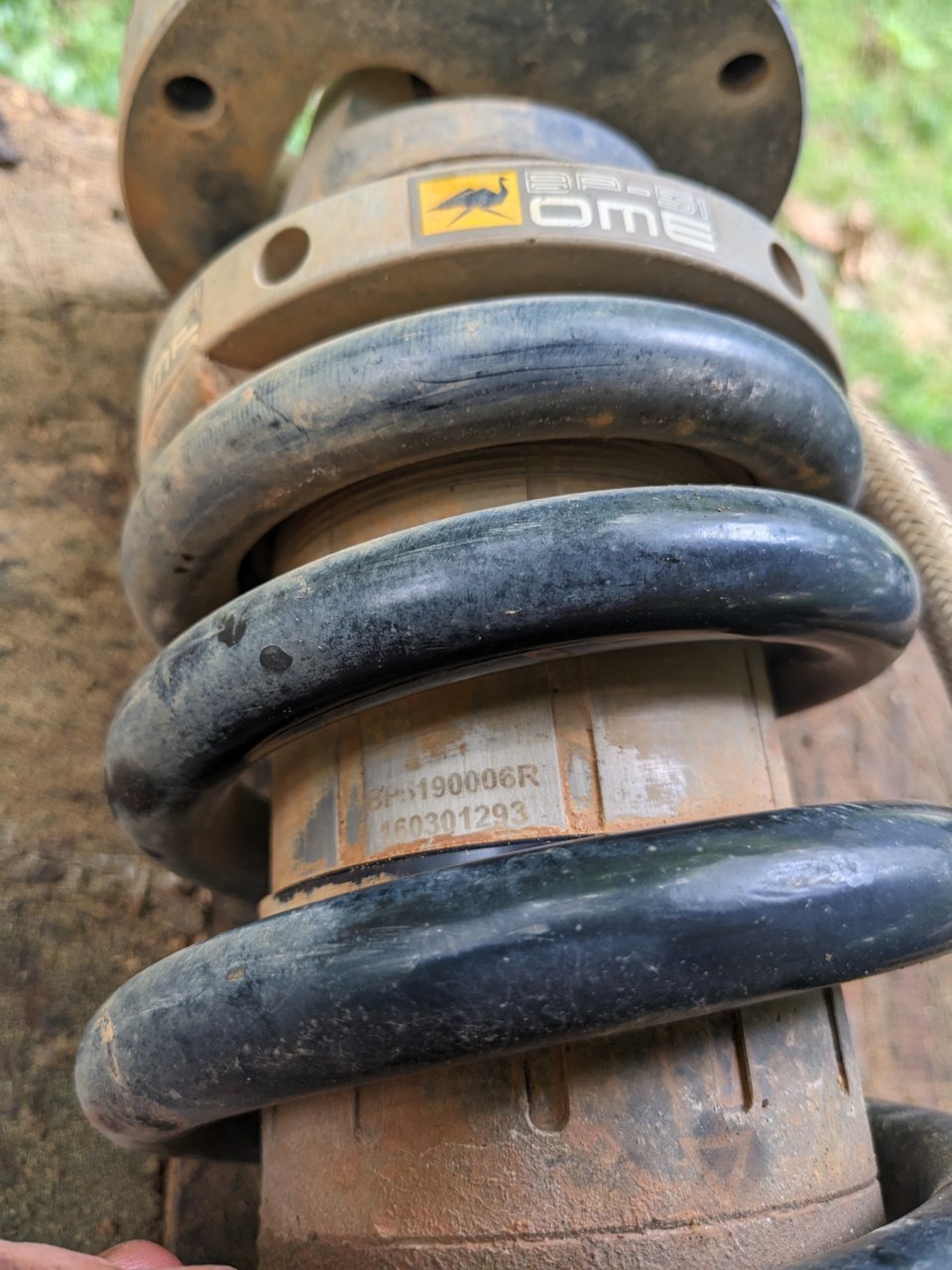

    Tried to find the serial number on the shocks when I was on the phone with ARB... It's on the back covered in mud.
    Passenger:
    Driver:

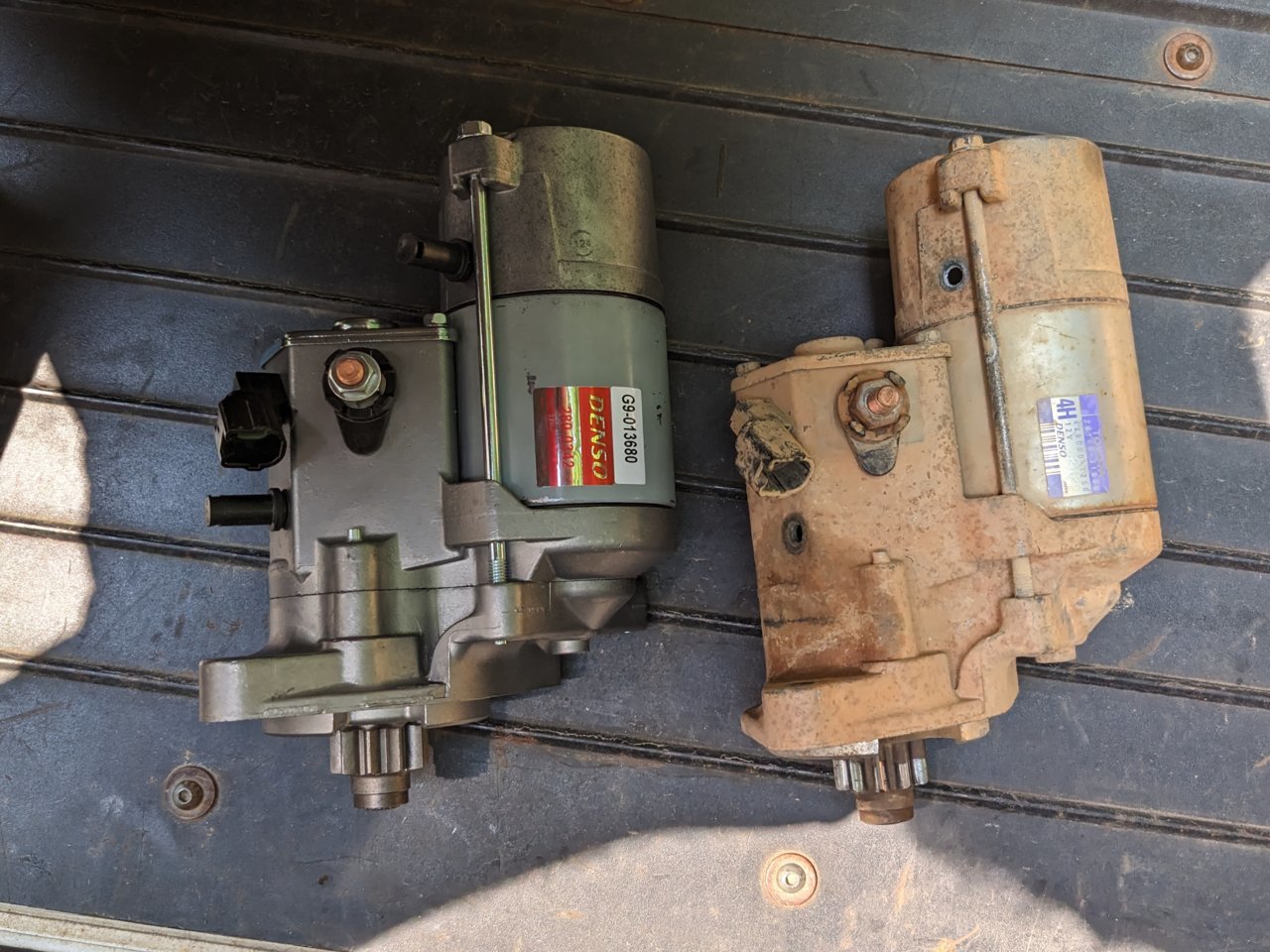

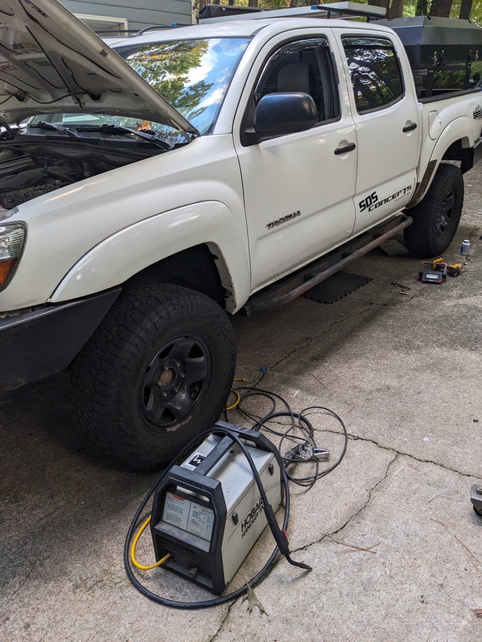

    After changing the contacts in the original starter didn't fix the problem I just put a reman denso In. 314343 miles
    https://youtu.be/PEjxPi9w1D8

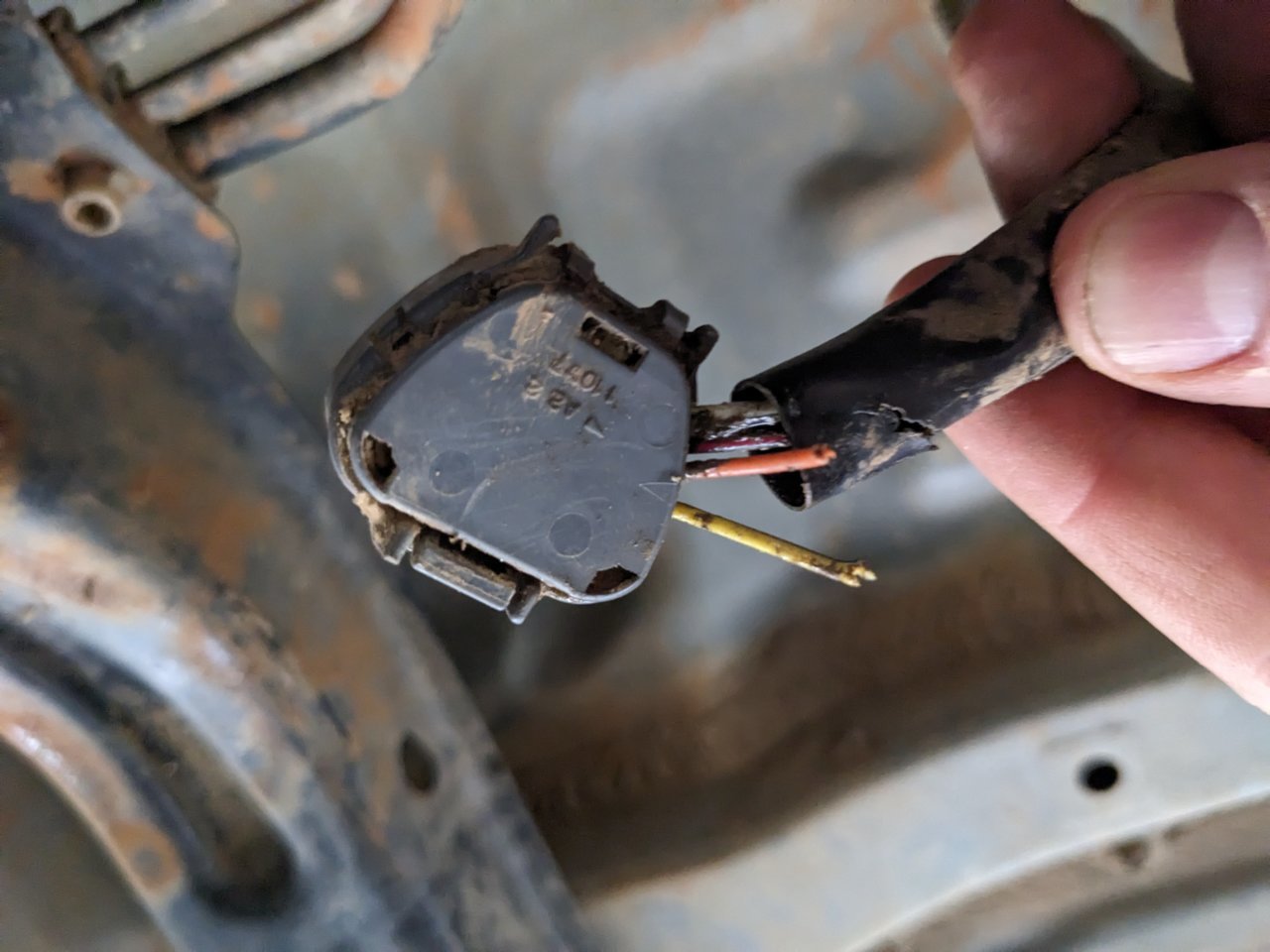

    Well I filled up one night and the next morning my gas gauge said NO I didn't. That's fixed.. Anyone want to come get some squirrels?

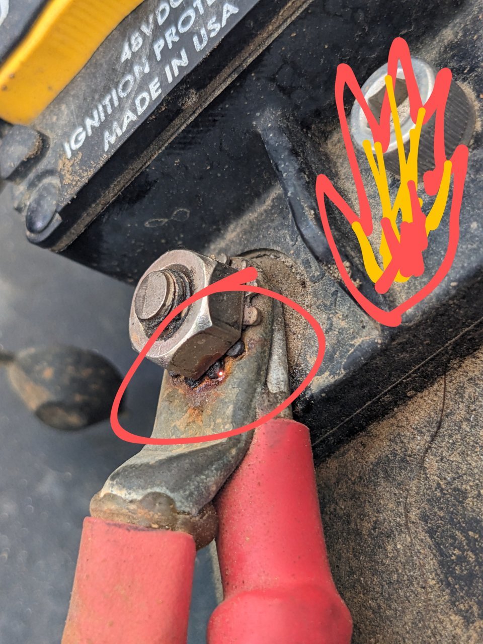

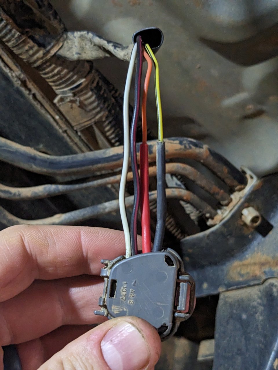

    Well that's getting a little HOT.. Found the reason my Ham Radio is loosing voltage, dropping out, and turning back on. Just a loose little connection.

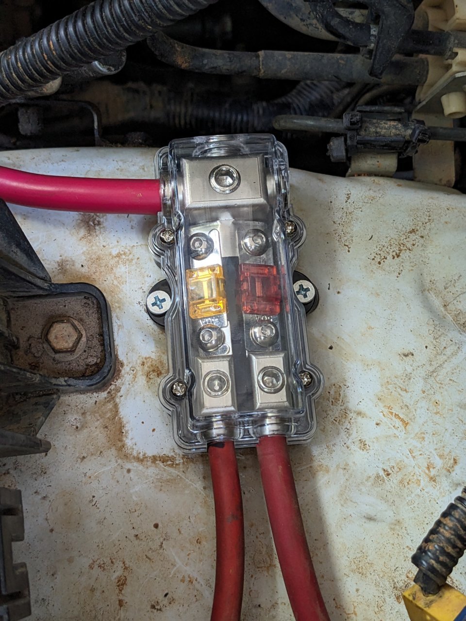

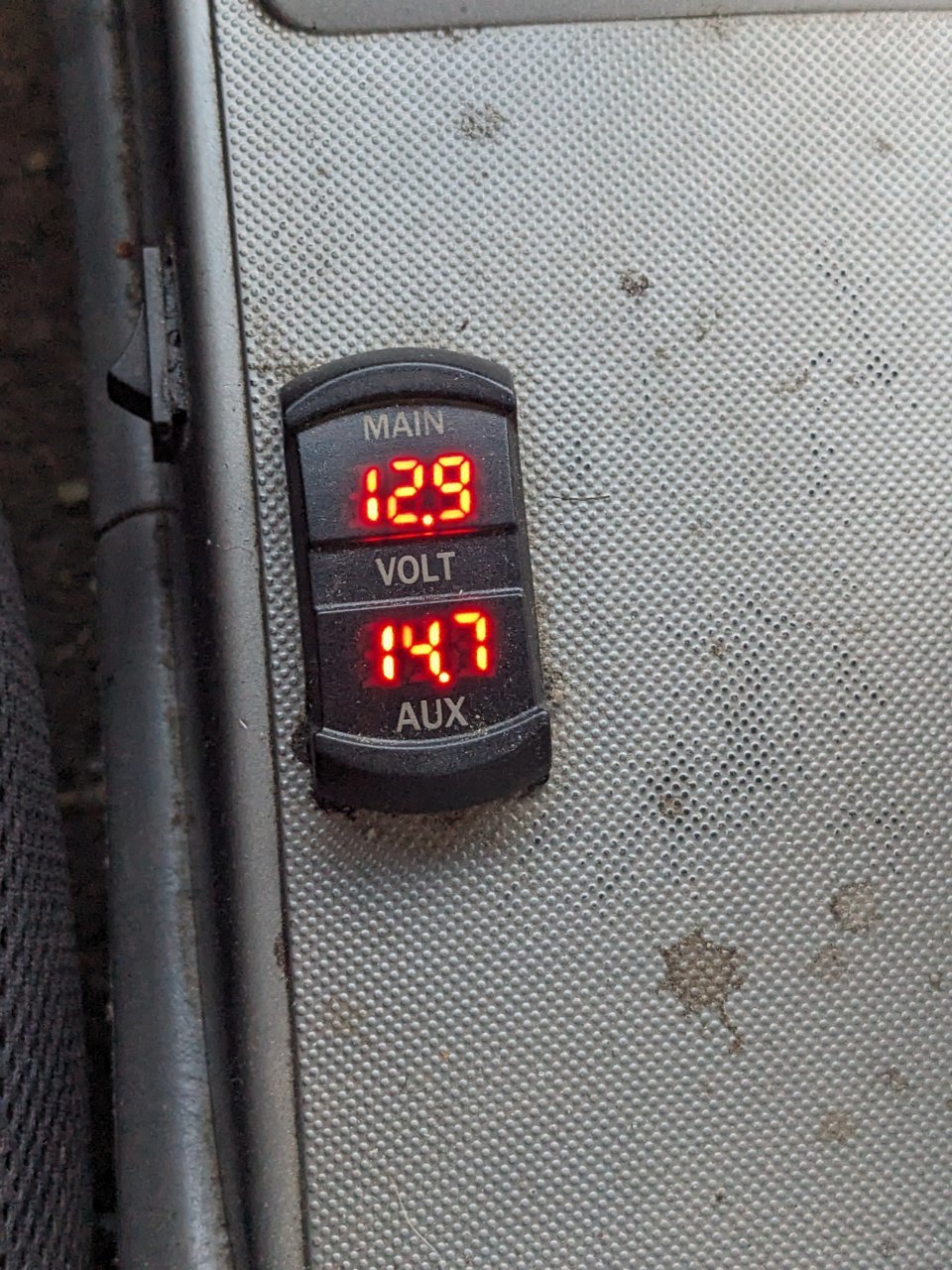

    Fixed a couple more bad connections and bumped up wire gauge to my rear battery and it's charging much better now

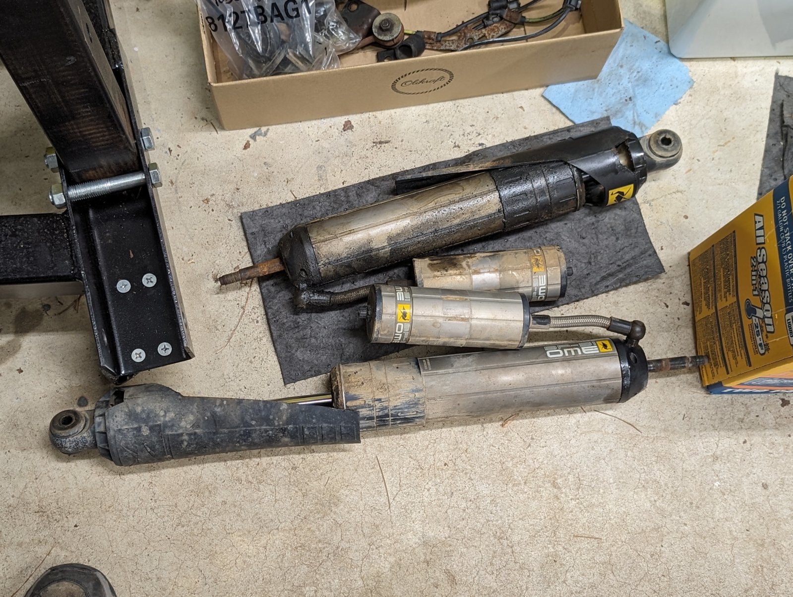

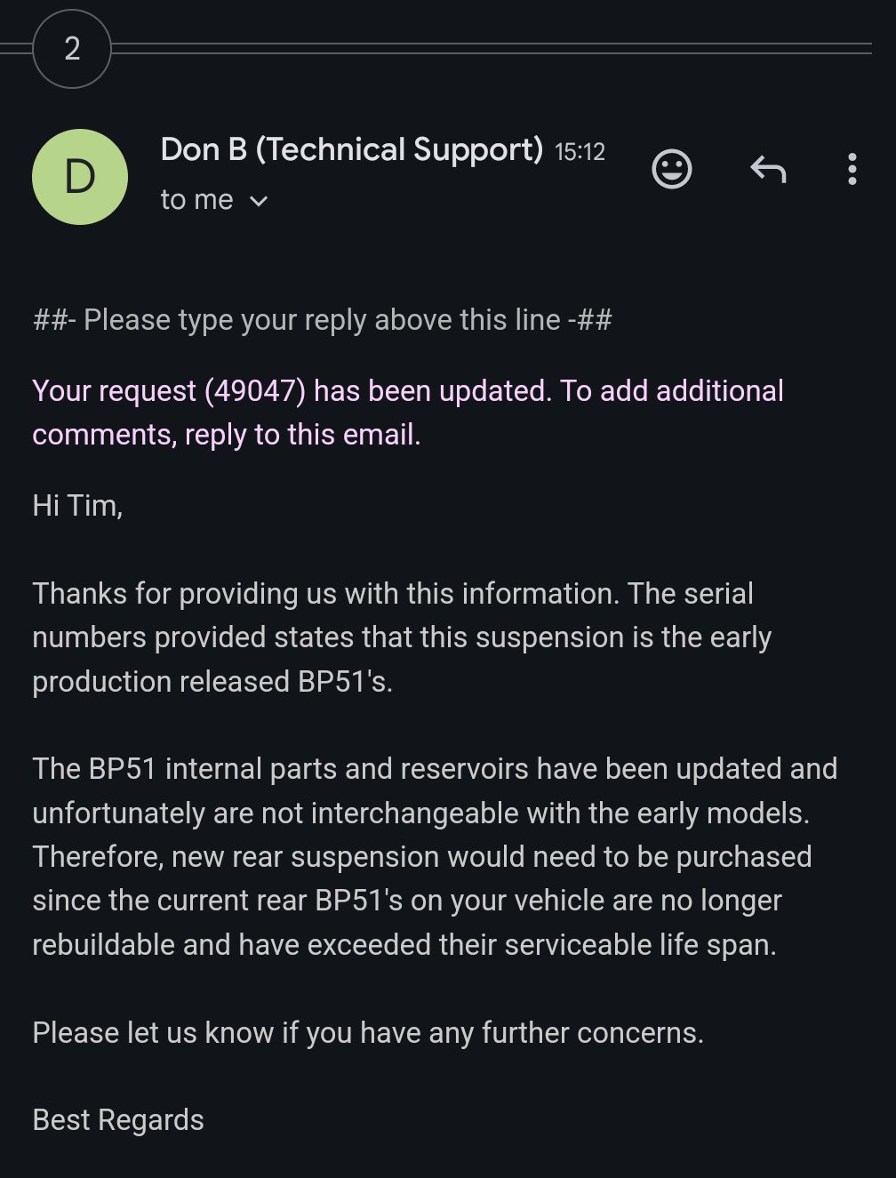

    Well ain't that just some more ARB/OME shit.. OME apparently has a lifetime rebuild service for the BP-51 shocks. That is as long as they don't change the design and invalidate that service... So I have to buy new suspension, and that will be from a more open company that supplies retailers/rebuilders with parts to service their products.
    Original install date: 5/26/16 169k miles
    Warranty replacement of leaking rear: 7/9/16 172k miles
    Leaking & Beyond "end of service lifespan": 1/17/24 325k miles

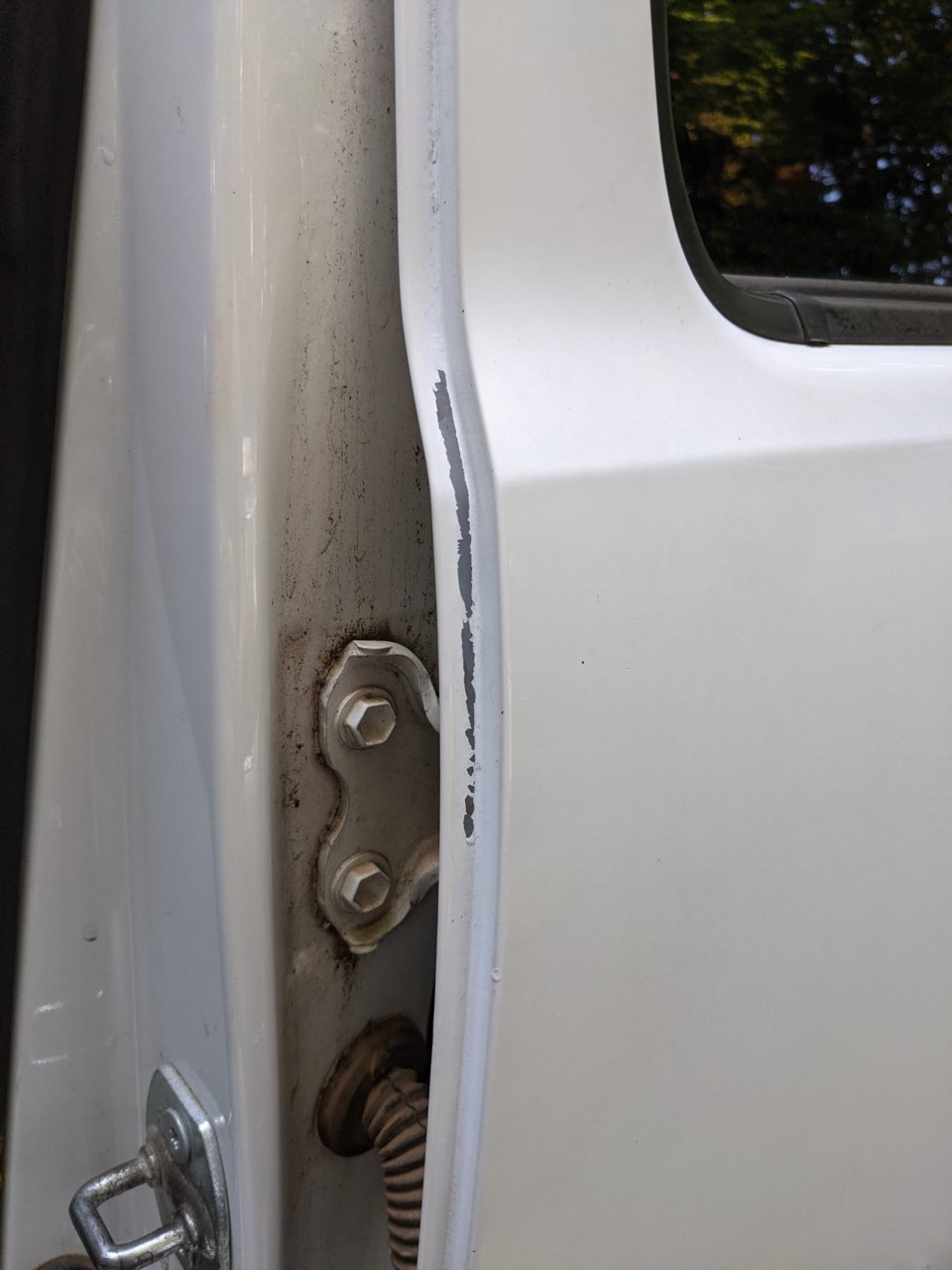

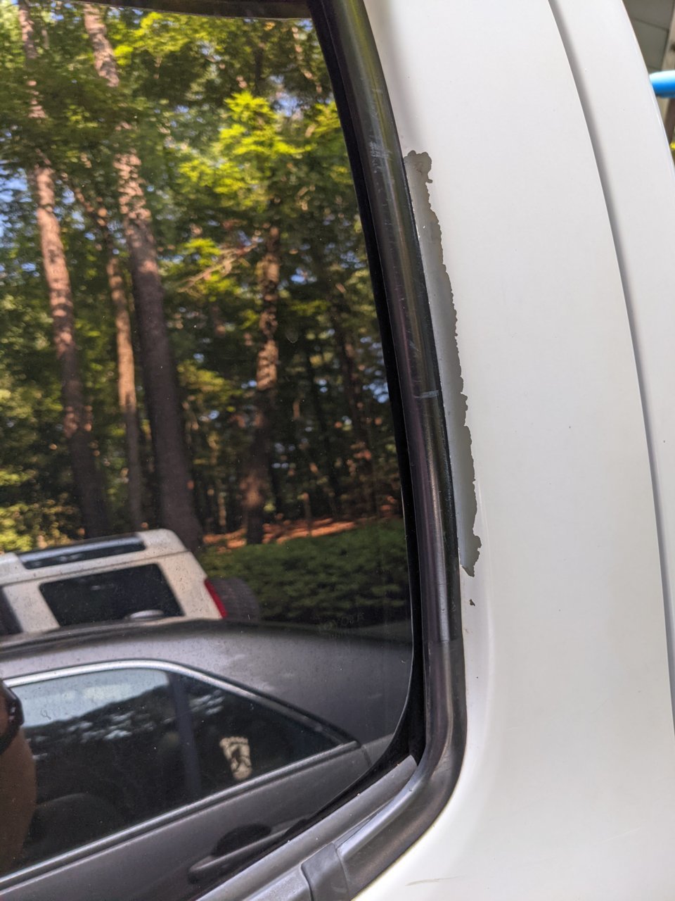

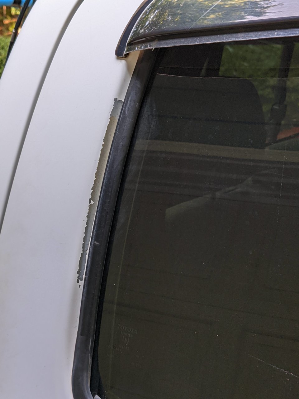

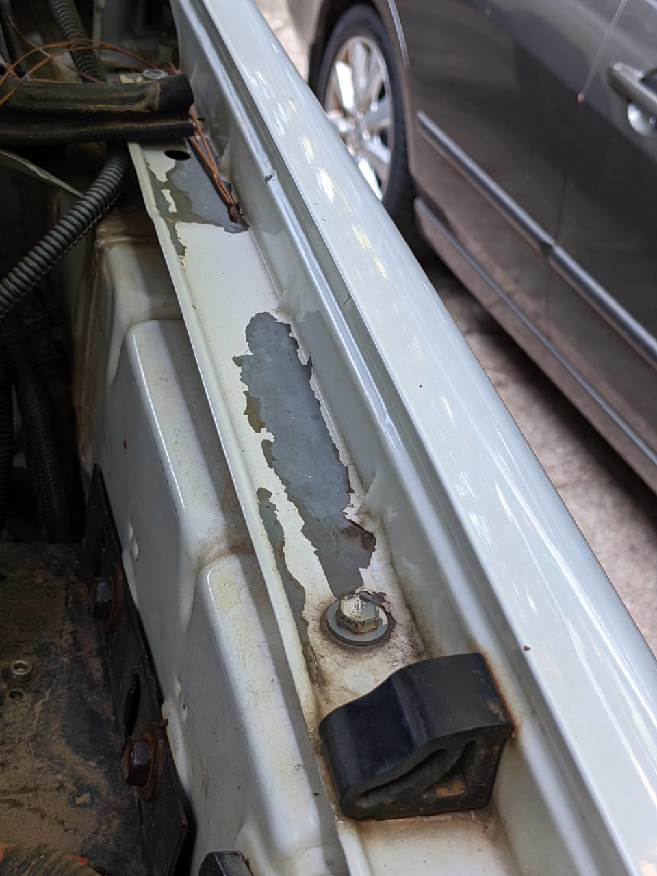

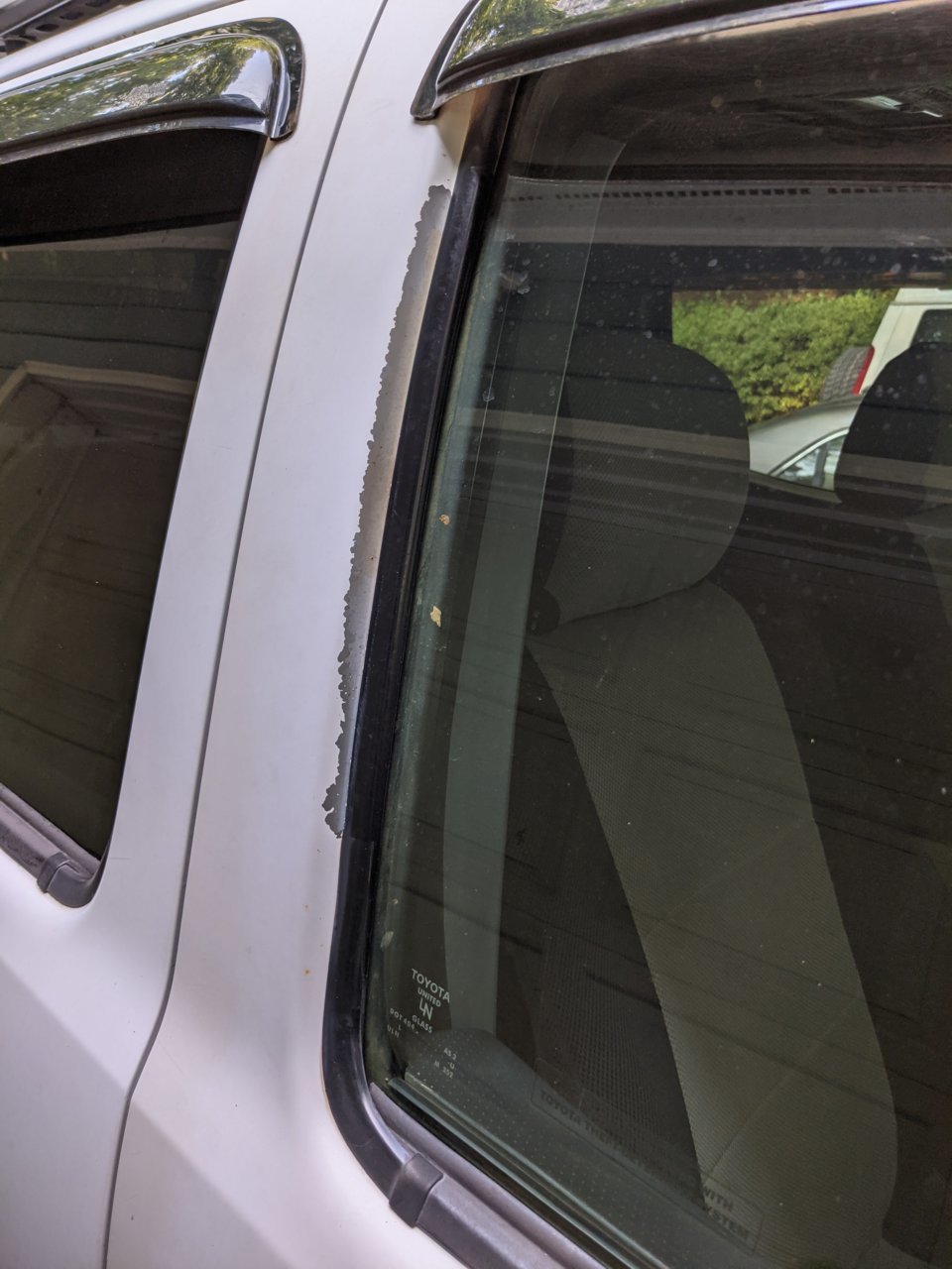

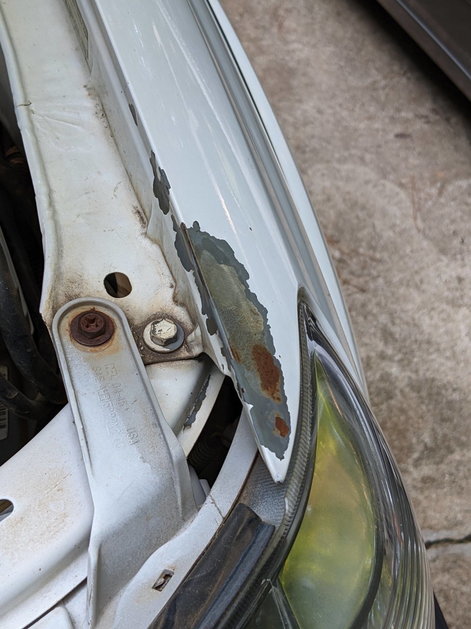

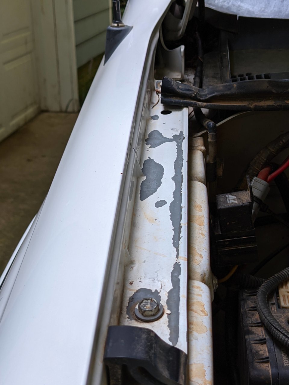

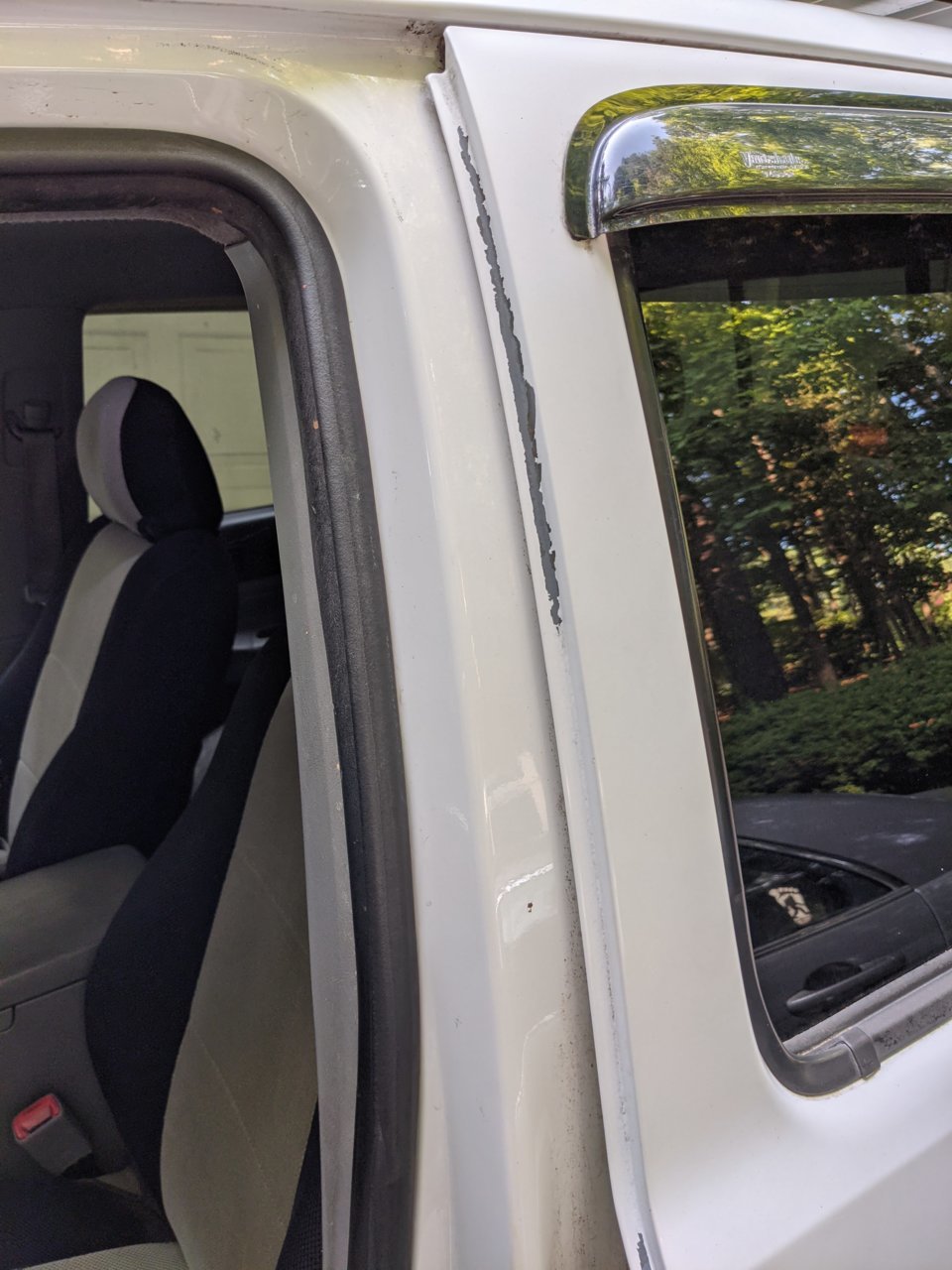

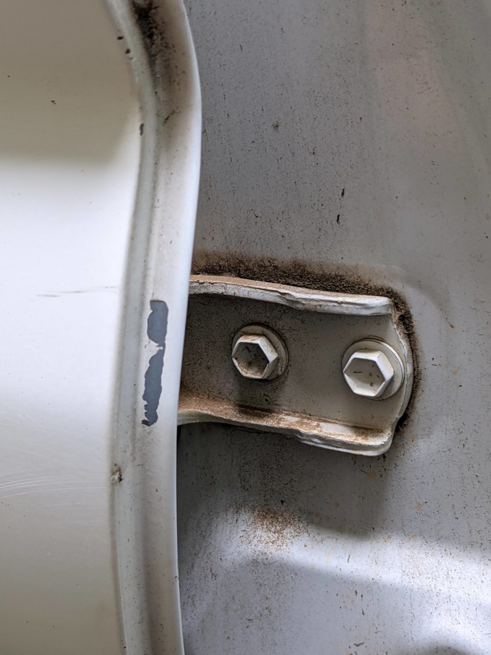

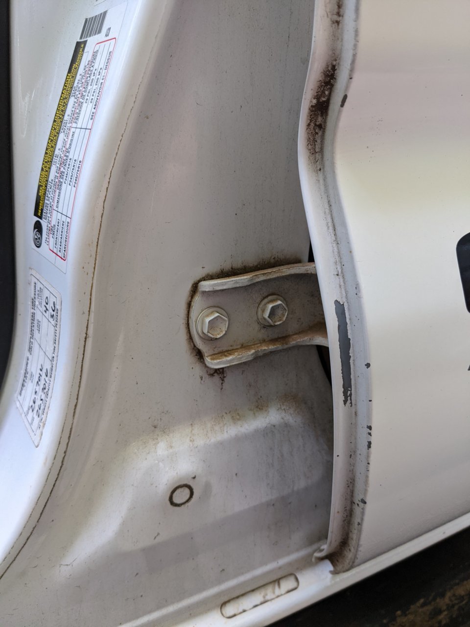

    Called Toyota again today about my peeling 040 super white paint reference# 240206001632. Still nothing for my year model. More Pics just because. 326011miles

    #1998
    Fight4Function
    Fight4Function Slightly Mutant
    Oct 5, 2011
    #64671
    55
    G
    SF Bay Area
    2014 DC TRD OR
    oof, that is the worst I seen, yet.

    Sandman614
    Sandman614 [OP] Ex-Snarky TWSS elf, Travis #hotsavannahdotcom
    Oct 26, 2010
    #45273
    35,875
    Tim
    Garner, NC/Boone, NC
    '06 SR5 Off Road
    But there's no problem here, no other Toyota Tacoma is having this issue, and "that's the first we've heard of it"

    Blkvoodoo
    Blkvoodoo a Hooka smoking caterpillar has given me the call
    Jul 23, 2015
    #160098
    4,187
    Kevin
    Near Clayton NC
    08 PreRunner SR5 DCSB
    My ‘08 is doing similar, in some of the same places
    I learned years ago with my Dads ‘84 HiLux 4x the bed rust issue was a known thing, but Toyota would only cover repairs if you were original owner.
    Given that Toyota and GM were in cahoots when these models were designed and sold, the paint is probably sourced from same supplier and GM had huge issues with adhesion, especially white, and they didn’t do anything about it.
    Besides. You already got a frame…. What more do you want ? Sheesh.
