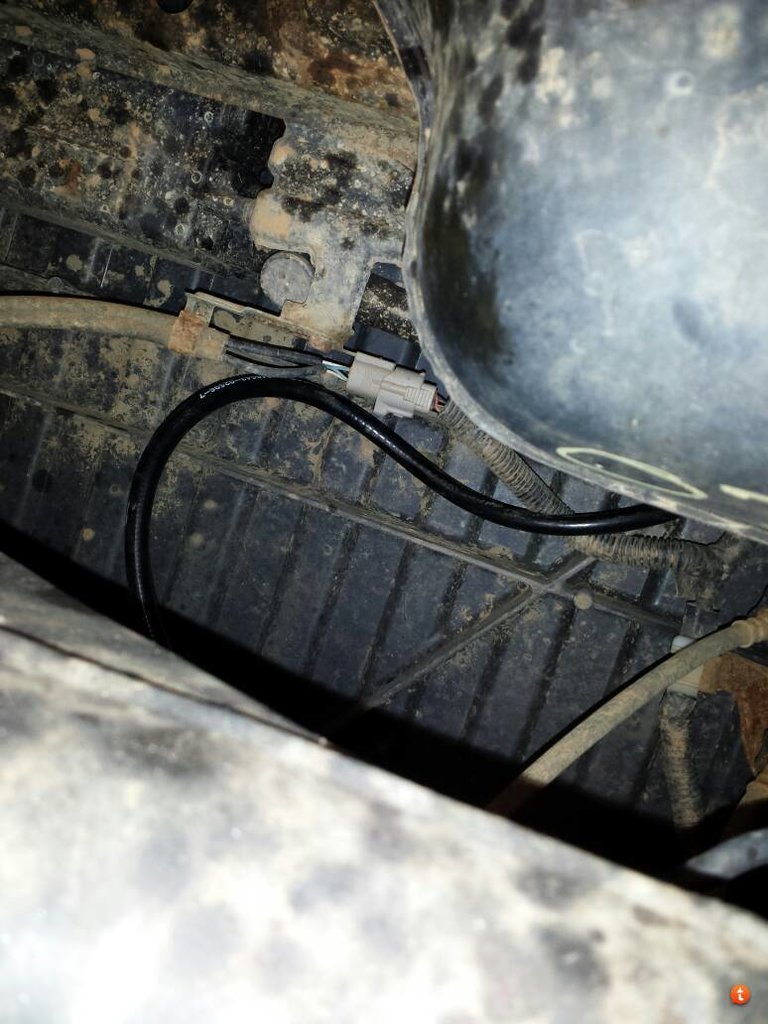

    Diff breather mod

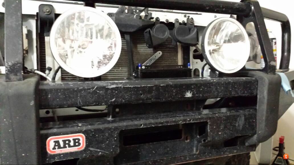

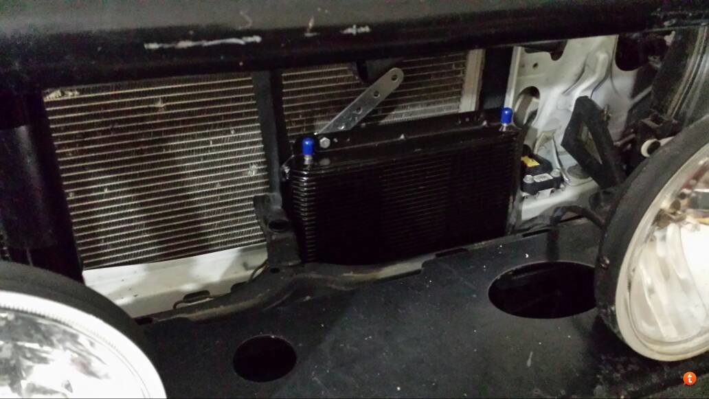

    Looking into putting in a transmission oil cooler.
    * Fin & Plate design
    * 10" x 7.5" x 4" Cooler & Fan
    * 12 Rows
    * 1/2" NPT In/Out
    * 7" 350 CFM Electric Fan
    * Fan Draw: 6 Amps
    * 175 Degree Thermal Switch
  8. Jan 22, 2014 at 10:51 AM

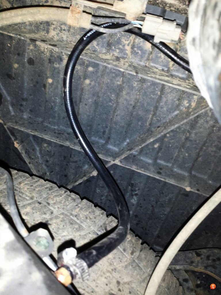

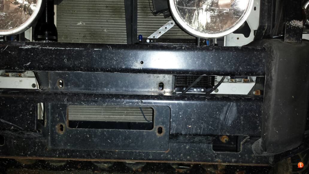

    Diff oils and transfer case oil changed. Transmission cooler mounted!

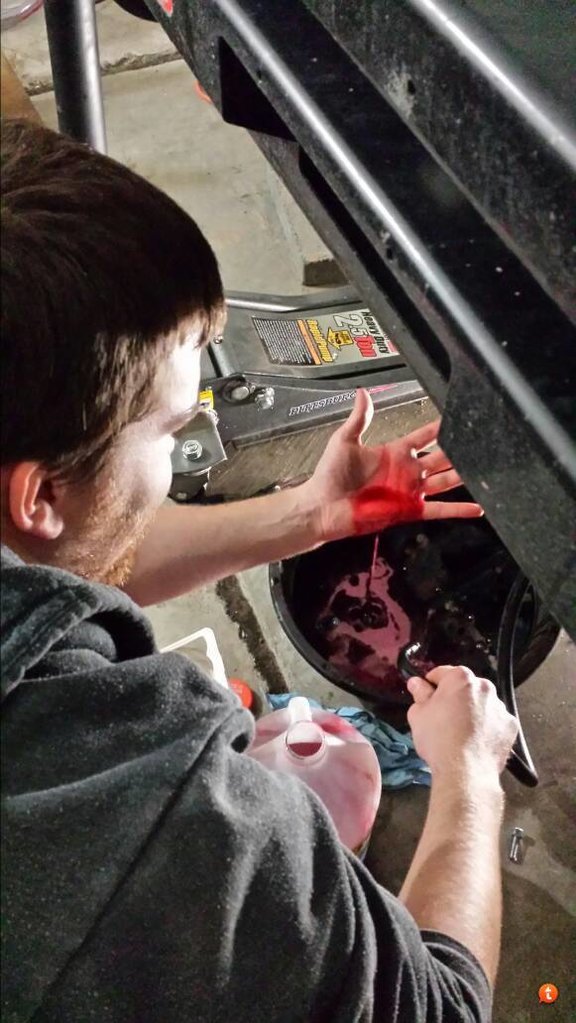

    Completed. Took about 3 hours, including installing a Trans cooler. Flushed with 14ish qts Toyota WS ATF.
    I've collected some fluid to send off to Blackstone. My kit is on its way. Hard mountain driving, mild off roading, no extra Trans cooler, 120273 miles.
    My friend being derpy holding the funnel.

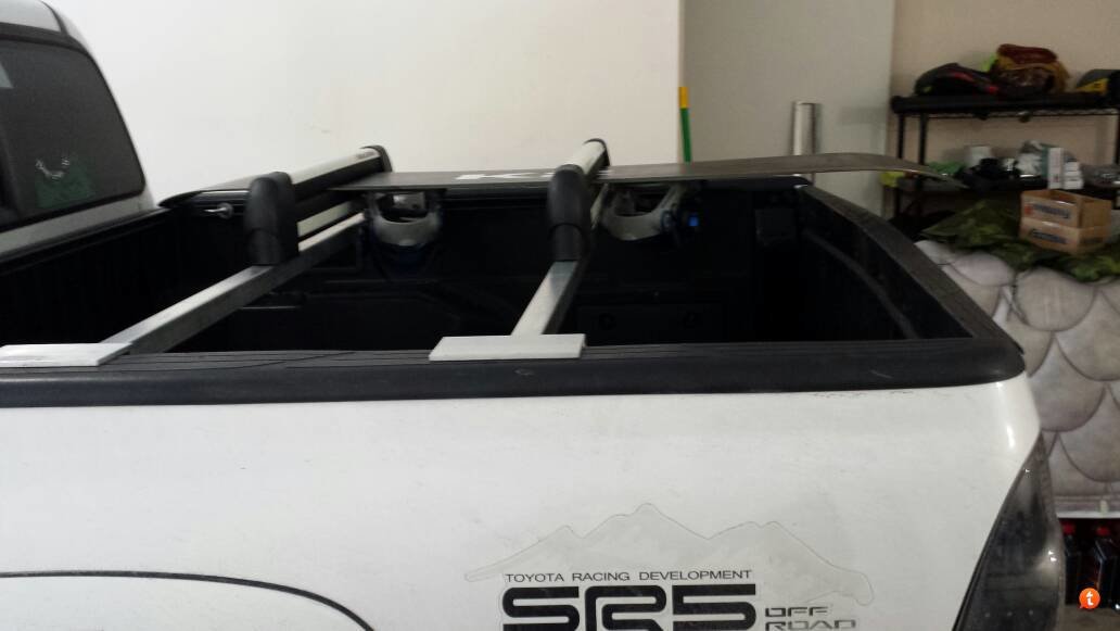

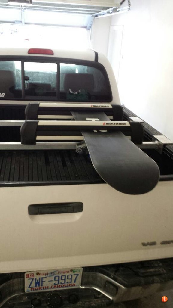

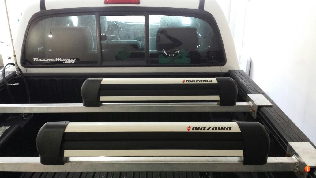

    Finally got these mounted up. Nice and sturdy. Headed up to Boone to board.

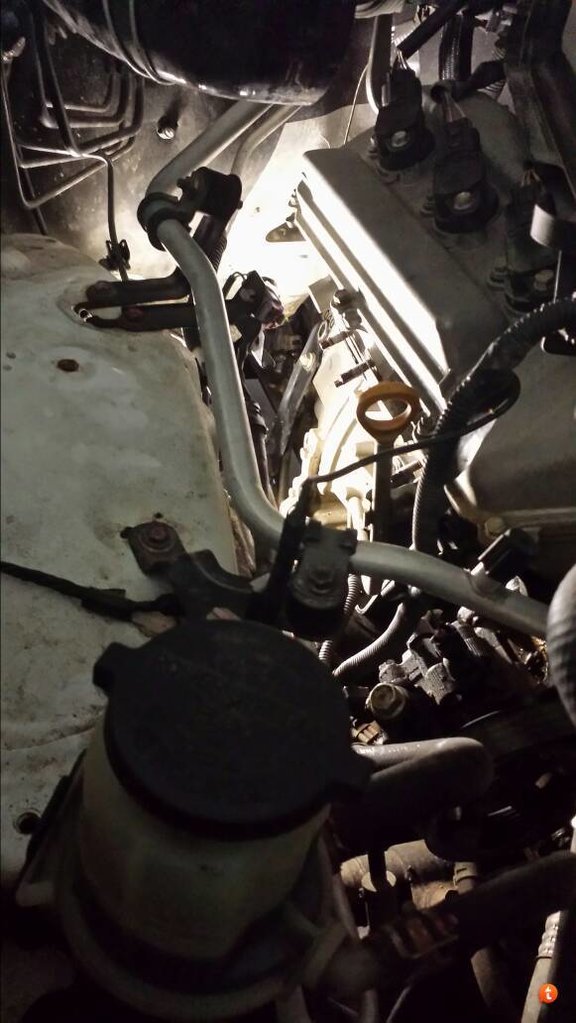

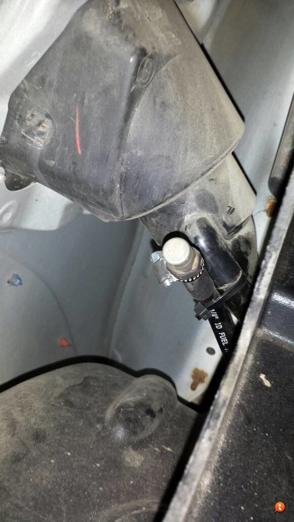

    Changing out the passenger side manifold. Trying to rid myself of this surging. 121781 miles

    Pretty sure the surging is gone. I haven't driven to far out of town but around town I don't feel it.
