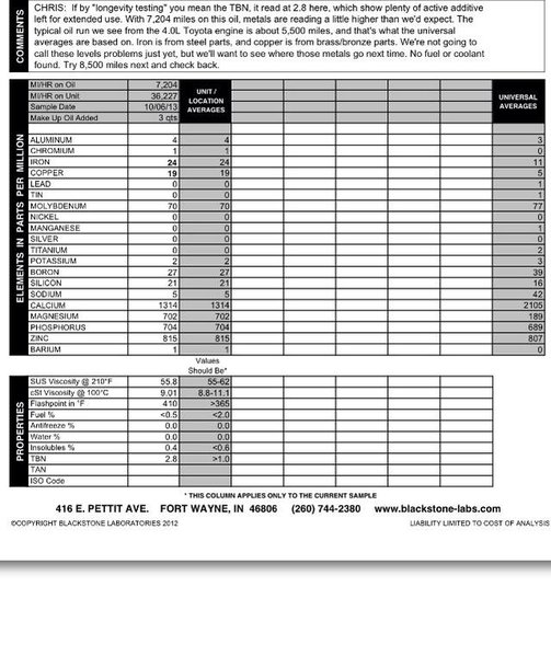

    Nice! Had them do my engine oil last change. Think I'll skip an interval and send in again.

    How'd it look? What do you use and what interval?

    Little high on a few metals. 7200 miles and Mobil-1.

    I've been running 10k intervals, I think I will send a sample off and see how it looks. Granted you have the SC.

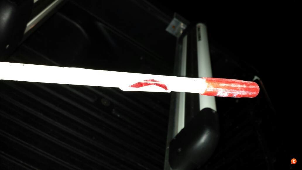

    Help. The outer shell of my firestick cracked open today. Should I cut the rest off and get some heatshrink that's large enough?

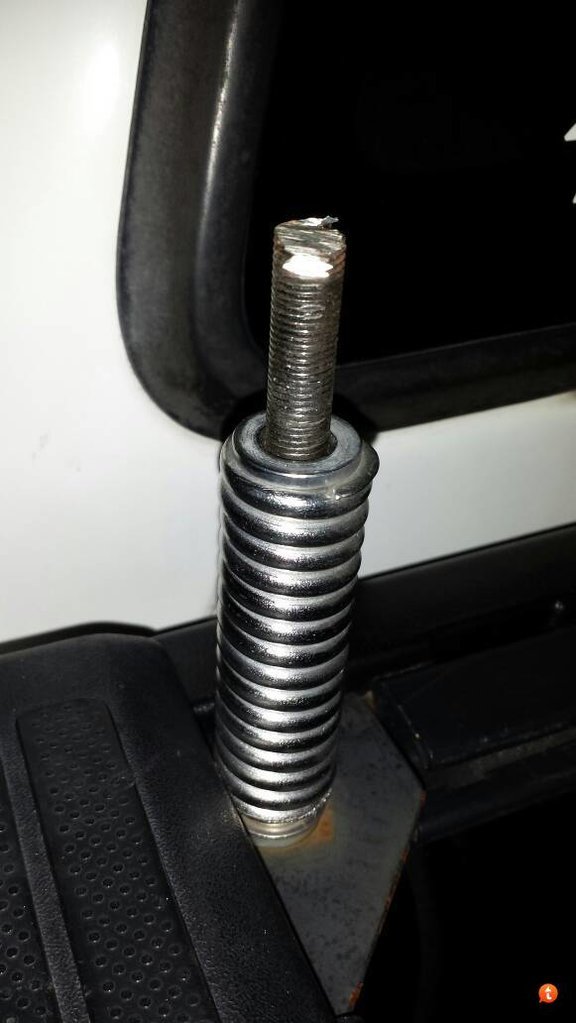

    And the stubby antenna mod, to keep shit outta the hole. (do you think I need to retune that)

    I would just put some white electrical tape around it if it still reads fine.
    Yes, retune :thumbsup:

    That's 2 votes for electrical tape. First vote was for the liquid tape and then finish with electrician tape. I'm kinda looking for a cleaner finish.

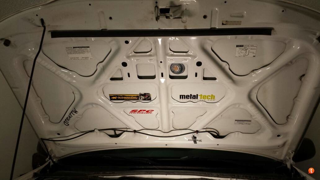

    Moar stickers
