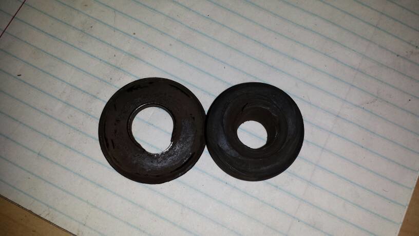

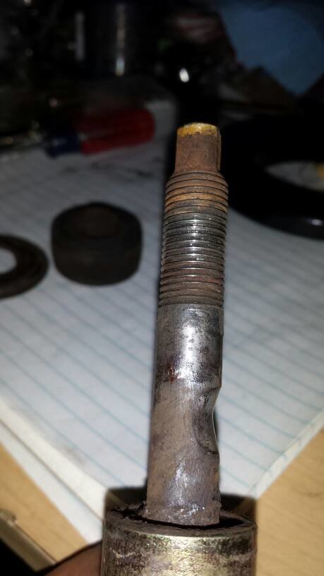

    That's the bushing that goes into the bottom of the top hat and the top shaft of the front shock. I emailed downsouthmotorsports.com (I bought them from them) about it.

    Dayum...didnt see that coming
    What do you think caused that? anything obvious?

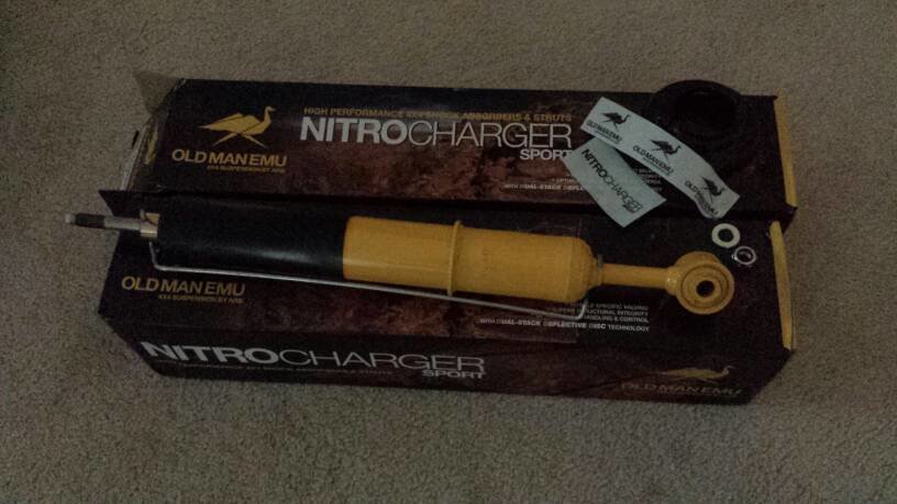

    Omg ARB is amazing!!!! They are replacing the shocks!!! I will be praising them and pushing their products and support even more so now!!

    Warranty replacements from ARB/OME!!

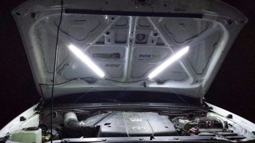

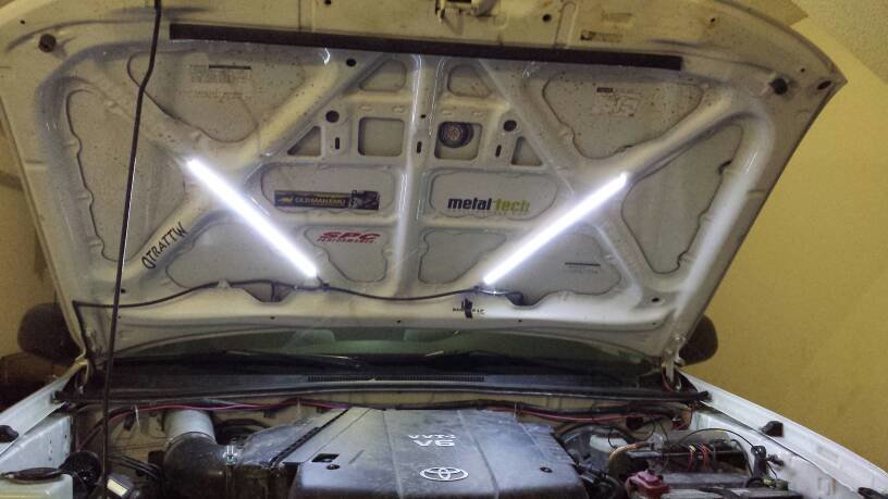

    I finally got my air compressor finished. I need a lower psi pressure switch. The one way check valve doesn't work at lower than 1CFM and when psi increases the valves closes and blows off.
    Step one: remove junky wire nuts and relay, and add viair pressure switch/relay (I need a lower psi switch though).
    Step 2: Find mounting location
    Step 3: Build bracket
    Step 4: Plumb and wire
    9235-12X1.25-04 | M12x1.25 Metric Male x 1/4" NPTF Female
    http://www.discounthydraulichose.com/9235_Metric_x_NPTF_Female_p/9235.htm?1=1&CartID=0
    Final View:
