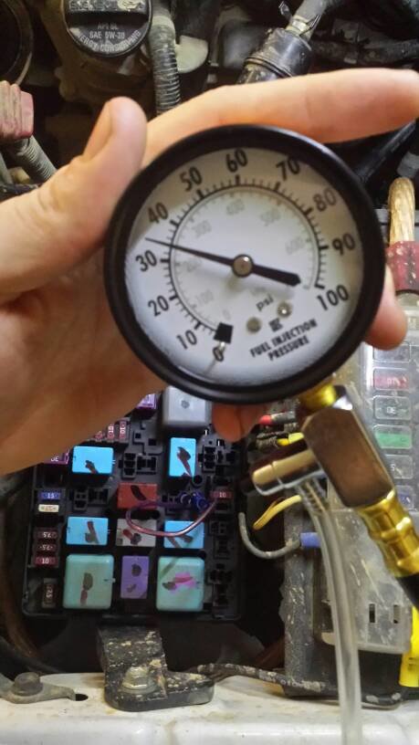

    Finally read the fuel pressure correctly. Key on, engine off, fuel pump running.
    Remove c/open relay, jump the two load side pins, turn key on(engine off), read fuel pressure (standard 281-287kPa or 40.8-41.7psi).

    Fuel pump photo dump. Walbro 255 gss342. Edits and explanations later:
    For the DCSB you have to drop the tank to access the fuel pump. I thought I might have been able to raise the bed but no dice. It does make it easier to disconnect the filler neck, fuel disconnect, and red cap vent hose.
    Instead of using the supplied butt connectors I pulled the "spade" connectors out of the Walbro plug and spliced new "spade" connectors onto the stock wiring for a cleaner look.
    Just checked fuel pressure:
    Key on engine on
    Key on engine off
    Key off pressure drops back to 0psi
    More details on issue here. Either a clamp is loose or too tight and cutting the hose.

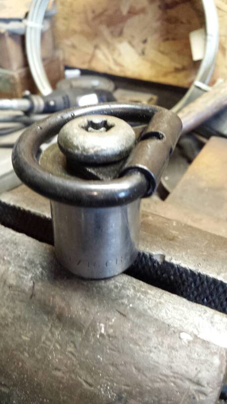

    Installed d-rings:

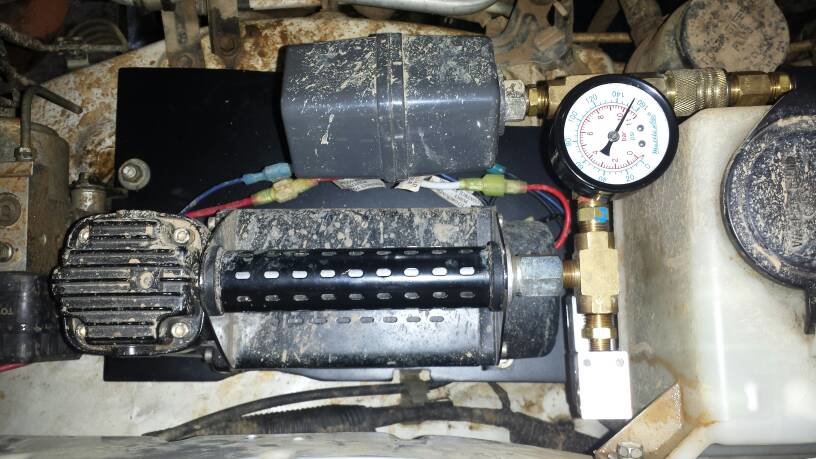

    Looks like I found what I need to make my air compressor work correctly. Will update when the parts arrive and are installed.
