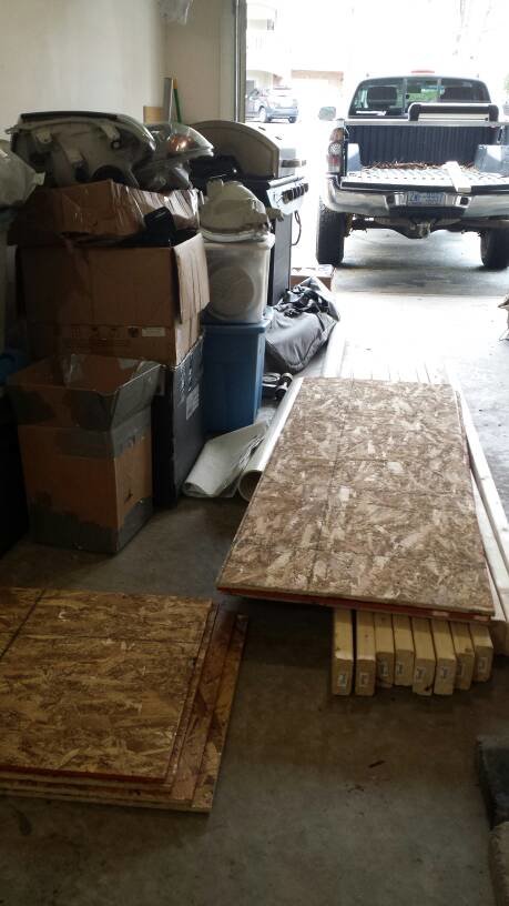

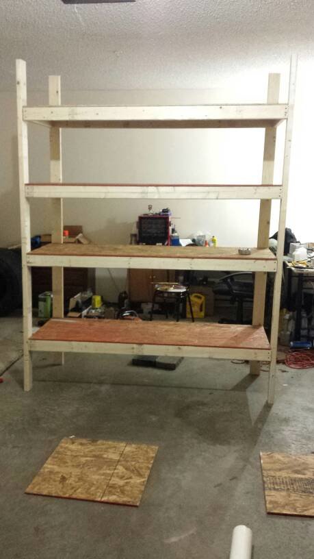

    Excited to get some space back!
    In place, just gotta load it!

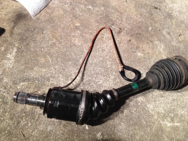

    Inner CV Boots are Blown.
    Make round hole fit on "tulip" peg
    I've got some work to do soon. Tie rods, lca bushings, lca cams, and inner CV boots.

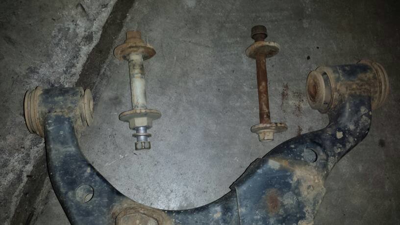

    Holy crap... Grinder and hours of beating and heating to get, the passenger side LCA (frozen cams) off, and LCA bushings w/sleeves out. Got everything back together then called it a night. Dragged my feet this morning because it was below 20* to get to work on the driver side. Expecting the worst I got the LCA off in just a few minutes. The driver side LCA cams and bolts look great!

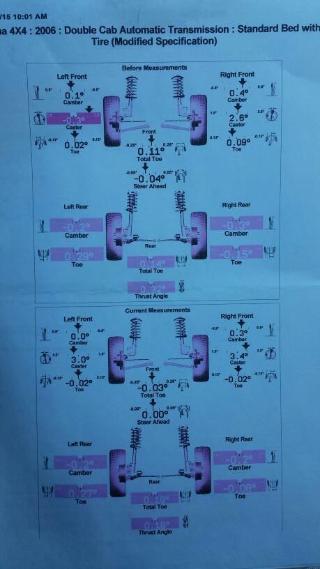

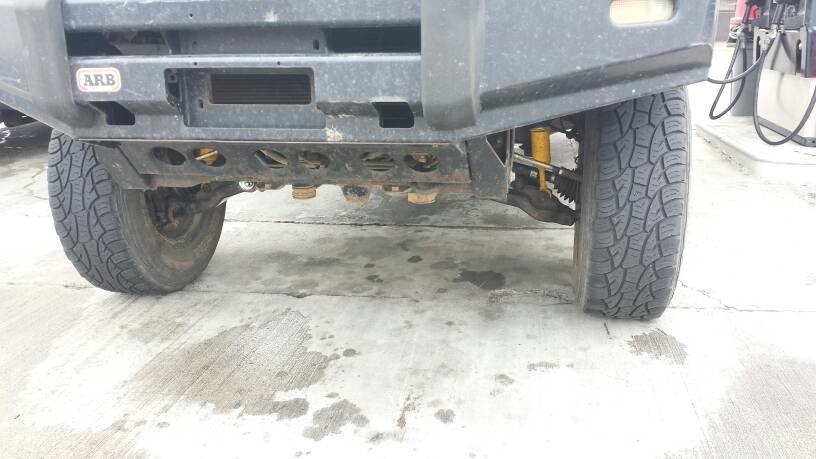

    How's this for an alignment, WTF. The tech was too worried about going home. Didn't touch caster like I asked to be maxed out as they only do stock numbers.

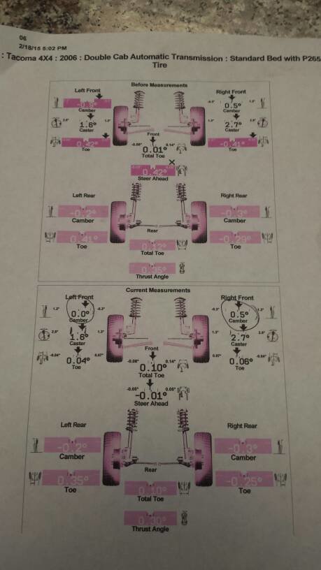

    Went back today to have the head tech John take a look. John Olmo at Firestone on High House and Davis is the alignment man! He listened to what I was telling him about the aftermarket parts and got me the alignment numbers I am looking for. He came out before he was finished to show me where it was at and asked me if I was ok with it.

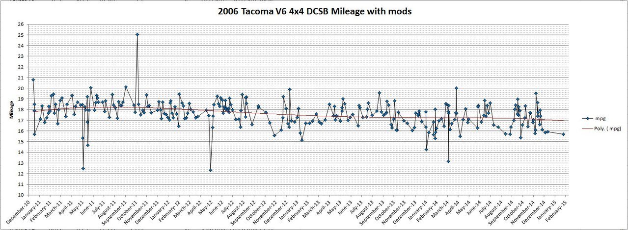

    @geocd posted a mileage chart. Here's mine over the last 4+ years
