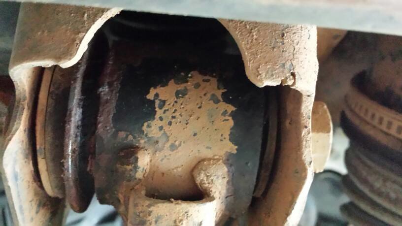

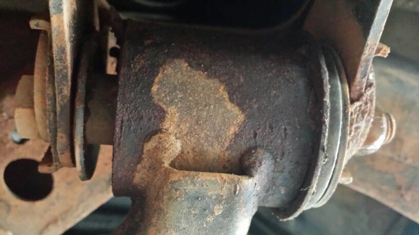

    I finally figured out my Pop,Clunk,Bang,Knock in the front end. The LCA is "breaking loose" from the LCA bushing.. I think the LCA was bent narrower when I removed or installed the LCA bushings..:(
    https://www.youtube.com/watch?v=s-Ub2rUdqEI
    Front bushing
    Rear bushing

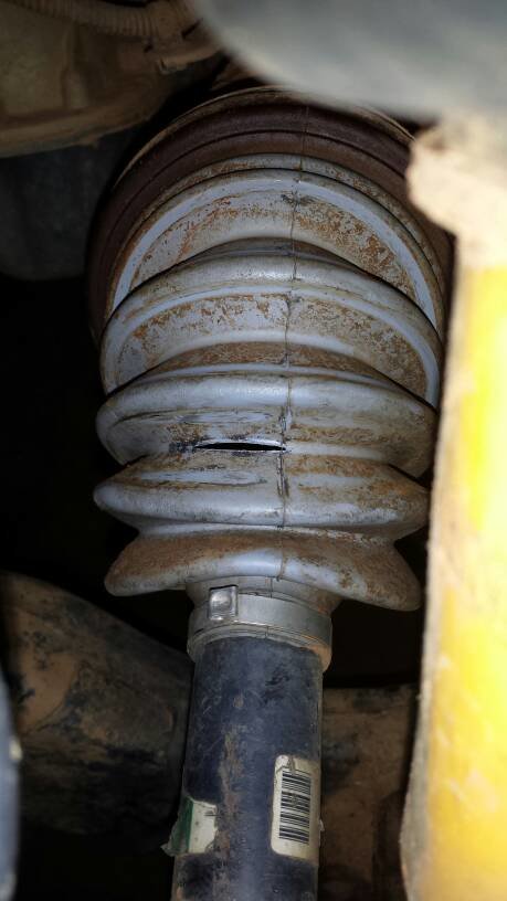

    My truck must know that I am bored with work.. The passenger inner CV boot is torn...ugh..

    It doesn't look like my Control arm is bent. I took it off the truck and pushed the bushing out by hand.. I took measurements of the bushing and it matches what Kevin found here (Moog Forward smaller bushing). I think maybe I enlarged the hole in the control arm somehow, but I am waiting on good numbers to compare to.
    Control arm forward bushing holder:
    Outside edge - 1.886"
    Inside edge - 1.890"
    Moog k200773:
    Outside edge - 1.887"
    Inside edge - 1.86"
    I looked through my old parts and found one of the correct bushings that I had not destroyed when i removed it. I cleaned it up, got some measurements, greased it up and put it in. I don't like using the old part but...
    The old factory bushing fits in about half way by hand and then is very tight going the rest of the way in. The moog bushing I can push in 7/8 of the way in by hand and then a swift pop knocks it all the way in..

    Ok, so start the clock, I've got 2 new Dorman 614-004 silicone CV boots installed. Passenger took about an hour by myself.

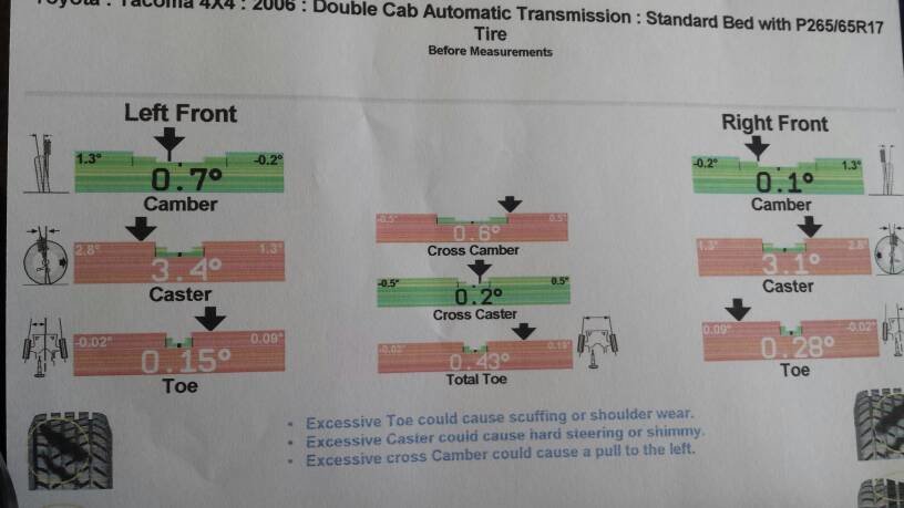

    Getting an alignment. I hate it when other people get there hands on my vehicles...

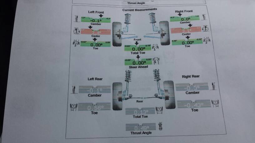

    After I changed the LCA bushing, before alignment.
    After alignment
