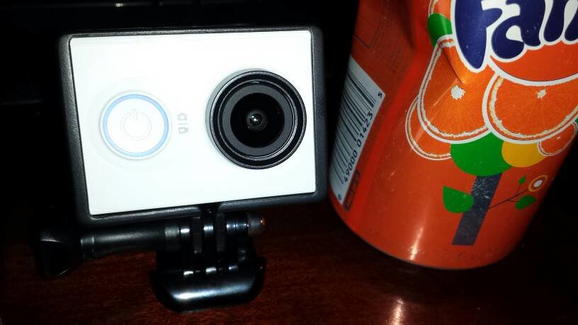

    Just got my Yi camera in! Now to get some gopro mounting accessories.

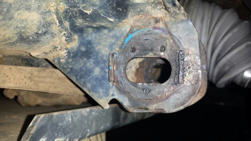

    Just ordered 2 Stock forward LCA bushings from Mid Atlantic Toyota Parts. They're in VA so hopefully it'll get here quick.

    The bolts were seized so I replaced the bushings with moog. They're loose in my control arms :/

    Straightened up the tabs while I was putting the new bushings in. Just need to put a bead behind them now.

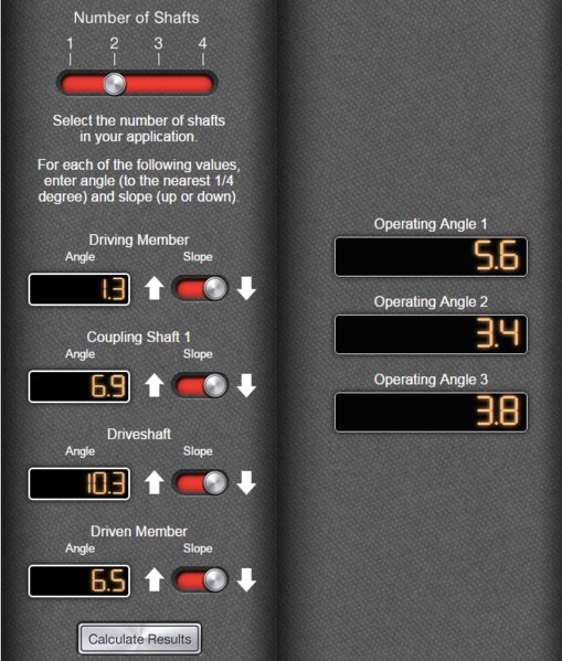

    '06 SR5 Off Road
    My current drive line angles, getting a shudder no hard take-offs and a droning vibration around 45*

    What symptoms were you getting from the bad LCA bushings
  14. Jun 10, 2015 at 3:34 PM
    #474
    Sandman614
    Sandman614 [OP] Ex-Snarky TWSS elf, Travis #hotsavannahdotcom
    Oct 26, 2010
    #45273
    35,919
    Tim
    Garner, NC/Boone, NC
    '06 SR5 Off Road
    Just the clunking. That should be taken care of now.

    X2 It's scary to watch the amount of movement within the mounts.
