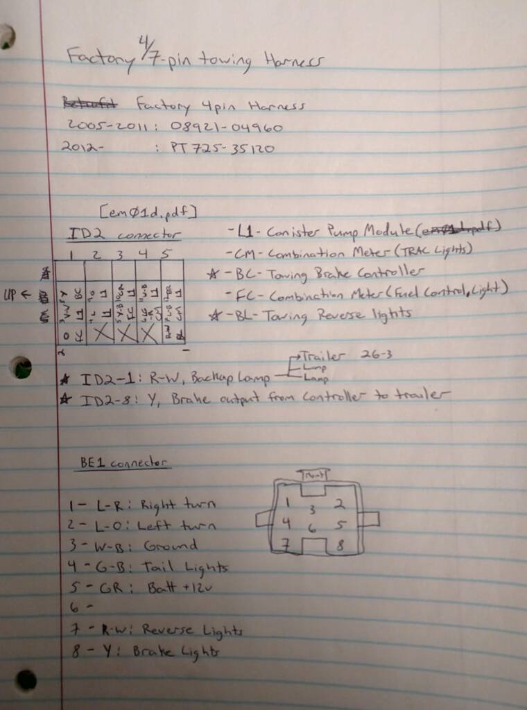

    Researching a factory trailer harness
    4pin installation instructions
    2005-2010
    www.toyotapart.com/2005-2010_TACOMA_TRAILER_WIRE_HARNESS_PT08921-04960_REV._B_T-AI-0297-W_--PT08921-04960.pdf
    2012-
    http://www.trdsparks.com/install/PT725-35120inst.pdf
    Here's some more, more on topic So looking at both part numbers, it looks like the 4pin connector is about 12" long and has a factory style 'square' plug and the 7pin factory harness plugs in there but also has 2 other plugs. I presume one is from the brake controller and the other for reverse.
    4pin 08921−04960
    7pin 82169-04010
    Hopkins 40950
    Hopkins 43385
    http://www.etrailer.com/Custom-Fit-Vehicle-Wiring/Hopkins/HM43374.html
    https://www.etrailer.com/Wiring/Hopkins/HM48470.html

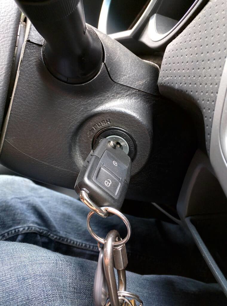

    Got my flip key cut (take the pin out and remove the blade). Now to get it paired to the truck. Thanks to Neneago and PreRunnerSeth!

    Another step closer to getting the Factory trailer harness figured out. Just gotta find the BE1 connector at the rear of the truck.

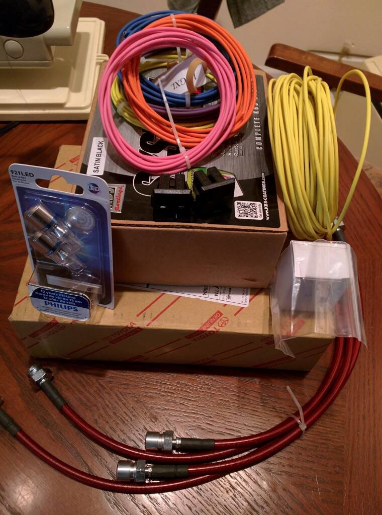

    I don't want to wait for all my parts and pieces to get here. I want to install all of them now!

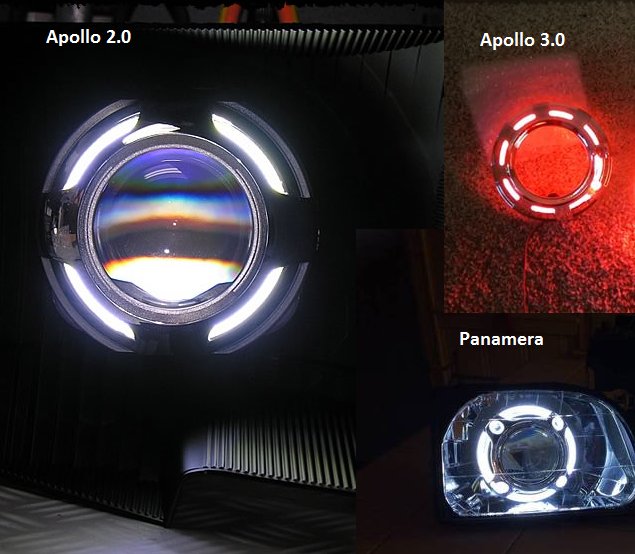

    Which shrouds for my Retros???

    Whichever one you have to modify the least to sit flush with the bowl! Apollo 2.0 is my biased opinion though!

    I wasn't aware you had to modify them. Planning on using the D2S mini kit.

    I had to trim some off the bottom of the shroud to sit in the bowl the best. There are a couple you won't have to modify but can't remember what they are. Might want to call the retrofit source and see which ones fit with the least trimming. Who knows, they could have a newer product line since I did mine that don't need trimming.

    I'm torn, the Apollo 3.0 uses the smallest Halo (least expensive) for the vent, but I like all 3.

    I wouldn't do it on mine cause it would be too much red but I think Apollo 3.0 would look mean on yours.

    Not the color the style of the shroud.
