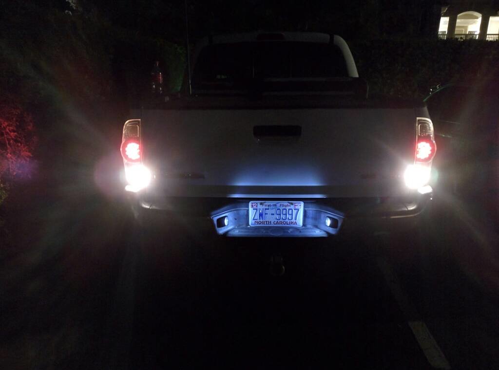

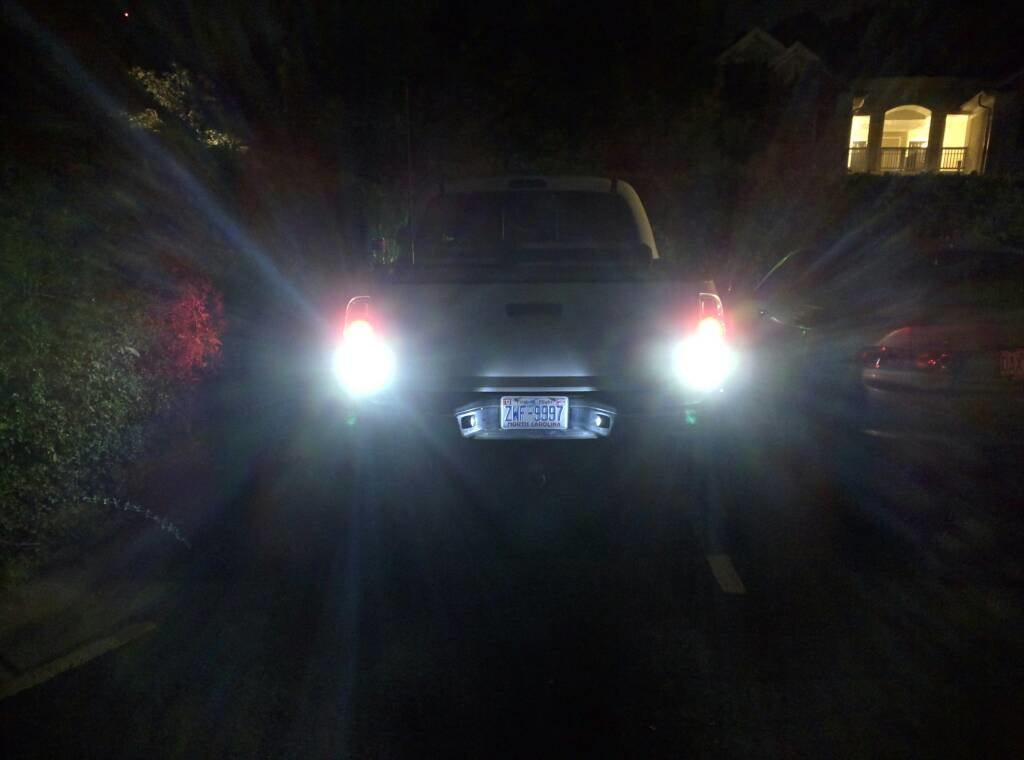

    Check out these reverse lights!! Philips 12841B2, 921 direct fit.
    Stock
    LED
    Stock - 1 bulb
    LED - 1 bulb
    Both led installed

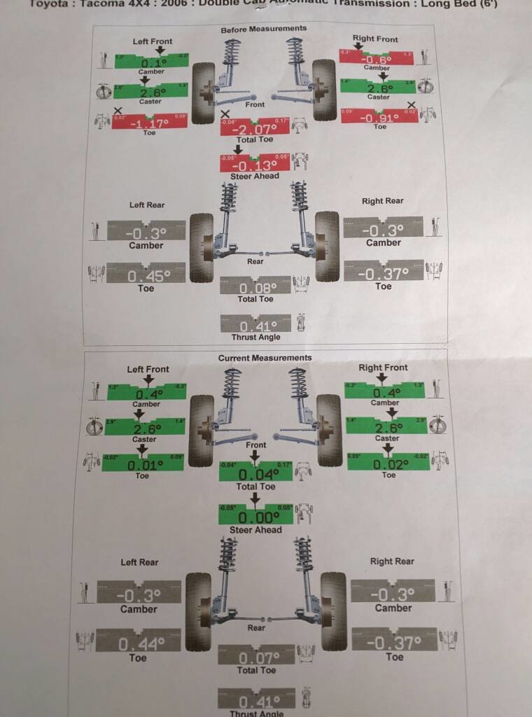

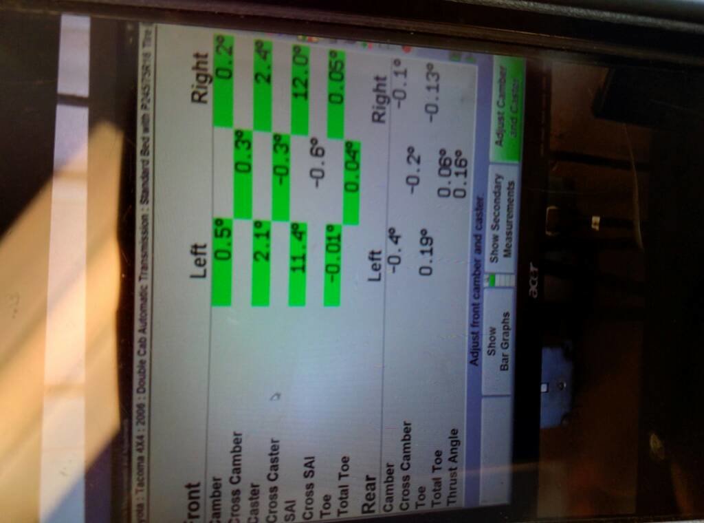

    Another alignment to try to get the numbers I want.
    It's not good enough.. Going back on the rack...
    After the second try the best they can get on caster is below. I've gotta make some adjustments at the UCA's and take it back. Now the question is do I adjust the Caster +1* or adjust the Camber, or both?
    Camber
    1.0 - 0.7
    Caster
    2.5 - 2.6

    Back from another try, same tech though he seemed to be in a bad mood today. I'm still not happy with this but it's better than it was.
    I moved the upper camber to about 1/4" from coil(about maxed out to center), Lower eccentrics are still maxed out.
    I made paint marks where I moved the ball joint so I know it moved. Instead of adjusting the lower eccentrics the tech took it upon himself to adjust the upper camber slide, it's now sitting about center in its adjustment. They also left this bitchs note on my paperwork, did not tell me in person. The next time I go in I will be getting my money back for the alignment service, they just cannot get it right, which is within spec. My truck still looks like a ballerina.
    It looks to me like all they had to do was adjust toe and a minor camber adjustment on the passenger side..
