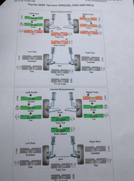

    Alignment numbers to get me home from Windrock TN

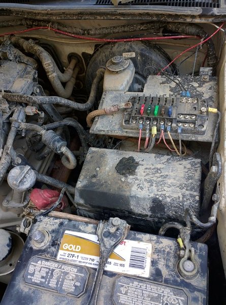

    Cleaning up this rats nest. While the Blue Seas box is a nice product it just leaves something lacking for hanging relays and having extra wires running around.

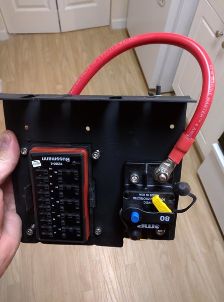

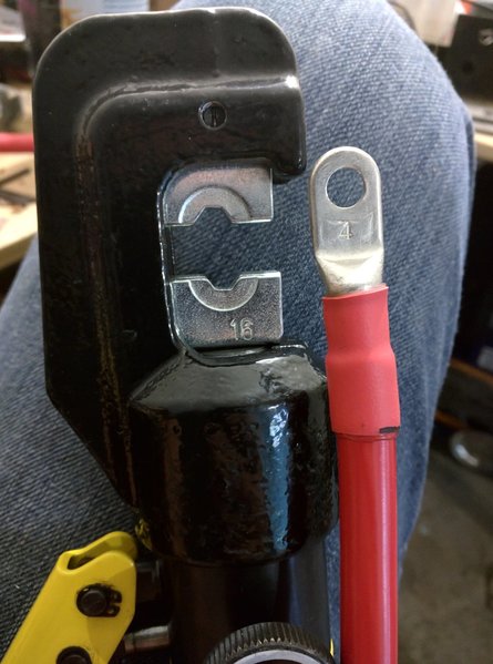

    Here's my parts list, to make 2 boxes. I got my wire from Wirebarn.com
    100, 39001 Gray Delphi Cable Seal# 12010293 Changed To 15324980
    50, 31068 METRI-PACK 280 SERIES FEMALE 12129409 TERMINAL 16-14GA
    100, 39000 Green Delphi Cable Seal 12015323 Changed to 15324982
    50, 30069 METRI-PACK 280 SERIES FEMALE 12110847 TERMINAL 18-16GA
    1, 533 CRIMPER SEALED METRI-PACK
    10, 75660 ISO 280 MICRO RELAY 12V SPST
    2, 46343 MINI FUSE AND MICRO RELAY RTMR PANEL BUSSMANN 15303-2-2-4
    100, 39010 Green Delphi Cavity Plug Delphi # 12010300
    2, 46691 1/4" Stud circuit breaker 80amp
    Notes:
    Input Terminal Rating: M6 input studs on bussed/partially bussed inputs: 80A max input on bussed fuse side, 80A max input on bussed relay side.
    Output Terminal Rating: 2.8mm blade terminals (30A max per terminal)
    Termination: Delphi Packard Metri-Pack® 280 Series terminals (sealed/tangless).* Delphi Packard 280 Series cavity plugs are installed where wires are not used.* Accepts #12-22 AWG wire sizes.

    Slowest progress ever...Bussmann style
