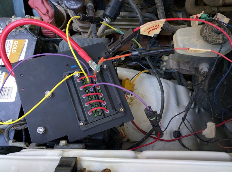

    Just a little wiring, no big deal. Reorganizing my wiring and making it color coded, more or less.

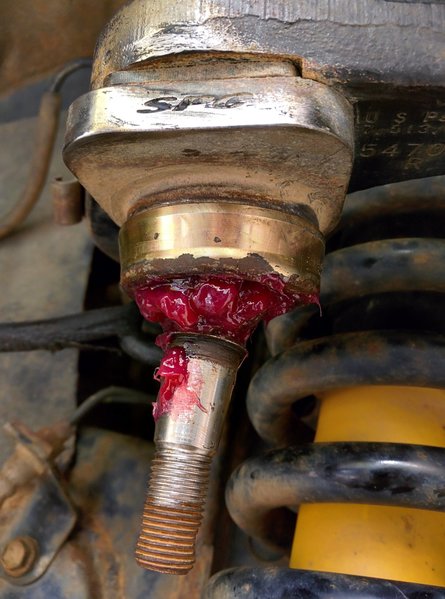

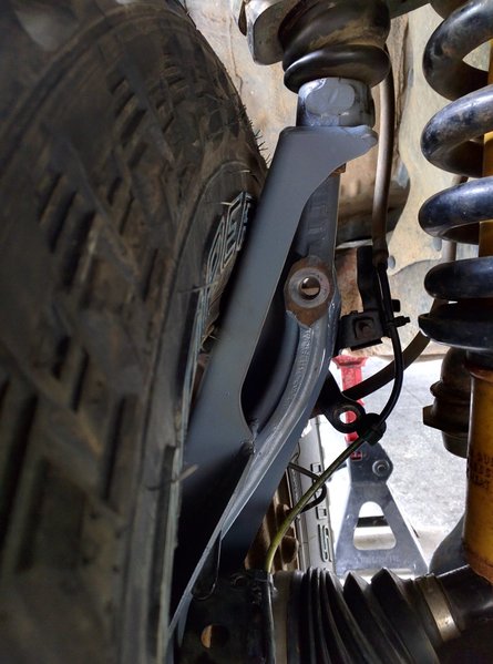

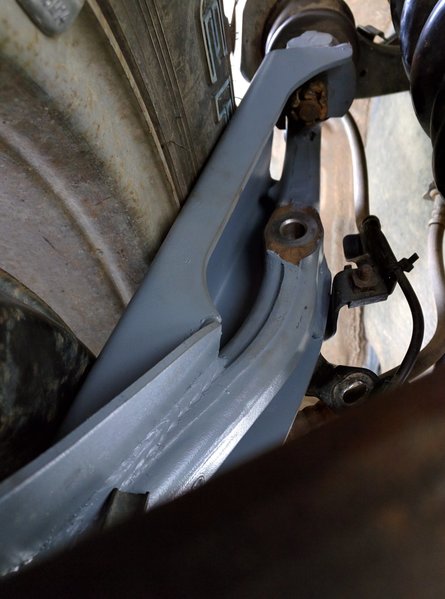

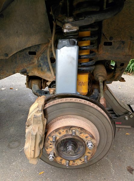

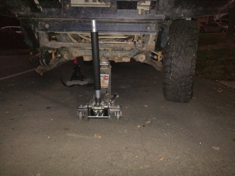

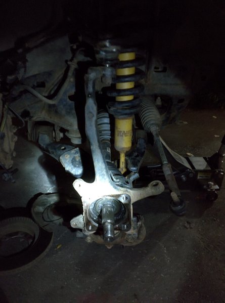

    The saga of bent spindles. I got a pair of spindles from Ahspulock, and ordered a set of TC spindle gussets (with swaybar) and Eddy welded them on.
    Started tearing into things during our mod day
    BS'ed too much and did some work by candle light
    Reused the Passenger side oil seal
    Gimpy, 7 wheel drive... This is where I stall for a while
    Had to go get new wheel bearing O-rings
    Cleaned up the minute amount of grease that was in the ball joint and packed it up with Lucas Red&Tacky(passenger side) Mystik Hi temp red(driver side)
    Installed and looking good #BattleshipGrey
    :Lisa: and crap I still need to get wheel spacers...

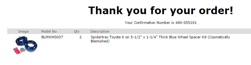

    Picked up 4 spacers from Spidertrax Outlet (cosmetic blemish) for 158$ shipped

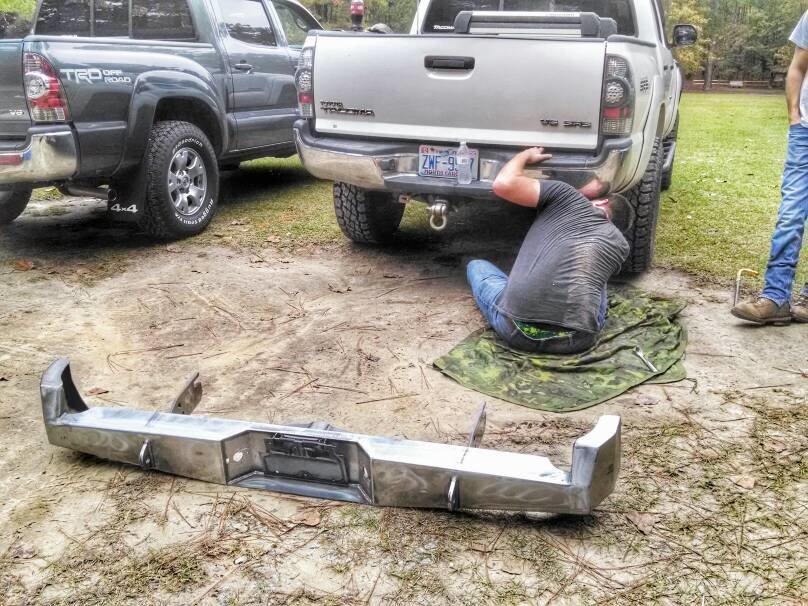

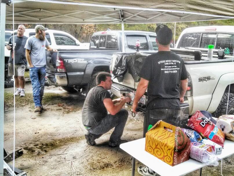

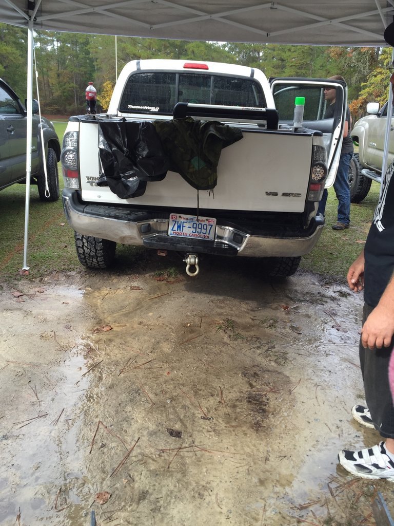

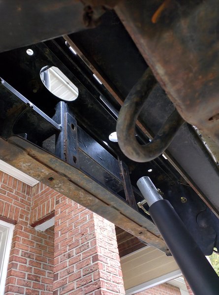

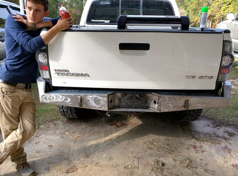

    SOS Concepts Reg rear bumper, mock install. I will paint it this week.
    Bumper and hitch for sale

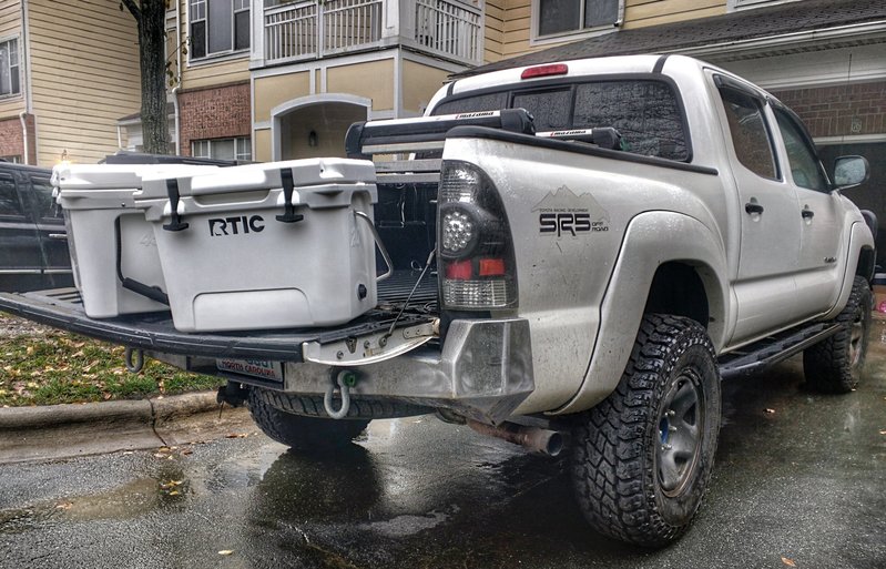

    Off road, on road, rain or shine! Icedown challenge coming soon. Sosconcepts and #rticcoolers "Half the price & holds more ice"

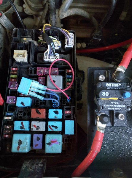

    Since I'm out of switch blanks on the dash I decided to use my unused foglight switch for my LED bar. Shouldn't accidentally press that when I want something else. The wiring for the foglights (35w=3amp each side) can't handle the LED bar (120w=10amp) so I made the driver side foglight wire the trigger for a relay in my bussman box. Works like a champ except it can only be on with Low Beams.
    Insert the foglight anytime mod!
    Found an Ign 12v in the box but did the ANYTIME (actually anytime constant 12v) mod for now. I want to find a clean way to tap into the Ign lead.
