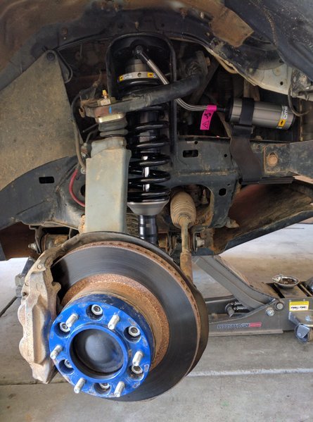

    886s:
    Driver front
    22.5
    Driver rear
    24
    Pass front
    22.5
    Pass rear
    24

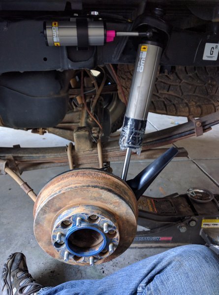

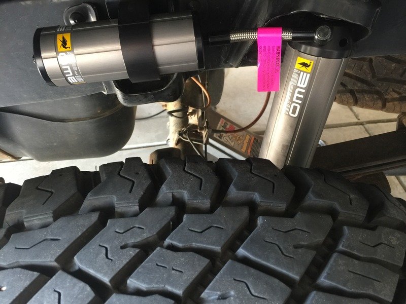

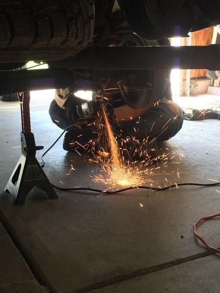

    My rear lower shock bolts are seized...
    Before:
    After:
    Driver
    Passenger

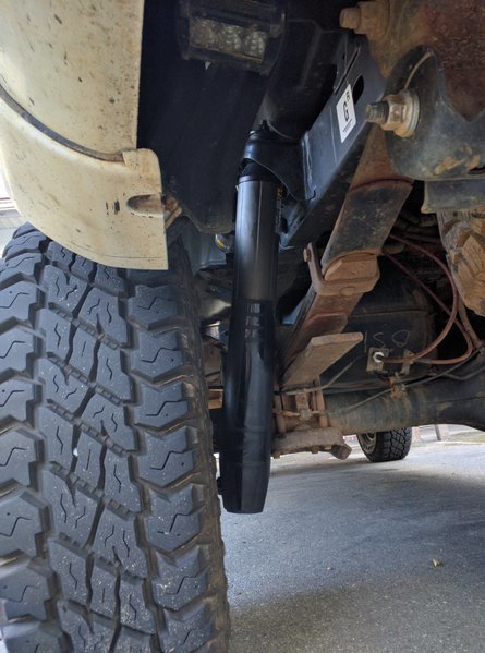

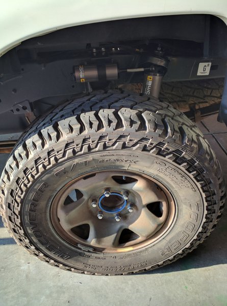

    And after I cut off the rear shocks it's fully installed.

    BP51s:
    Driver front
    23.25
    Driver rear
    24.5
    Pass front
    23.25
    Pass rear
    24.5

    I see you gained almost an inch in the front. I'll be interested to see how much they settle after some miles before you gotta raise em again. :popcorn:
    And looks great BTW! :cheers:

    Wasn't planning for any lift I actually thought I was gonna be an inch low, from factory they are set for 2" w/bumper and winch.
