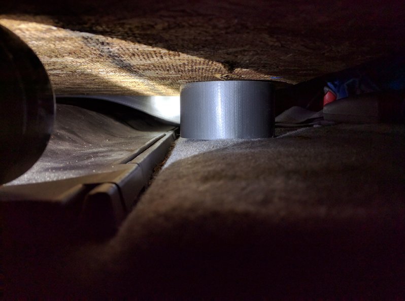

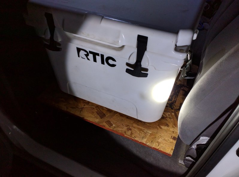

    #midnightmodday no more cooler rolling around.
    #ducttape fixes everything

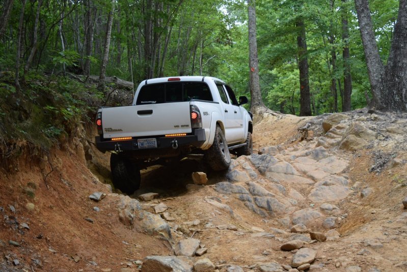

    :facepalm: what trail?

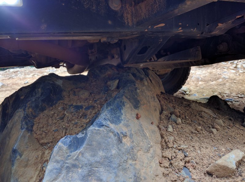

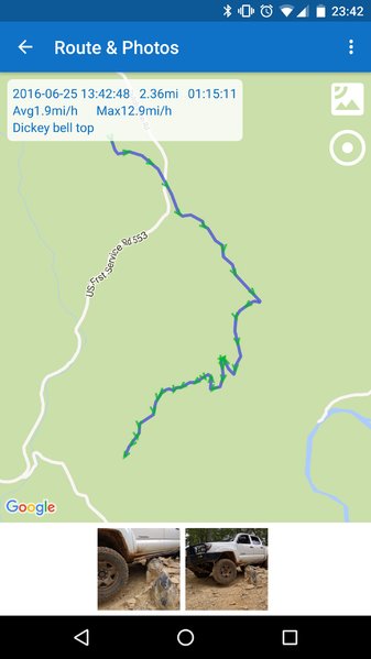

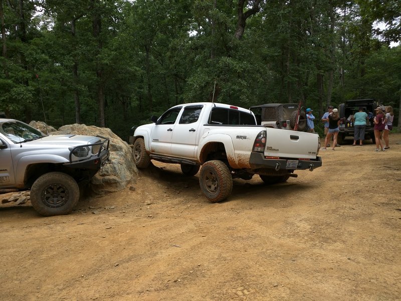

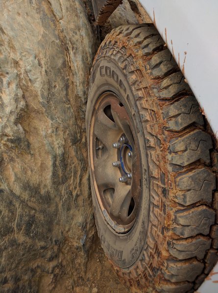

    Backside of Dickey Bell, had to dodge 2 dummies on 4wheelers and a wood guardrail.. Didn't see the rocks. Needed the world's best spotter!

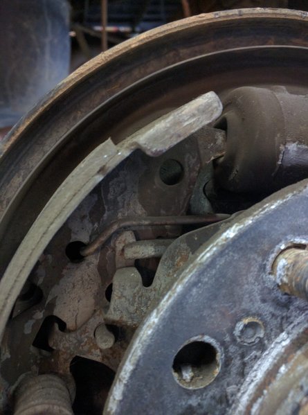

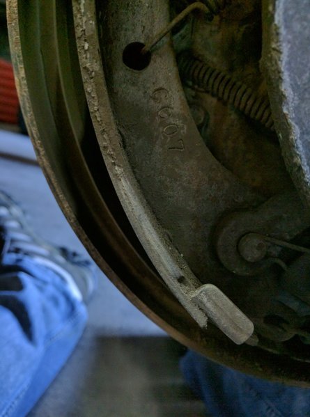

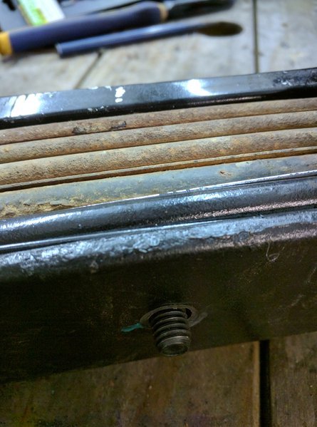

    Checked my rear Brakes.. Need new shoes.
    So I rebuilt my spring packs with fresh new Toyota leafs. Also cut it close with the new centering pins, didn't need to cut them.

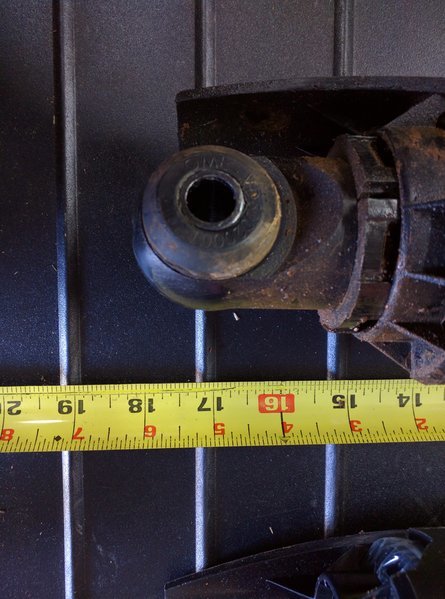

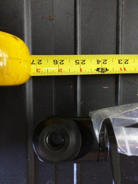

    Took some measurements and I think I need to take some more and figure out what to do, shock extenders, relocate shock mounts, etc..
    New spring only droop 28.5"
    Shock extended 25.75"
    Shock collapsed 17.25
    Blown shock saga continued: As I unbolted the top shock nut it fully compressed under its own weight lol. For those of you that installed your own, you know how much pressure these bad boys have. The oily/muddy shock will be going back to ARB tomorrow or Monday.
