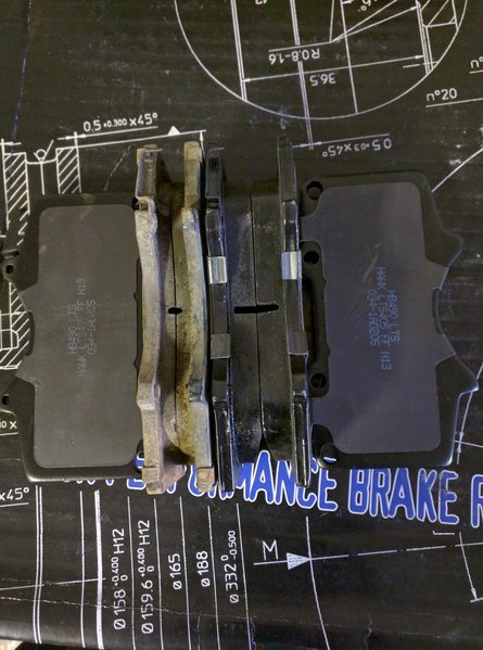

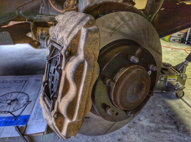

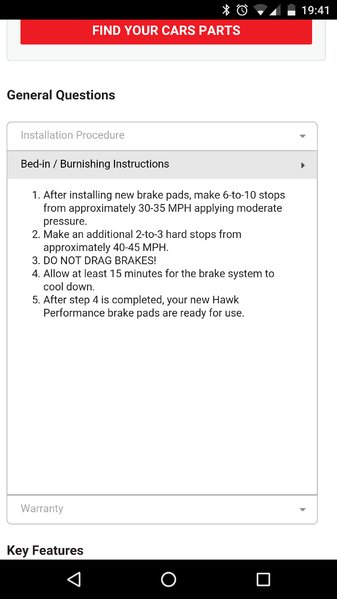

    Front brakes swapped out for Hawk LTS pads and Centric(Stoptech) slotted rotors. Bedding procedure complete, lol they smoked a bit at a stoplight. I was not holding the brake pedal at the light, I had the parking brake on and truck in neutral. I'll do the rear Brakes in a few days.

    Bedding procedures? How you like the slotted brake rotors?

    that paper makes my head hurt, so you need extended travel shocks with that leaf pack you built?
    give me a good review on this setup, I've had hawk lts and stop tech rotors on my radar for about a year waiting on a replacement, just now getting some squeals from brakes. Hard to beat 75K stock brakes.....

    Not judging on first lap out. Gonna give it a few trips.
    Haha Yea, math...need longer shocks. Will give a review later on of this brake combo.

    You thinking of longer shocks now? Please give a review on the combo. I need to replace my brake pads.

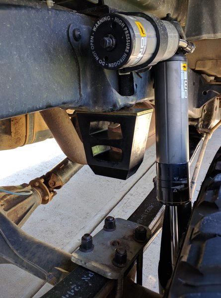

    Or good bumpstops and limit straps..

    Sucks I won't be able to use the full spring though.

    Yea, that's how I feel with my expos. I don't know if I want to go long shock later on.

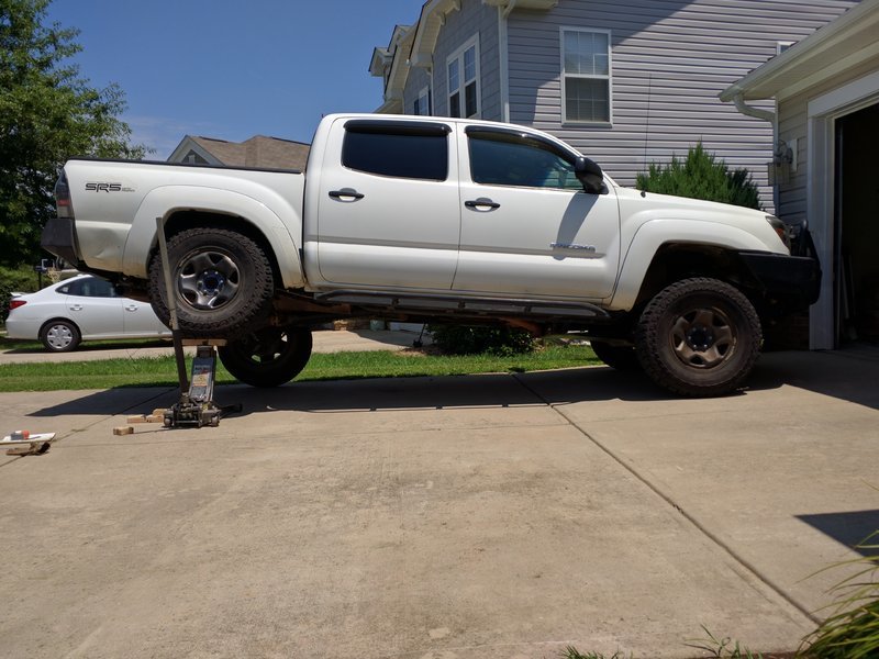

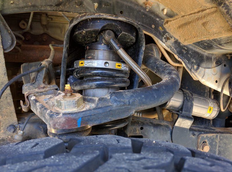

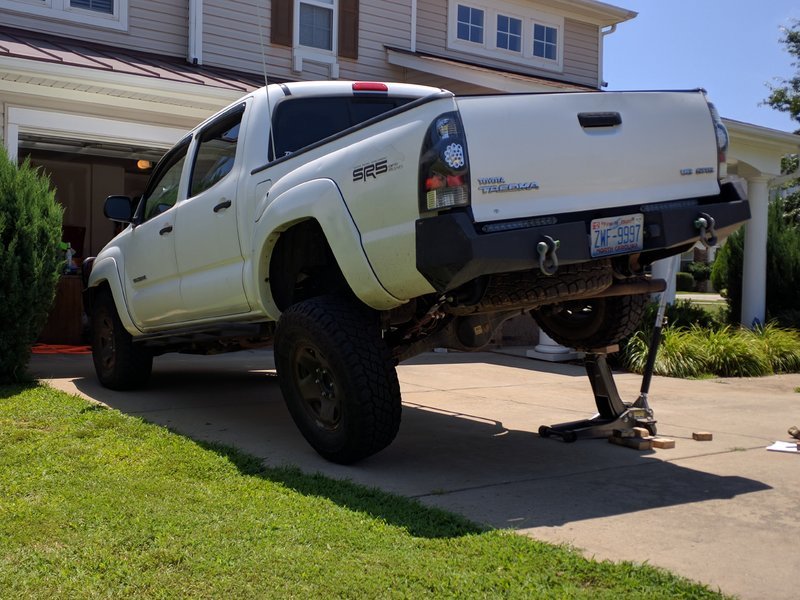

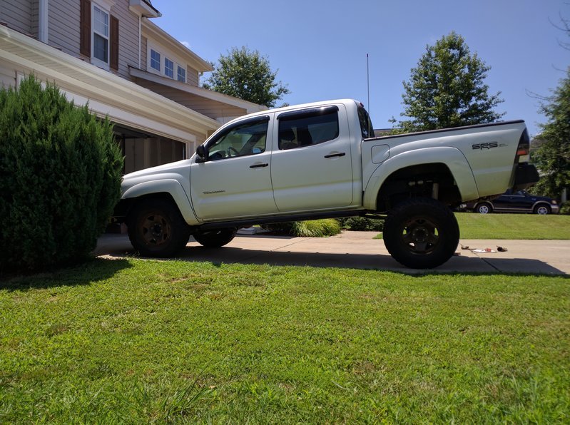

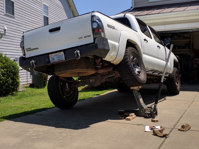

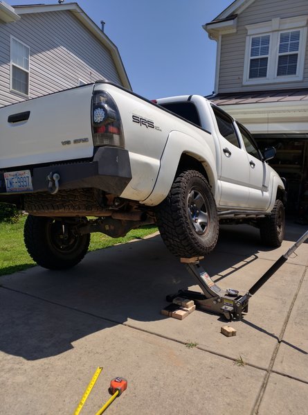

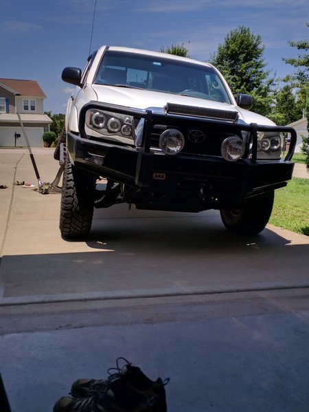

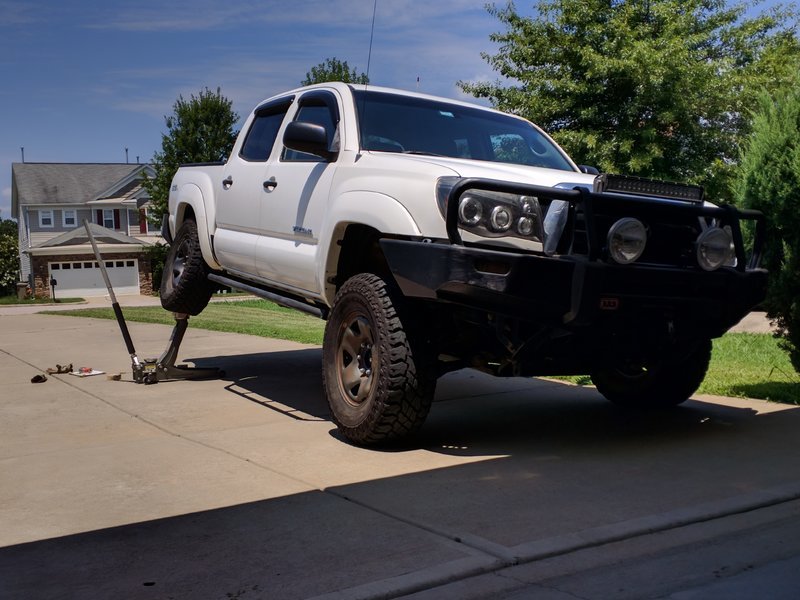

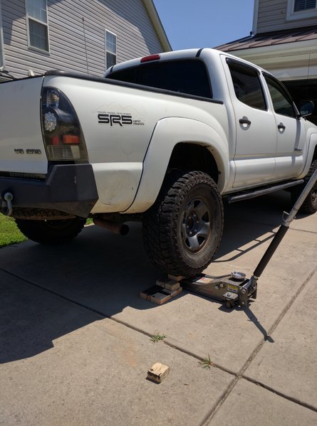

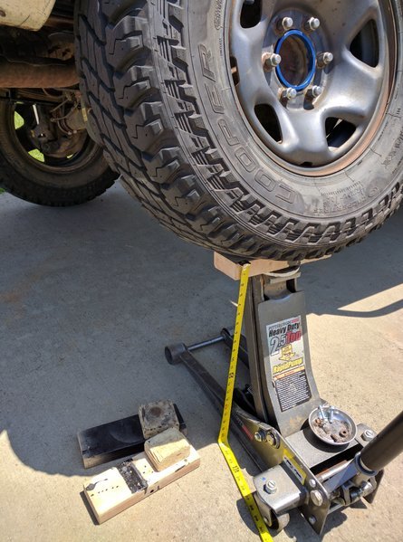

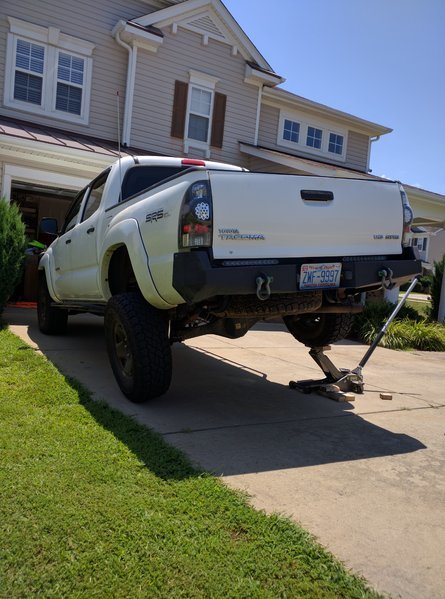

    Just took some more measurements. Looks like jack tops out at 21"(with the 2x4).
    Compression:
    Passenger side bump mount to frame - 3 ⅝"
    Passenger side shock mount to mount - 18 ¼" (min 17 ¼")
    Static:
    Passenger side bump mount to frame - 7 ½"
    Passenger side shock mount to mount -22 ⅛"
    Driver side bump mount to frame - 7 ¼"
    Driver side shock mount to mount - 21 ⅝"
    Extension:
    Driver side bump mount to frame - 11"
    Driver side shock mount to mount - 25 ¼" (max 25 ¾")

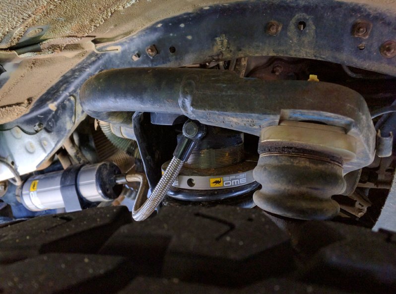

    Here are some comparison numbers...
    Stock 2006 dbl cab tacoma
    Extended 23.5"
    Compressed 14.375"
    Travel 9.125"
    OME 90000
    Extended 24.5"
    Compressed 14.625"
    Travel 9.875"
    OME BP51
    Extended 25.75"
    Compressed 17.25"
    Travel 8.5"
  17. Jul 13, 2016 at 8:20 AM

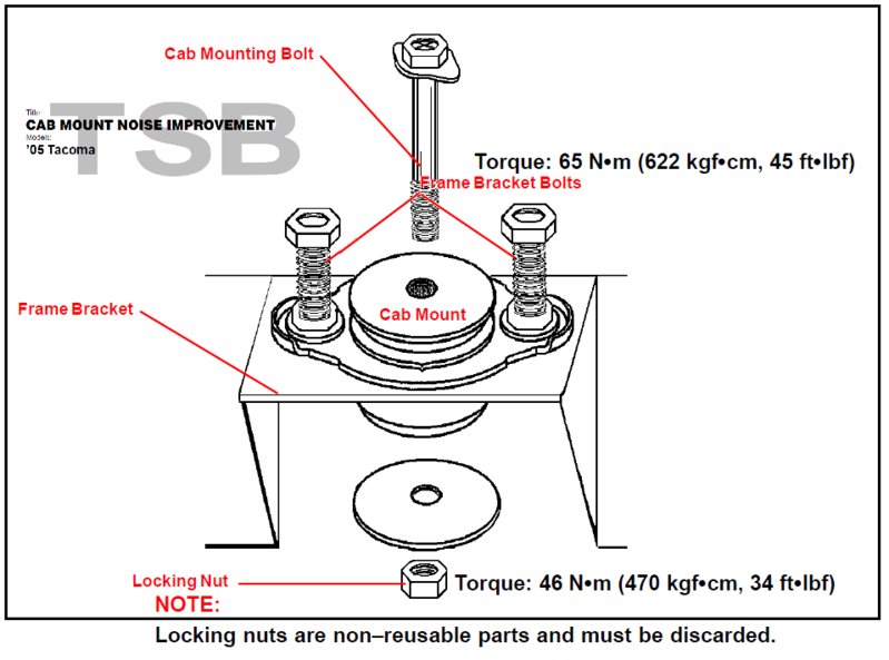

    Just found out body mounts are supposed to be 34ft/lbs. Thanks
    scottalot and ChadsPride like this.
  18. Jul 13, 2016 at 9:52 AM
    #858
    Sandman614
    Sandman614 [OP] Ex-Snarky TWSS elf, Travis #hotsavannahdotcom
    Oct 26, 2010
    #45273
    36,066
    Tim
    Garner, NC/Boone, NC
    '06 SR5 Off Road
    Some of the noises Creaking/Crunching were definitely coming from the mounts being too tight, quieter and smoother now!

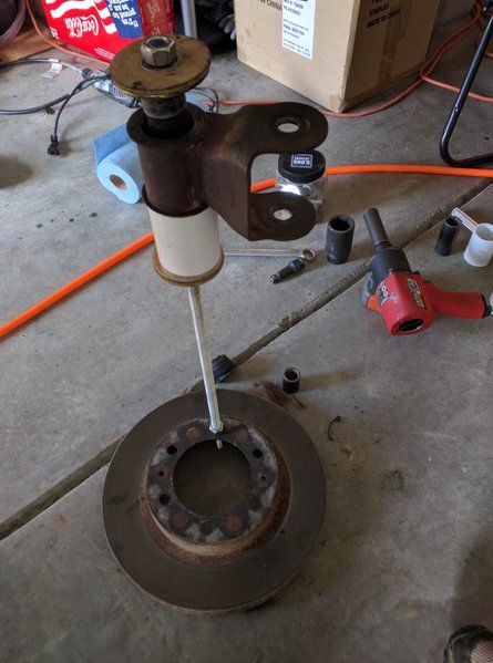

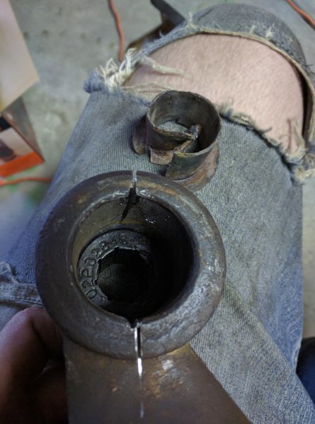

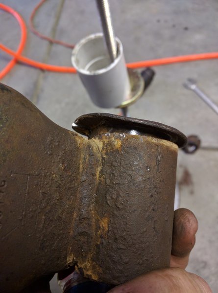

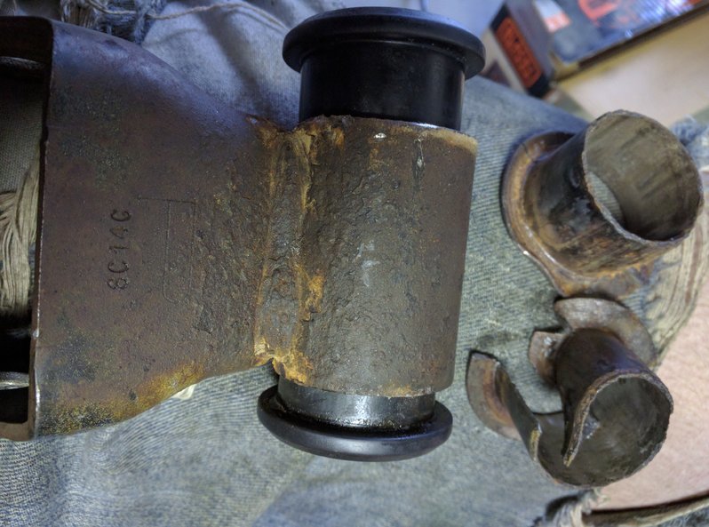

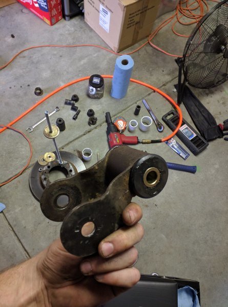

    Tackled this today. I used a redneck press to press out the rubber and inner sleeve, then cut slits in the flange with my Dremel then made a cut down through the sleeve with a metal cutting blade on my jigsaw, and finally hammered it out. The Energy bushings slide in by hand and the inner sleeve is a little tight so I put it back on the press with minimal pressure.
