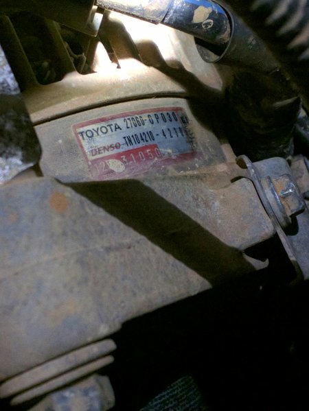

    '06 SR5 Off Road
    Soo... After I got back from my last trip home(to see my parents) I noticed my truck making a strange whining sound that was changed by engine speed. The whine is coming from the engine bay, not the speakers. @mrbedgood helped narrow it down to the alternator, plugged in whines, unplugged no whine, as such
    https://www.youtube.com/watch?v=hmPUUVwIJUU
    Here's the noise
    https://youtu.be/J0CyhCAW9fc
    Well, after considering costs of a Brand new alternator* - $341.97 (no core charge), Remanufactured alternator* - $182.79 (inc core charge), I am going to give it a shot myself for $40

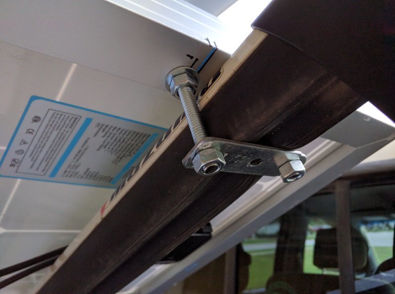

    '06 SR5 Off Road

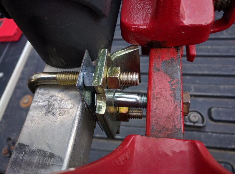

    My temporary maybe/probably permanent hilift mount. Superstrut ubolts from Home Depot.

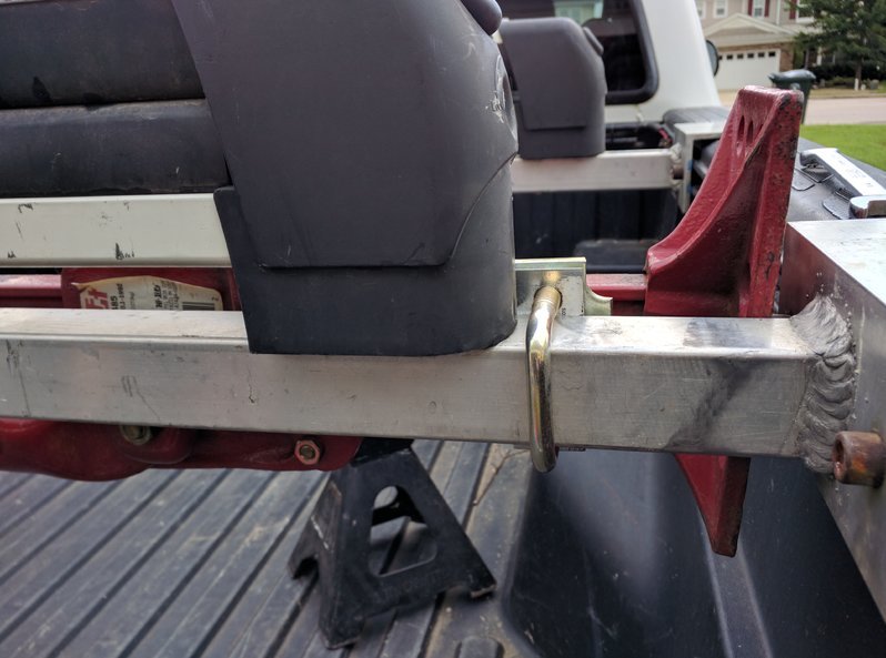

    Oct 26, 2010
    #45273
    36,066
    Tim
    Garner, NC/Boone, NC

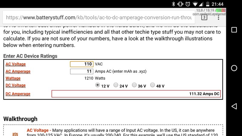

    '06 SR5 Off Road
    Trying to think through my inverter installation.. The 'house' battery will be in a battery box, with accessory charging connections, in the bed of the truck (passengerside). I want to keep the 12v wires short, and don't mind running longer lengths for the 110v wires, keeping amperage in mind*.
    With that in mind I need a waterproof, dust proof location that has ventilation to keep the inverter cool...

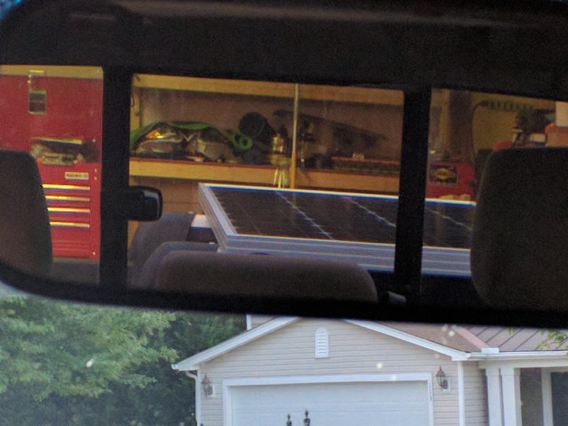

    '06 SR5 Off Road

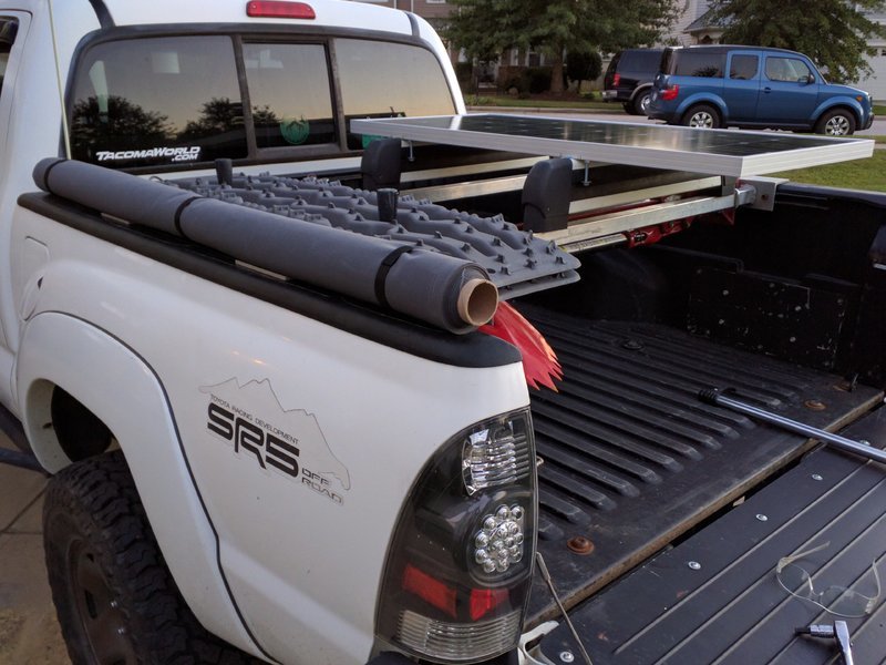

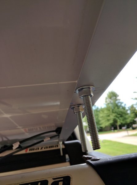

    100 Watts Solar Panel
    EricL, Crom, ChadsPride and 1 other person like this.

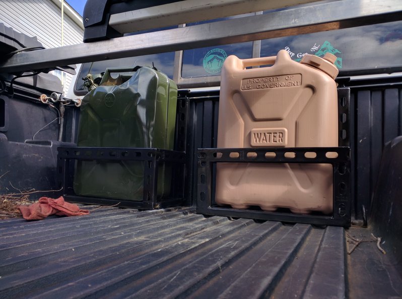

    '06 SR5 Off Road

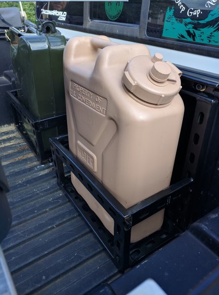

    Jerry can holders cleaned up and painted.

    '06 SR5 Off Road
    Jerry can holders mounted #expoprep
