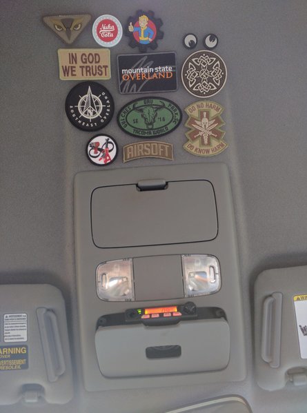

    I'm gonna redo my headliner in Black Multicam or something similar

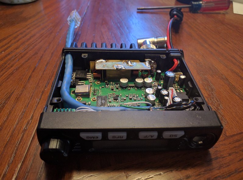

    Just need some filler and it's gtg! Anytone Smart CB

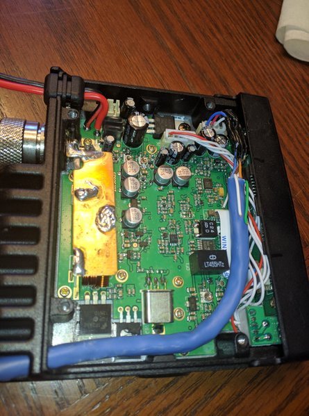

    Cat5-cb
    Blue-blue
    Orange-red
    White/green-white
    Brown-black
    OP1 Closed
    OP2 Open
    Minipcb1 20150925
    1541
    ChadsPride and Acerwin like this.

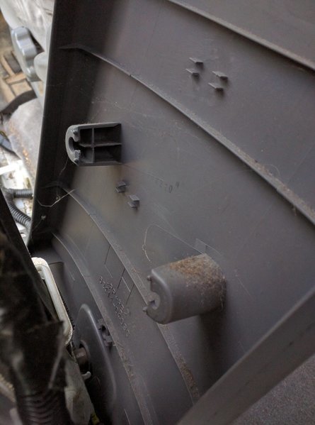

    Got some 0.060 kydex coming to fill in the gaps.

    Okay, the CAT5 CB is cool, but whats the purpose of connecting it with the ethernet cable?
