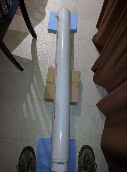

    About 2.5 gallons of on demand water

    My pipe details are personal.

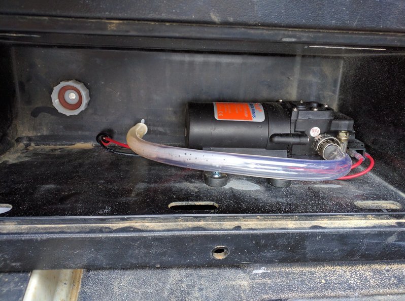

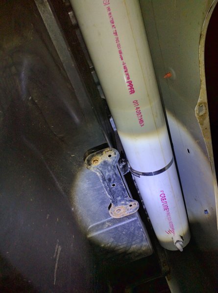

    I just need a short hose and sprayer

    Good idea on the on demand water. And +1 for using that unused space under the bedsides. :thumbsup:
    I've been contemplating doing a potable water tank for some time...

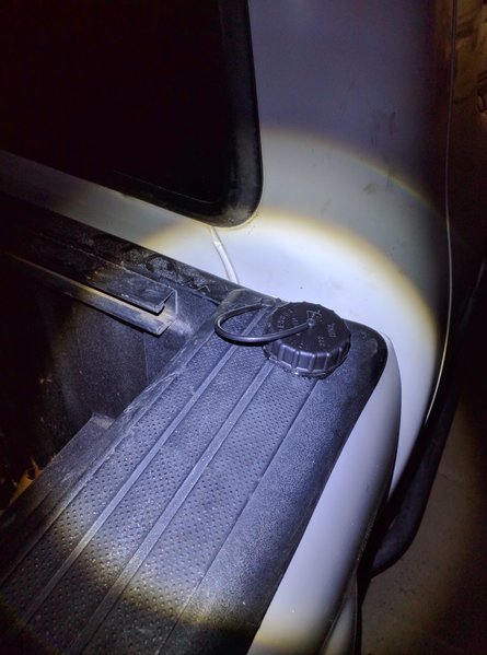

    I've been wanting to do it for a while. I about threw out the idea altogether because I wasn't going to be able to have as much water as I'd planned. So as it is it should be just short of 3 gallons, and easily refillable with a jerry can/bucket/garden hose. Hopefully with a little bleach and care I can keep this potable, but don't know that I would use it for that.

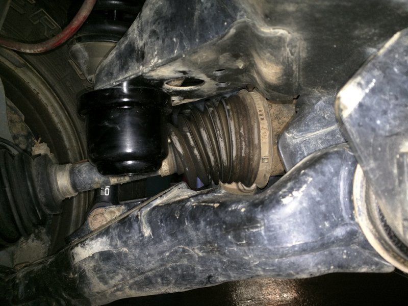

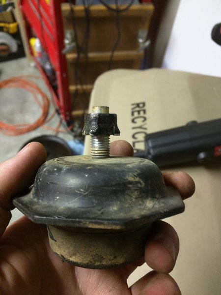

    Incase you were wondering how strong the welded nuts are that hold the front bumpstops on.... They're not.. Idk if this happened during frame swap or not. Also it's 44* and raining...
    *the passenger bumpstop was loose, unscrewed it by hand.

    Cut down one of the supplied 8mm Allen keys to about 2" and threw an 8mm socket on it. Easy job, easier if Toyota doesn't fuck shit up..Quick dig through my bucket of tetanus and found a 6pt nut that fits(14mm)

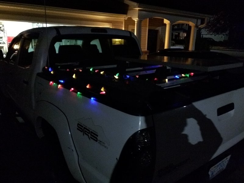

    These bad boys are solar! Haha solar Christmas lights!
