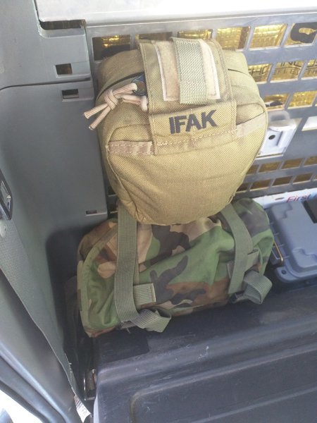

    @mrbedgood got me a military field bag for my recovery straps. Got the IFAK bag from another member. Storage solutions, molle, surplus

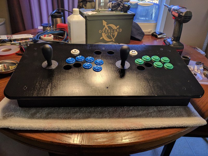

    Arcade progress

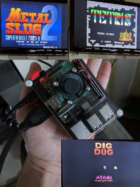

    Arcade finished! Now I can play all the Pac-Man that I want.
    $11 - Drill bit
    $17 - 1/2 Birch plywood 2'x4'
    $37 - HDMI and other cords/wires
    $53 - Raspberry Pi 3, power supply, case, heatsinks, and fan
    $56 - Joysticks and buttons w/micro switches
    $174
    Priceless -
    reliving childhood memories and being super badass

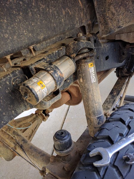

    Fedex just brought me some work to do. Looks like OME updated the included hardware for the dust boot. The old was metal, the new is plastic.
    mrbedgood and ChadsPride like this.

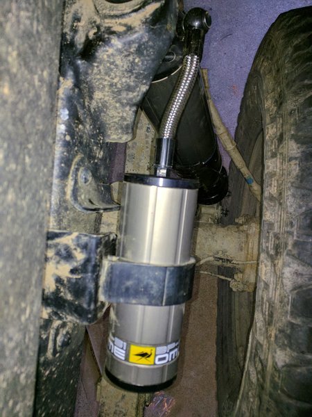

    Crickets in here when there's work to be done? Out with the blown and in with the new. Also got 2 screws in my tire.

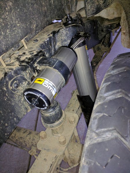

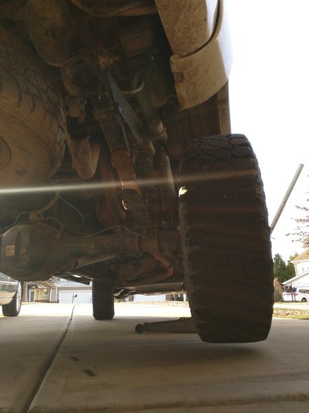

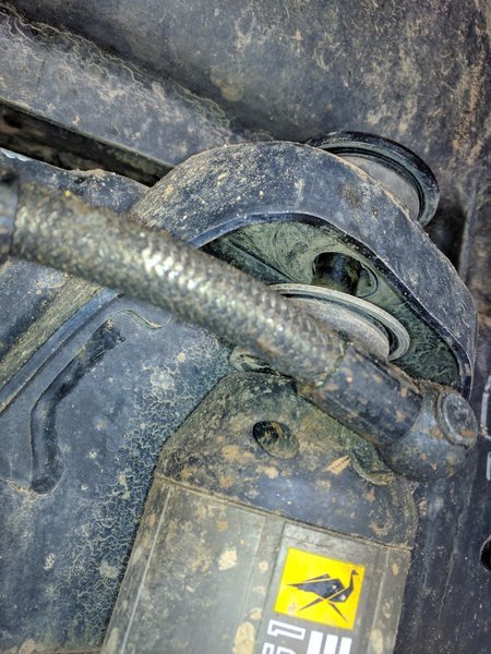

    These two shots show that the rear shocks are too short for my suspension. The tire is off the ground, leaf springs fully extended. The top shock but is off and there is about inch+ gap, note bushings aren't compressed either. ARB/OME asked for specifics of my truck as far as daily carrying load and offroad usage. I also provided custom leaf pack layout. They said there were no problems and replaced the shock. I will continue to have them warrantied until they won't.
    @Crom thought you might like the angles.

    One inch isn't so bad. Glad they replacing it under warranty. :thumbsup:

    Might be more if I loosen up my shackle bolts ;)
