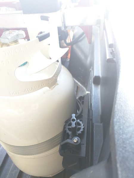

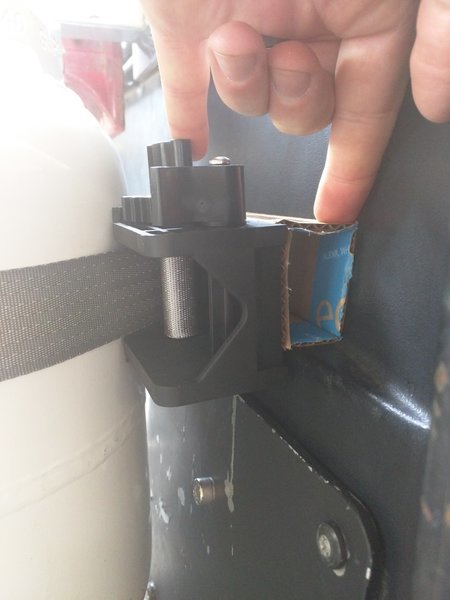

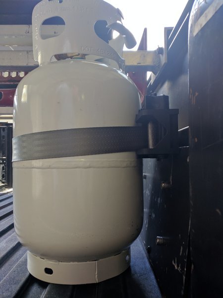

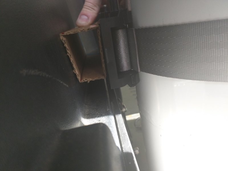

    How do I make this work, mount flat bracket to slanted bedside..
    (cardboard assisted design)

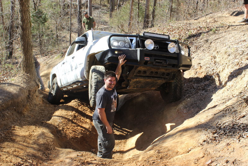

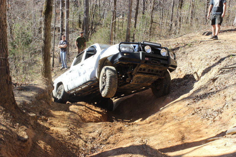

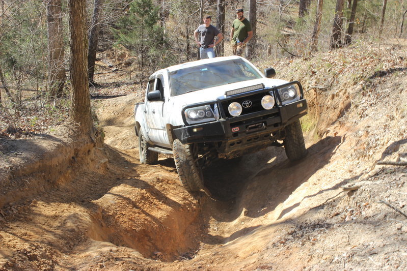

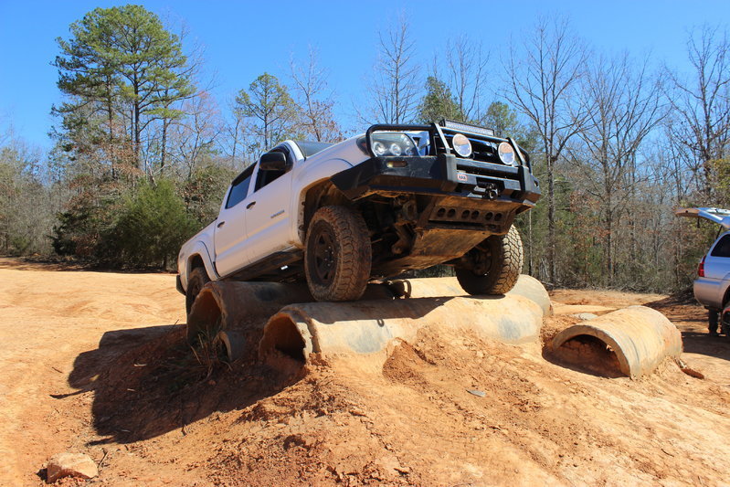

    Gulches pipe garden #actionshots
    Credit PvilleJohn

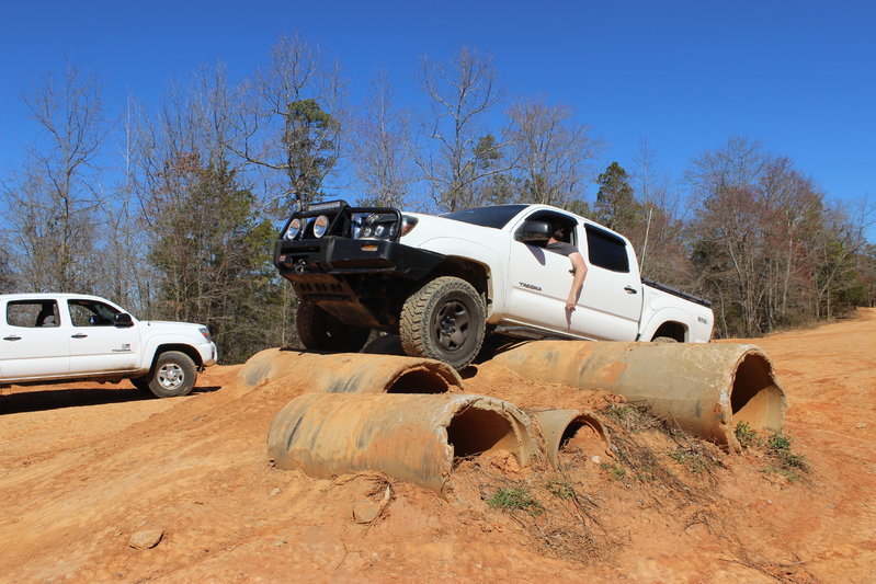

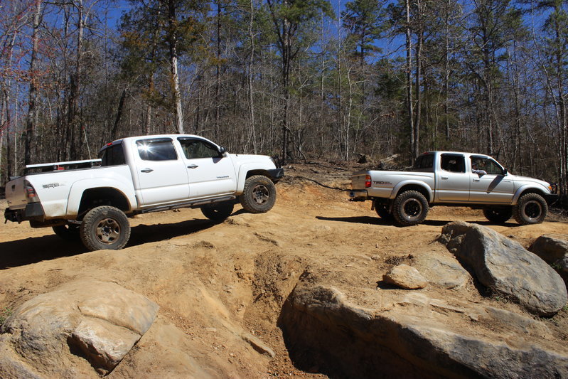

    Winching @misdirection1982 through part of Ship Wreck, propped against a tree.
    Somewhere at gulches? #actionshots
    IMG_4634.jpg IMG_4684.jpg IMG_4632.jpg IMG_4627.jpg IMG_4629.jpg IMG_4628.jpg IMG_4631.jpg
    Credit PvilleJohn

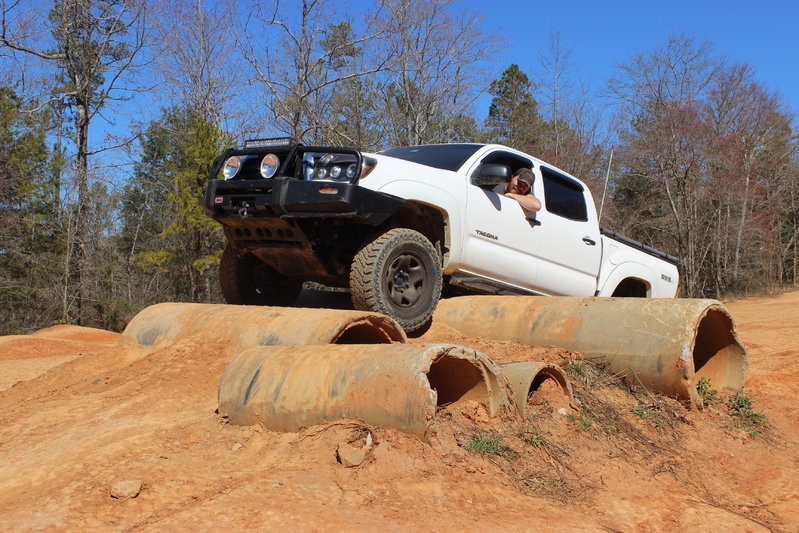

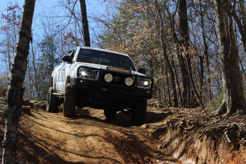

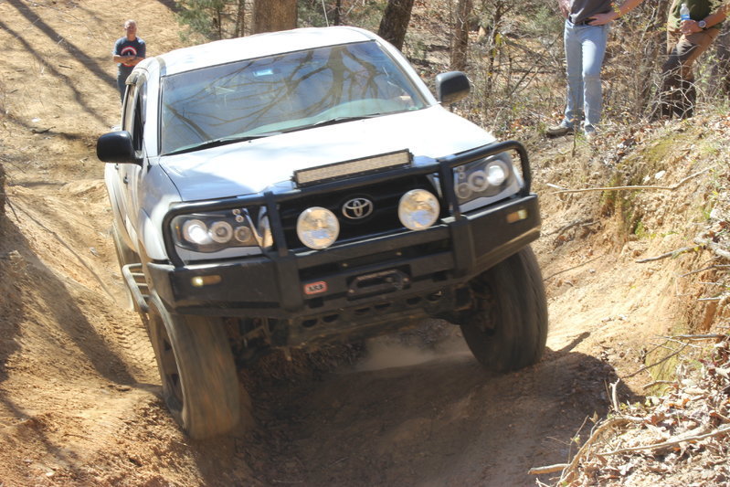

    Gulches trail 28 #actionshots
    Credit PvilleJohn

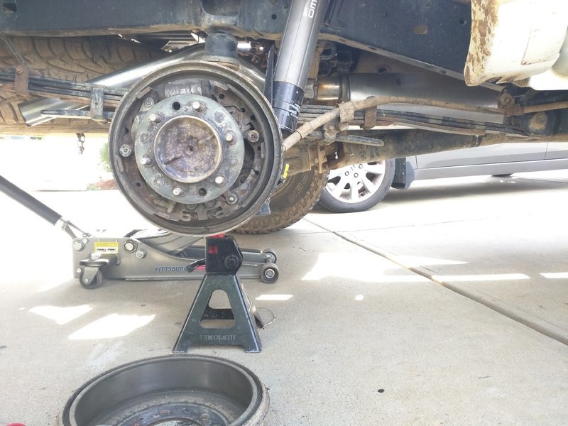

    The parking brake this weekend went all the way to the floor.. I'm not sure what's up with it yet, it was weak before and would only hold the truck still at a complete stop(just barely) but there was more tension on the pedal. Everything seems fine on the passenger side. The splitter under the shifter cover is pulling more on the driverside and not much at all on the passenger side.
    Also look at the awful bend at the front of the leaf pack..

    Parking brake works... And subsequently the rear brakes work better. I had to adjust the star adjuster on the driverside, a lot. I guess last time I had them apart I didn't adjust them far enough.

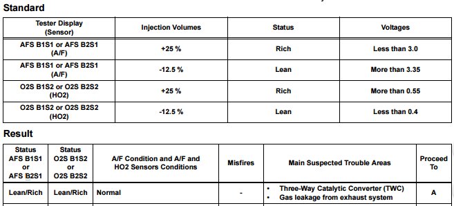

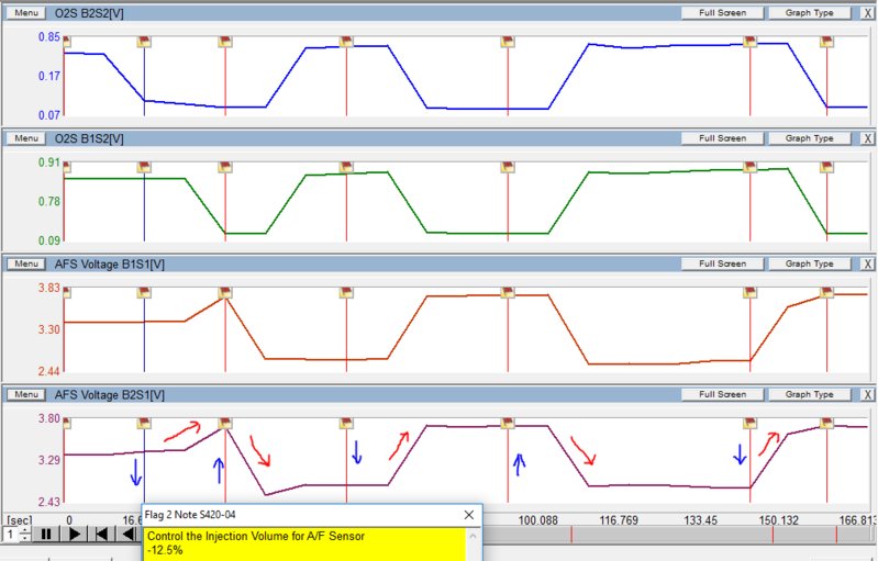

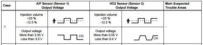

    Friday I popped a P0430 CEL... I had the exhaust done on Feb 22, should have seen it come up before now... Went to Gulches ORV park and didn't get the code there and back... I got an alignment Mar 1... and the morning of Mar 3 I get a CEL code... An alignment and CAT inefficiency are completely unrelated... but it's a damn convenient coincident...
    Enough conspiracy... Here's some data. It looks like I may have an exhaust leak
    Test
    (a) Connect an intelligent tester to the DLC3.
    (b) Start the engine and turn the tester ON.
    (c) Warm up the engine at an engine speed of 2,500 rpm for approximately 90 seconds.
    (d) Select the following menu items: DIAGNOSIS / ENHANCED OBD II / ACTIVE TEST / A/F CONTROL.
    (e) Perform the A/F CONTROL operation with the engine in an idling condition (press the RIGHT or LEFT button to change the fuel injection volume).
    (f) Monitor the voltage outputs of the A/F and HO2 sensors (AFS B1S1 and O2S B1S2 or AFS B2S1 and O2S B2S2) displayed on the tester.
    HINT:
    • The A/F CONTROL operation lowers the fuel injection volume by 12.5 % or increases the injection volume by 25 %.
    • Each sensor reacts in accordance with increases and decreases in the fuel injection volume.
    Recorded Data
    Standard Data and Test results

    Fog machine is cool and all, but why not just get under and feel while someone else holds a rag over the end of the exhaust (i'll volunteer), I gotta wonder of the torquing of the engine didn't crack a pipe or weld, is there not a ball socket somewhere in the exhaust to allow for rotational movement on the factory exhaust ? ( the spring loaded bolts are the clue here )
    At that, your leak is going to be in the converter or before area, thats a lot of smoke to push back thru the cats
    your O2 is picking it up before the secondary cat, air fuel sensor is before the main cat
