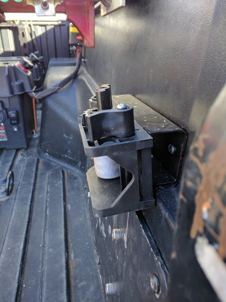

    I'm happy with the fit, and low profile finish with this Quickfist Ratcheting strap

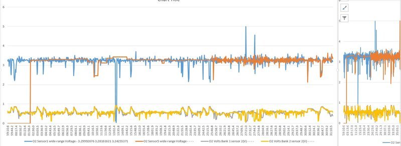

    Anyone see anything wrong with these 02 readings?

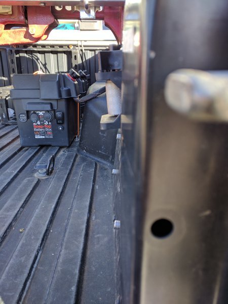

    Bed lights, water pump, other stuff in the bed.

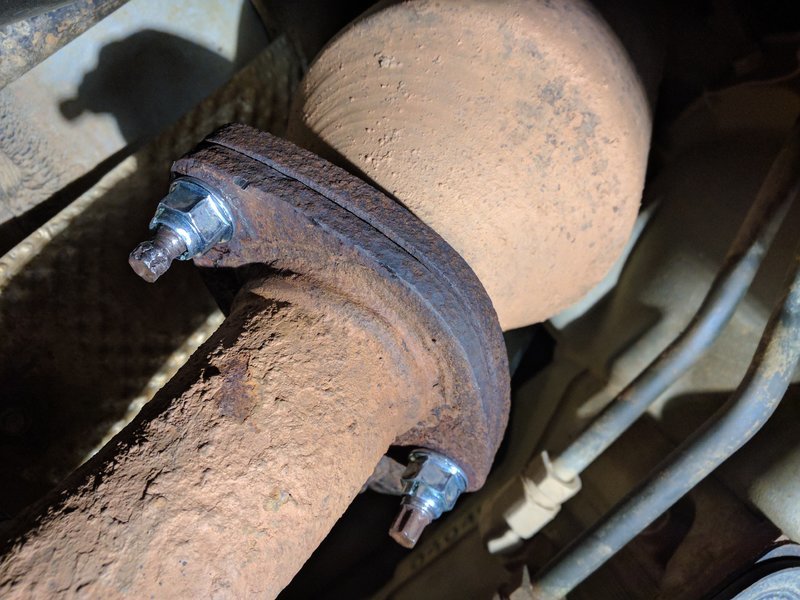

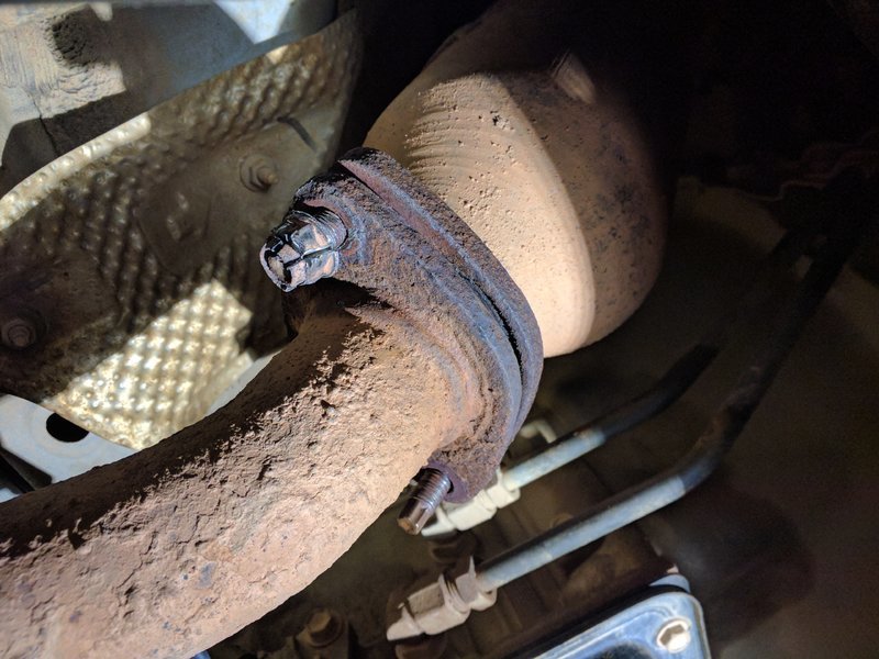

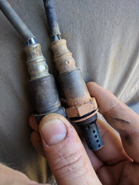

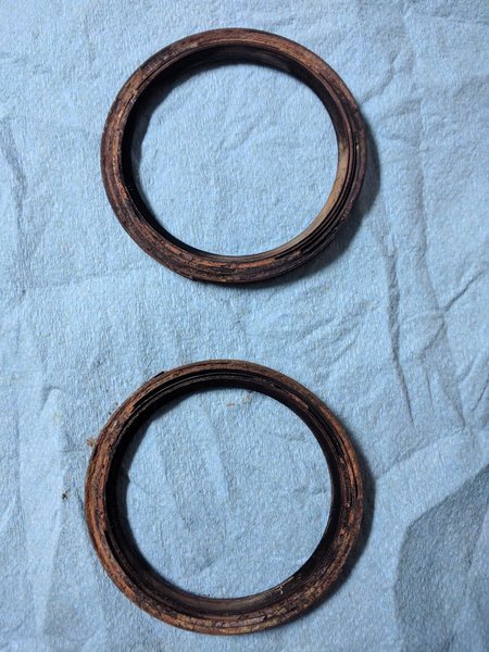

    After lots of diagnostic and studying graphs, I determined either I had an exhaust leak or the driver CAT was bad. I found an exhaust leak right in front of the driverside lower O2 sensor. I've had a set of gaskets I ordered from URD a few years ago, mistakenly thinking they were for the y-pipe to muffler pipe connection.
    Let's see if this clears up my P0430 code. Initial graphs show a huge improvement.
    I started by testing all the o2 sensors and swapping them left-right.
    New URDusa exhaust gaskets http://urdusa.com/store/p1260519127/URD-Exhaust-Collector-Crush-Gasket-(each)/product_info.html
    Fighting with old studs and nuts
    Picked up new nuts and studs from Toyota $15 for 4 of each, didn't use the new studs
    Old gaskets
    Crom and Bsheriff11 like this.

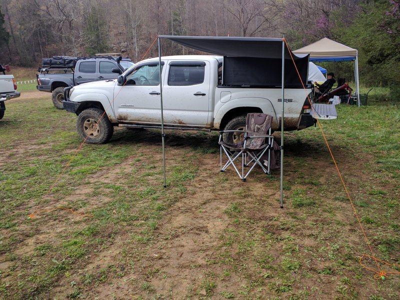

    It's just a piece of Duck Canvas that I sewed a channel in to slide an aluminum bar into to mount it to the truck. Then sewed the edges on, and added grommets for the poles.

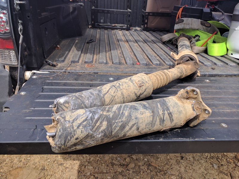

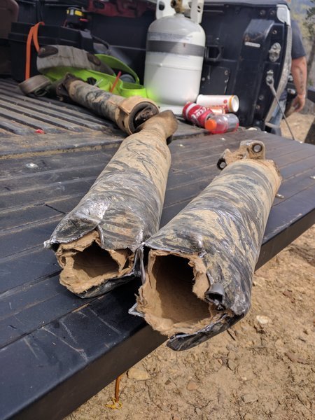

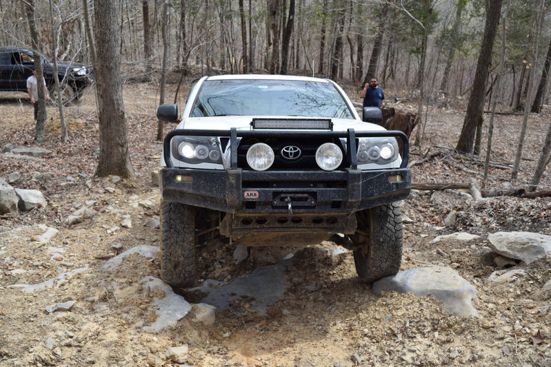

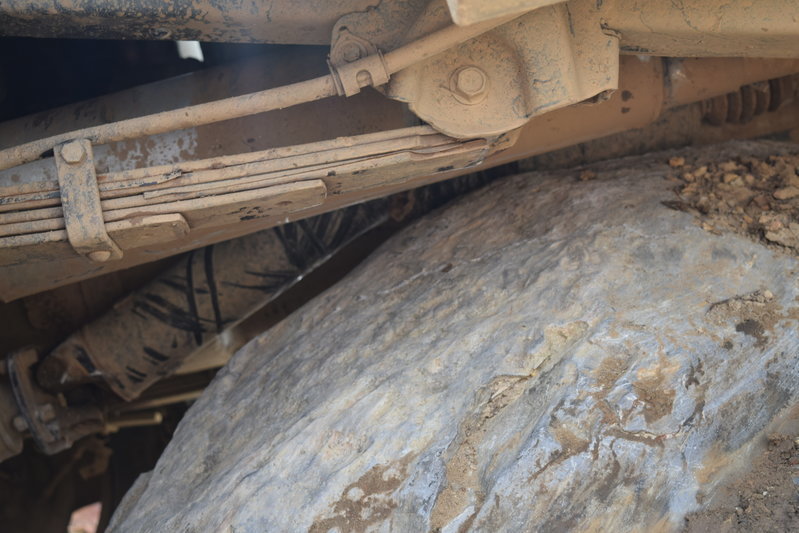

    Adventure Offroad Park trail 21 probably shouldn't have been trying to do it. Busted my driveshaft good. #carnage #actionshots
