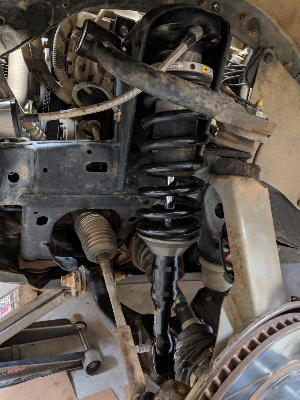

    A-A-ron is doing lca bushings or ball joints. I got the hefty Northern tool jack stands for when I pulled my front diff. I wanted something that I'd feel safer under the truck with.

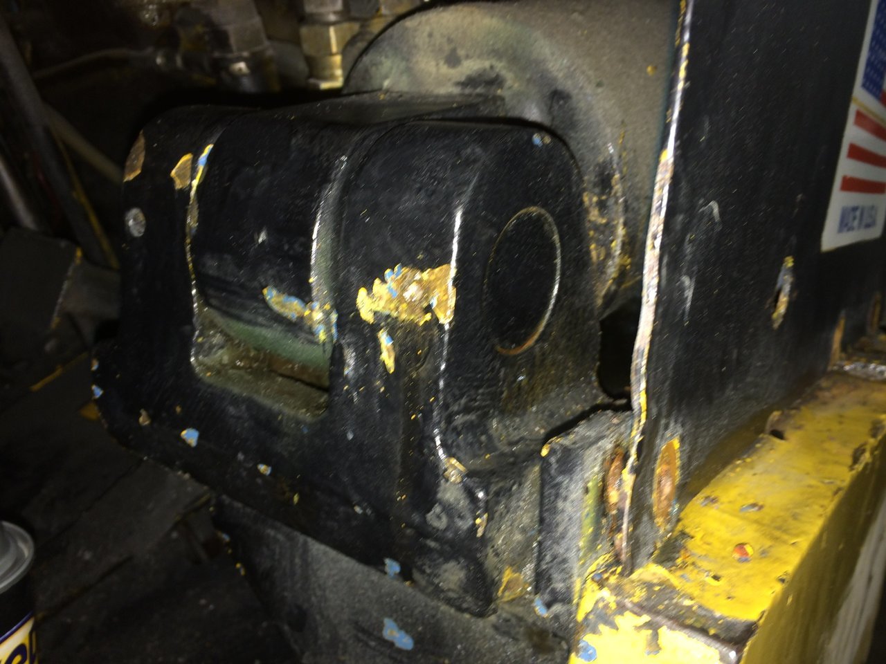

    Had my fun cutting this pin out this morning, cut each side of 1.5” pin then drilled out the right side, that chipped paint was a cotter pin that is corroded in the hole, drilled that out and still wouldn’t budge, burned all the paint off Friday heating with a torch, still no joy.
    My arms hurt, my hands hurt
    I need a cookie...

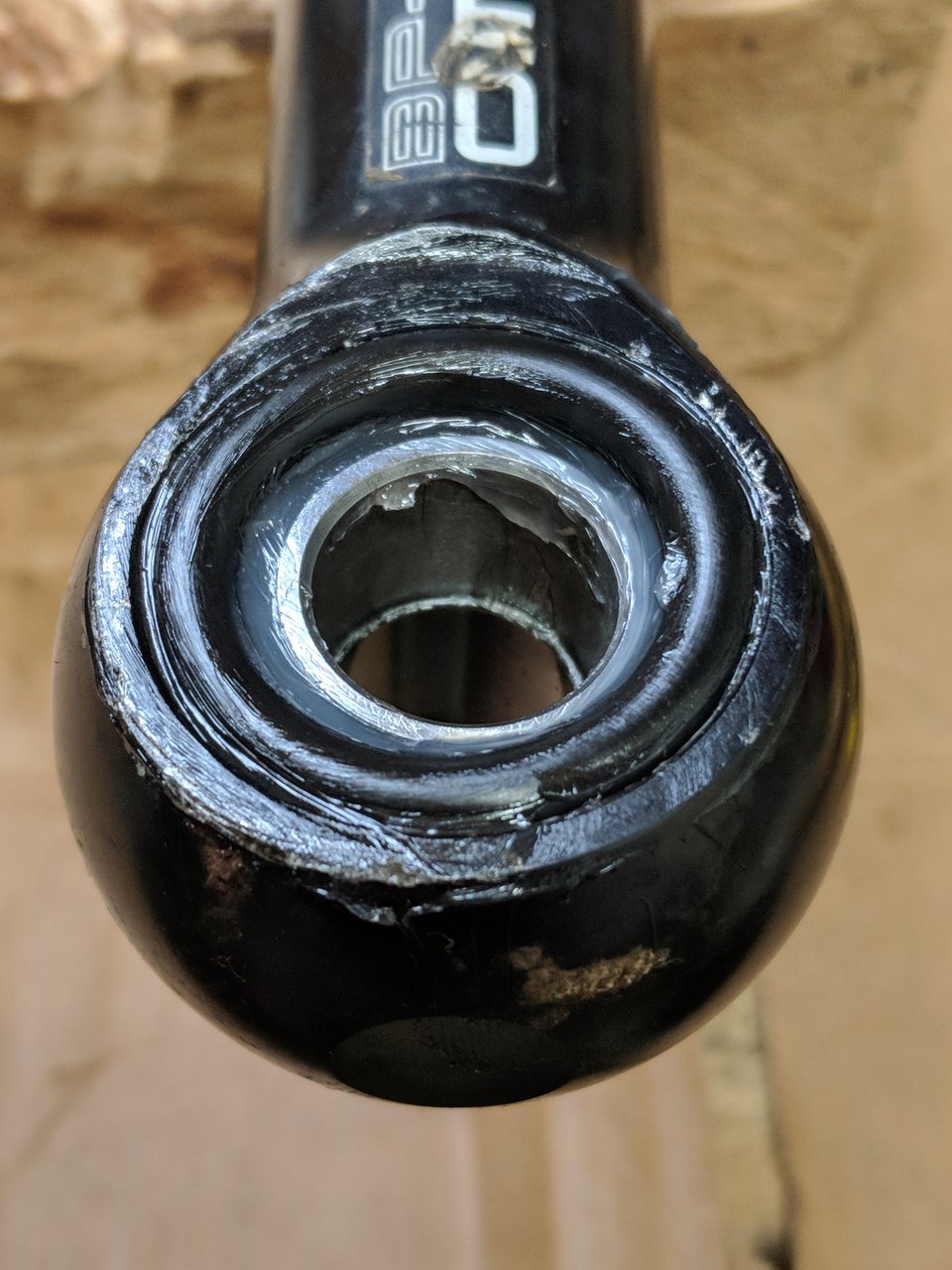

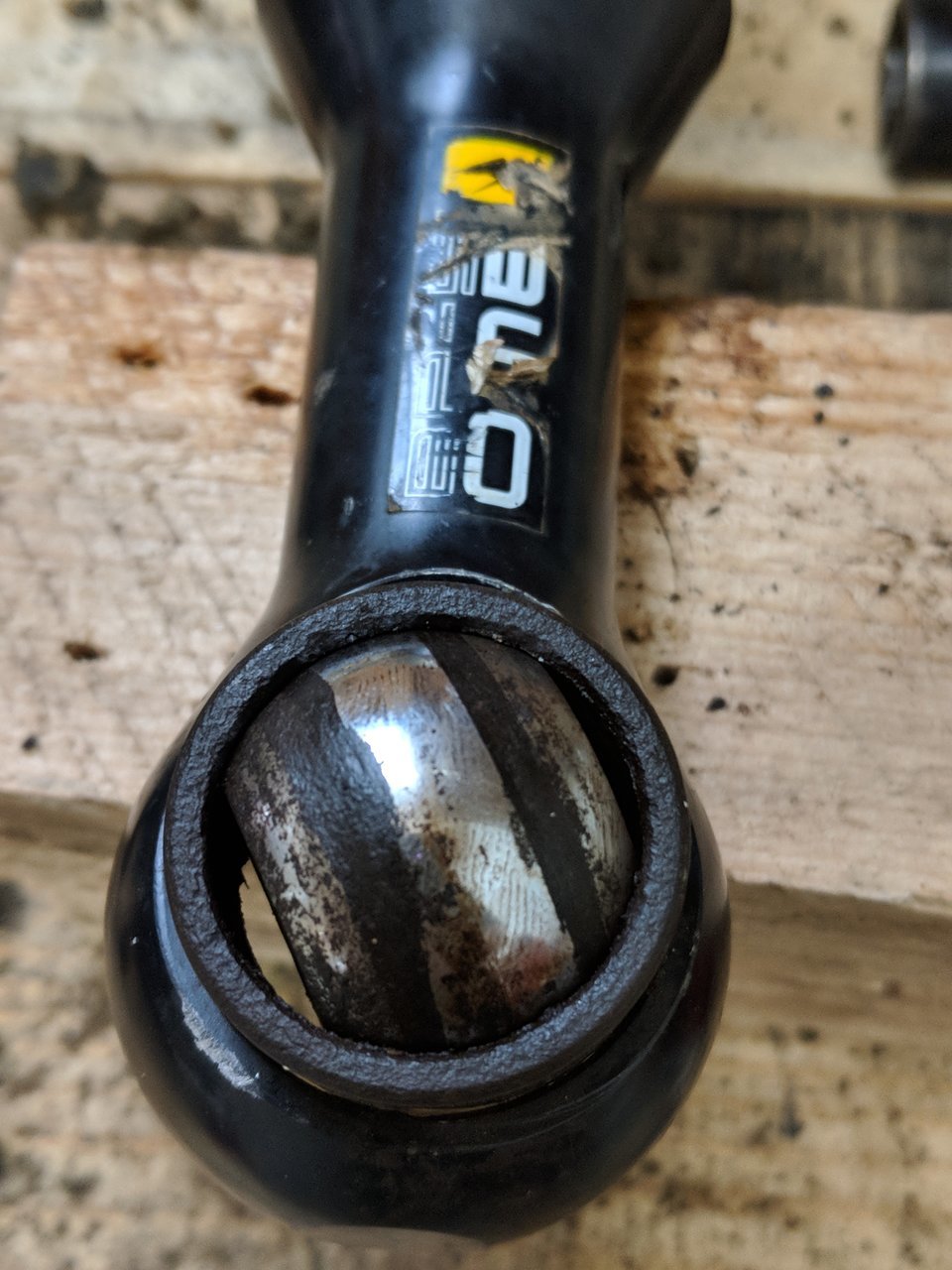

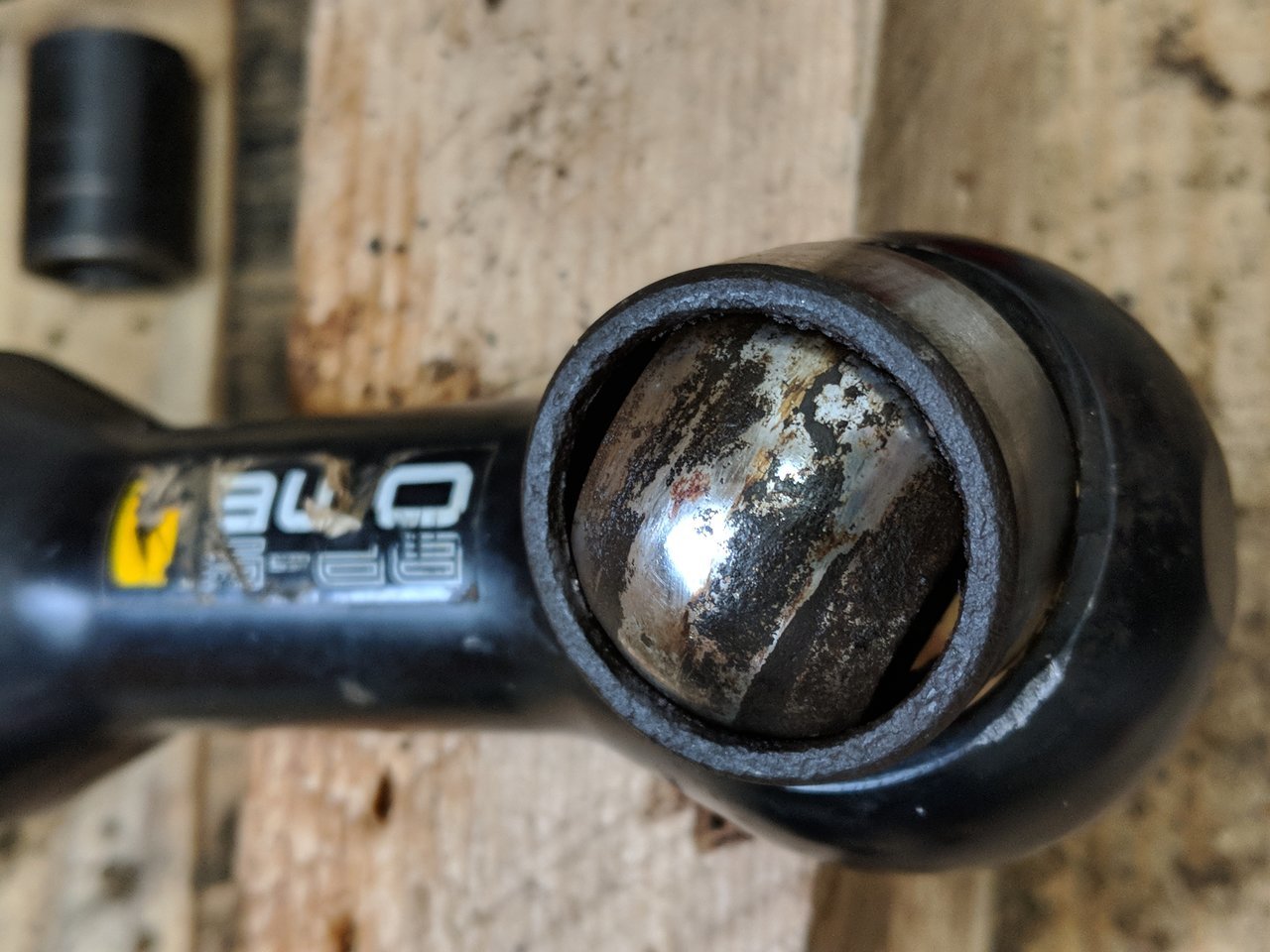

    Exhibit 1 crusty oring sealed spherical bearing

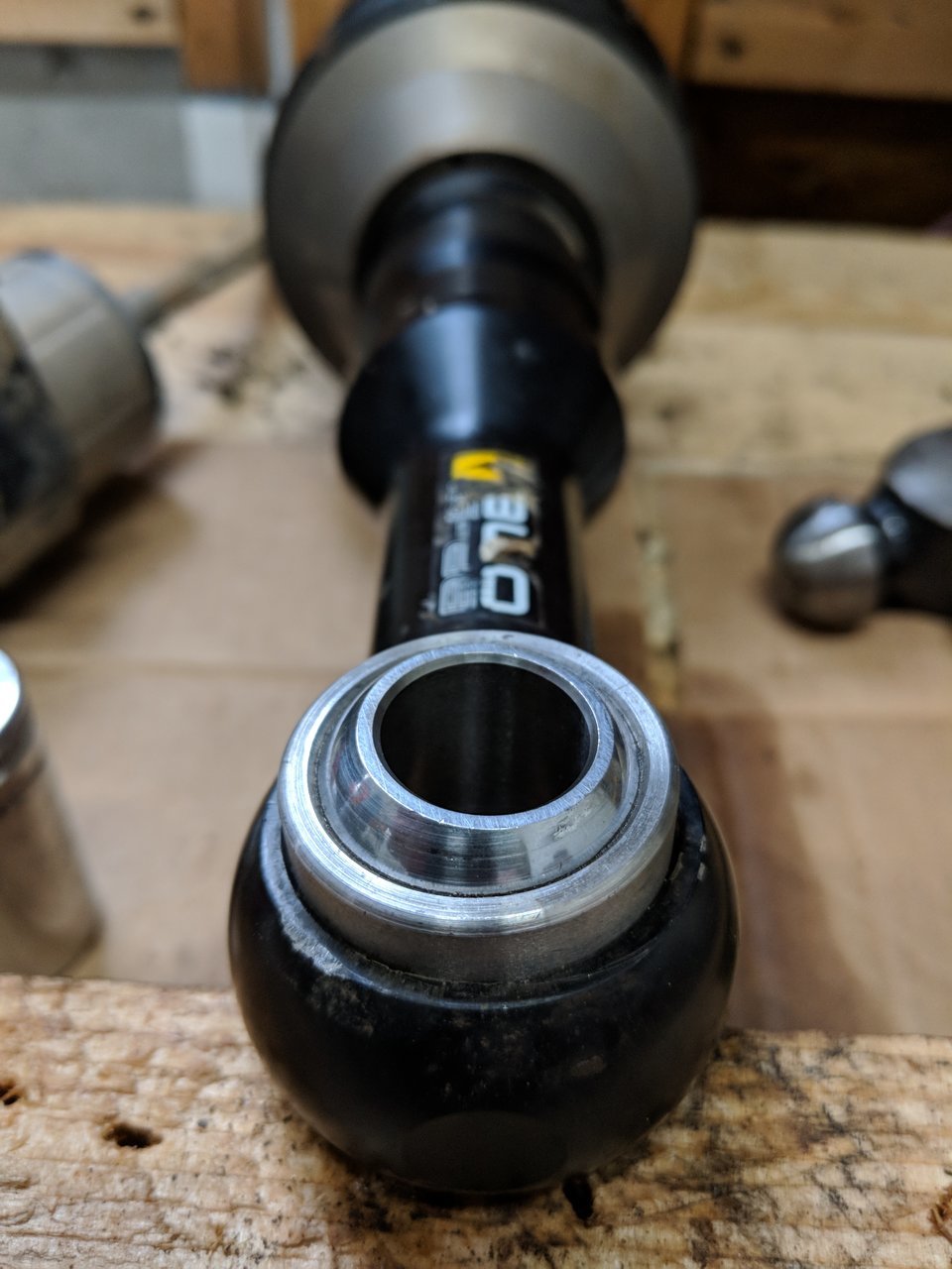

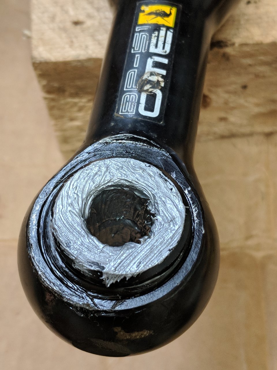

    Uncrustification

    Nice reclaim on those shocks. Cool that OME can get you those little odds and ends for them.

    Thanks. OME has been great to deal with, they didn't have them in stock because they were new but as soon as they did they sent them out.

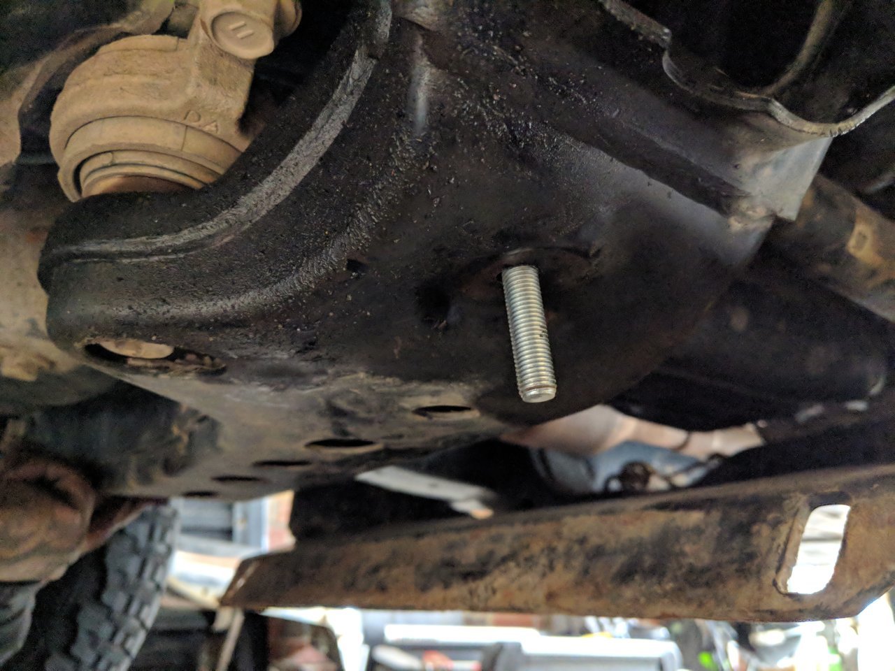

    216096 miles actually got around to changing oil, put SOS Concepts fill plates in, fixed rear IFS skid plate bolts. Knocked off the "welded" nuts off and put a bolt/nut in place.
