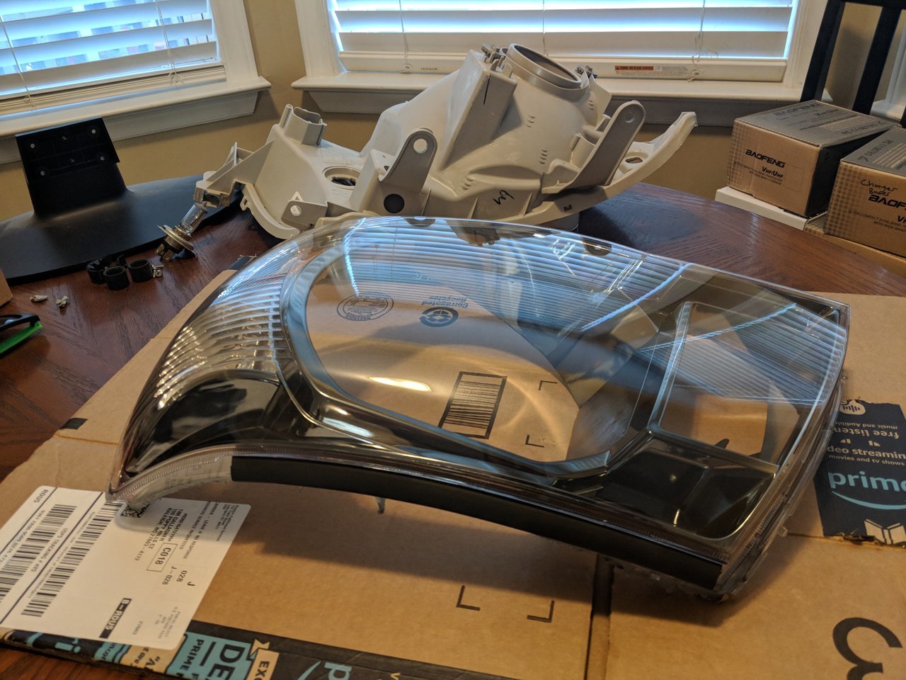

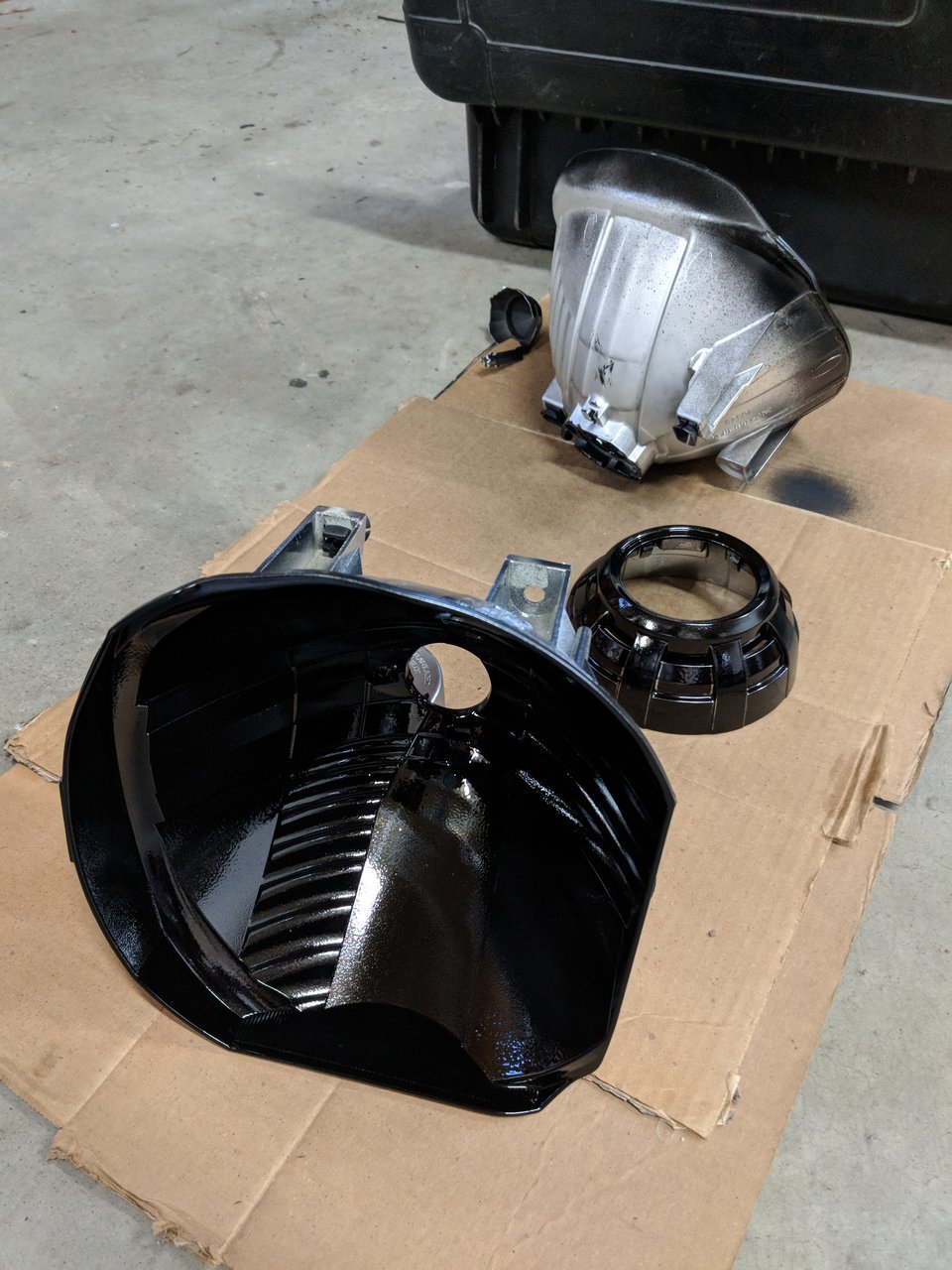

    After like 3 years I think it's about time to do some retrofits... Tried the TRS tip 270* for 7 mins but it wasn't quite enough so they went back in at 285* for 7 mins.

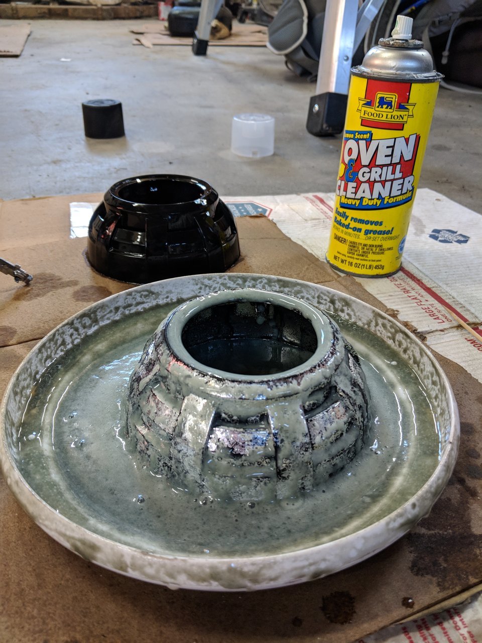

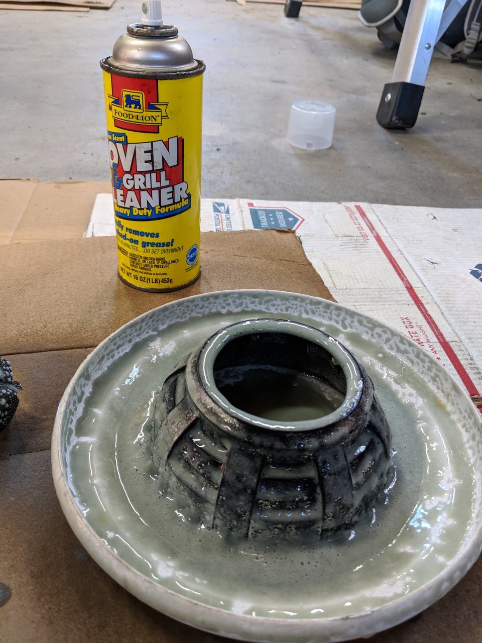

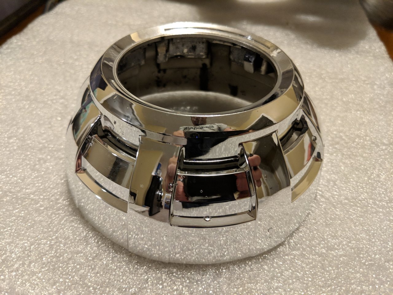

    Painted the reflector bowls semi-gloss black and attempted to paint the shroud with dupli-color Shadow Black chrome... That didn't turn out well so I stripped it which didn't hurt the chrome..

    Oven cleaner works great to strip chrome from plastic

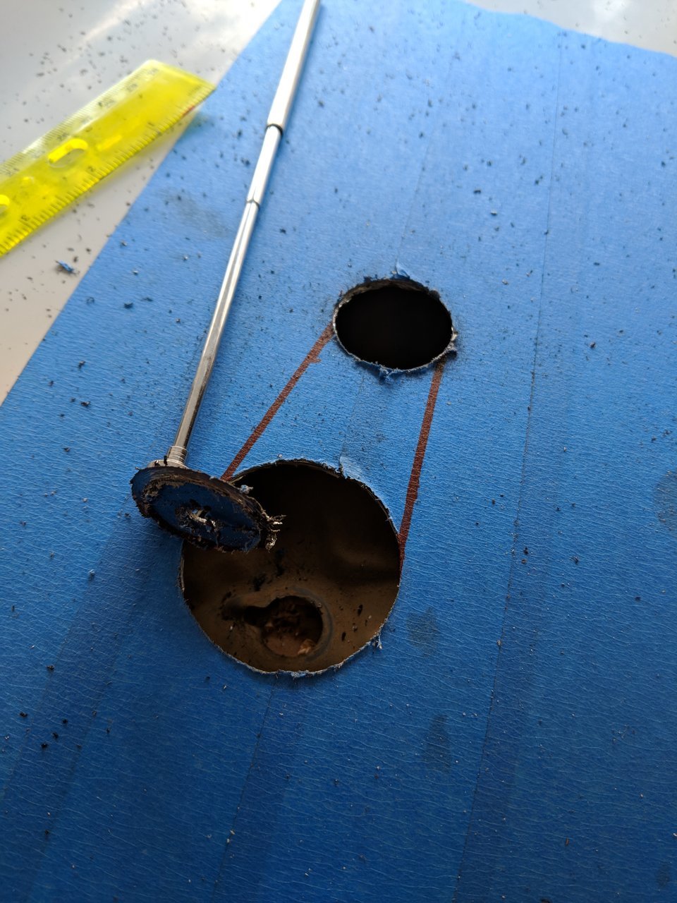

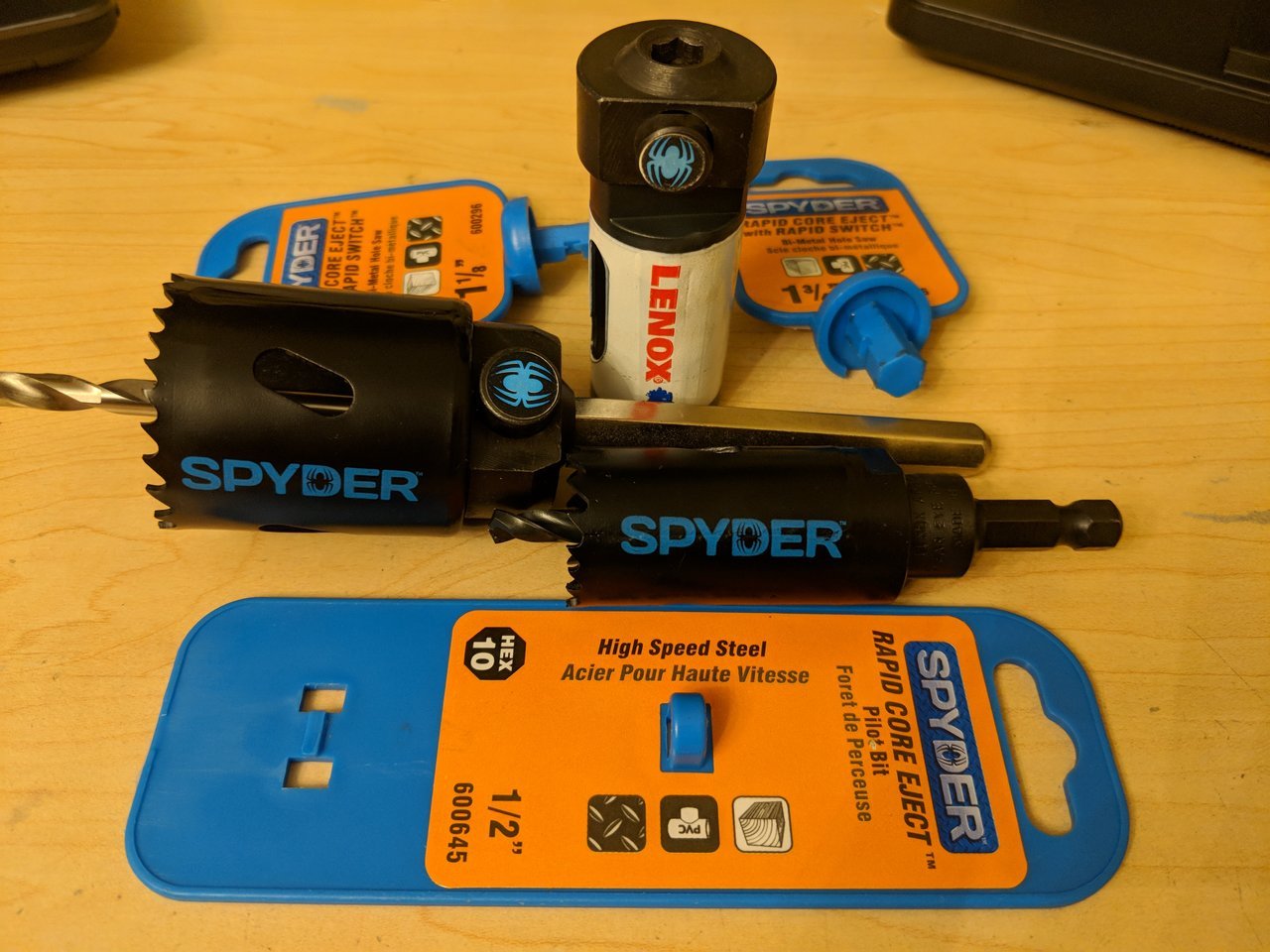

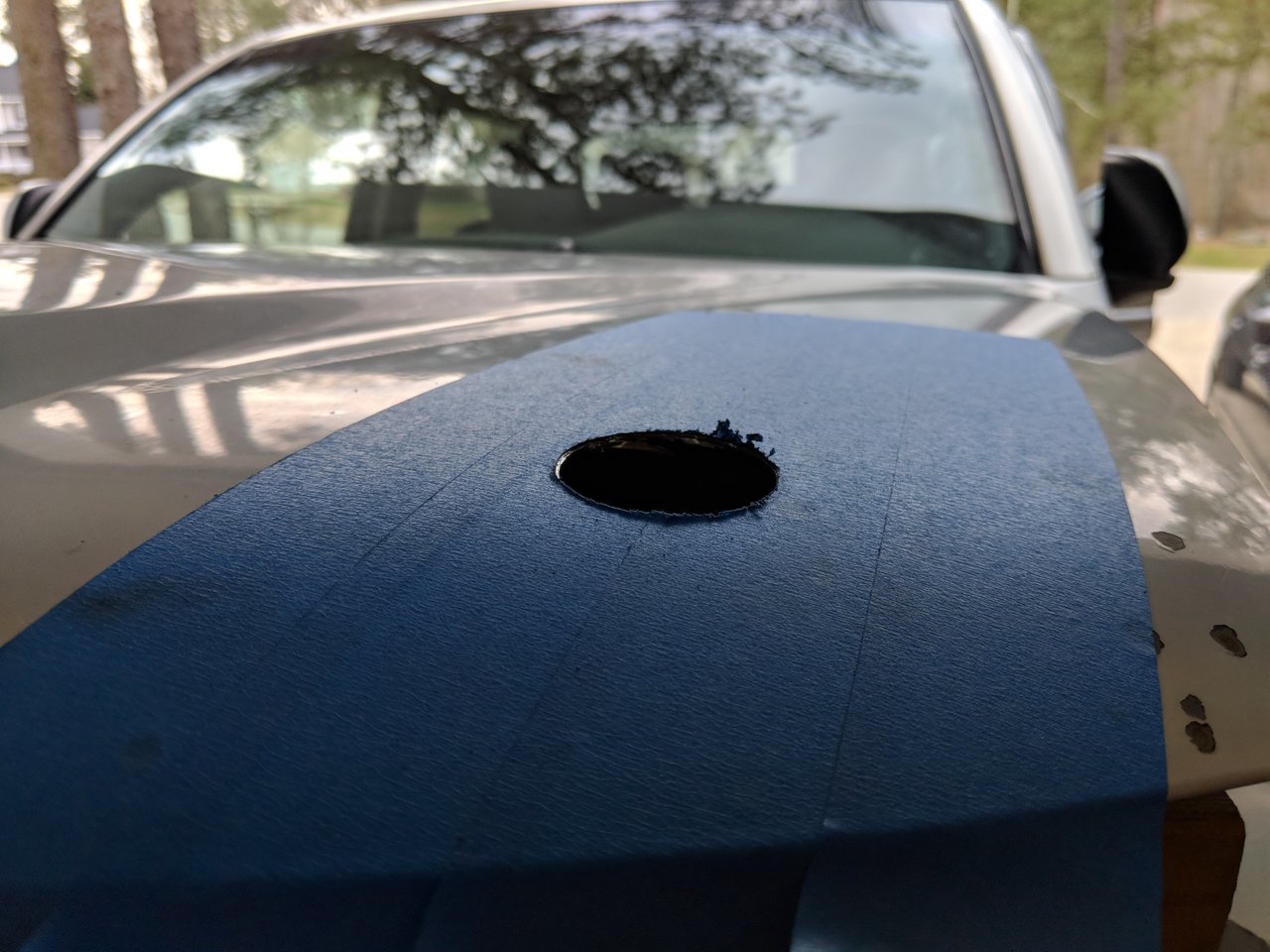

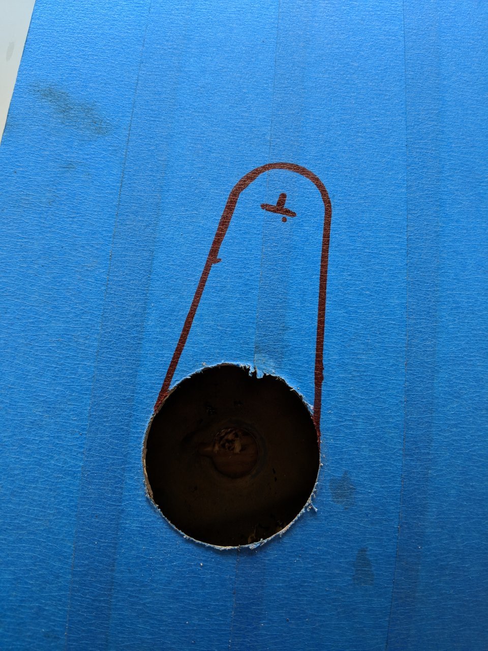

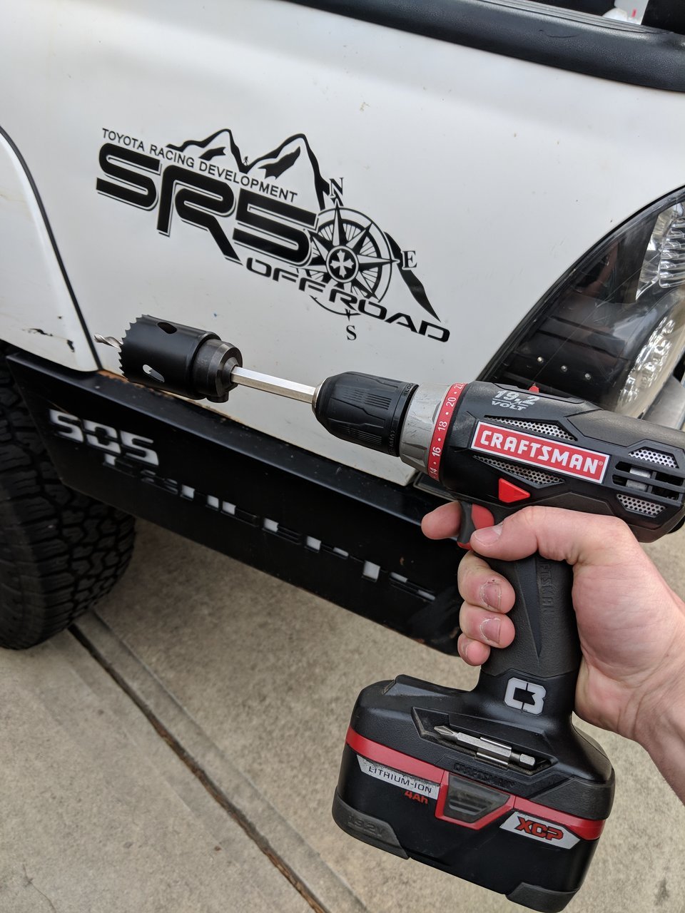

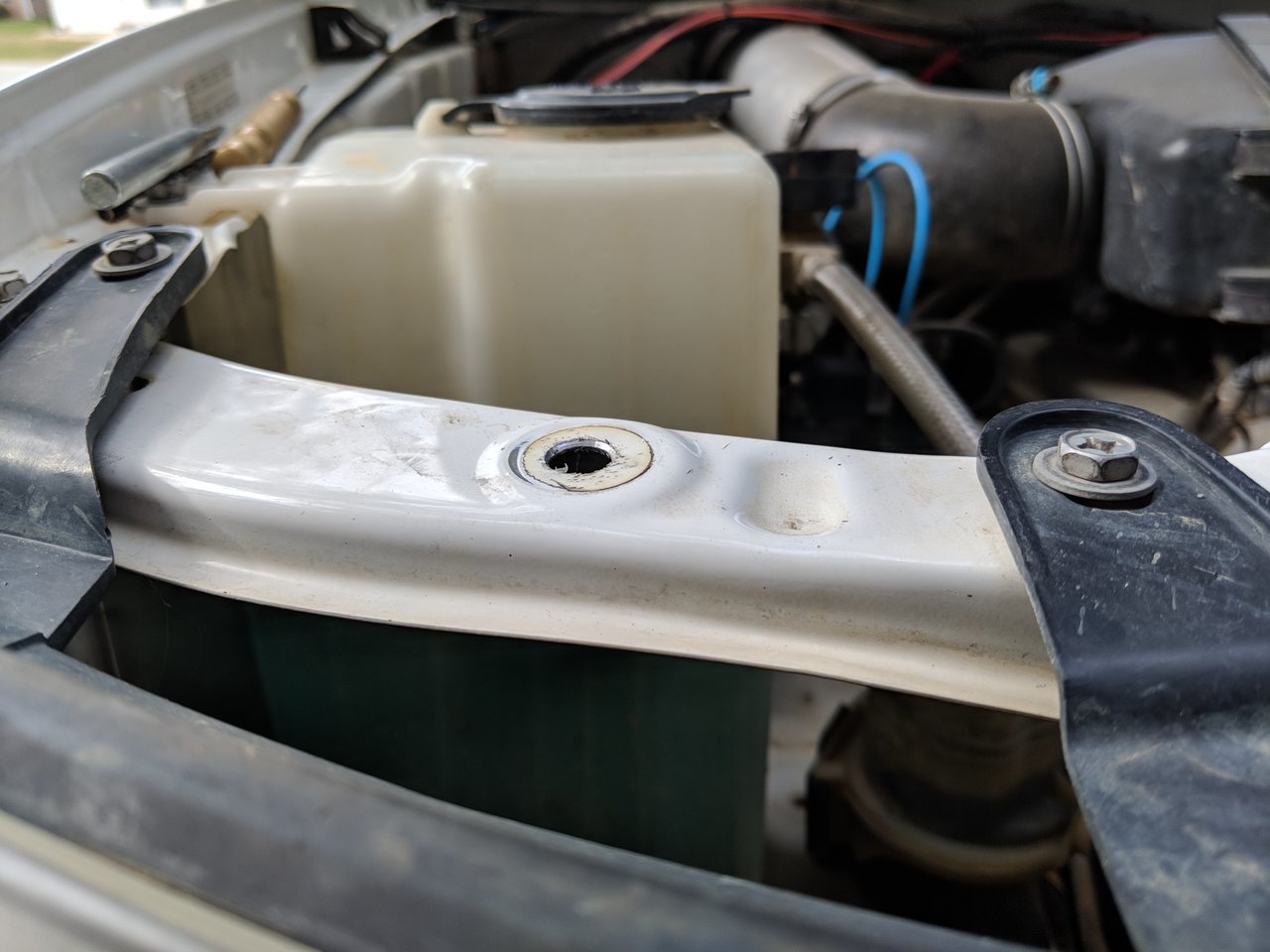

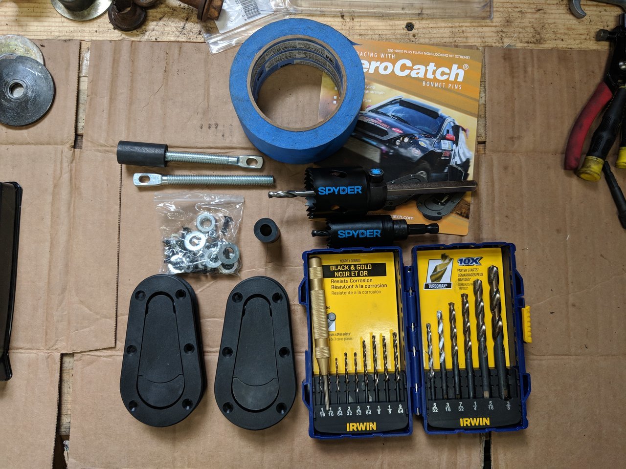

    Got the hole saws for my hood latches.. The large one uses a 1/2" Arbor and the smaller one uses a 3/8 Arbor.. Instead of waiting on Amazon again I just went to Lowes and got a Lenox and swapped the Arbor in. I may even swap it back and return it..

    Gonna drill some holes in my hood today

    Stripping the chrome to get better paint adhesion?

    Yep. The paint didn't stick for shit even with adhesion promoter

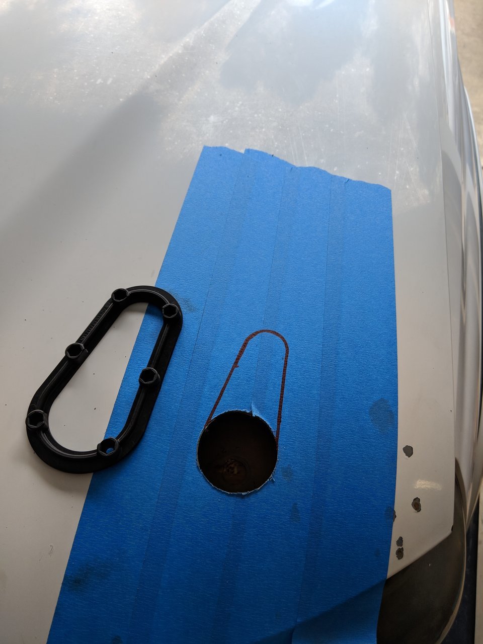

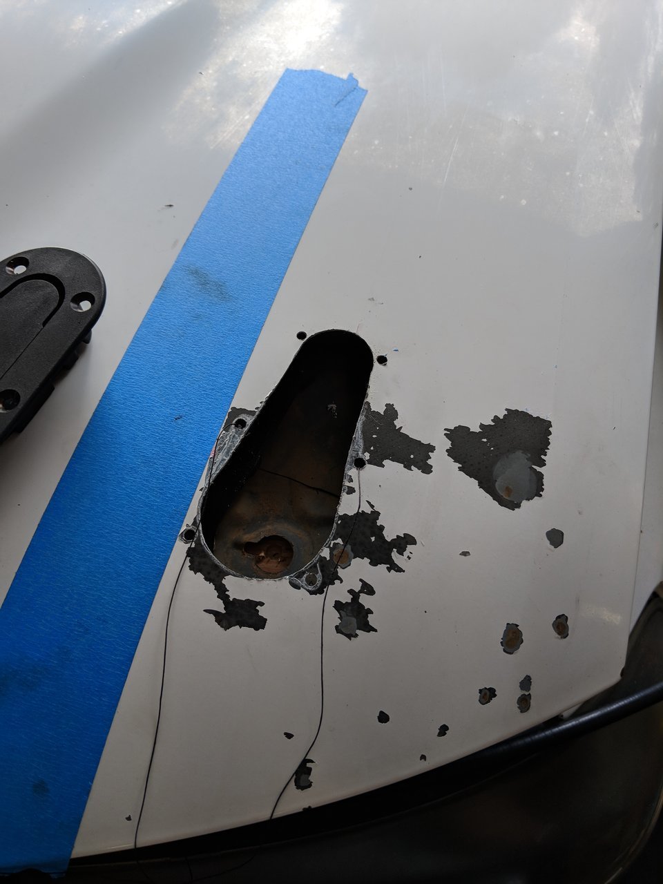

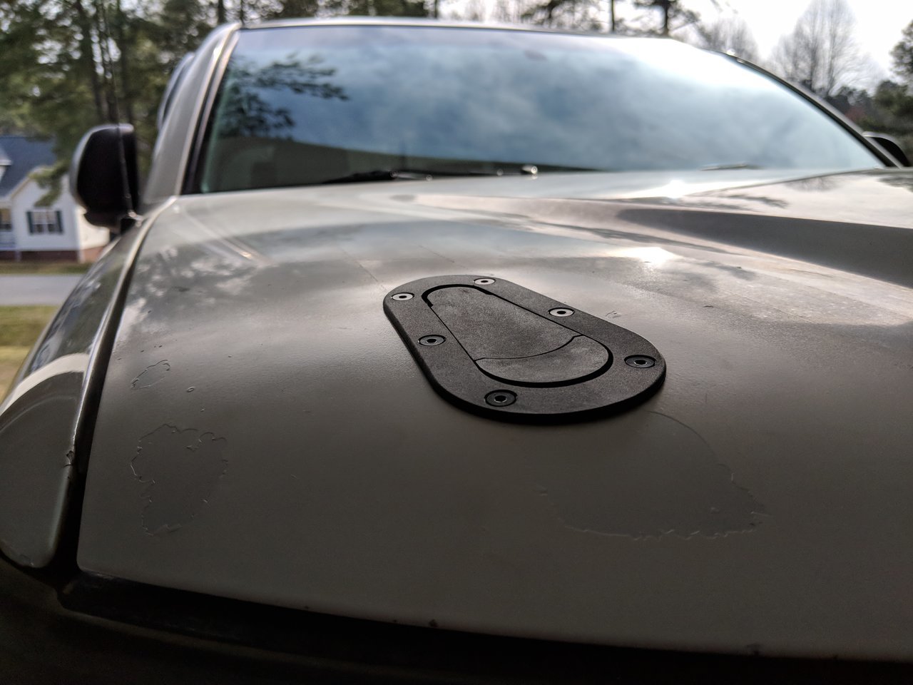

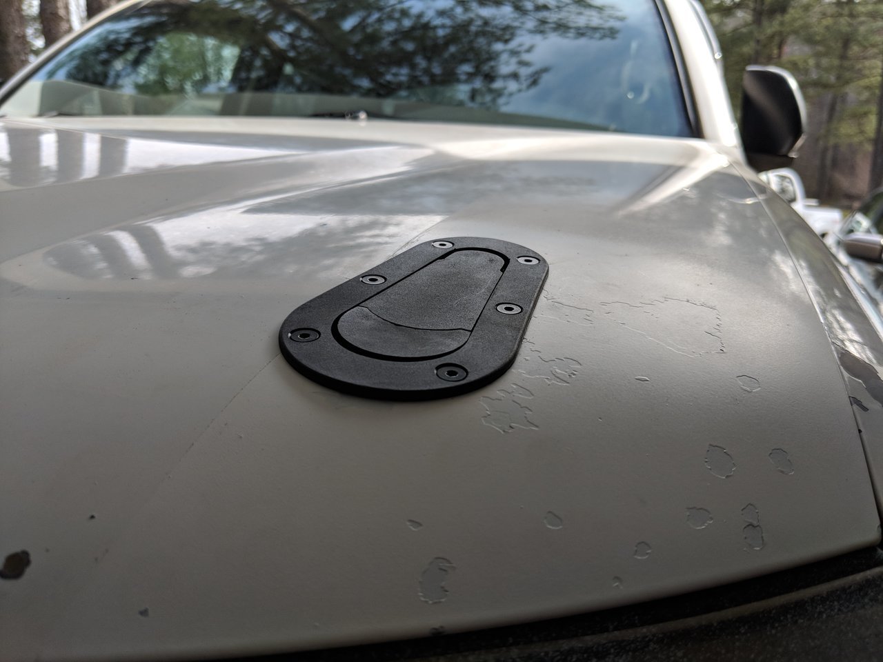

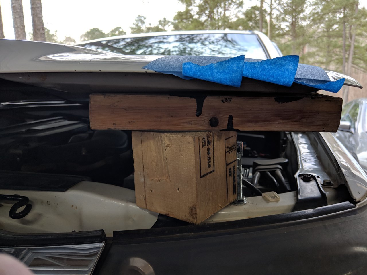

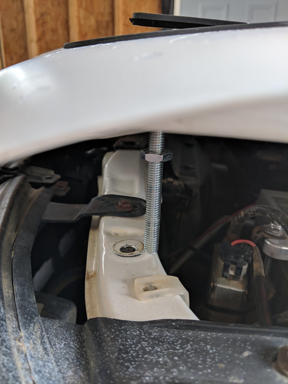

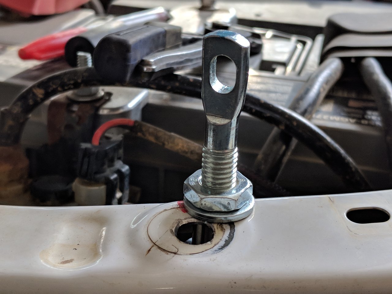

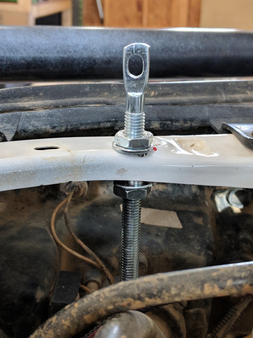

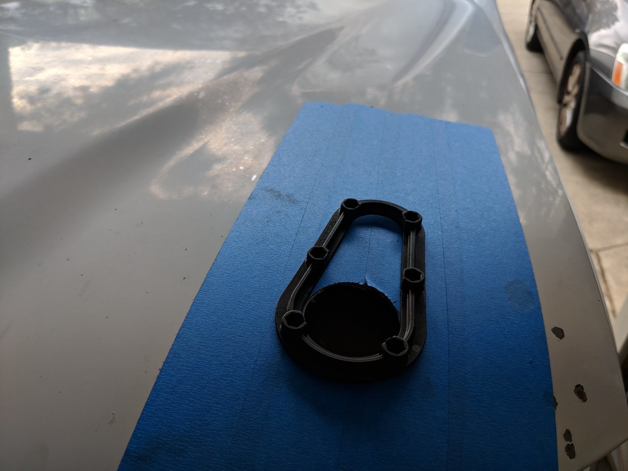

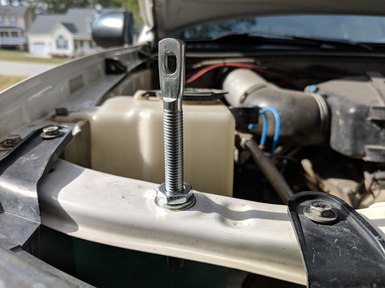

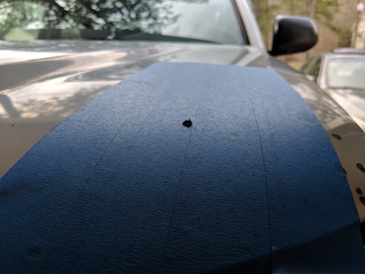

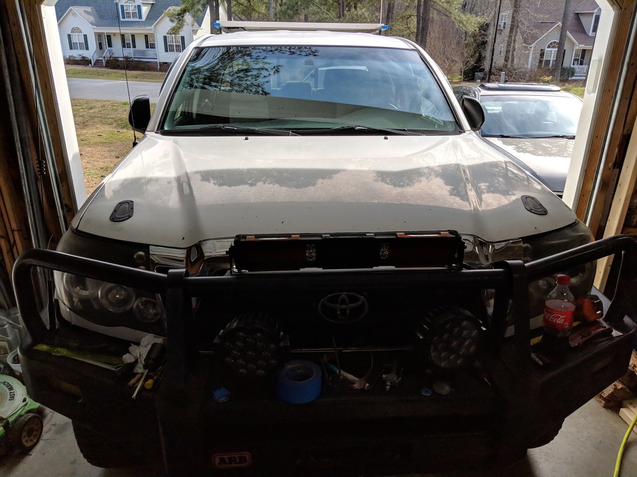

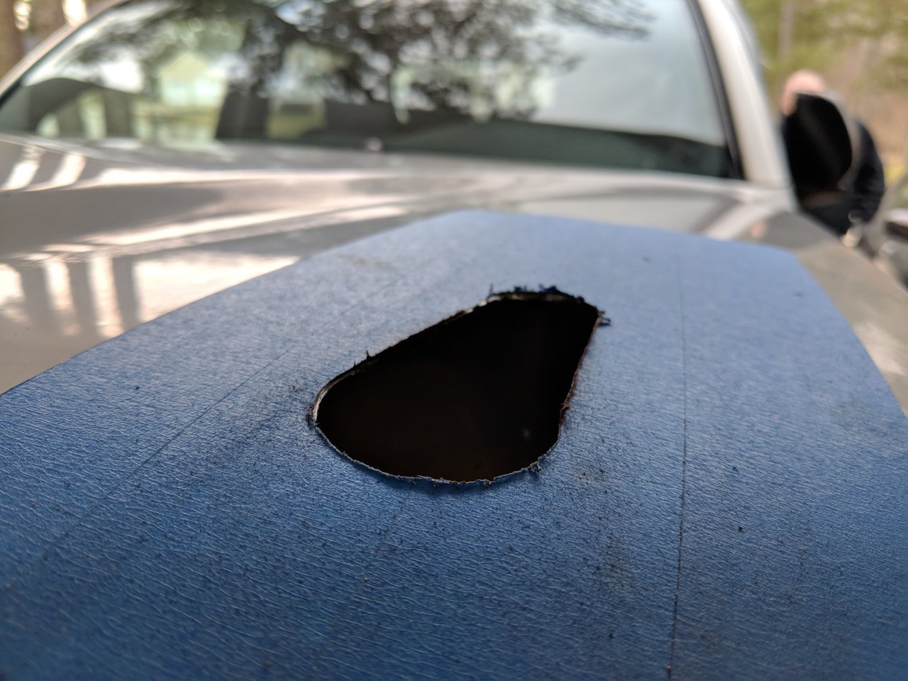

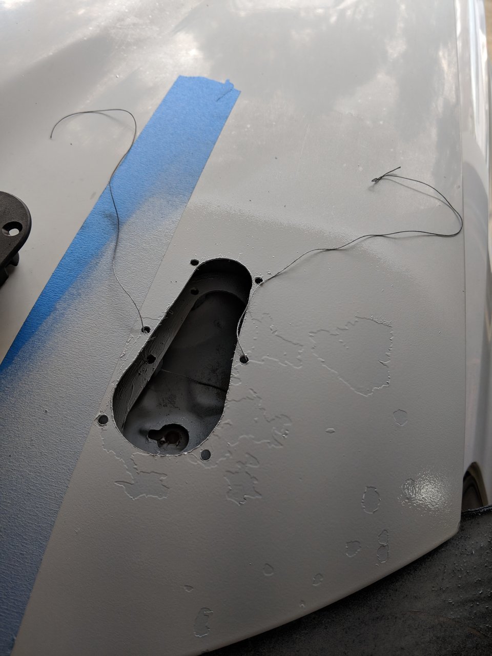

    Alright so here are a few pics of the install of the hood latches. 216436 miles
    IMG_20180317_095914.jpg IMG_20180317_100602.jpg IMG_20180317_101317.jpg IMG_20180317_103654.jpg IMG_20180317_104447.jpg IMG_20180317_104601.jpg IMG_20180317_104713.jpg IMG_20180317_104852.jpg IMG_20180317_105227.jpg IMG_20180317_105750.jpg IMG_20180317_110337.jpg IMG_20180317_110920.jpg
    IMG_20180317_174450.jpg IMG_20180317_111420.jpg IMG_20180317_115320.jpg IMG_20180317_120141.jpg IMG_20180317_130333.jpg IMG_20180317_134417.jpg IMG_20180317_134424.jpg IMG_20180317_163901.jpg IMG_20180317_163855.jpg IMG_20180317_163929.jpg

    The damn 3M "easy release" painters tape stuck more than the paint... I had some automotivetouchup.com rattle can on hand so not a huge deal. That and I have a buddy that does paint work!

    Yep it's full of rock chips and is dry as a bone. My paint guy has been on me to wax or repaint it.

    Just shooting to kill hood flutter with the latches?

    Yep, I don't like feeling that the hood could pop open at any moment. Plus #racecar
