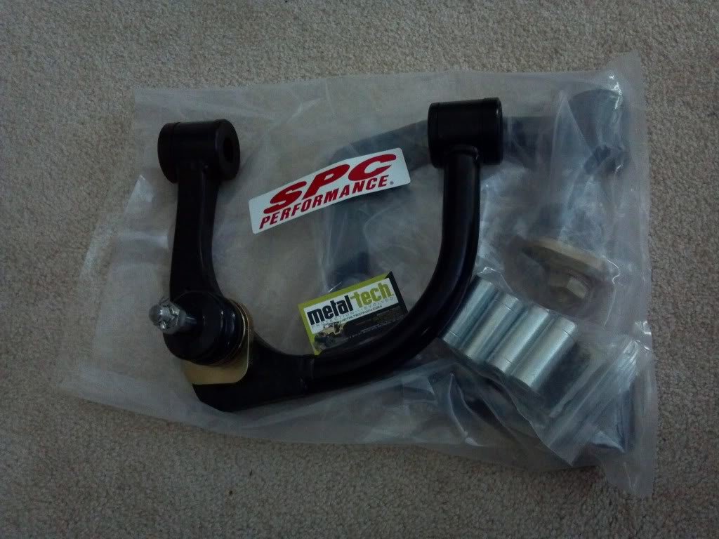

    Metal Tech SPC light racing UCA's

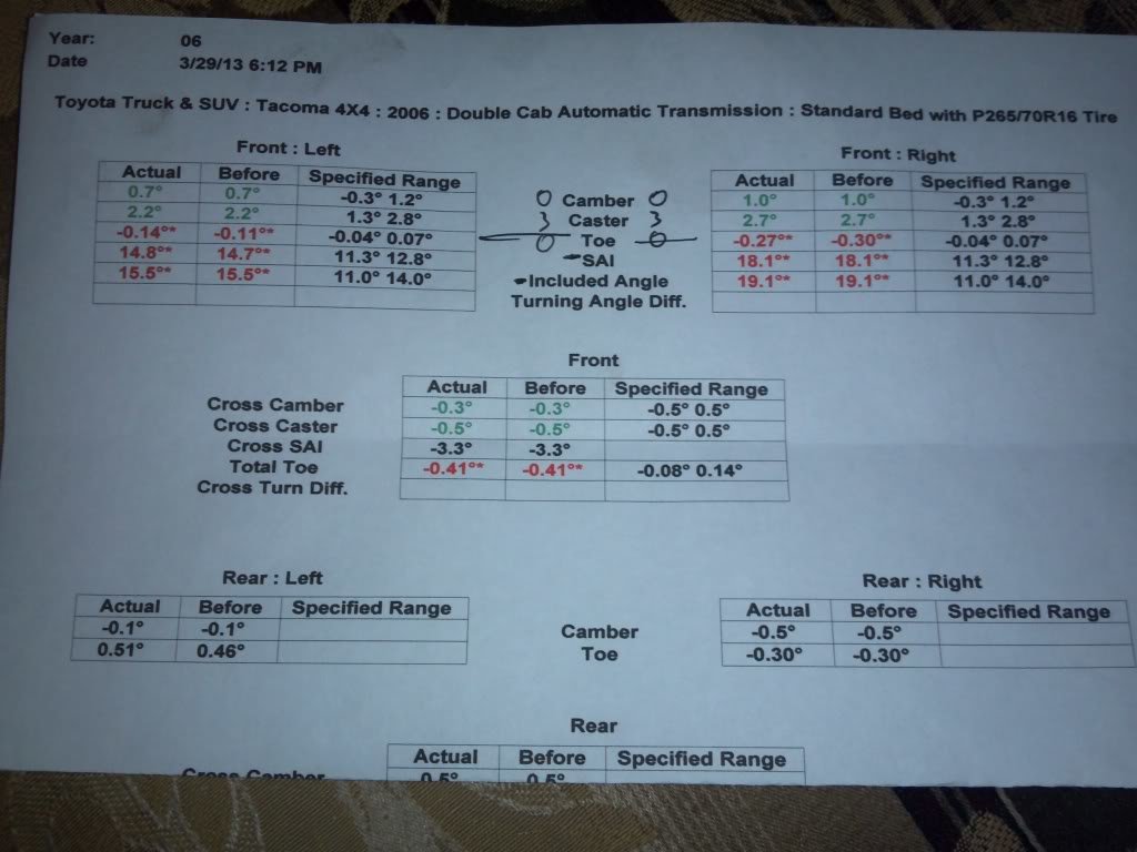

    This is just the numbers I had before with the LR UCA set to +2.0*
