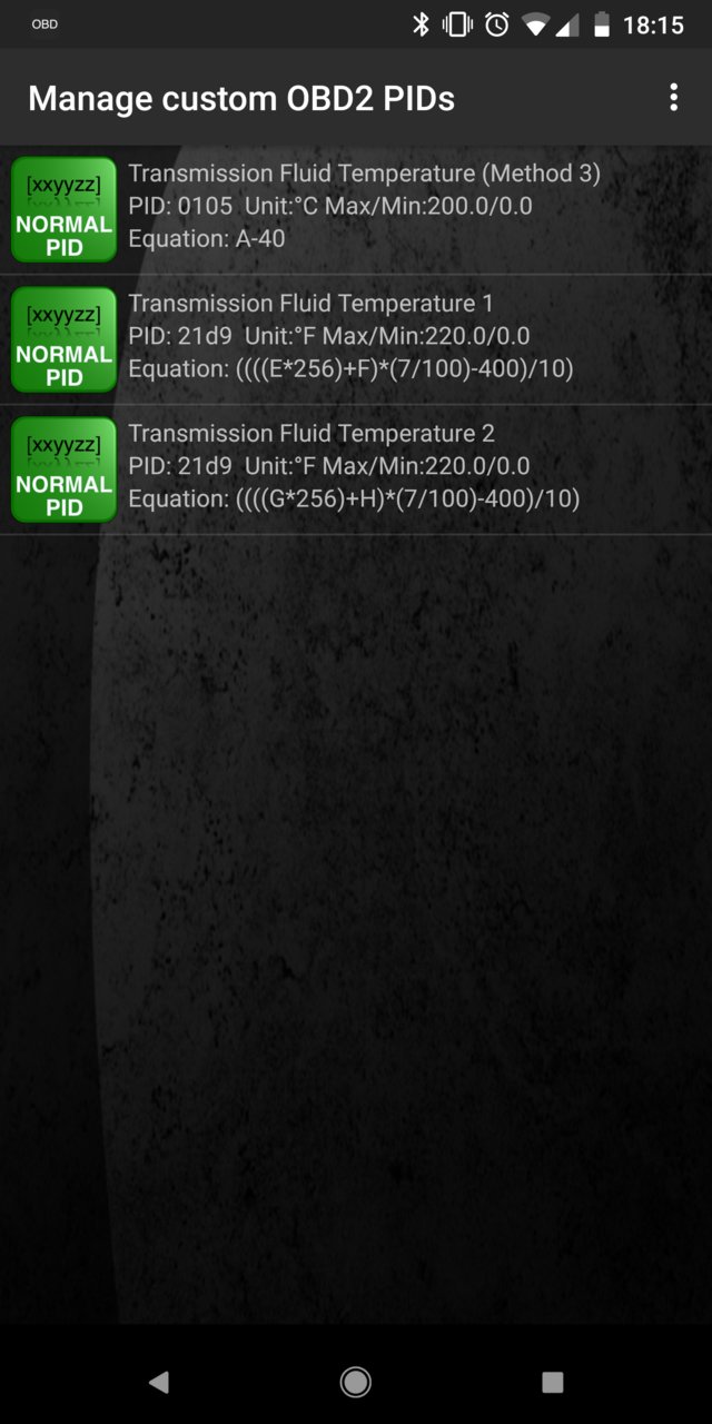

    Hey man I figured out the equation issue and got the new PIDs but am not getting any info from the truck on the trans temp is there another step I am missing?

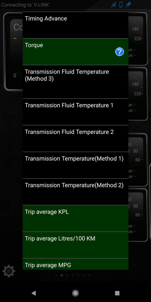

    Should look like this and then add a new Guage on whichever page you want it. While your trucks running and connected you should see values in the add Guage list.
    Transmission PID for torque

    Damit I used the PID 2182 and the equation for that ok I'll change the equation then
    Why did you only go to a max value of 220?

    Anything over that is bad juju. Also with the oil cooler I installed I don't see those temps.

    Works now that I put those equations in thanks!!!
