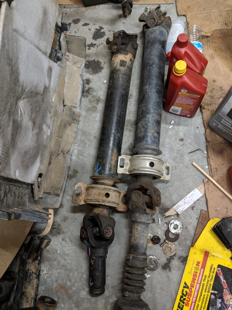

    IEDLS Poly Center Carrier Bearing will be happening soon. Lol I've had this damn thing long enough. I've got enough shafts to go around now.

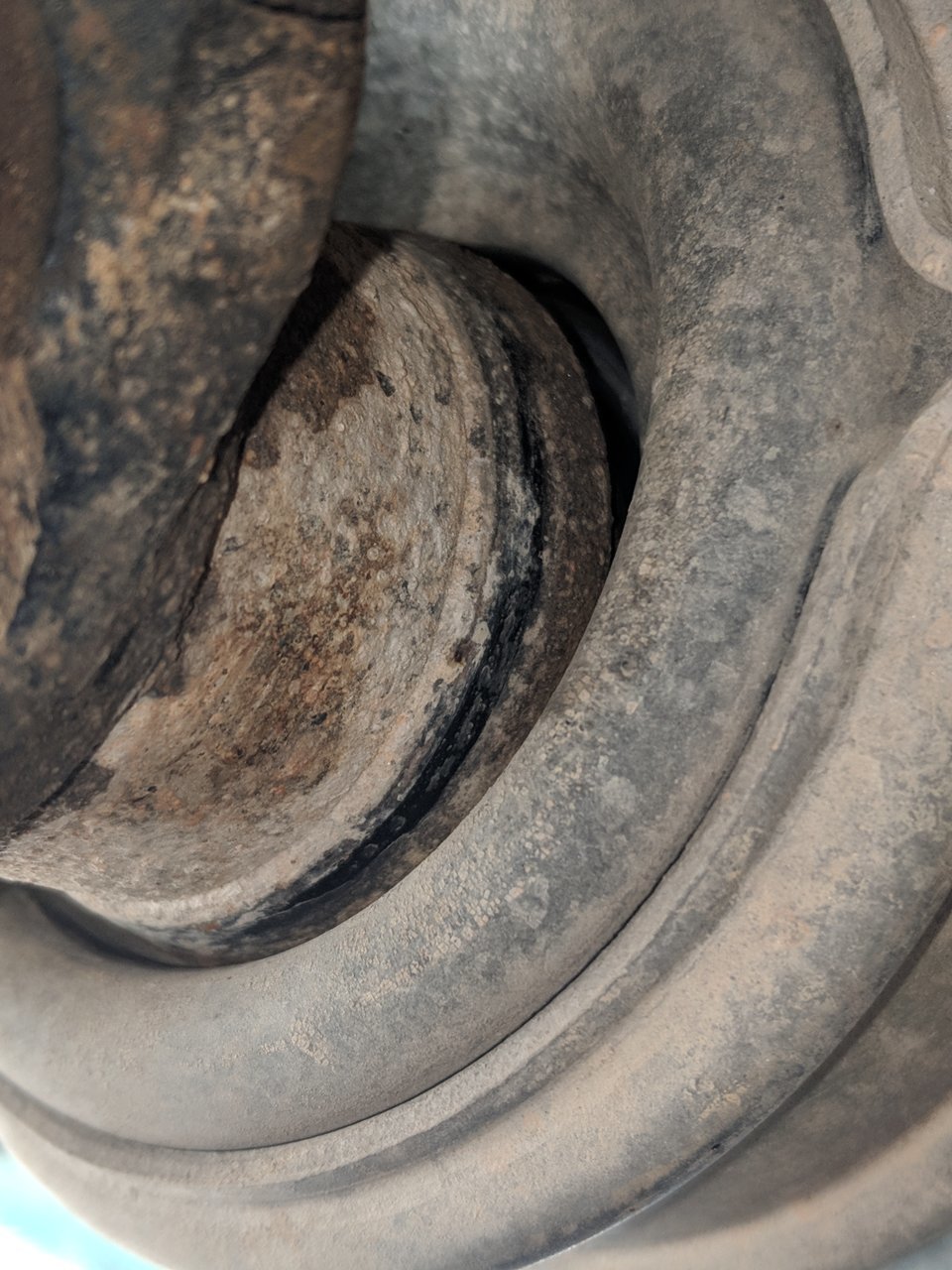

    Hmm does this look right? I can move the shaft and the bearing looks totally seperate from the rubber.

    Yeah the bearing just is isolated from the truck via rubber but if the bearing outer race can spin inside the rubber then that's totally not good.

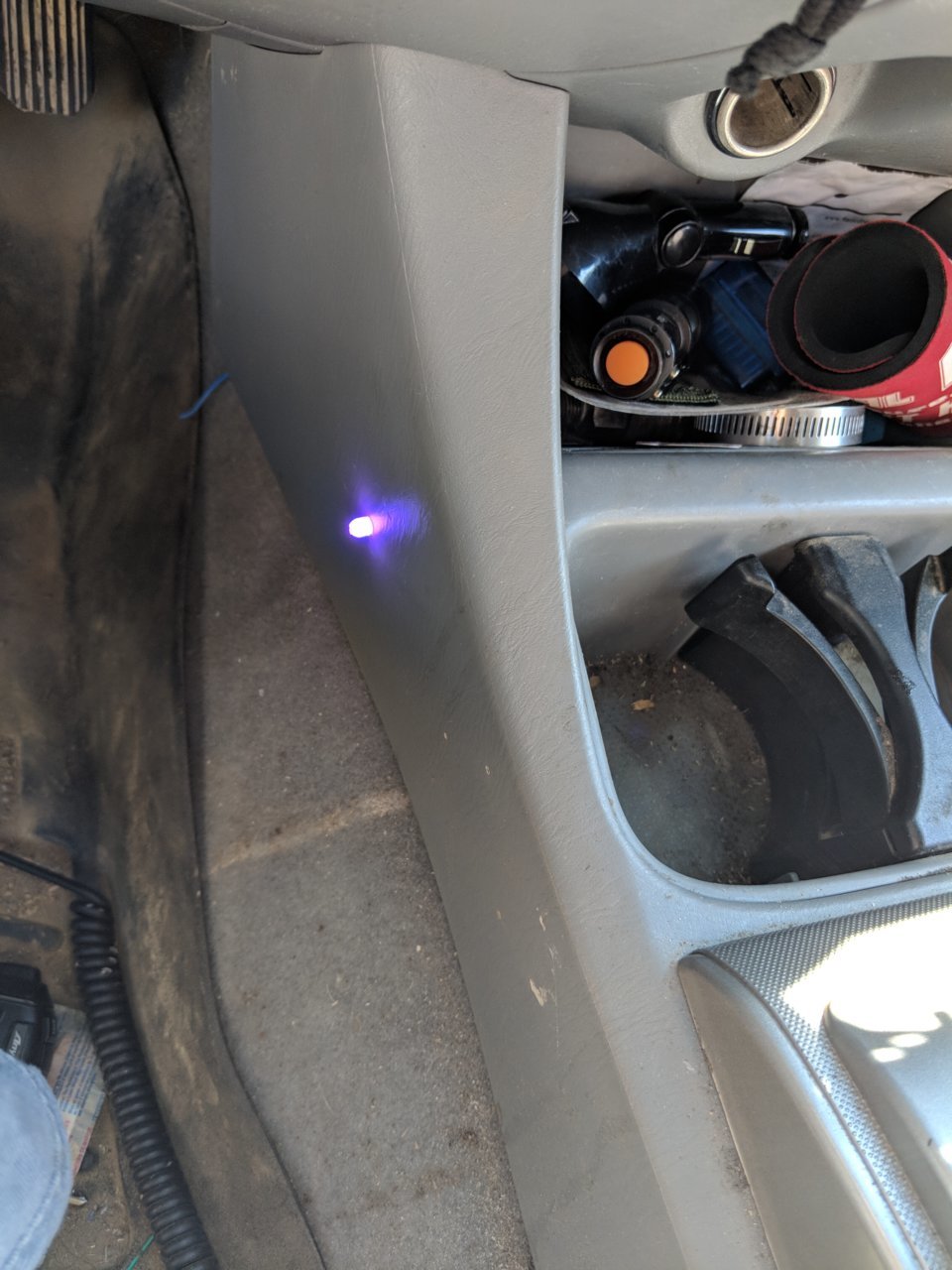

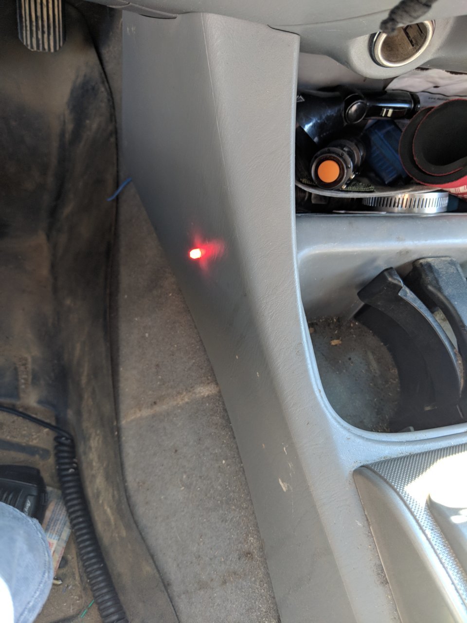

    Just a little mod today, an indicator for my RGB lights.

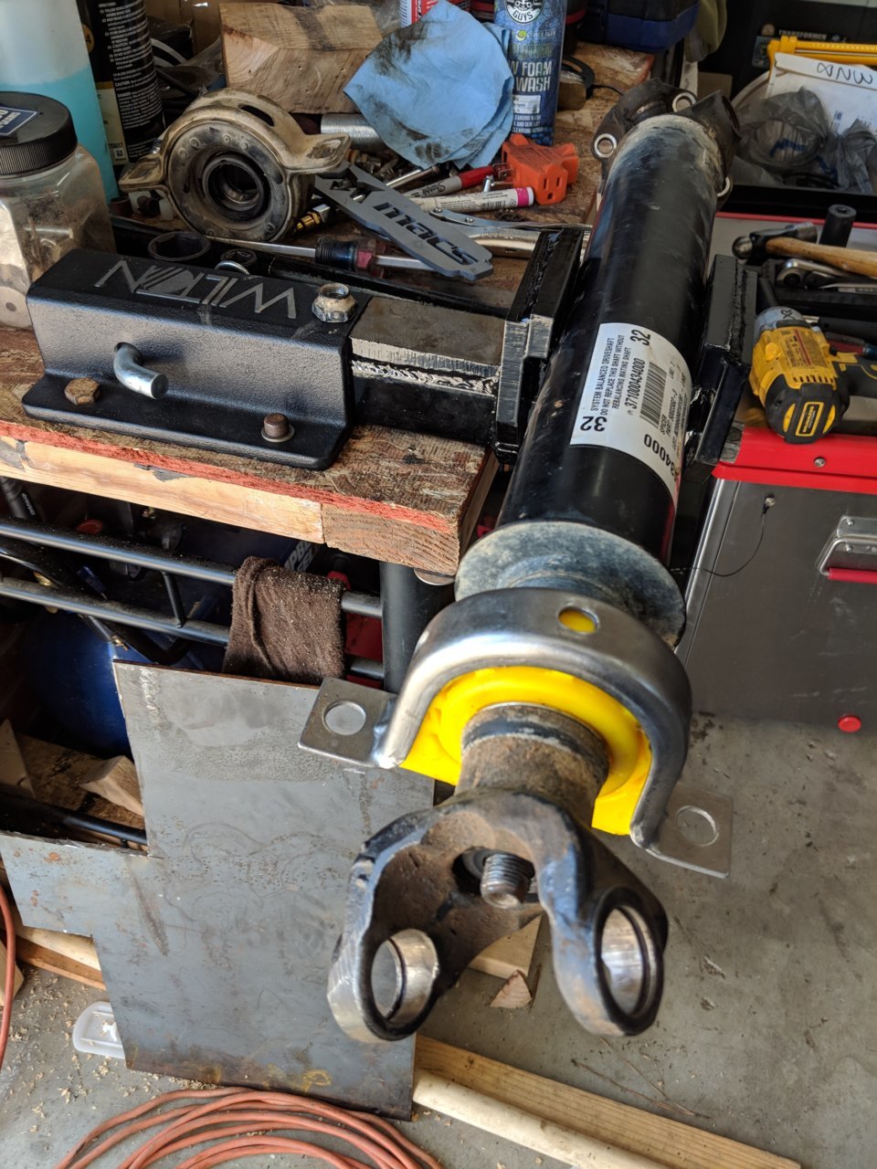

    Driveshaft end nut torque: 1st 134 ft/lbs remove 2nd 51ft/lbs. Looks like I'm replacing u-joints too.. They're notchy and making crunchy noises.. I didn't think I neglected them that much.
    PSA: don't clamp your shaft like this.. I was gentle with it.
