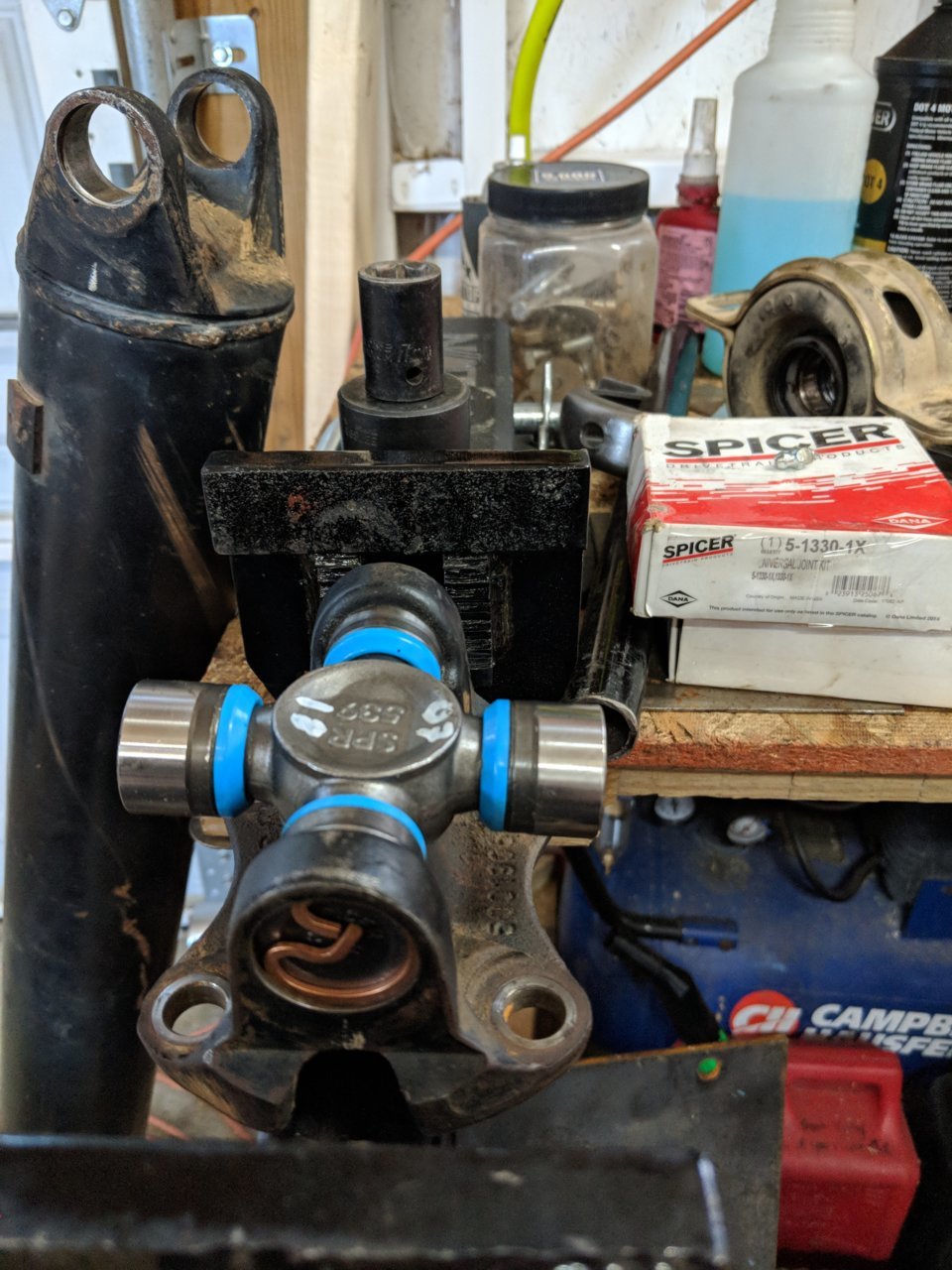

    This driveshaft is done.. New Spicer u-joints, IEDLS poly Ford carrier bearing, and fresh grease. I even managed to get all the grease zerks all on the same lobe for easy greasing. I'll take that plate off and paint it tomorrow.. Holiday plans...whiz bang...
    New dangle angle(i zeroed the level and kept getting different readings):
    (Angle A)Tcase to forward: 1.6 or 2. 2*
    (Angle B)Forward to rear: 8.5 or 6.5*
    (Angle C)Rear to pinion: 6.8*

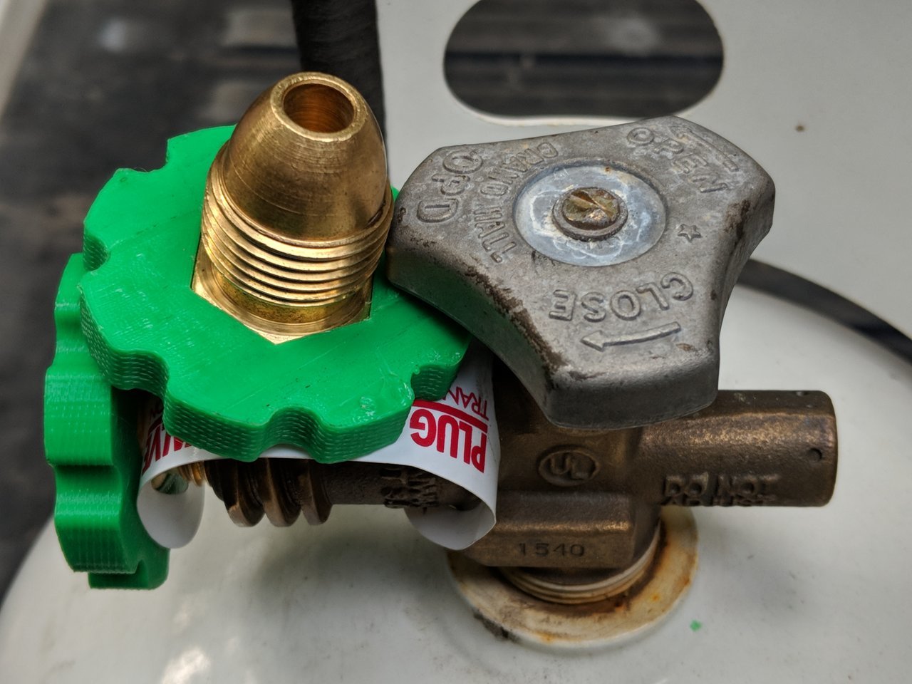

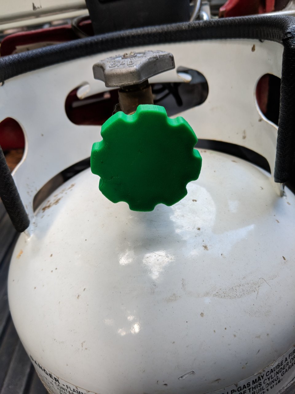

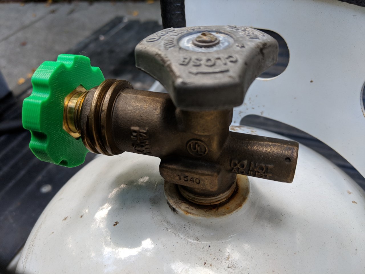

    Some nice 3d printed knobs for these propane tank plugs thanks @diverdale
    ovrlndkull and Blkvoodoo like this.

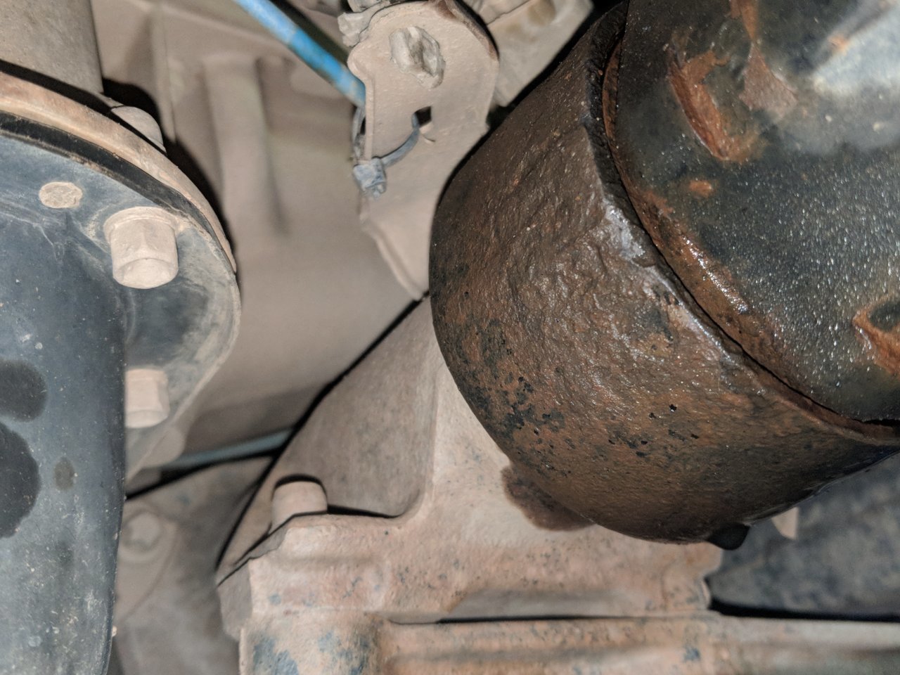

    The seal is $0.89 plus $2.99 shipping lol. This thing is a spring chicken compared to my Land Rover. I'm ok with fixing a leaky seal, I was just surprised to see the oil spill on the driveway.

    Lol thanks. After reading... It could be more than a leaky seal.. I need to add up all the things wrong with that front corner and see what they all point to. Stay tuned.

    My front passenger tire was worn all choppy when I took it off.. I don't recall if it was like that when I put it on... I checked for play in the bearing and ball-joints.. Will check into that more today.
