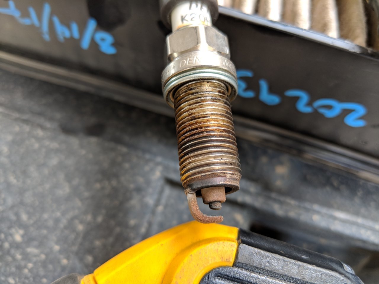

    Today feels like a sparkplug changing kinda day

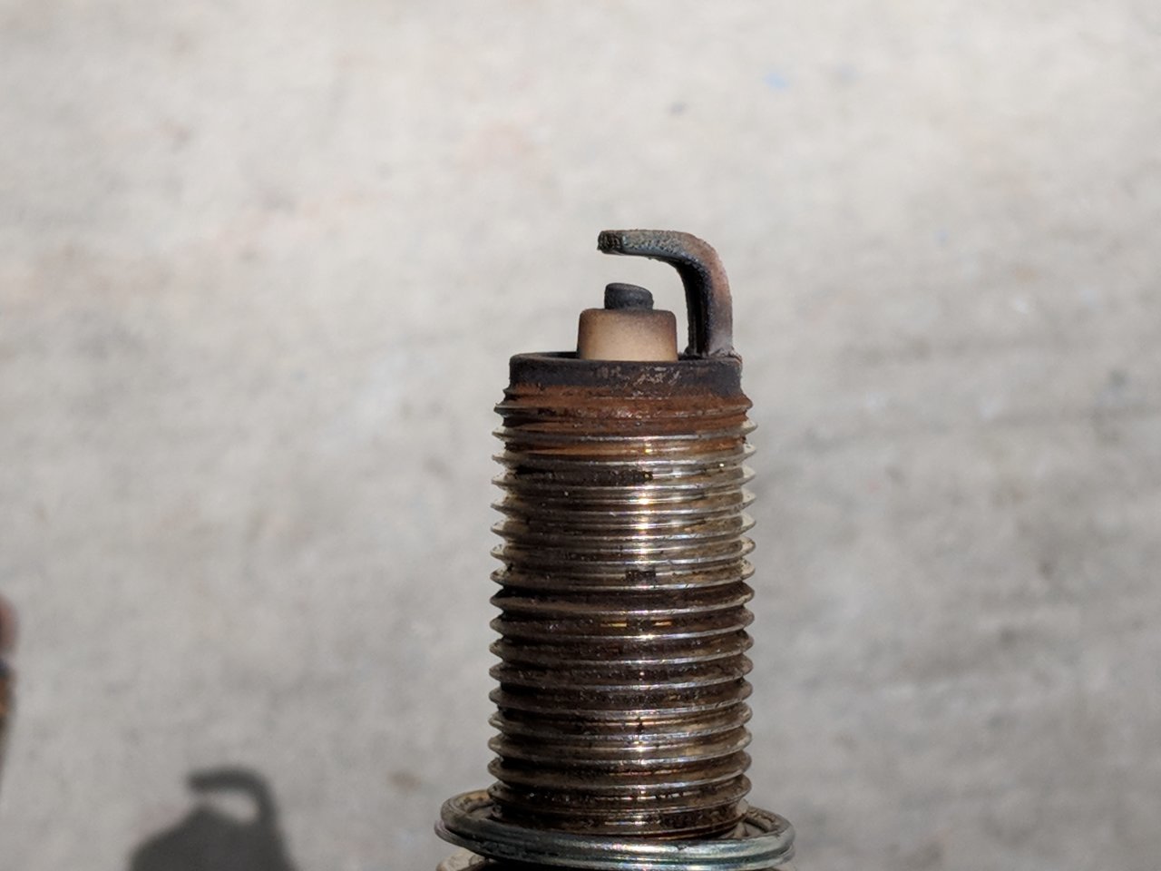

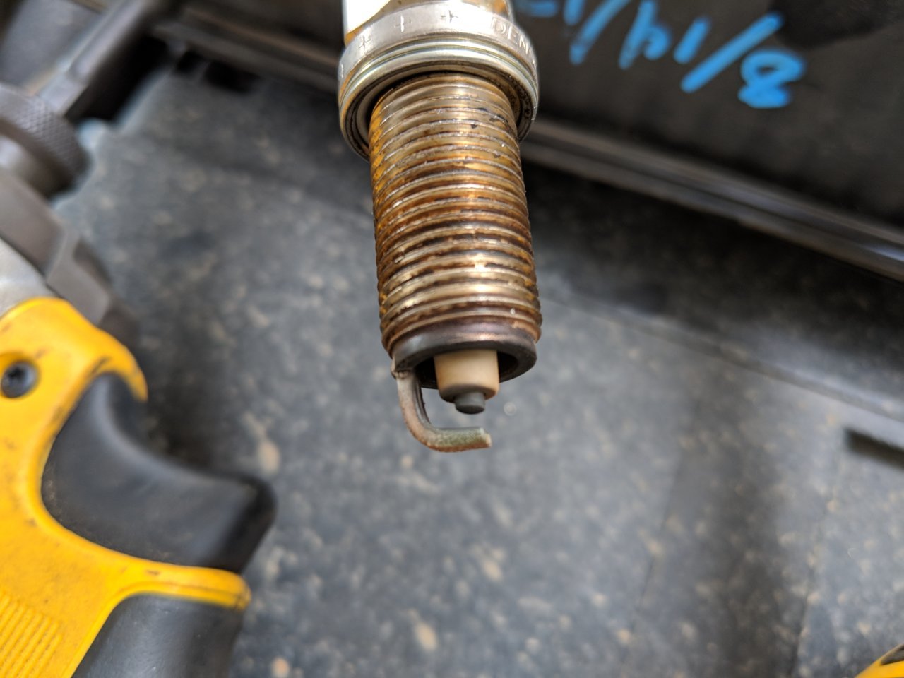

  9. Aug 1, 2018 at 6:56 PM
    #1689
    Sandman614
    Sandman614 [OP] Ex-Snarky TWSS elf, Travis #hotsavannahdotcom
    Oct 26, 2010
    #45273
    36,067
    Tim
    Garner, NC/Boone, NC
    '06 SR5 Off Road

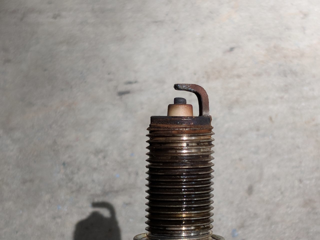

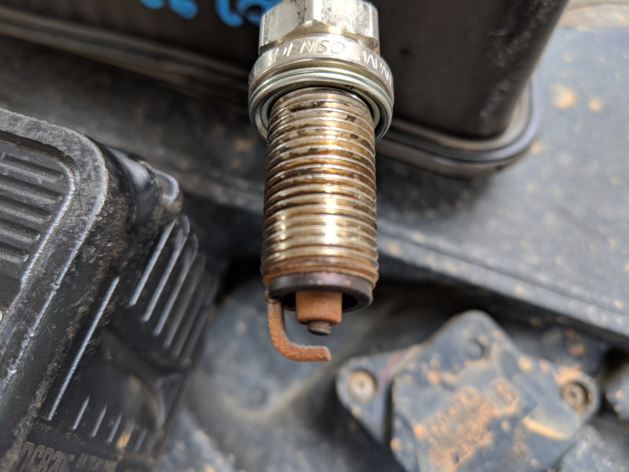

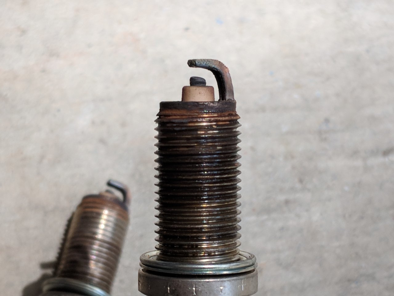

    230930 miles spark plugs #maintenance

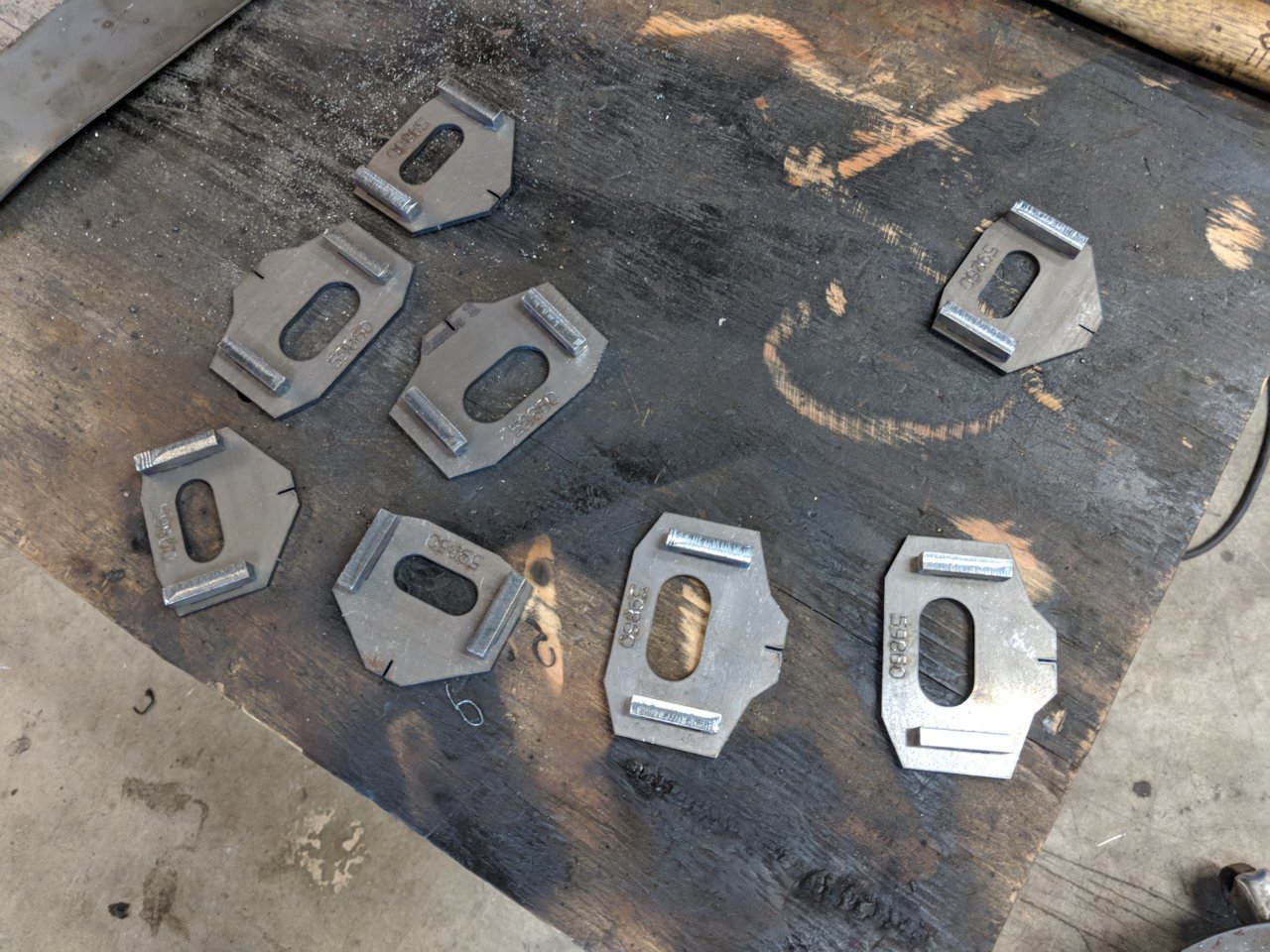

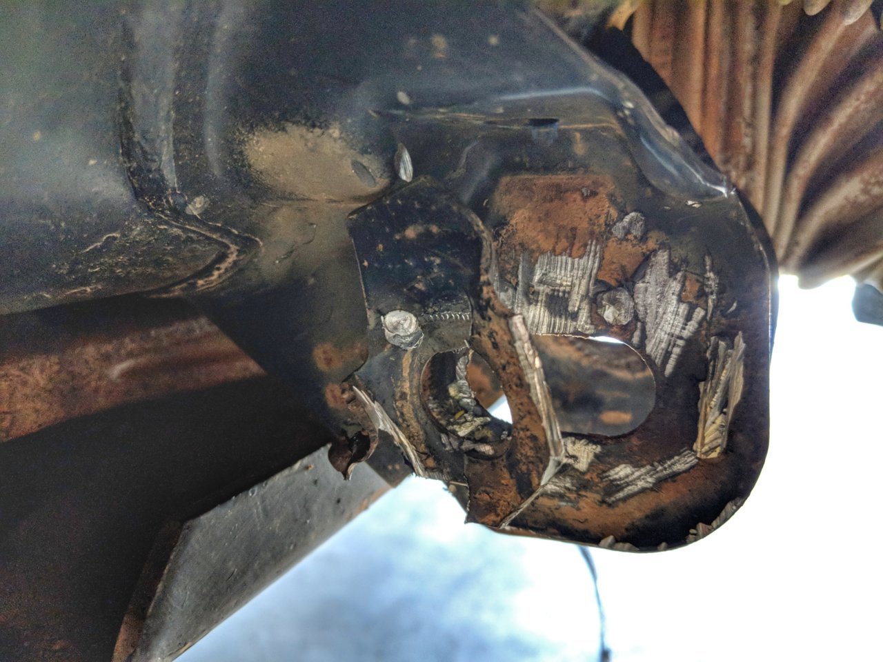

  10. Aug 5, 2018 at 5:54 PM
    #1690
    Sandman614
    Oct 26, 2010
    #45273
    36,067
    Tim
    '06 SR5 Off Road

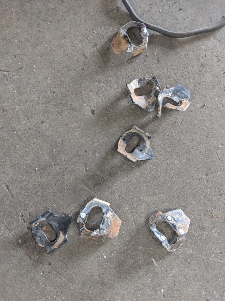

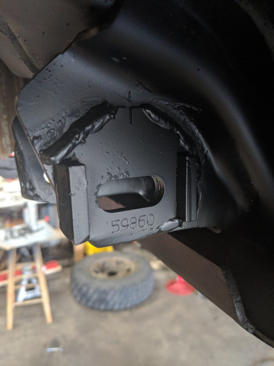

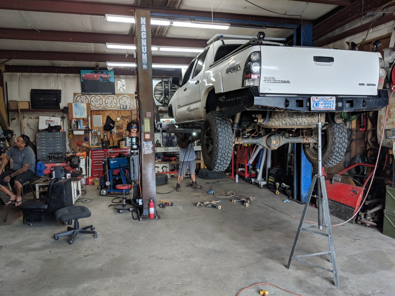

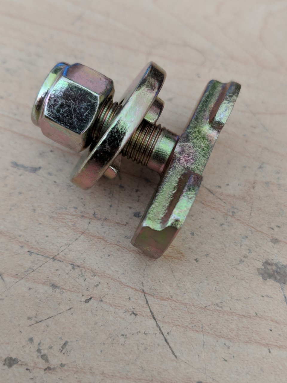

    Got this chinsy metal pieces off like pie with the air chisel and Jason did a good job on the new TC alignment cam tabs! Even got some beach time in! Alignment set for tomorrow morning.

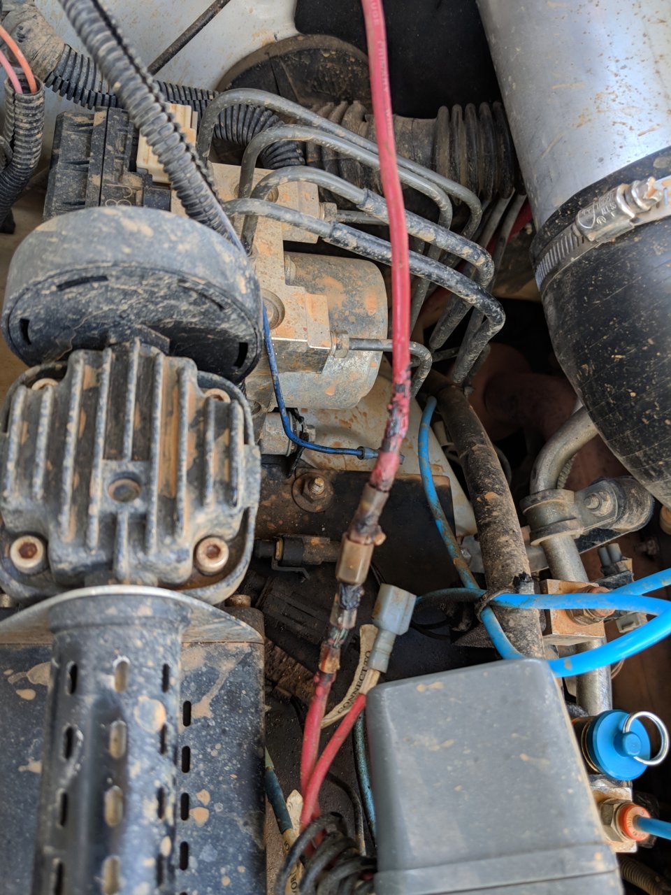

  12. Aug 8, 2018 at 1:11 PM
    #1692
    Sandman614
    Oct 26, 2010
    #45273
    36,067
    Tim
    '06 SR5 Off Road

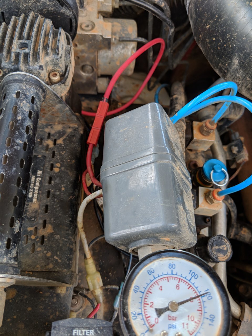

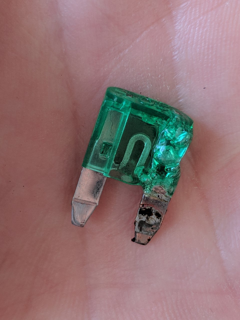

    Some good news:
    The new air pacifier fits and blocks pressure
    Now the bad:
    The o-ring is useless. These are Home Depot and harbor freight universal quick connects. Also I put a drop of oil in the connector to help keep the seal in the coupler happy. You can see how effective the old cover was, it just jumps off and hangs there.
    https://www.homedepot.com/p/Husky-1-4-in-Universal-Coupler-HDB20500AV/100063067
    And the ugly:

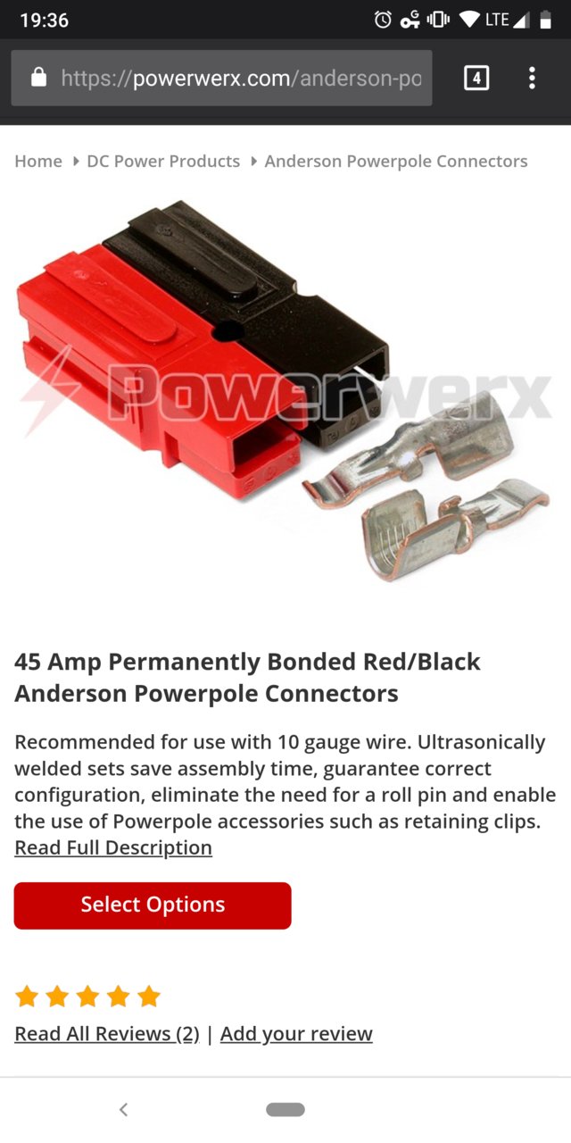

    So what we have here is a failure to current rate a connector supplied..? The wire is only hot/melting the first couple inches around the quick connect.
    Hmm :bananadead: specs say max amp draw 30amps.. I guess it was hitting 29.99amps

    Got an amp clamp coming Friday to check out what's going on with this and then the new connectors going on it.

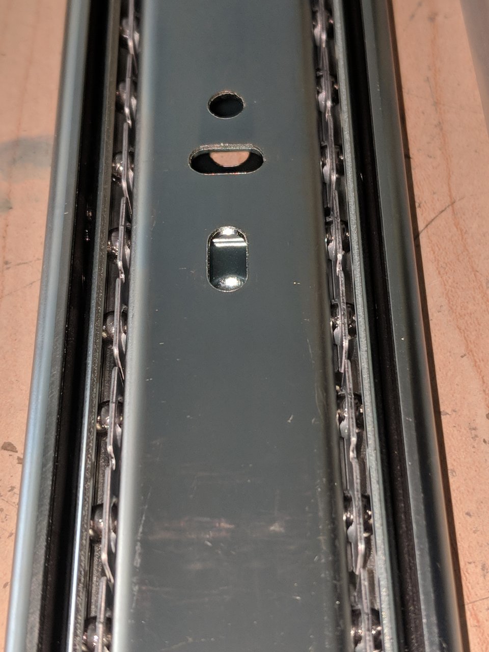

    The beginnings of a fridge slide

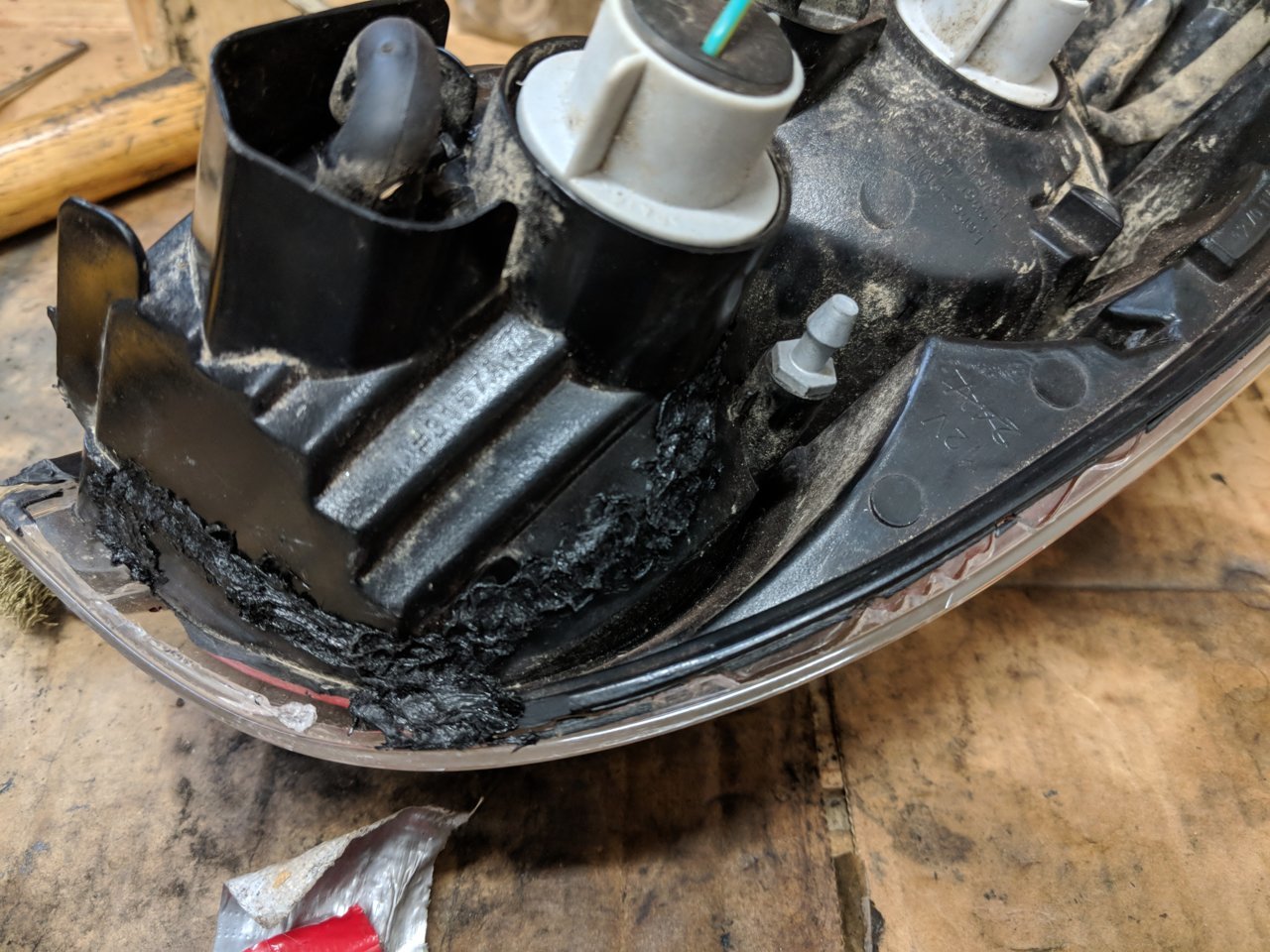

  19. Oct 11, 2018 at 1:08 PM
    #1699
    Sandman614
    Oct 26, 2010
    #45273
    36,067
    Tim
    '06 SR5 Off Road
    A little melty melty and some plastic epoxy and it'll be good as new, or a good replacement until I fix my light. Thanks @EricL I think it should be kept in TW as a hand-me-down for people that need a temp taillight.
    EricL likes this.
