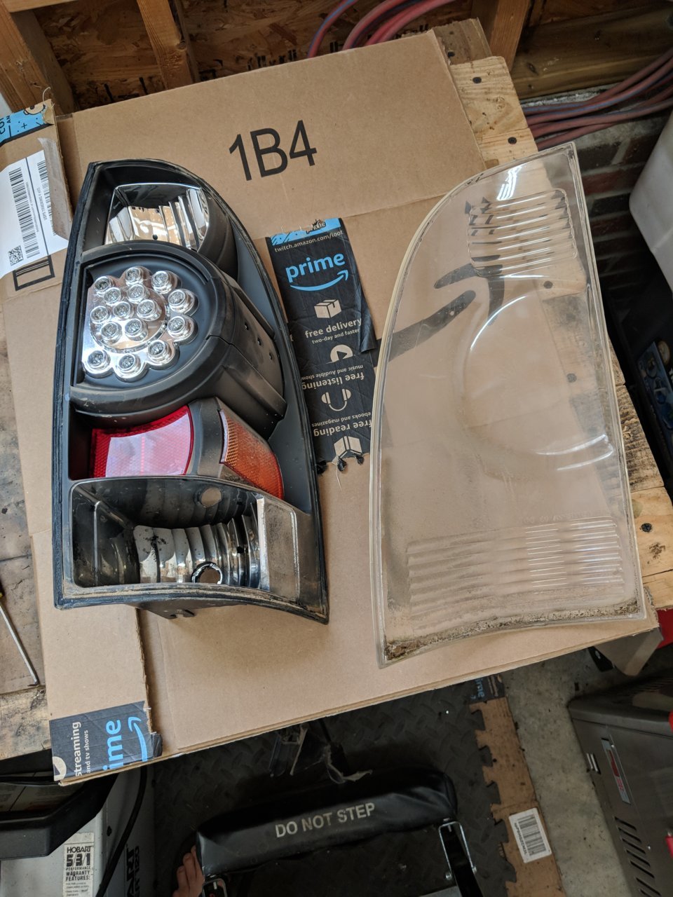

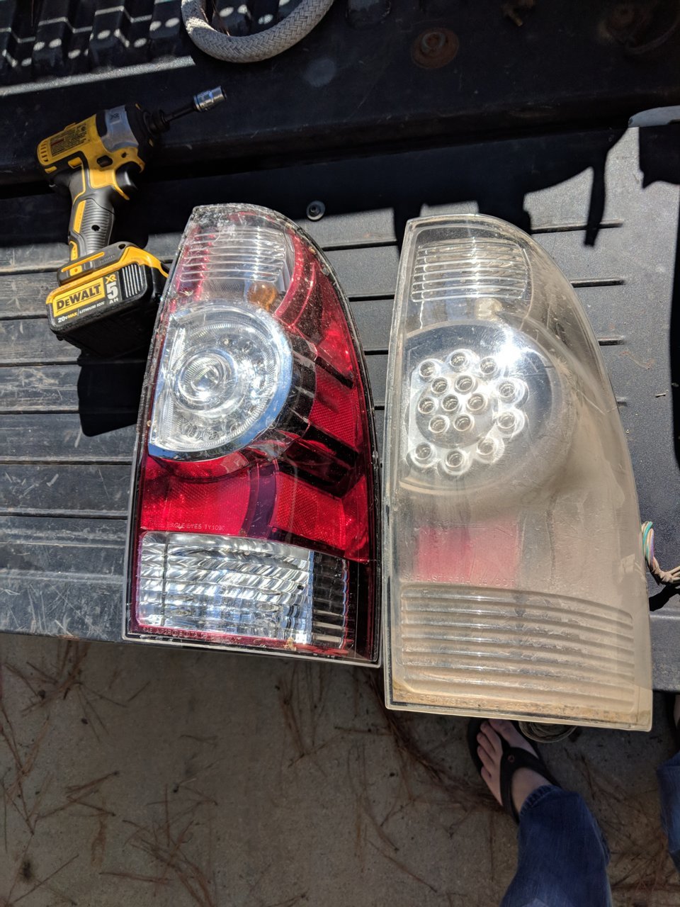

    This light was surprisingly easy to take apart, probably because the 'factory seal' was almost all already broken. Washed it up and sealed it back together with some Gorilla Epoxy clear.

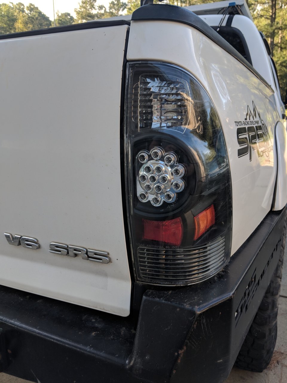

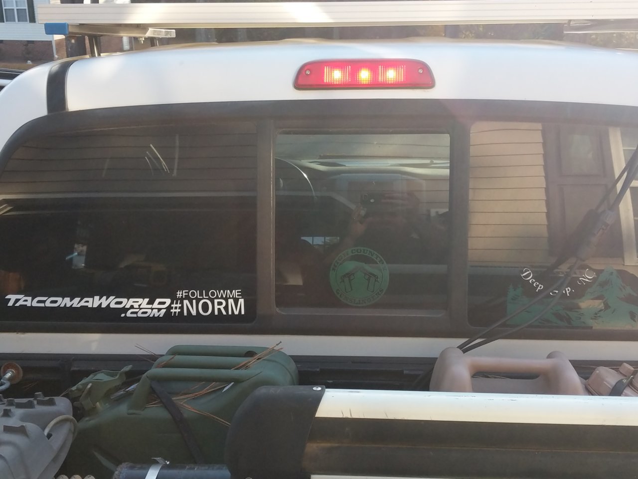

    Replaced a dead led in my 3rd brake light. Old ones were from ebay or super bright leds, and new ones are Philips

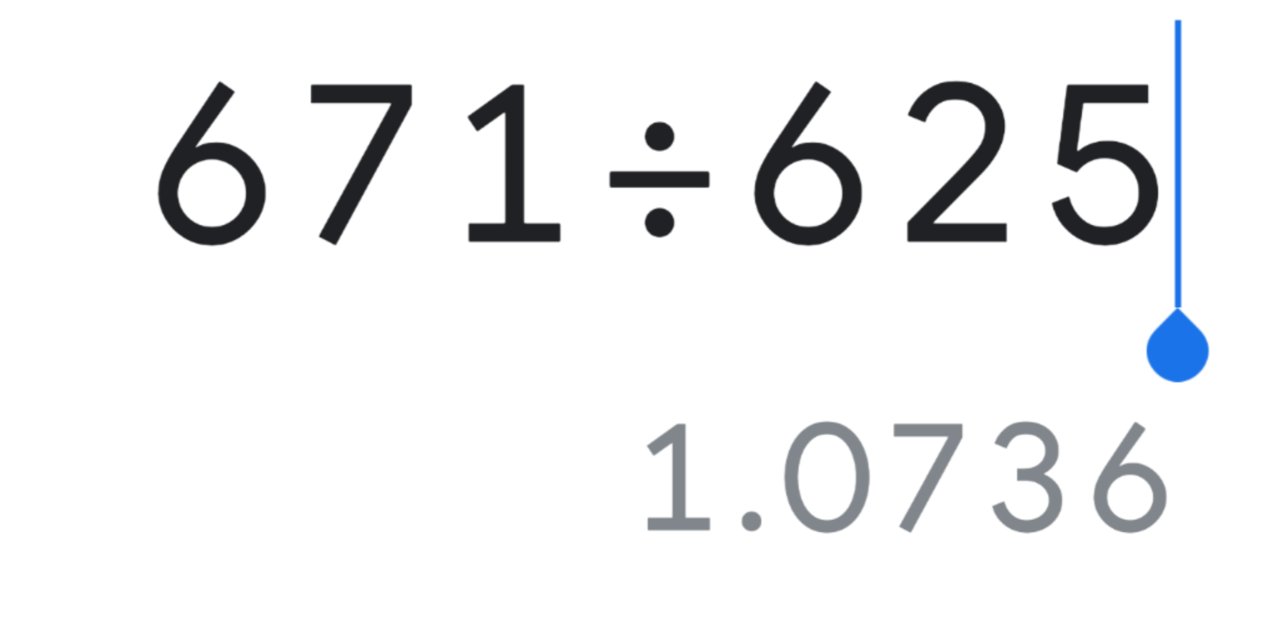

    Anyone else good at math? Looking for corrected mileage for my 33s. Odometer x (revs per mile ratio) sounds good to me.

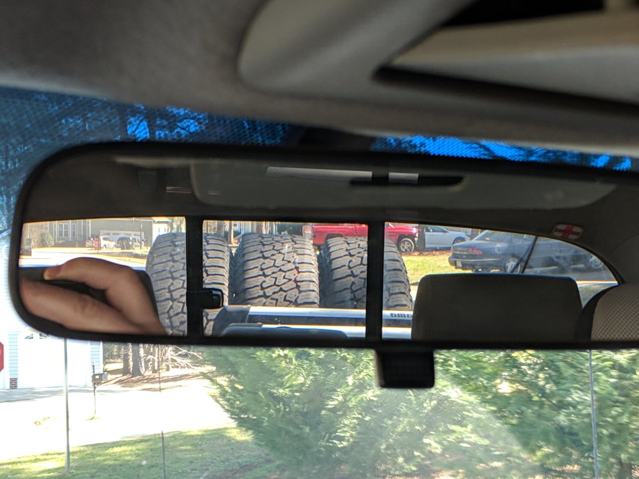

    Today's field trip brought to you by Discount Tire free balancing. Feeling like a Desert PreRunner
