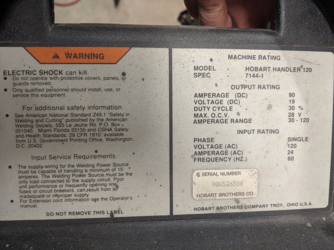

    Also that unit I didn't think can Handel more than 1/8” gas shield usually requires more amps over flux core

    The dial on the front goes up to 3/16" and the side panel reads up to 3/16" gas and flux. Kind of impressive based on the serial number and some googling it looks like this one was manufactured in 1992.

    Don’t believe everything you read about welders on TW :D For some reason this board thinks you need a 220 machine to weld anything more than sheet metal. In reality 110 machines work great for the work our trucks needs

    I wasn't sent saying that. Although 220 is nice to do single pass on 1/2”
    I was implying that flux core wire, while not as nice looking, dosent push the machine as hard.
    @Sandman614 just remember your duty cycle. 30% is at 90A while the machine goes to 120A it’ll be ~10% or less duty cycle

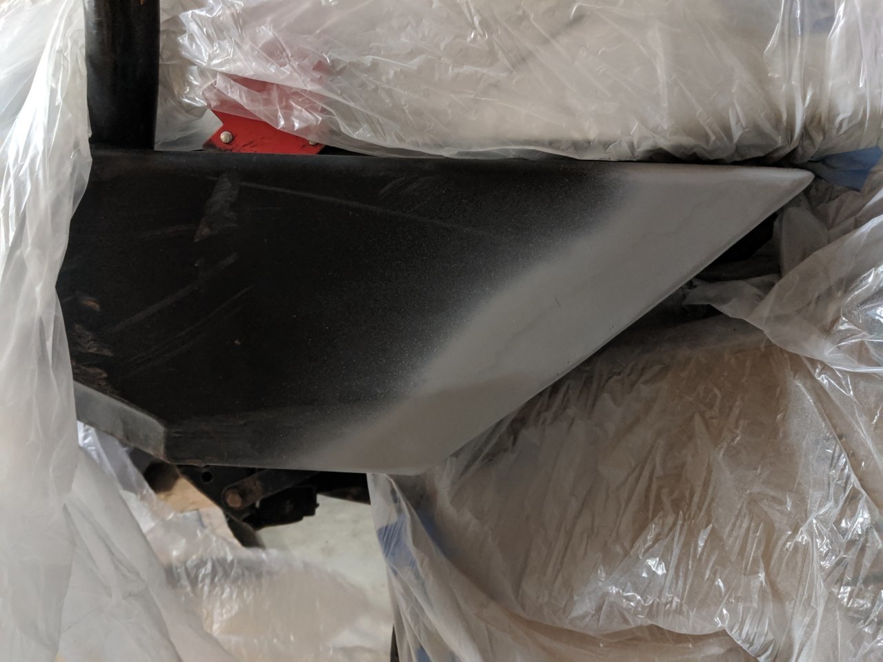

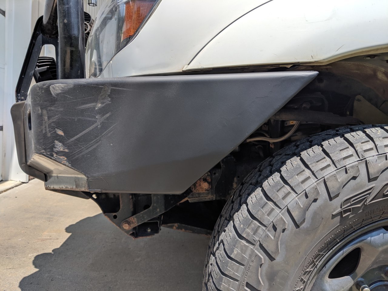

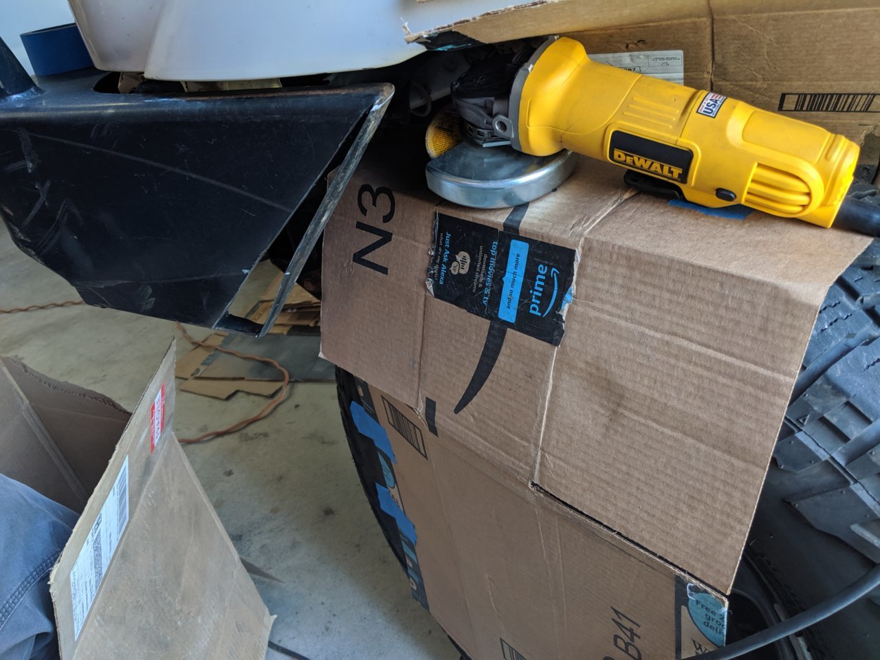

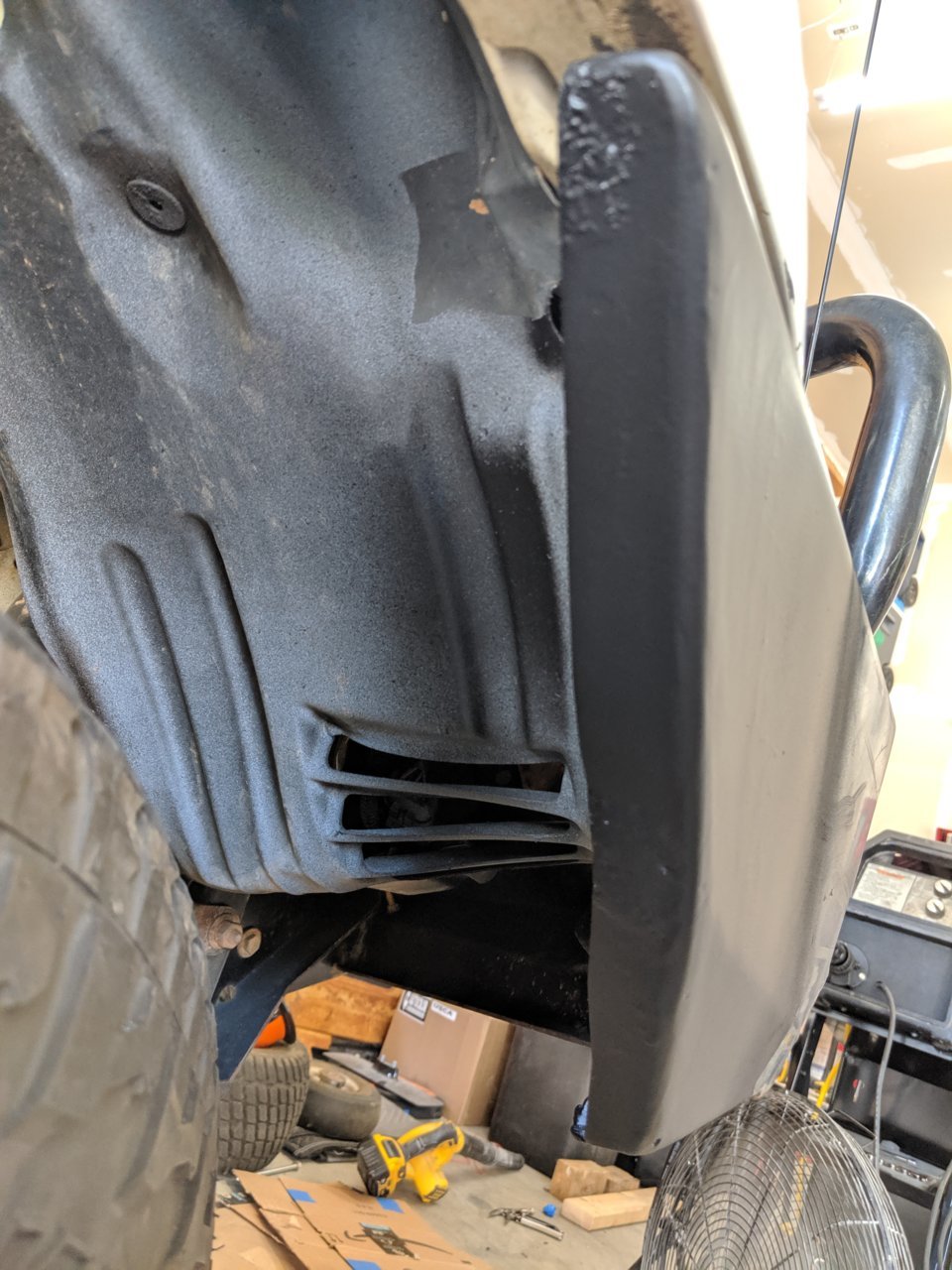

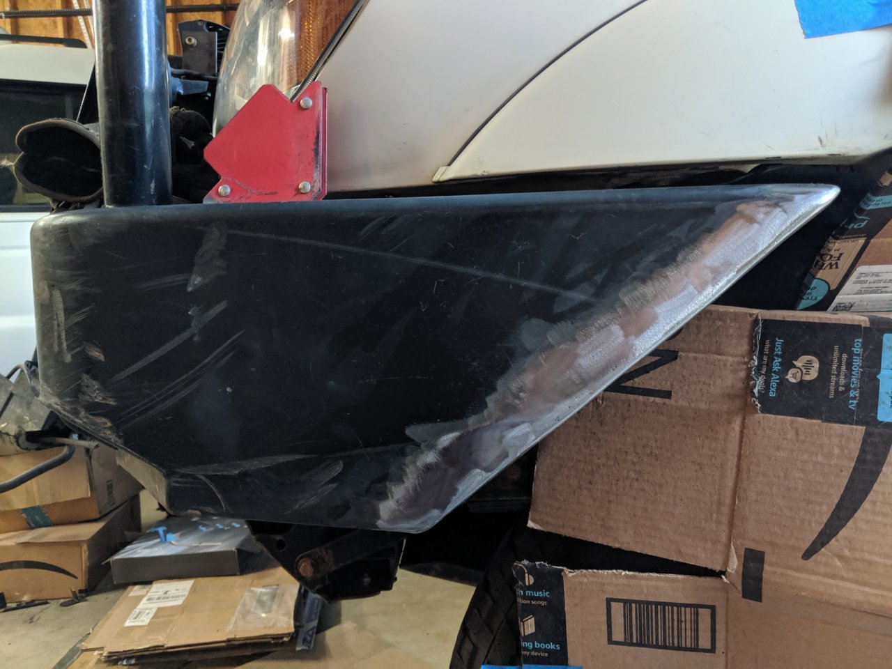

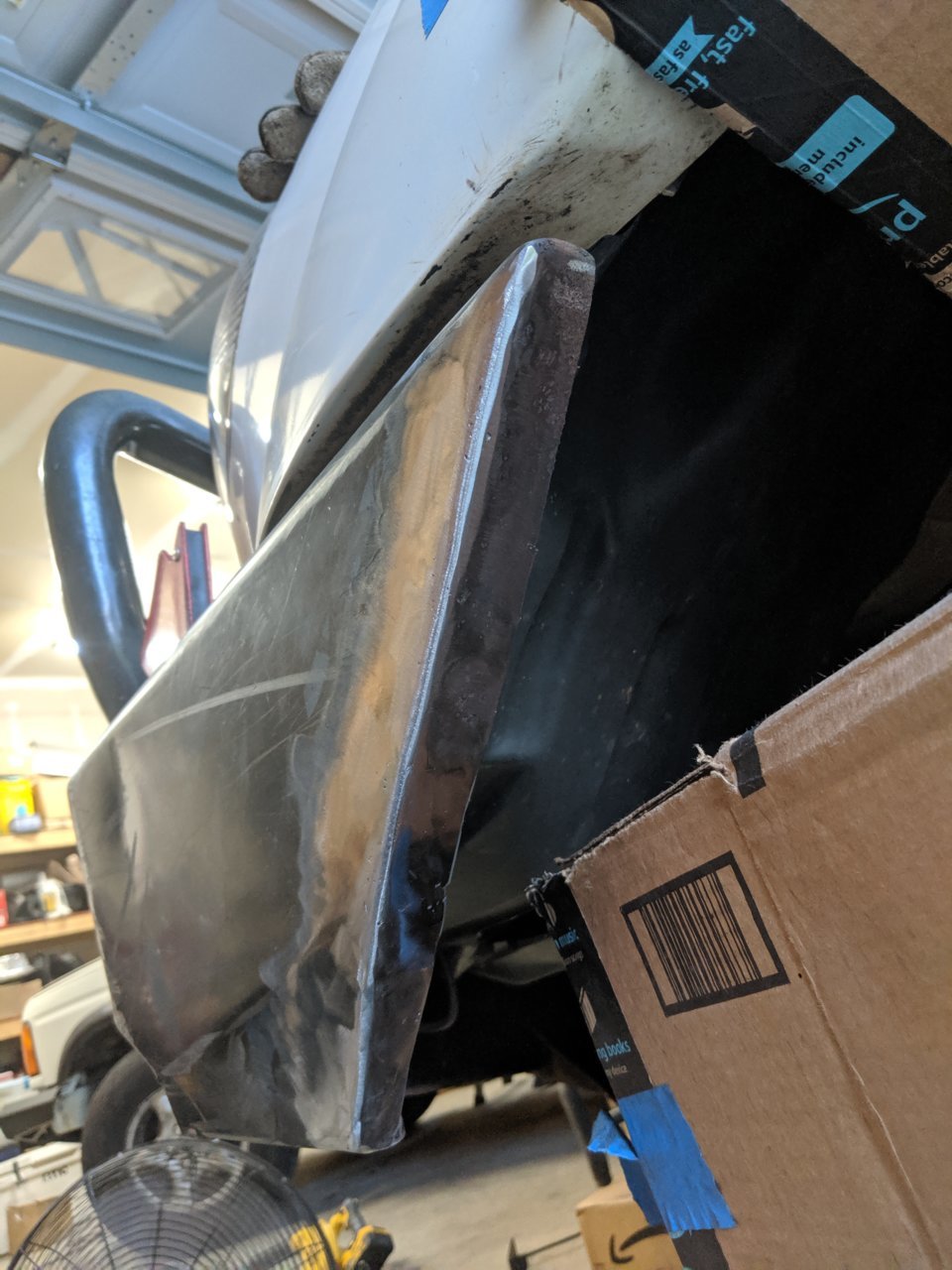

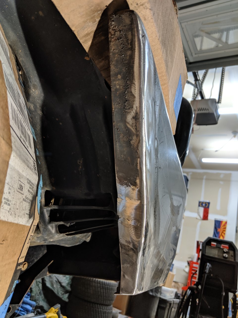

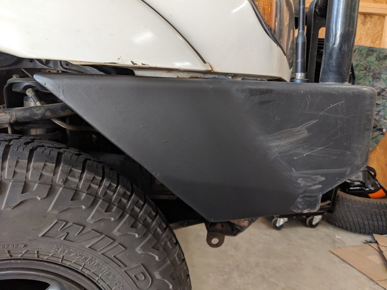

    I made a leg protector. Oh and I cut 1.5 inches out of my bumper. I may or may not have burnt through this 3/16" plate once or twice(That's because it's actually 1/8" if I would have taken a second to measure). Well see how the new tires clear.

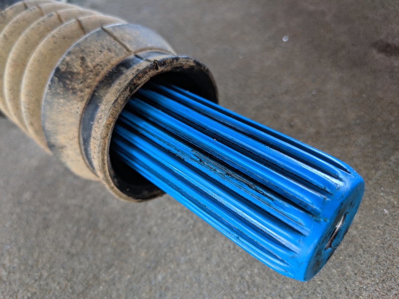

    Having a gopro sure beats finding a buddy that is willing to ride underneath, less liability too! Trying to figure out this "axle wrap thump". Looks like the slip joint isn't happy.

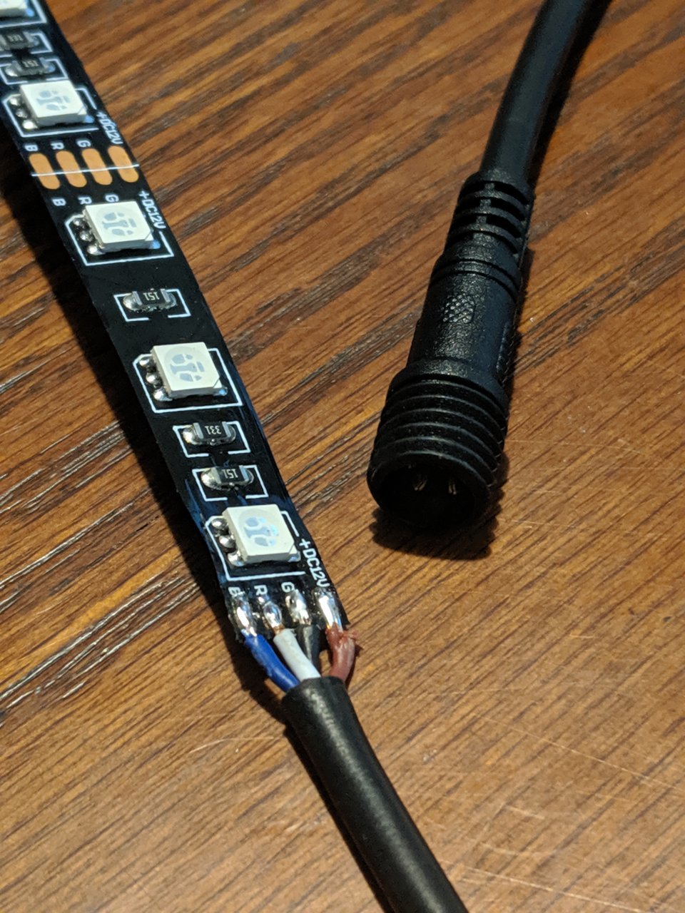

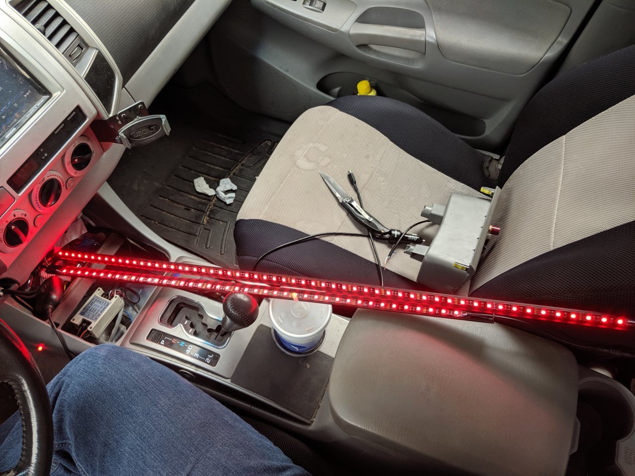

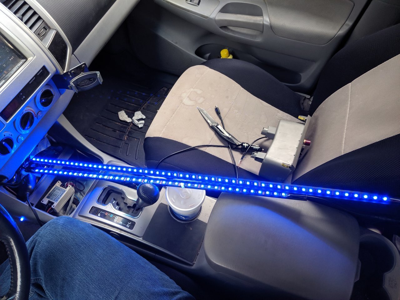

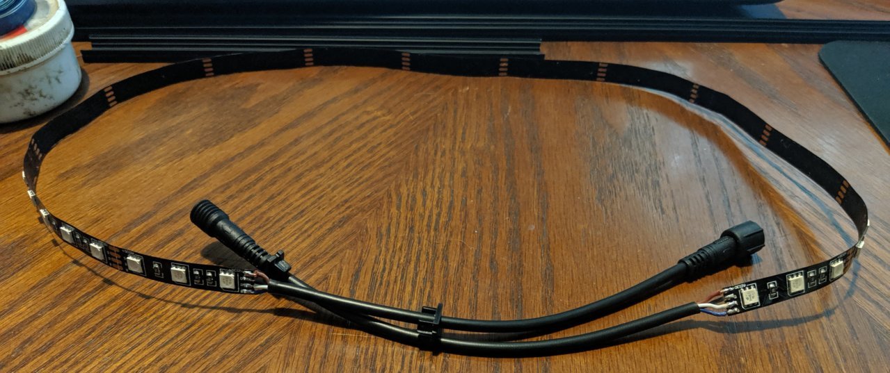

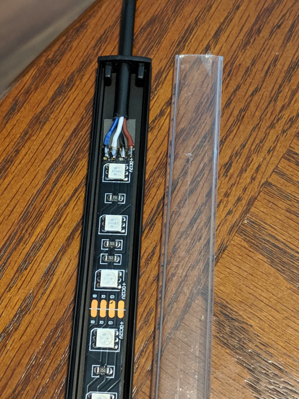

    Refreshing my ArrrrRGB MVIMG_20190805_082828.jpg MVIMG_20190805_093627.jpg MVIMG_20190805_114547.jpg

    Arduino + RGB? Whats the use? :popcorn:
  16. Aug 5, 2019 at 10:55 AM
    #1756
    Sandman614
    Sandman614 [OP] Ex-Snarky TWSS elf, Travis #hotsavannahdotcom
    Oct 26, 2010
    #45273
    36,067
    Tim
    Garner, NC/Boone, NC
    '06 SR5 Off Road
    Just a cheap Bluetooth controller. For some Overland raves
    [​IMG][​IMG][​IMG][​IMG][​IMG][​IMG]

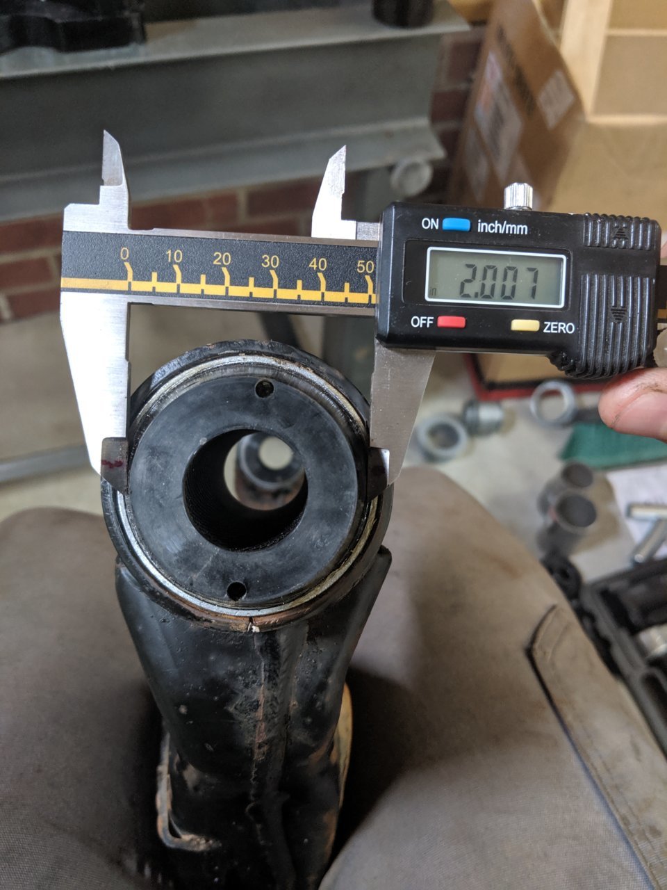

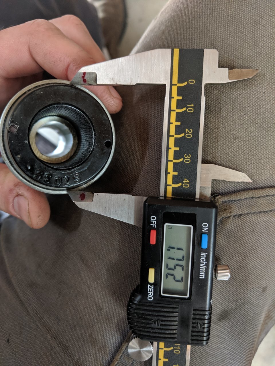

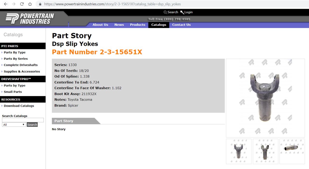

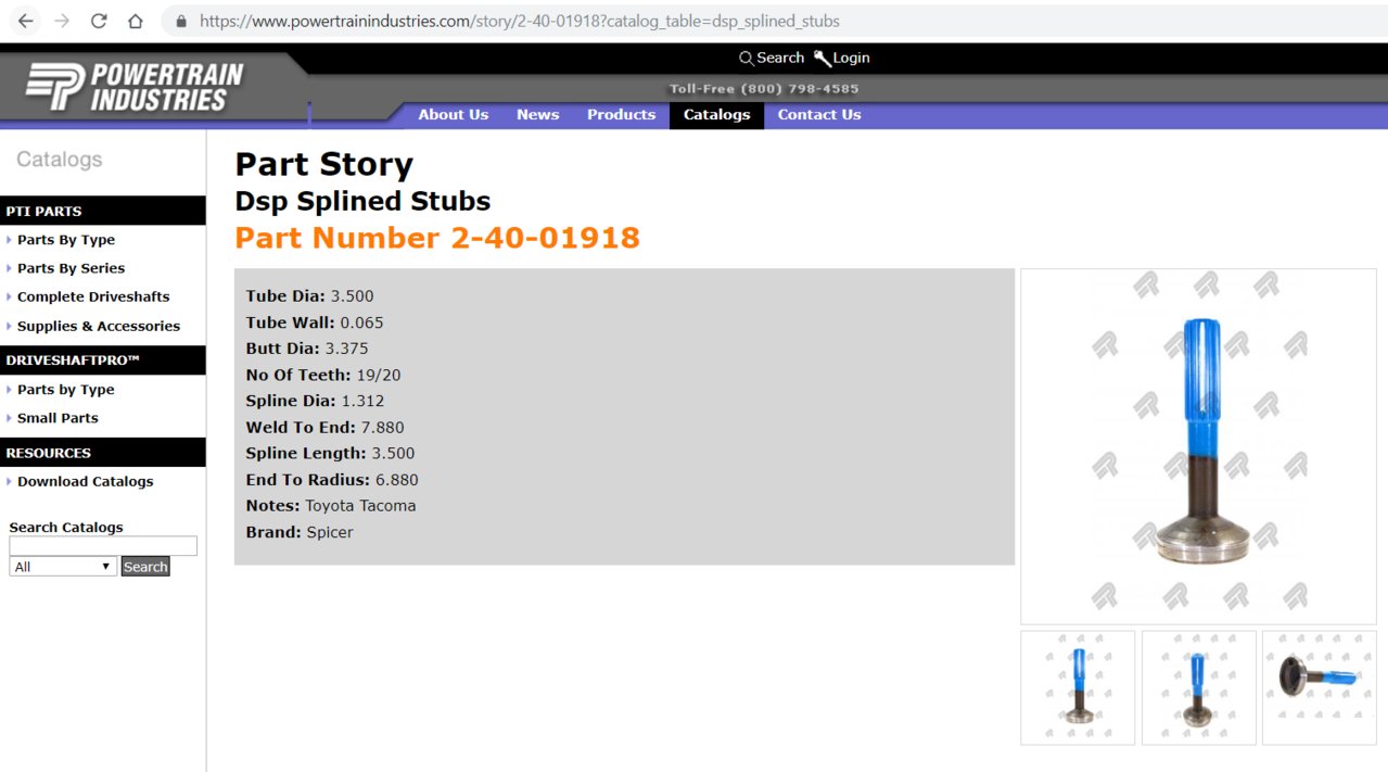

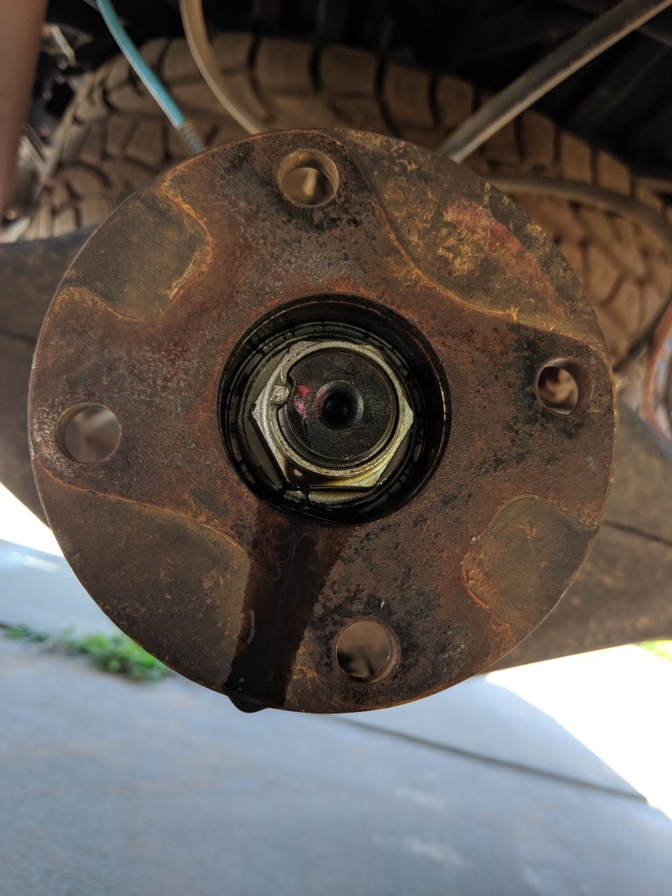

    Now back to some real work/research. I pulled the rear section of the shaft out and it looks like the Blue coating is worn pretty bad, and the Pinion seal on my rear diff is leaking.. I threw in the rear section that broke a while back at URE and I had Olivers Drive Shaft retube and the clunking is gone(The blue coating on this one is cracked down the length of the splines on a couple splines).
    IDK if it would be worth it to have the Slip Joint replaced so I started researching..
    Starting on Driveshaftparts,com I found some diagrams of how to measure the Slip Joint splined Stub and Yoke. Gathered up all the measurements and started looking, they didn't have anything that matched. I jumped over to Drivetrainamerica,com and they don't make it easy to search through all of their listing so I got on their Live chat, they asked for a part number to see which shaft I needed parts for so I gave them the casting number on the Slip Yoke C2-3-3079. While I waited on them I googled that same number and came across fortwayneclutch,com which gave me Spicer 2-3-15651X. More looking around I found https://www.powertrainindustries.com and it looks like the matching Spline stub is Spicer 2-40-01918.
    https://www.powertrainindustries.com/story/2-40-01918?catalog_table=dsp_splined_stubs
    https://www.powertrainindustries.com/story/2-3-15651X?catalog_table=dsp_slip_yokes
