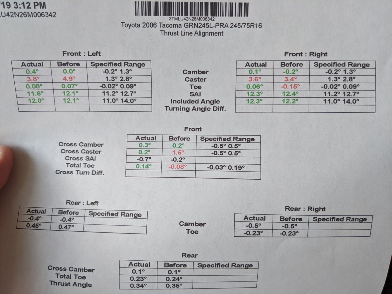

    That's about as close to perfect as you can get an alignment with adjusting for road crown and everything! Wish I had a guy near me that could get them that good.

    Yea, took me long enough to find someone. Now I'm gonna go clean off my old marks and add new ones.

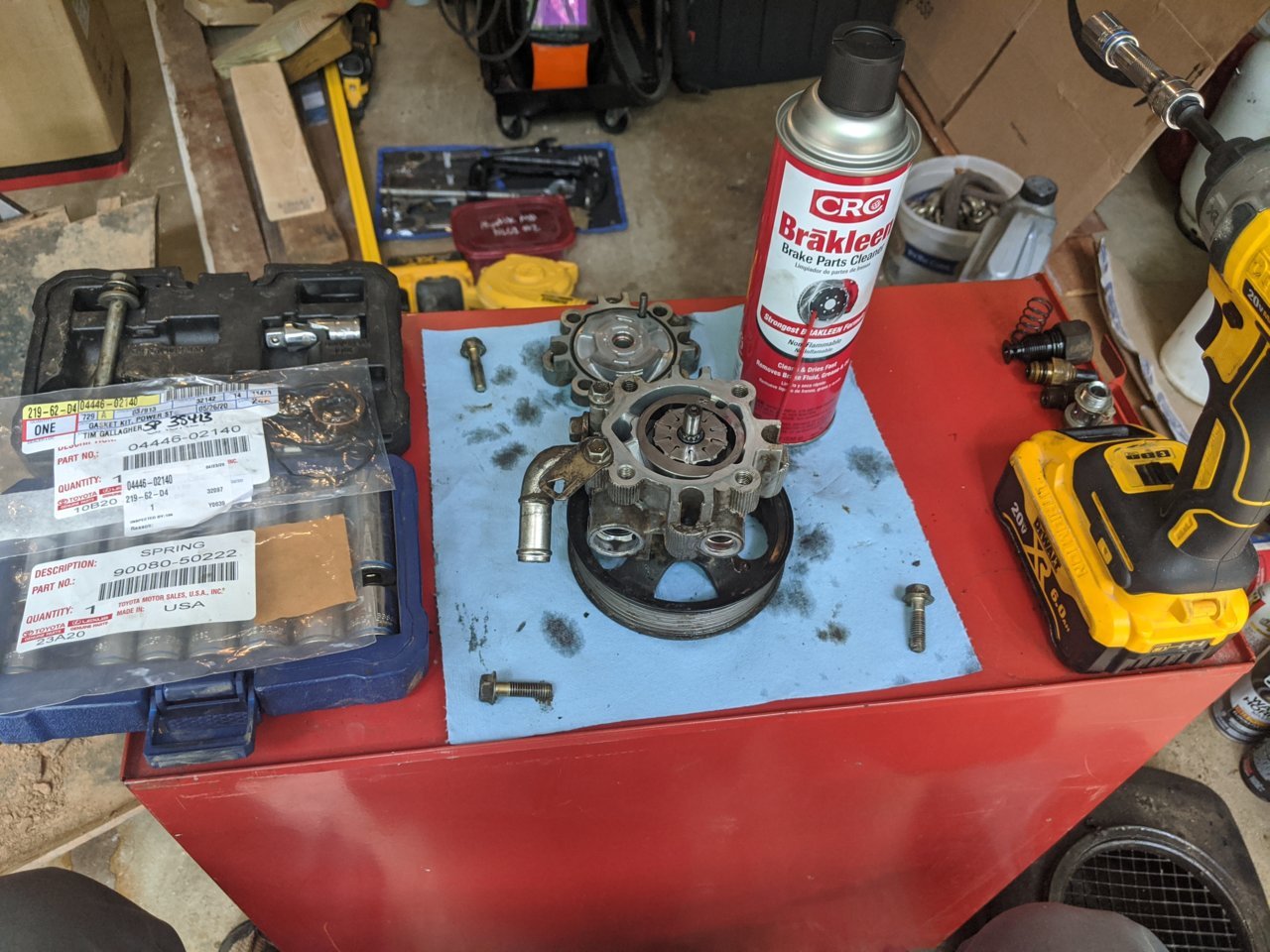

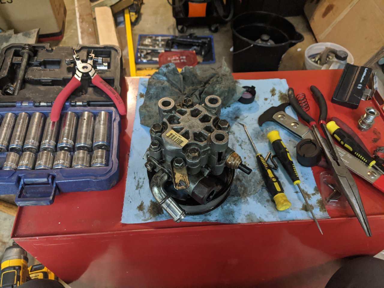

    Decided to try to wait on the steering rack replacement and stumbled on this power steering pump rebuild thread, figured for $20 it'd be worth it.
    https://www.tacomaworld.com/threads/2nd-gen-4-0l-power-steering-pump-rebuild.568779/
    Well maybe that's at least part of my problem

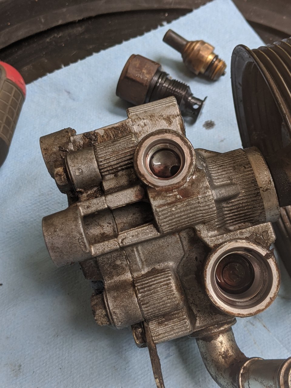

    Minimum spec on the power steering "pressure return?" spring is 36.9mm, new measures 38mm, old one measures 30mm.
    ** Flow valve assembly Mark D **
    Power Steering Pump Seal Kit 0444602140 $19.89
    SPRING, COMPRESSION(FOR FLOW CONTROL VALVE) 9008050222 $0.87
    BOLT, WITH WASHER 90119A0135 $4.56

    Garner, NC/Boone, NC

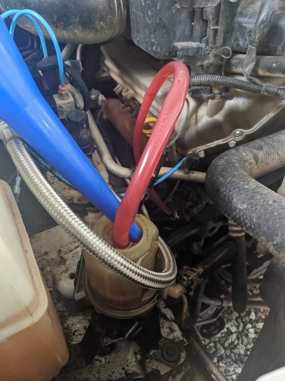

    I stepped in the full oil drain pan to top off the night..

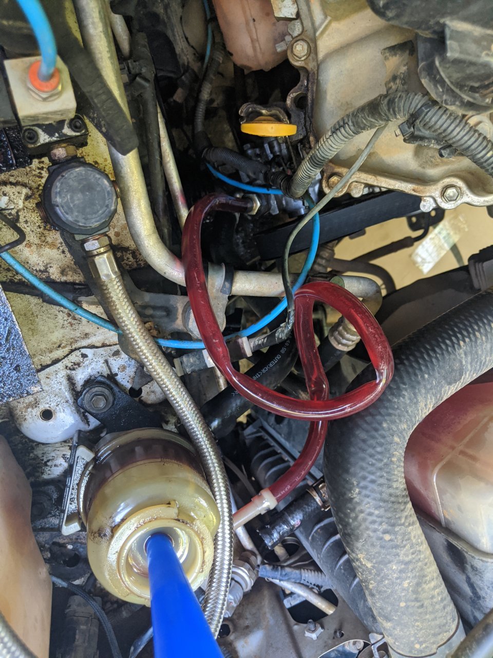

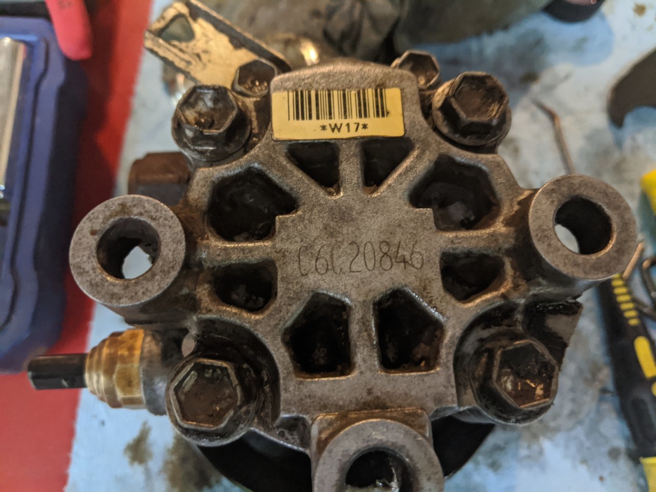

    Looks like the new in spec flow control spring is too good. After several tests the pump is shot, can't build enough pressure. So it's back together with the old spring(at least I have some steering) and ordered a Delco 36p1009 reman from Amazon. Now we wait... Because it's temp out of stock

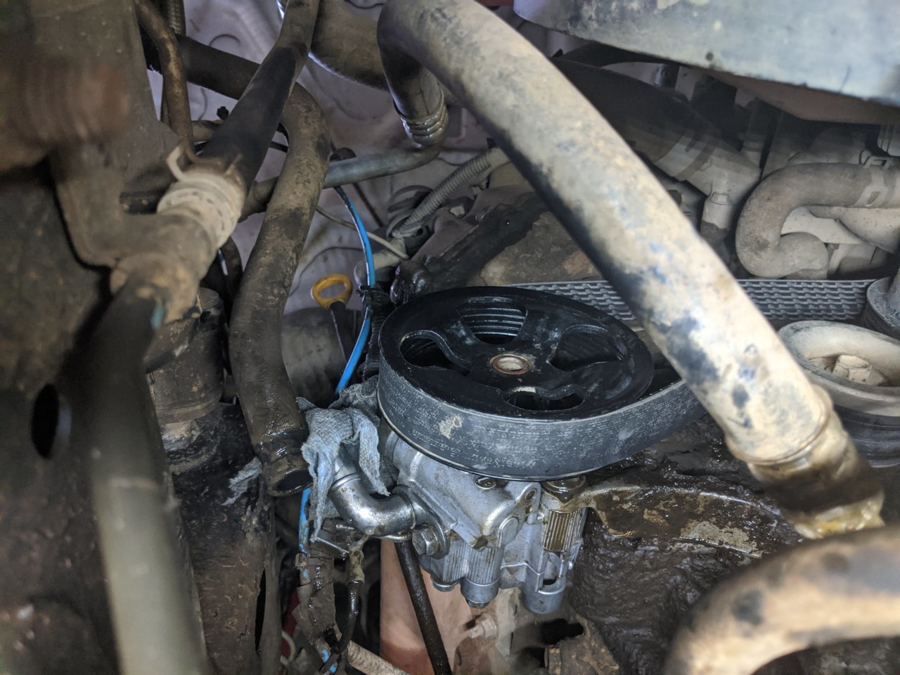

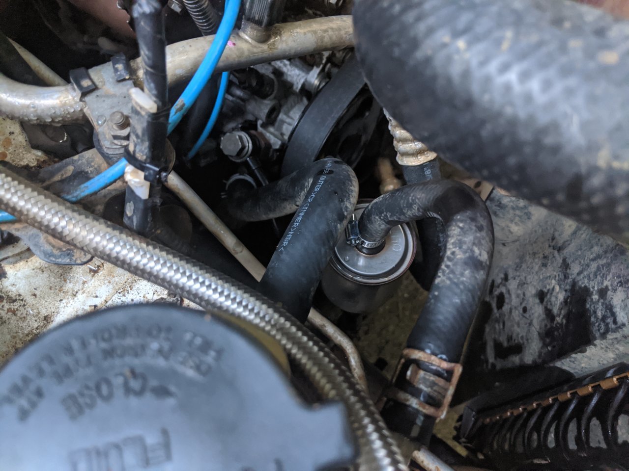

    Well putting the pump back together with the old spring was better but still worse than before. Ordered a pump from Amazon (temp OOS) which I'm still waiting for.. And ordered one from LKQ which just showed up, pumps beautifully, and after dropping in an inline filter I have glorious power steering again! If the Amazon one shows up I'll send the crapped one off for Core charge and have a backup!
