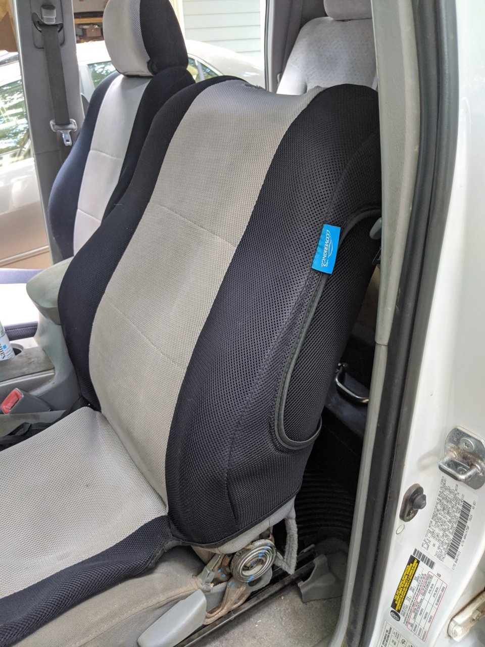

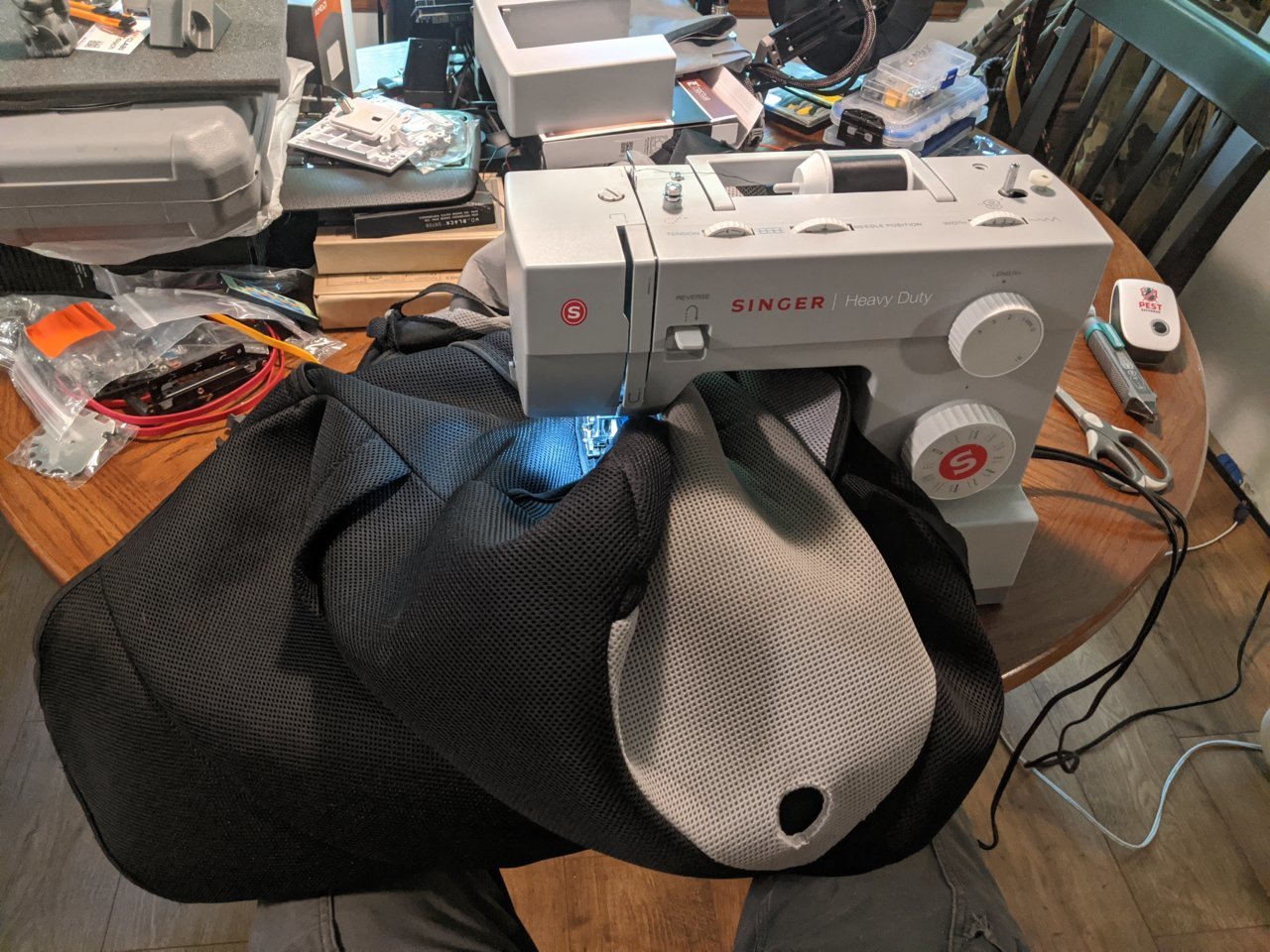

    Finally took my seat covers off to wash them and decided to sew up the weird side flappy bit flapping open. The seats(from eddys truck) have airbags, but my truck isn't wired for them.

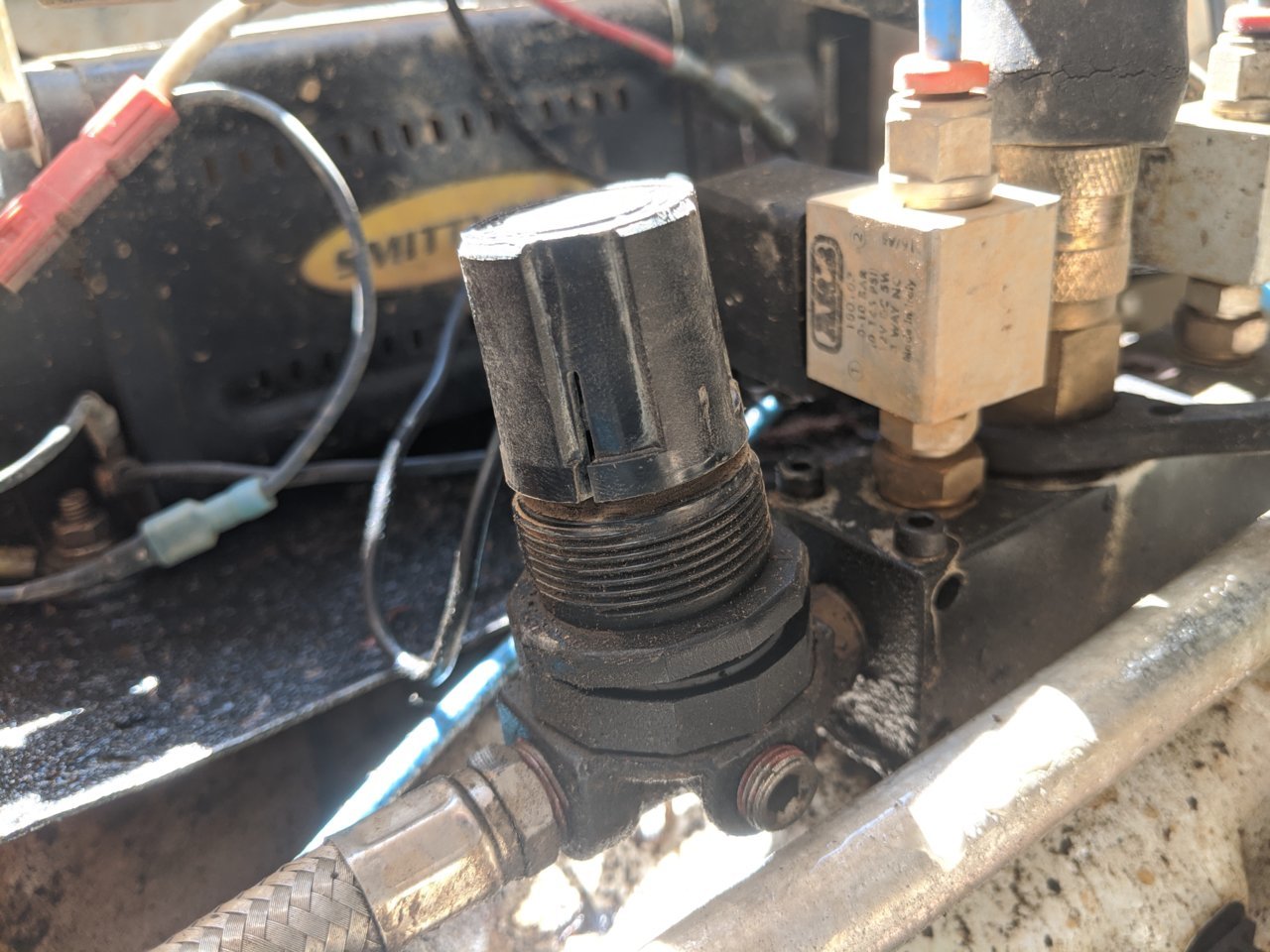

    I guess it's time for OBA maintenance.. The other weekend at URE the blue line to my rear locker popped off the diff fitting and today while checking my diff breather vent the regulator gave up..

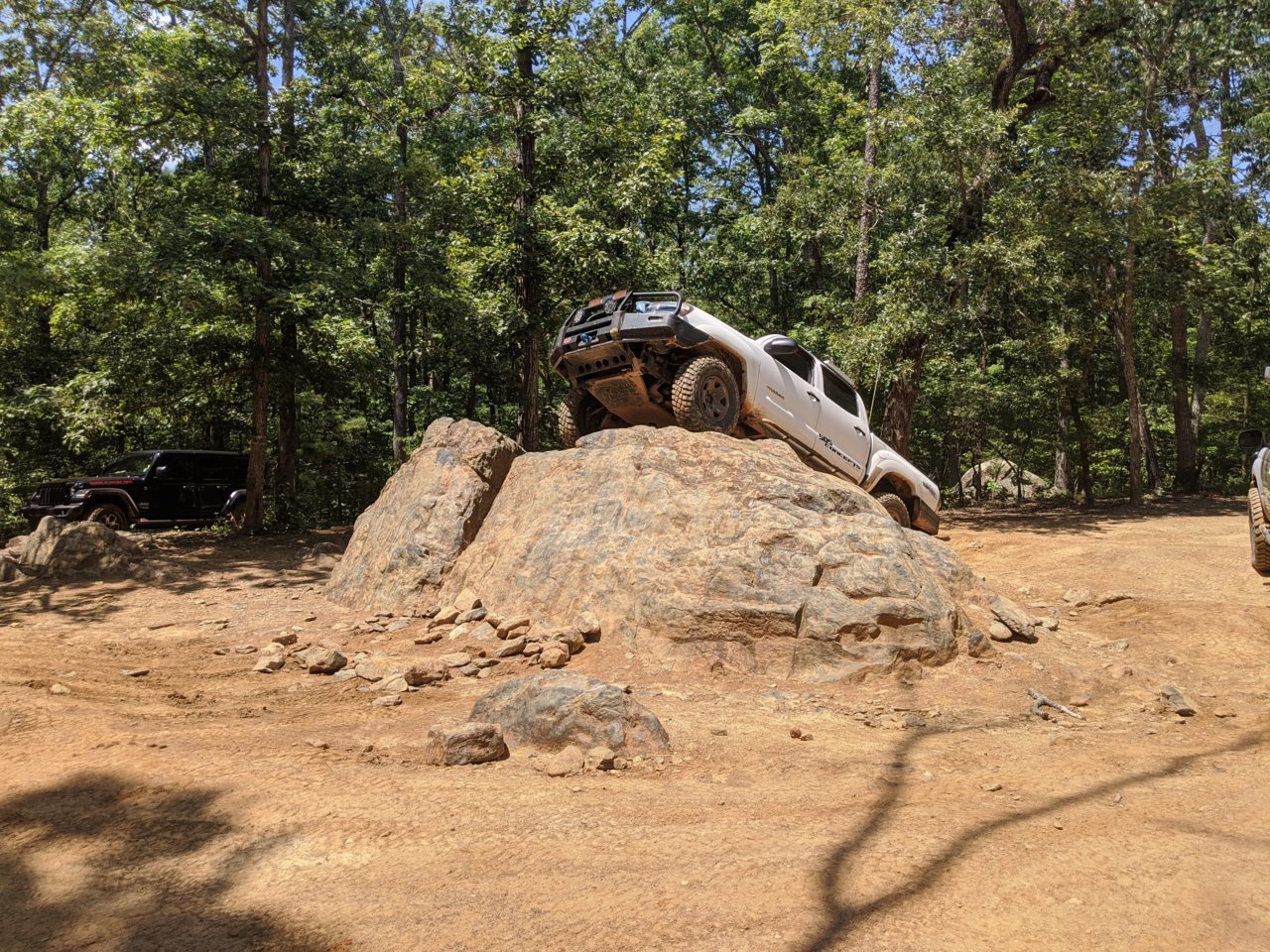

    #actionshots from URE this weekend, climbed poser rock.

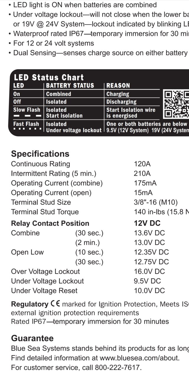

    Finally attempting to tackle my low alternator voltage/dual battery ACR connecting/disconnecting issue.
    The ACR needs to see 13.0v(2min) or 13.6v(30sec) to combine and 12.35v(10sec) or 12.75v(30sec) to disconnect.

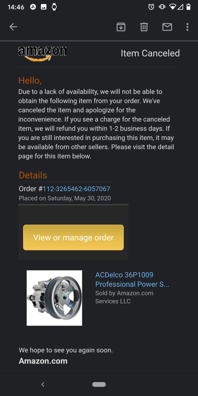

    Stupid covid19 :rofl: this power steering pump was a great price.. I was hoping they would have just kept the order until the finally got one back in stock.

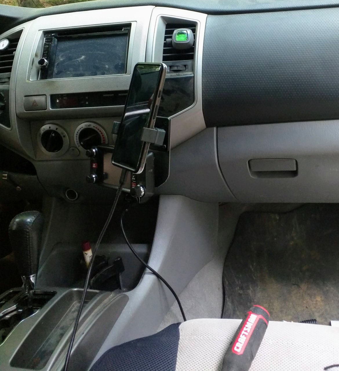

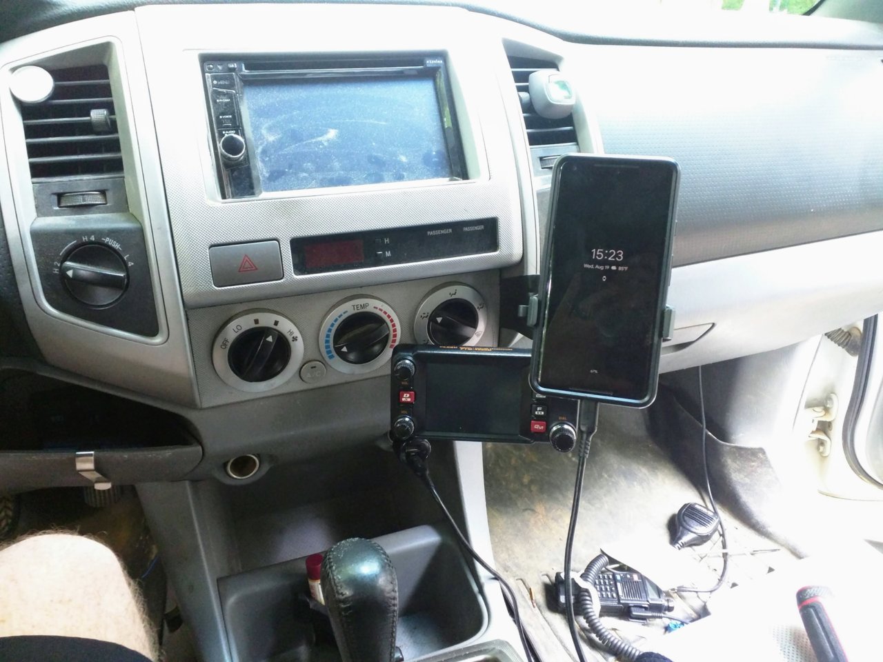

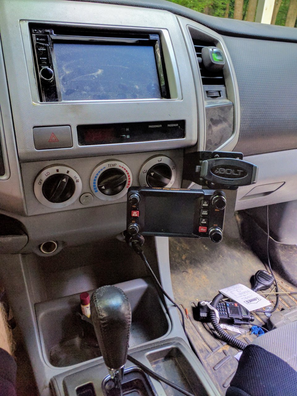

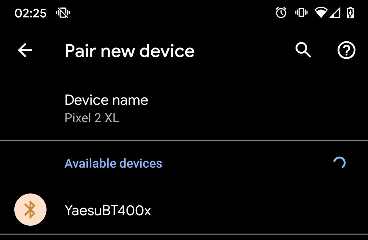

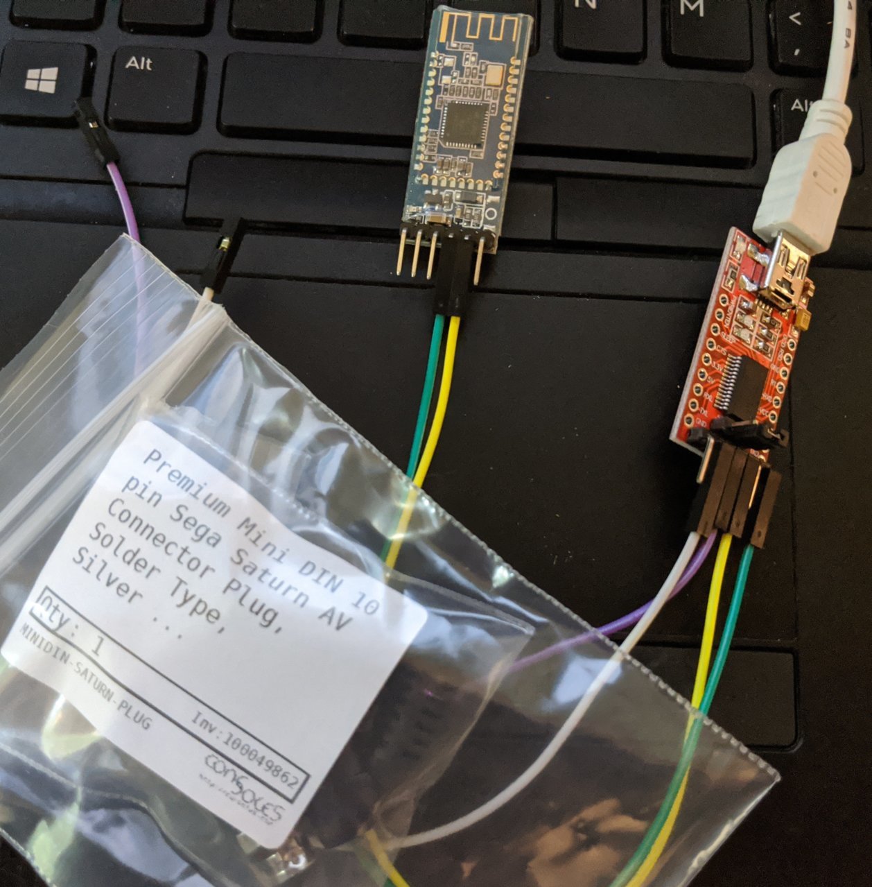

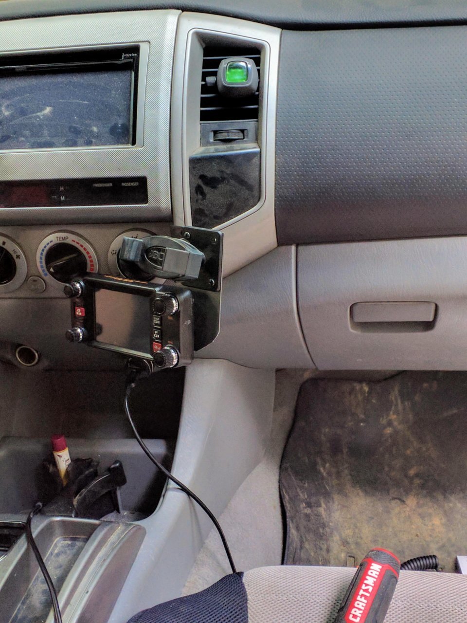

    Figuring out this serial-Bluetooth adapter for my new mobile HAM radio has been interesting. The adapter is a chinese knockoff, the ftdi serial to usb programming adapter is a Chinese knockoff that apparently windows drivers will brick, and Yaesu(ftm-400xdr) uses rs232(+/-12v) serial while the Bluetooth adapter uses TTL(3.3v) rs232 serial. Lots of little gotchas and nuances involved.
    :rofl: after several hours of playing with stupid Fedora live usb without persistent storage I turned around and used my wife's Mac to change the Bluetooth name...

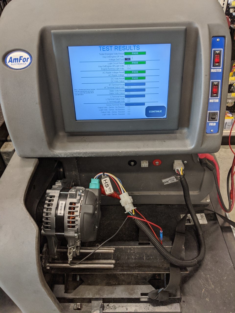

    Grabbed a new towing 130amp alternator off ebay. :rofl: I put it in my watch list and the seller sent me a lower offer, so since he is so interested in selling I gave a counter offer. He accepted it, messaged me showing pictures of some damage to the back plastic piece he didn't notice before and asked if I still wanted it. I asked for a partial refund for the damage and he agreed. Original asking price $150 +15 shipping, he offered $130 plus shipping, I countered with $100 plus shipping, and ultimately he agreed on $80 + shipping...
    Now I'm sceptacle as hell, but the thing looks brand new(factory refurb). Got it in, took it to Autozone to get it tested.. Their machine was down, went to another... They tried to test but their machine wasn't working, they called 2 more stores and their machines were down, a 3rd store was able to test gave me fail/replace with no other info or numbers. Autozone is garbage.. Called Pep boys and the kid that answered was beyond useless, Napa is closed til Tuesday... Called advance and their machine is working, went there, they had no issues, the alternator passed, and they could show numbers.

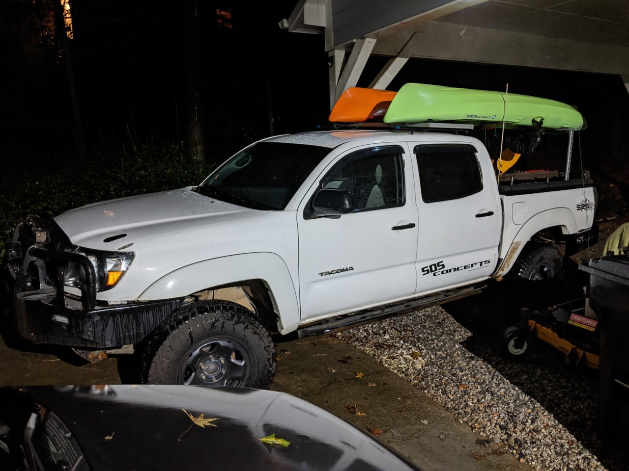

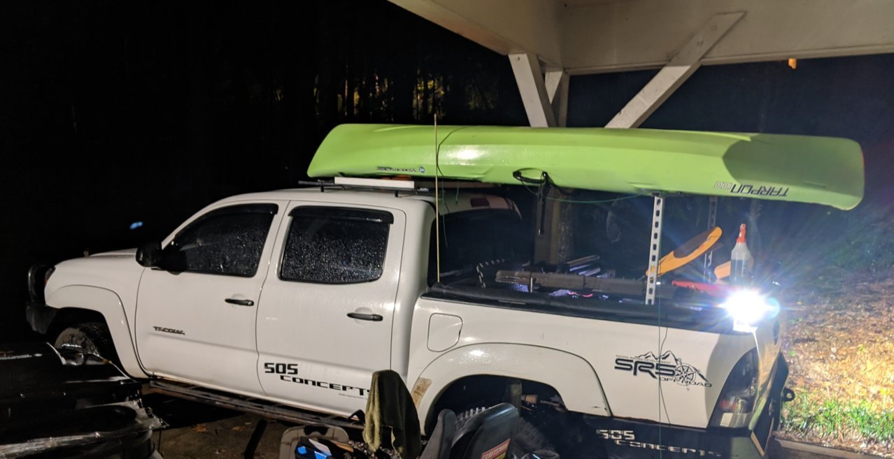

    Yakety Yak! Made a quick kayak rack out of uni-strut. I still want to make a crossbar for the front, but the maiden voyage is tomorrow morning.
