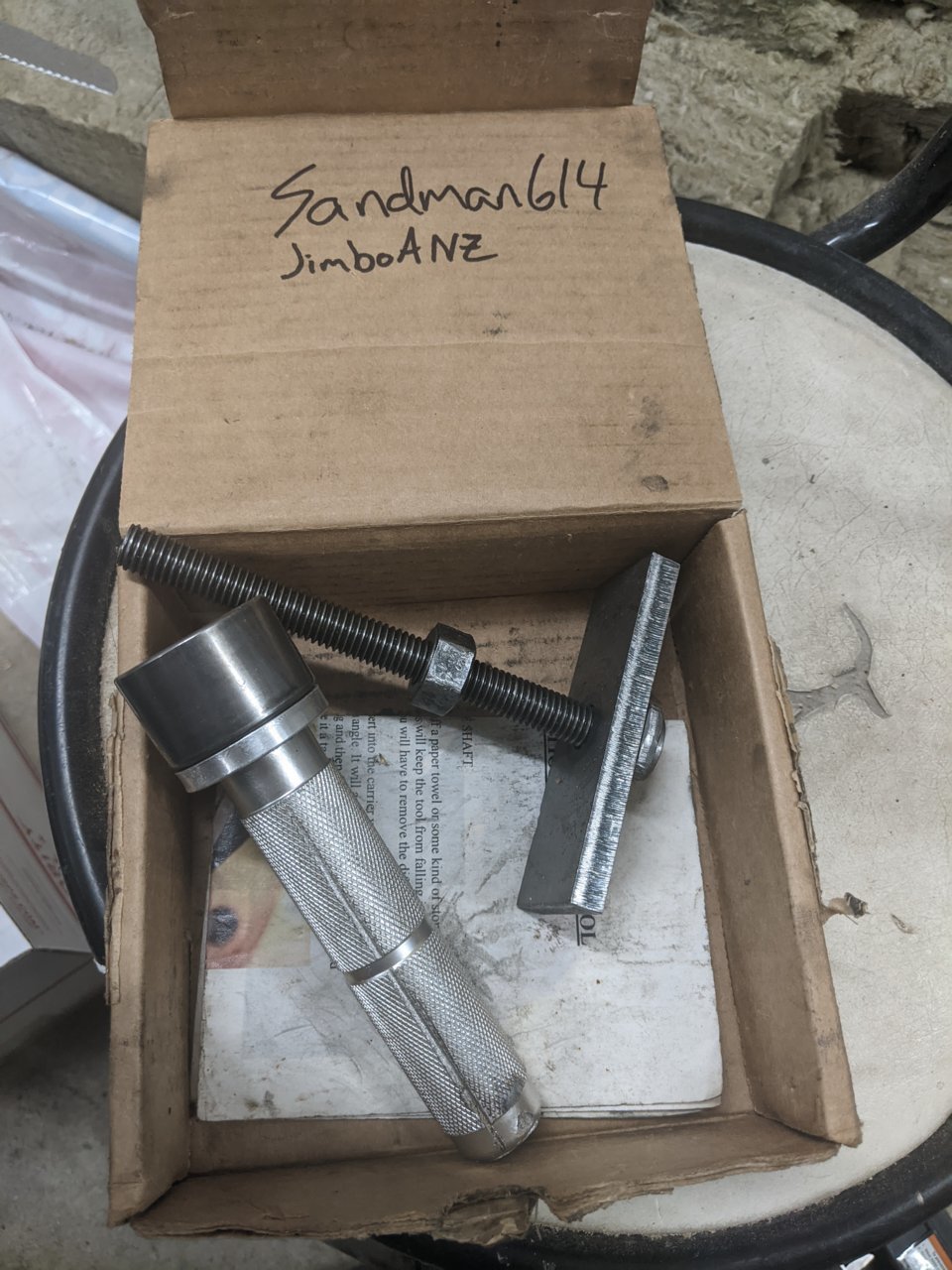

    #foolwithmytool
    @bradleg coming at you, ECGS puller, driver tool, and stock bearing someone left in the box :rofl:

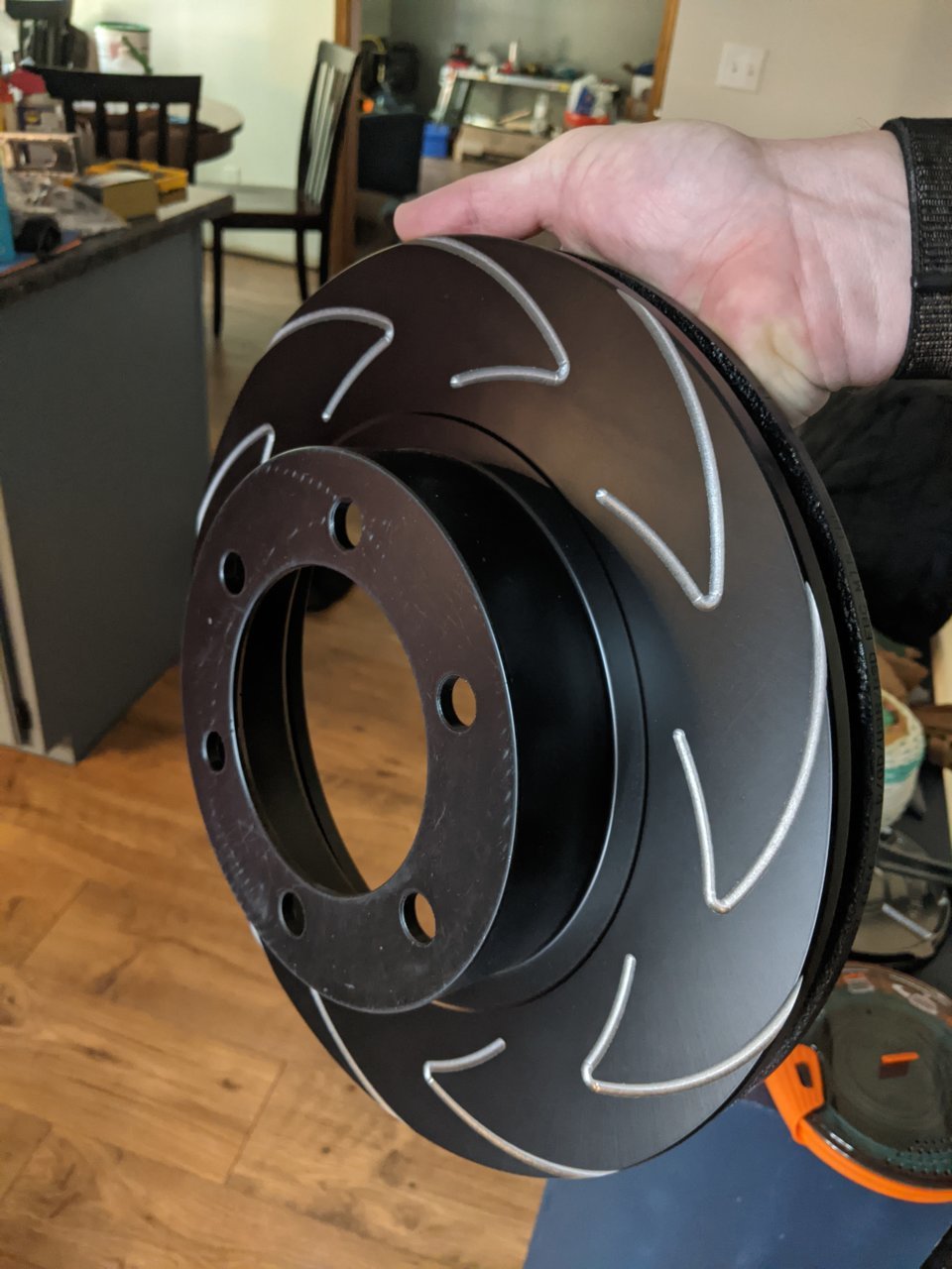

    Picked up these EBC BSD7237 Blade Rotors since I wasn't able to finish the checkout process on AdvanceAuto website for the same Stoptech Rotors I had. Gonna pair them with a new set of Hawk pads.

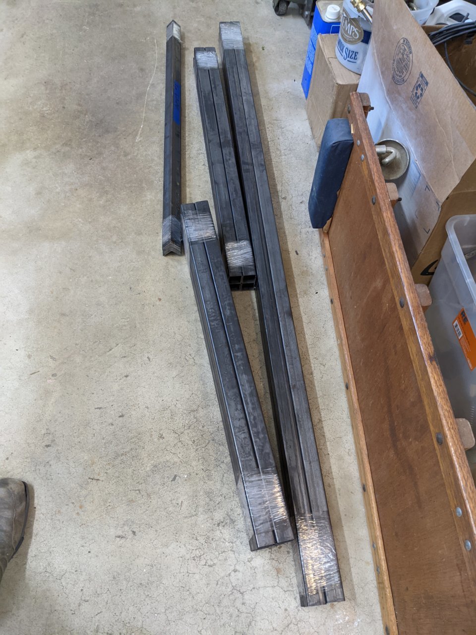

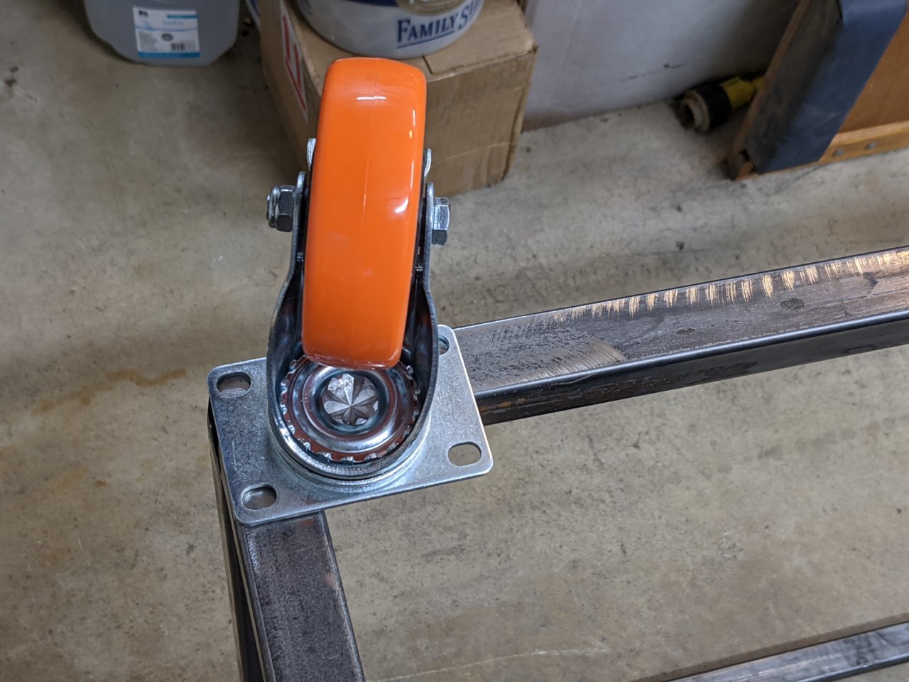

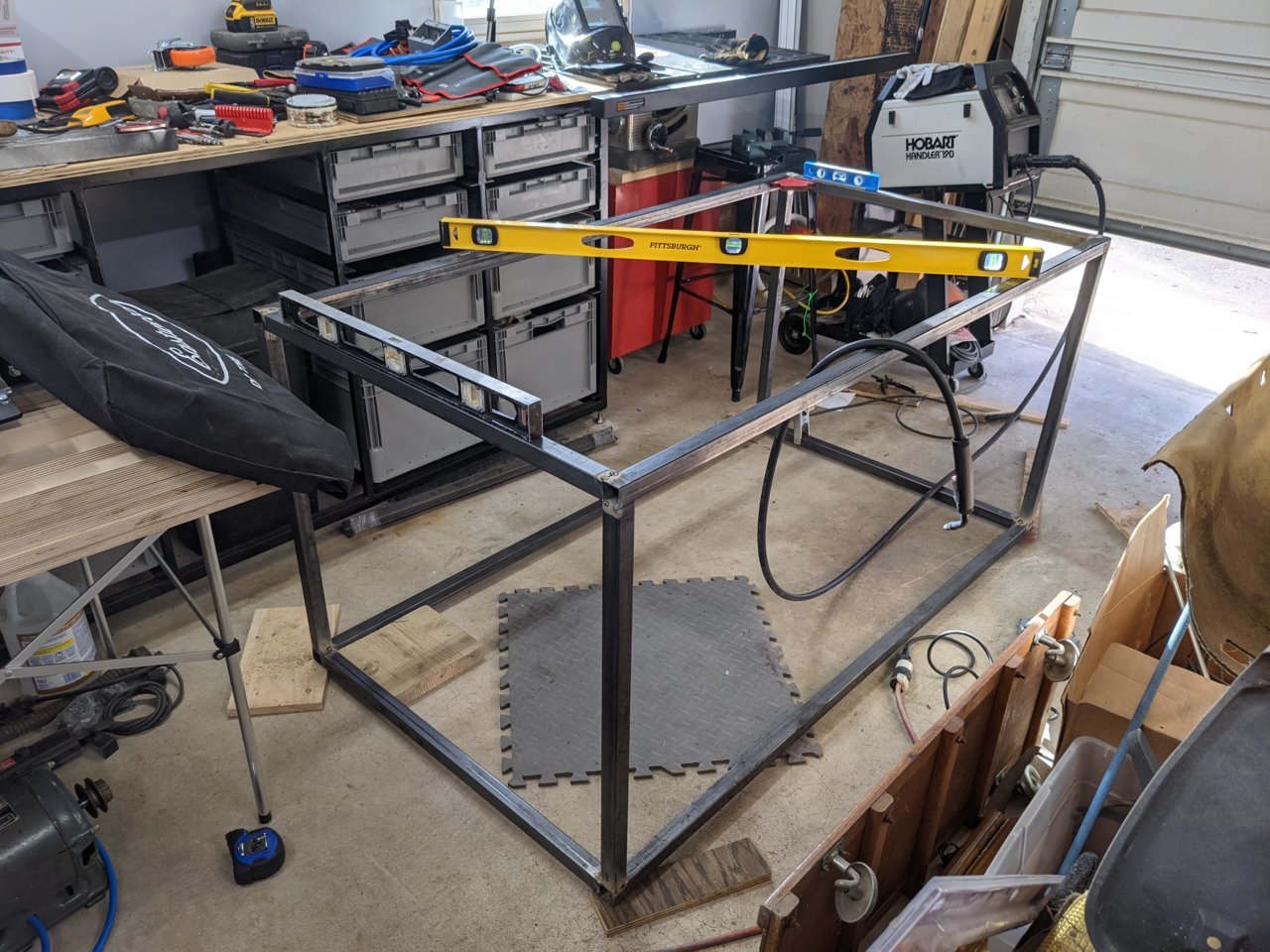

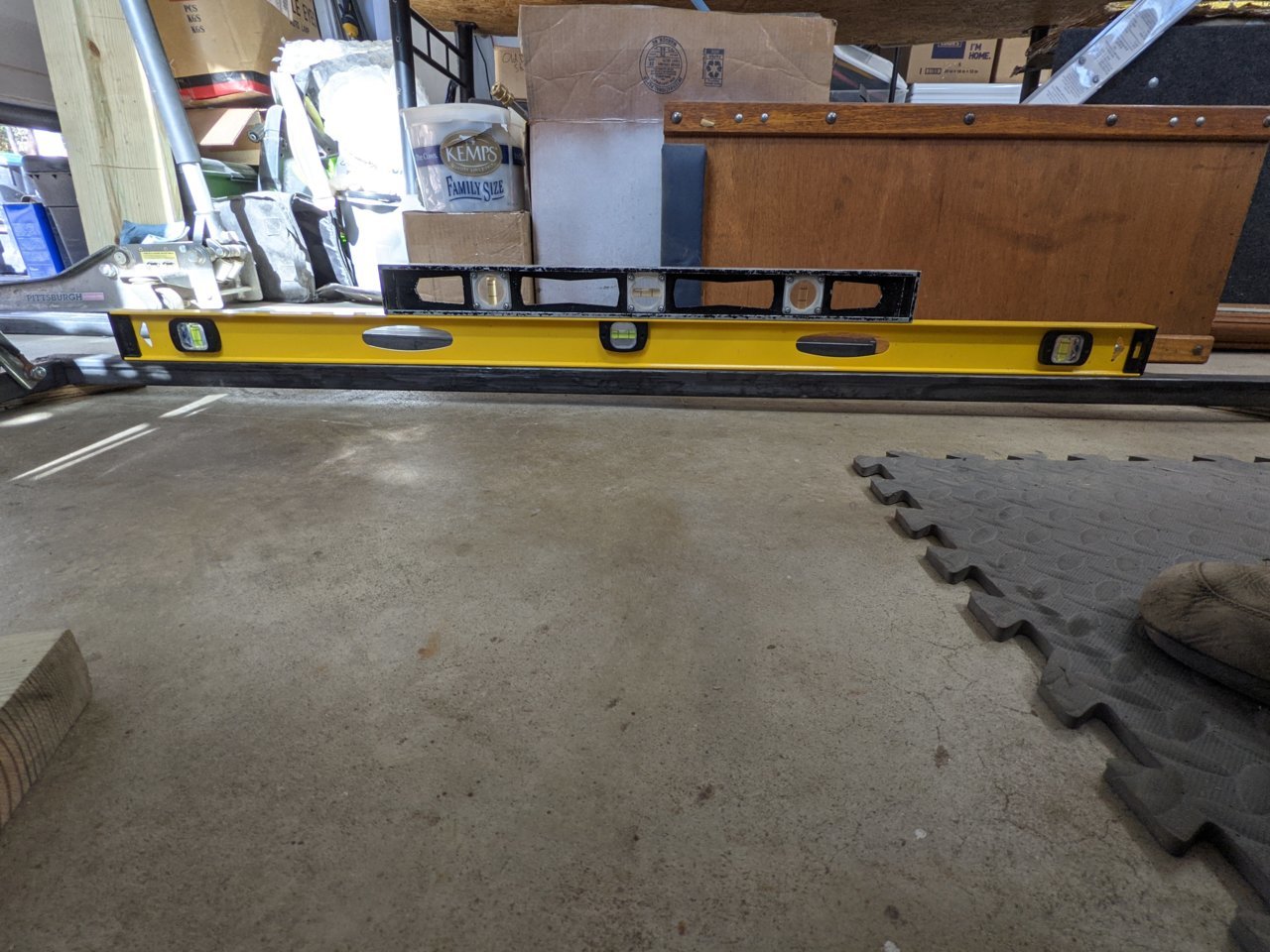

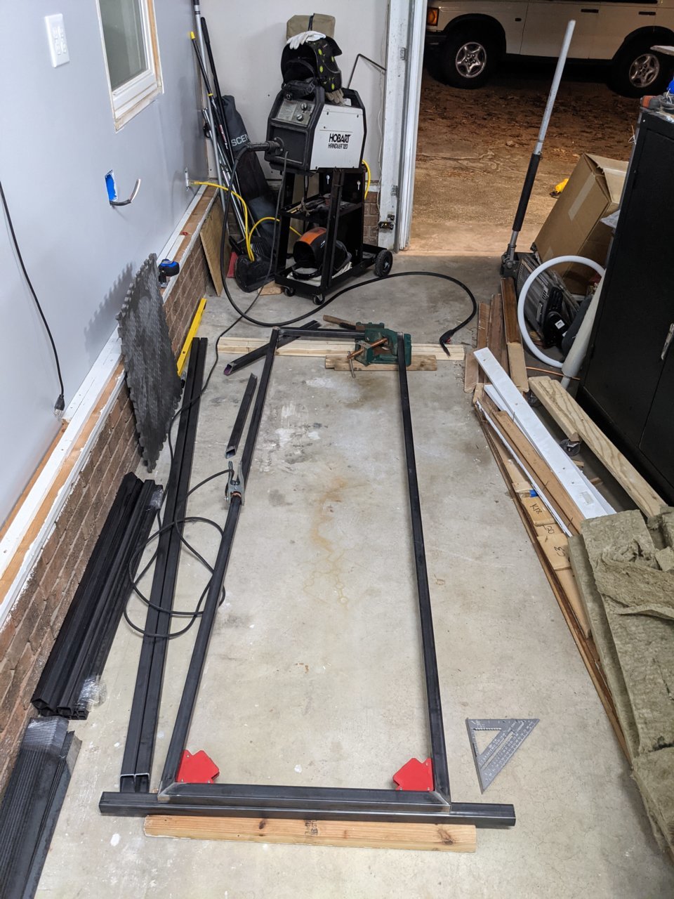

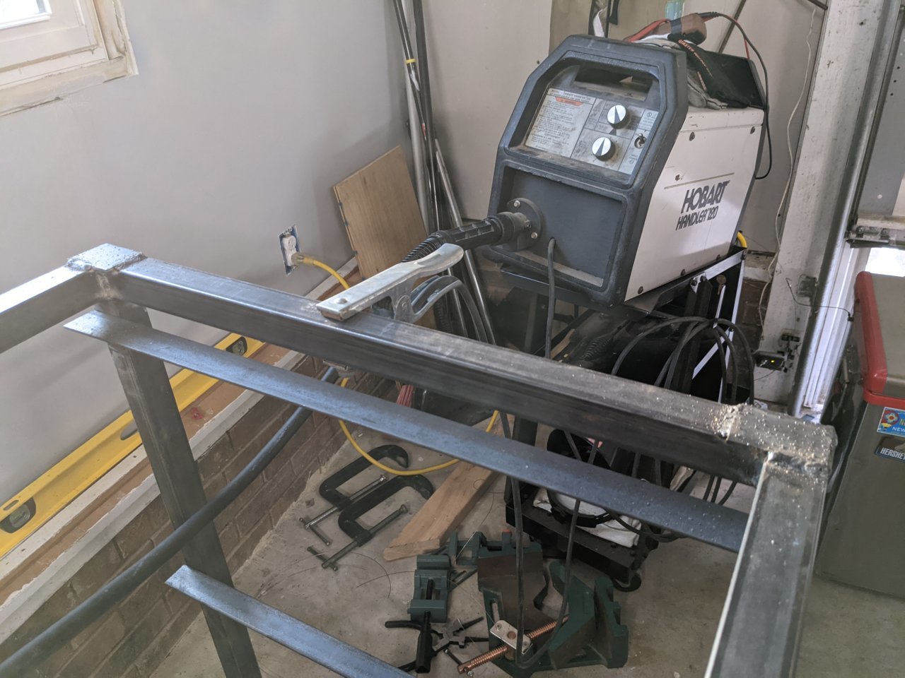

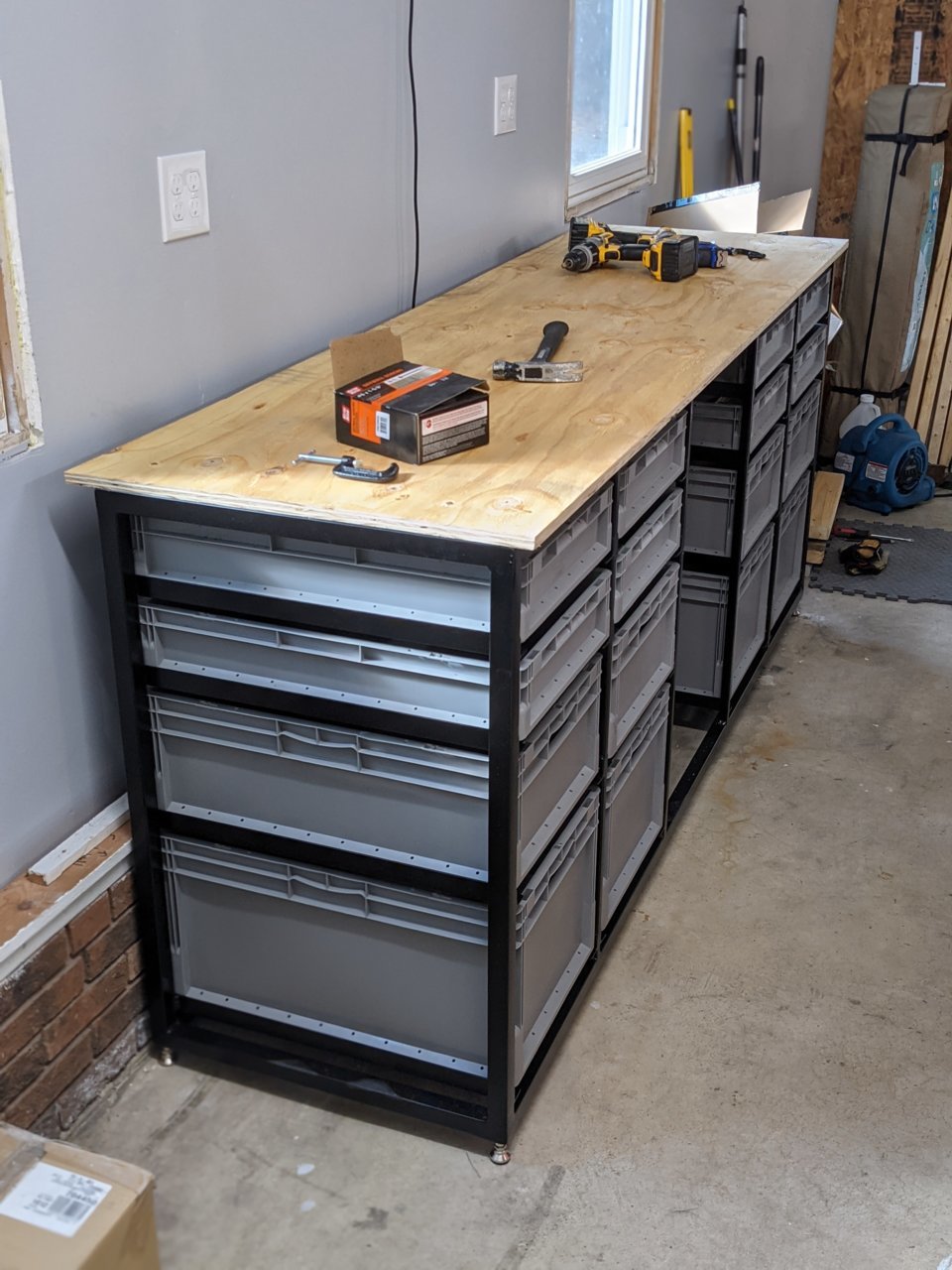

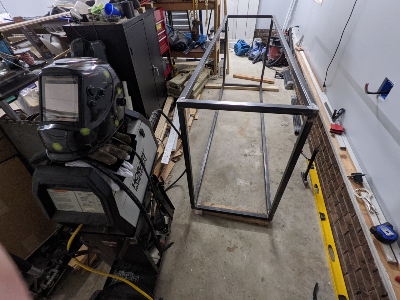

    #Workshopbuild
    One workbench please :rofl: some assembly recommended.
    https://youtu.be/mk6ch1pNIfY

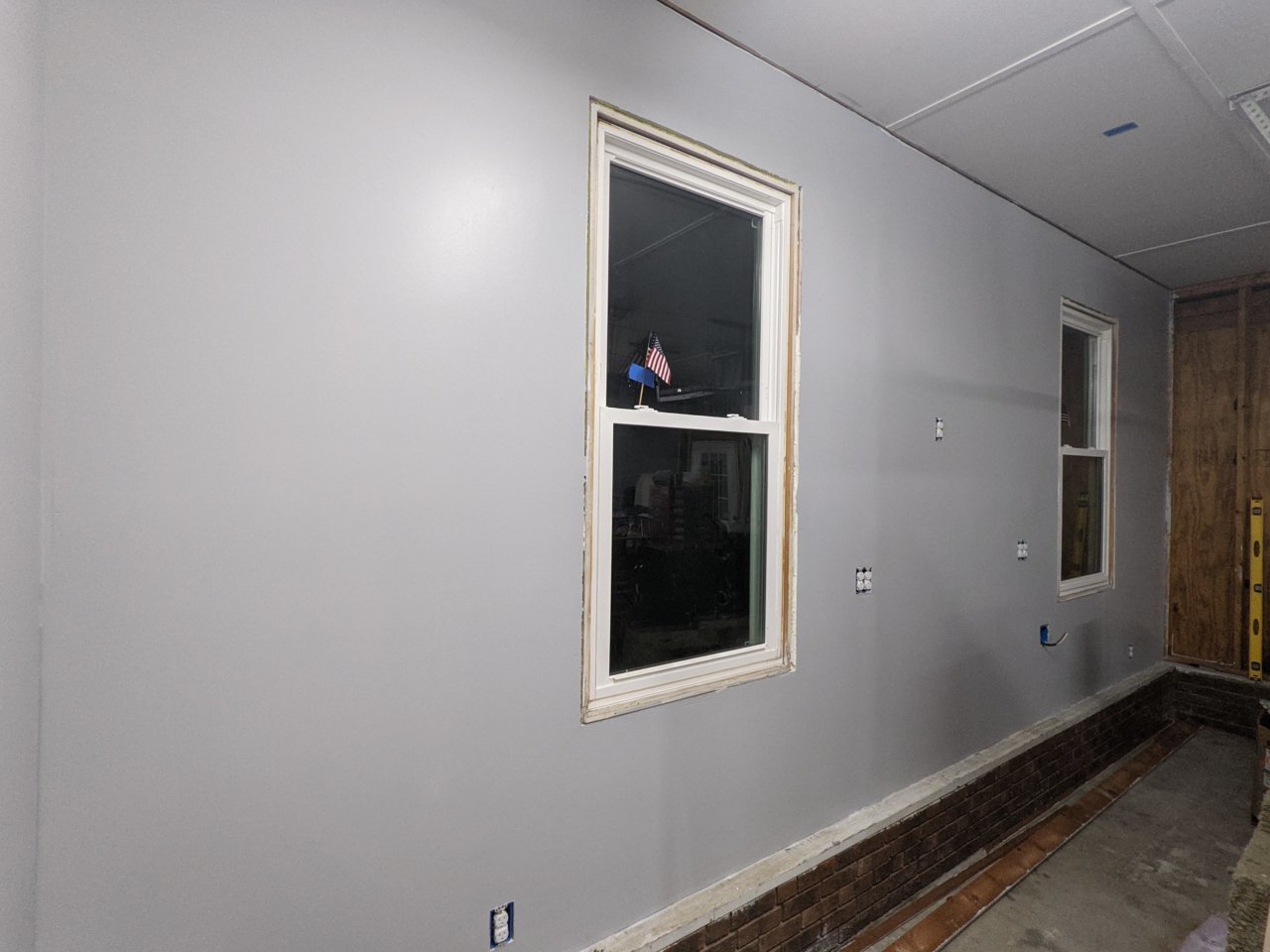

    I just redid my whole garage. Ran 2 6/3 to nema6-50 outlets on each side of my garage, through bored joist holes, ran 12/2 down each wall on seperate breakers, new light circuit for indoor lights, new circuit for outdoor lights, garage door sensors and button wiring in walls/roof. Not too bad of a job except for climbing over all my shit and moving it a dozen times..
    Getting started.

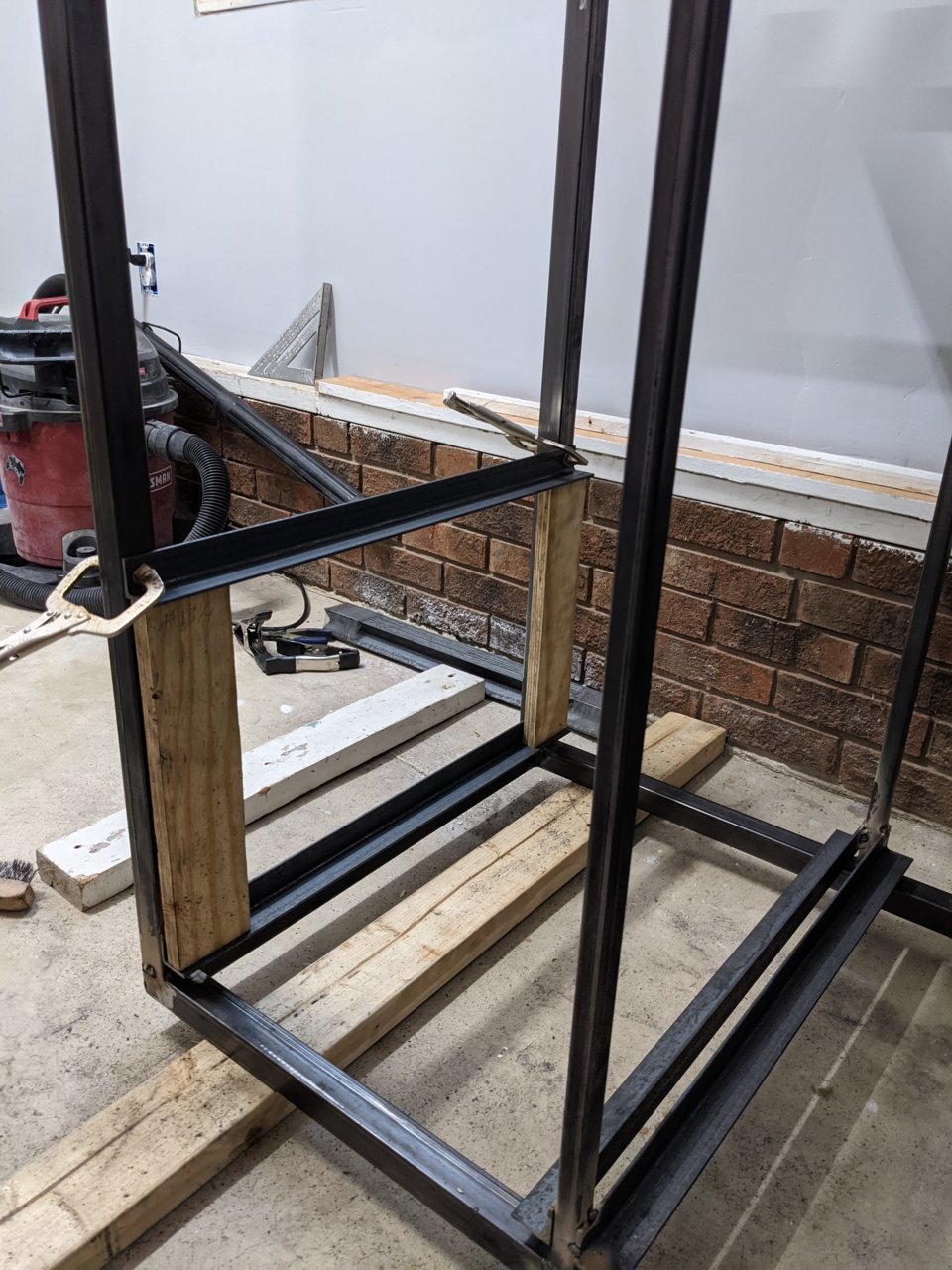

    Yeswelder hood, oldass Hobart 120 frankensteined back together with eBay euro whip and some other feeder parts.. Warped as shit!

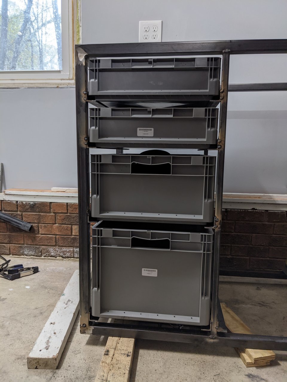

    Progress. Also realized I miscounted the pieces of angle I needed.. I need another 16ft :rofl:

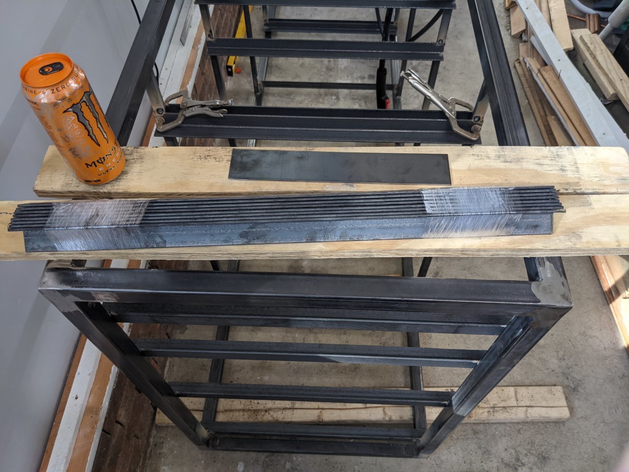

    Figured it would be best to "cap" the mitered corners with some plates before drilling and tacking on some nuts for leveling feet. Don't judge, it's Flux Core.. That'll be the last of the welding finally.

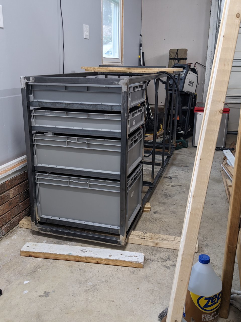

    'Finished' product I might find a piece of rubber or stainless for the top but it'll do for now. I've got a chainsaw to get to work on.

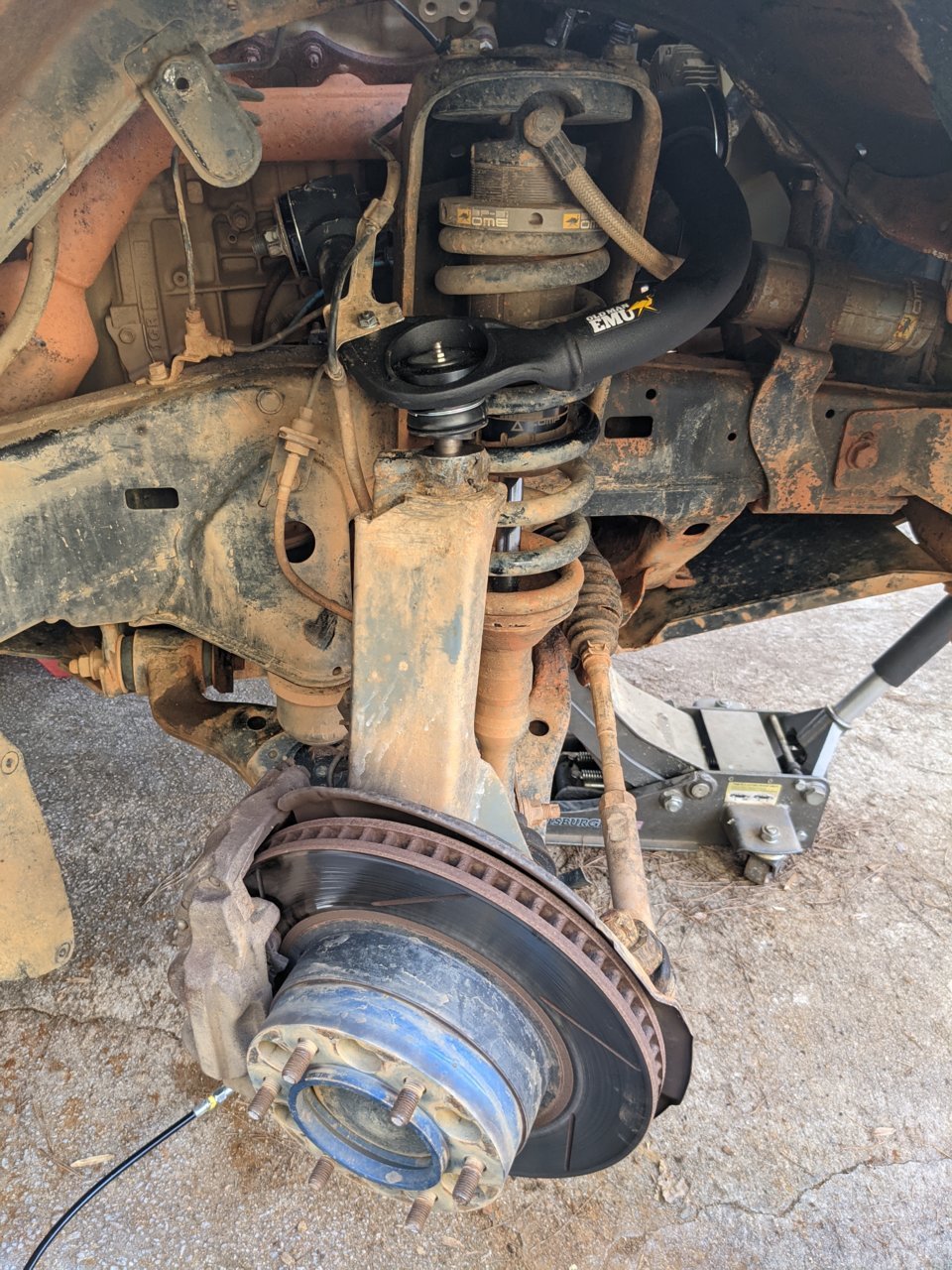

    These just look out of place.. OME UCA's are too clean

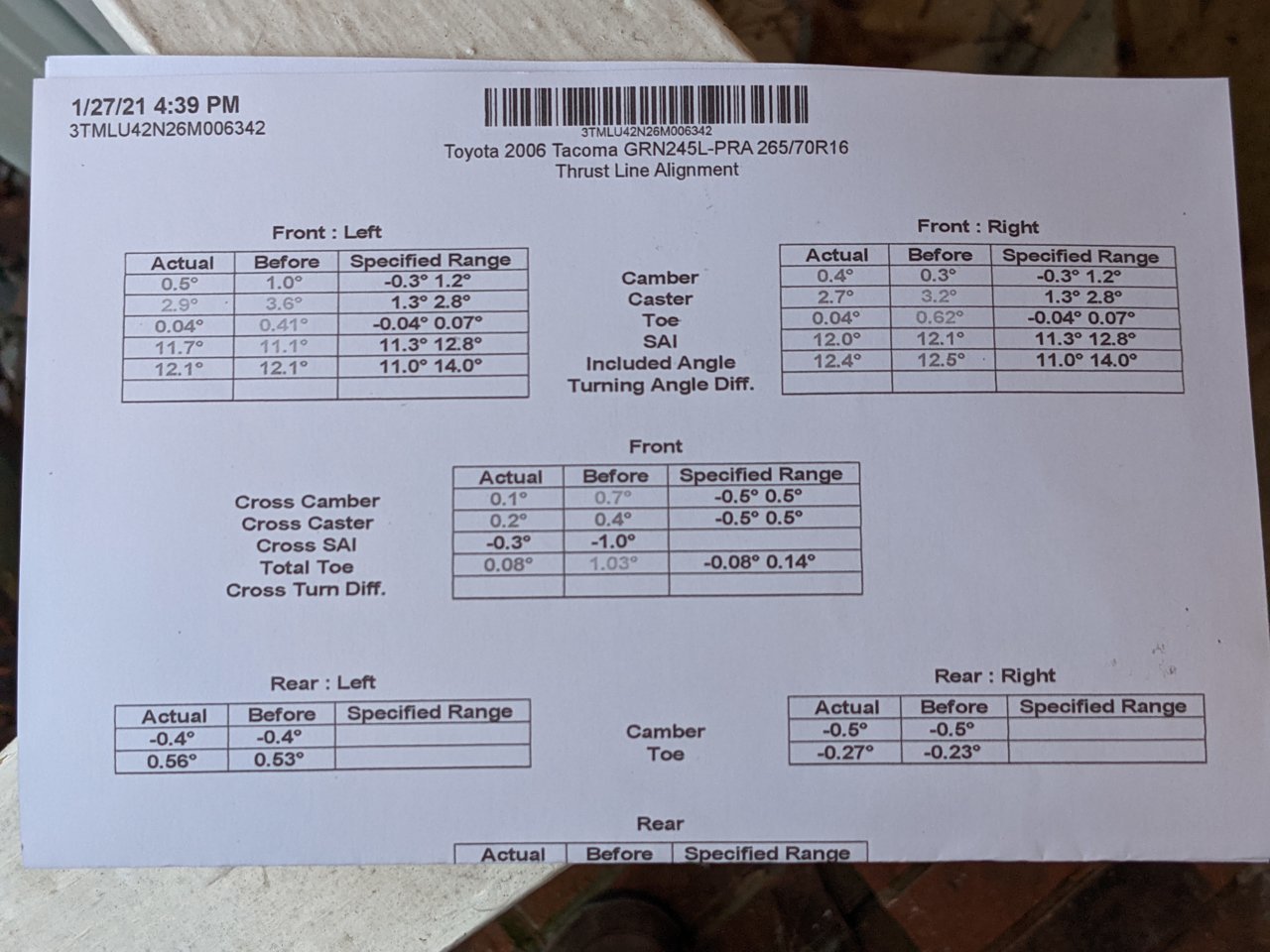

    #maintenance alignment after replacing the UCA's
