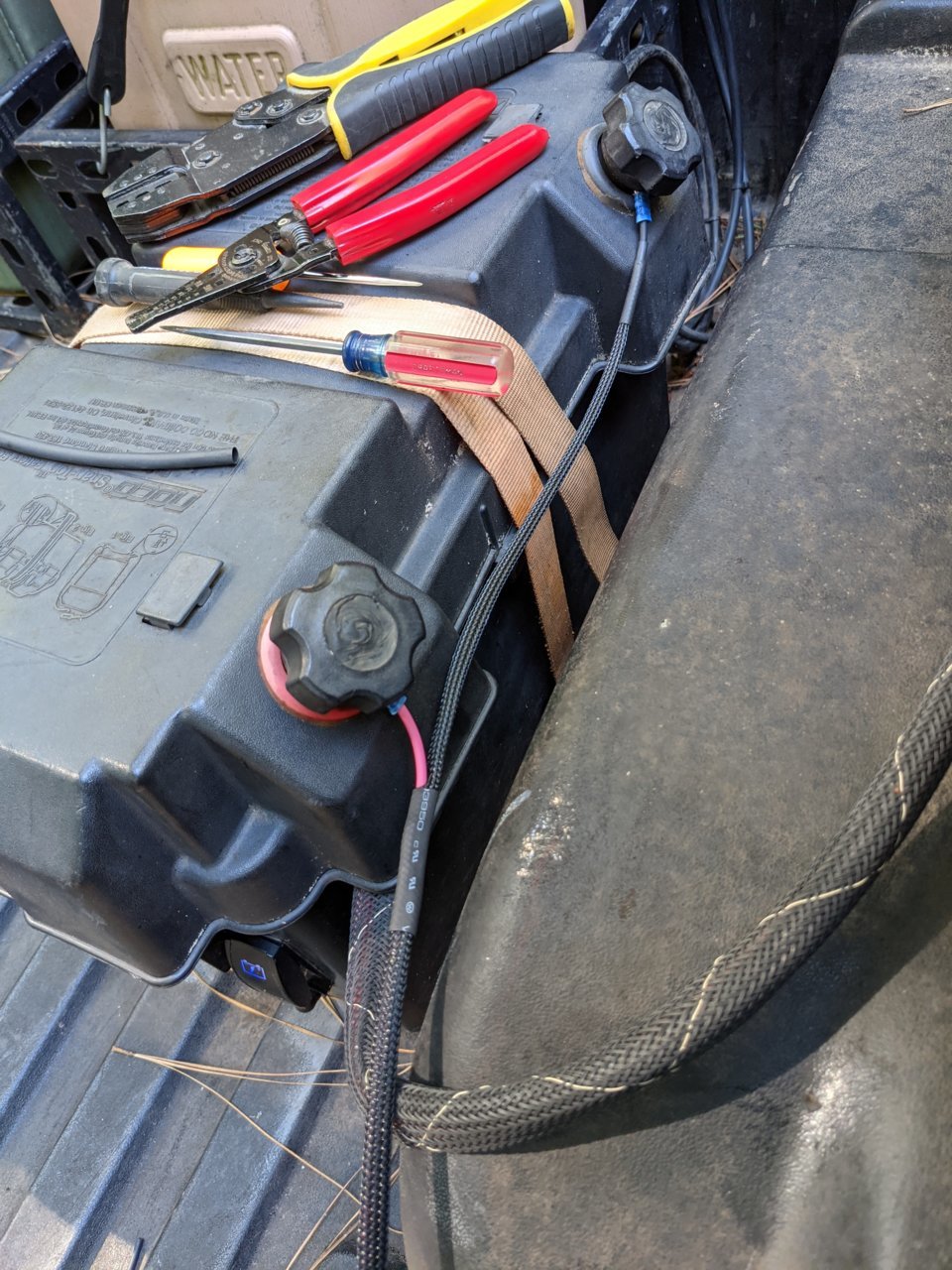

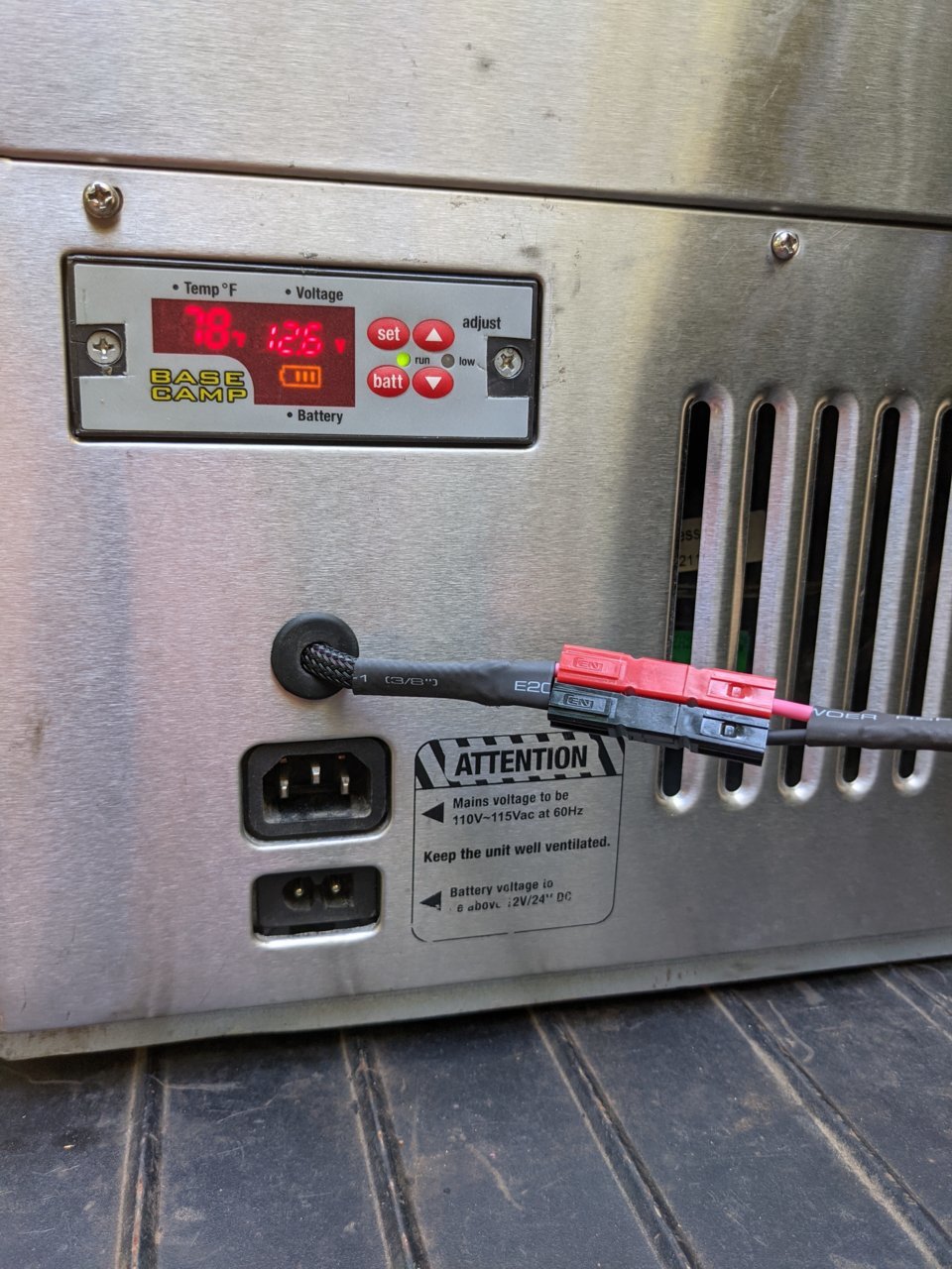

    Made a "hardwire" harness for the fridge. Unlike the cigarette lighter plug this can't be bounced loose and should be a much better connection(less resistance/voltage drop). Still can use the old plug If necessary.

    i actually like this idea. My fridge connection shook loose and threw a E1 code... restarted the fridge and everything was good. I wonder if i should go about doing this instead. The fridge and battery are about 2 feet away from each other.

    My cord had been pinched a few times in a few places so I opted for new wires and making a new connection inside. You could just snip off the cig outlet and put another connector on the factory cord. Also shortening up the cord will reduce any voltage drop.

    We had the same idea with the battery box. Do you have a blue sea on the inside lid of yours? I need to redo mine yet again. The last time I did, I only had red wires - for positive and negative :devil:

    Nah no fuse panel. Just some resettable fuses for the USB/12v outlets on the outside. Then the big main terminals on the top.

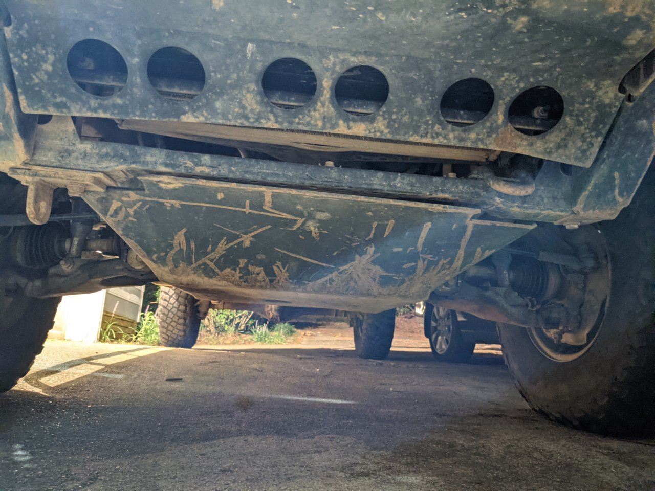

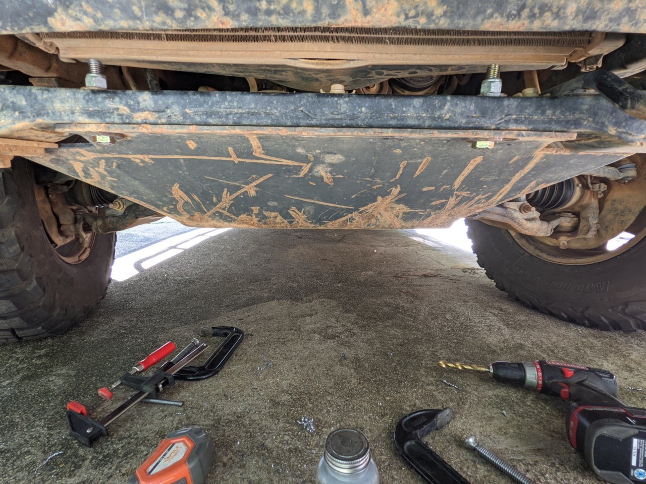

    Last time I put my skids back on I noticed these front two bolts didn't want to tighten up. So I got em close and left em. At URE last weekend I hear a big metal go a kinda noise :notsure: must have been a rock on the skid.. Then I hear it more.
