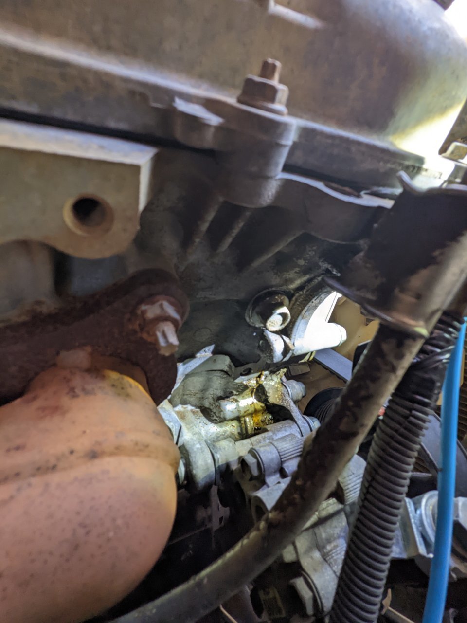

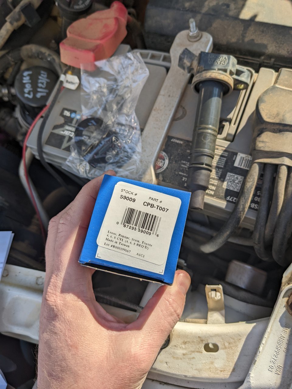

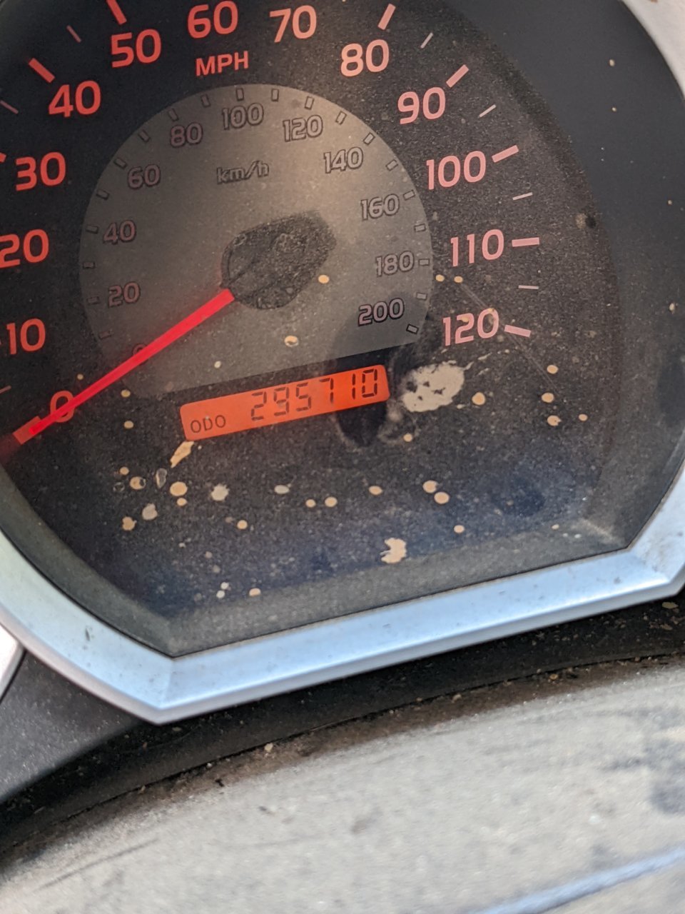

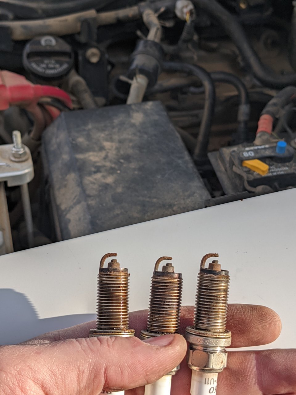

    3/20/21 281215 air filter
    9/23/21 290169 oil change
    1/27/22 295492 air filter

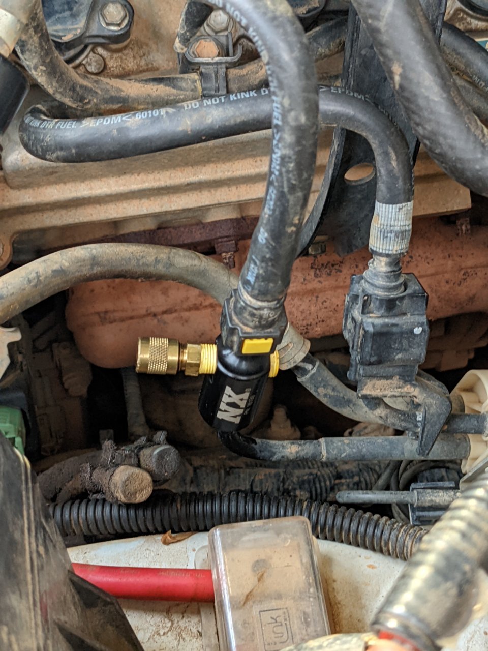

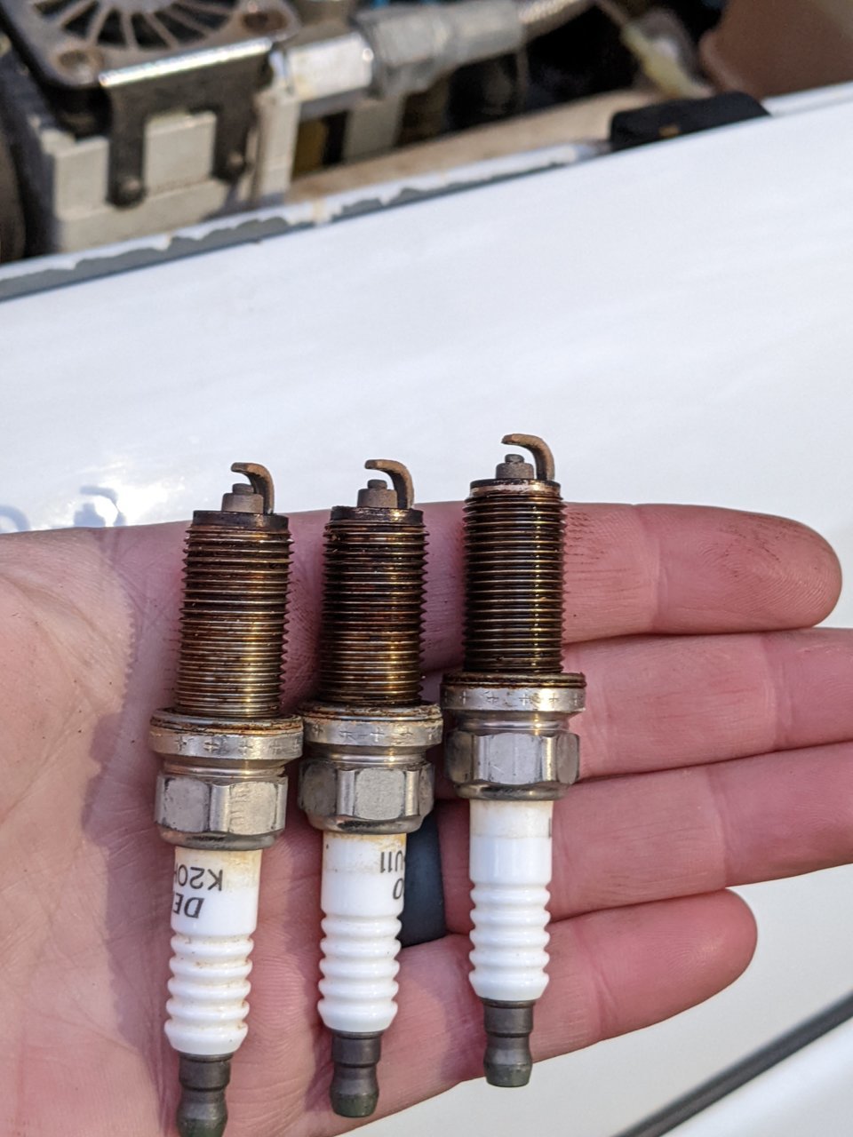

    1/30/22 295710 spark plugs, coil dust seals, fuel tester port install *plastic coating on fuel line too damaged and cut off

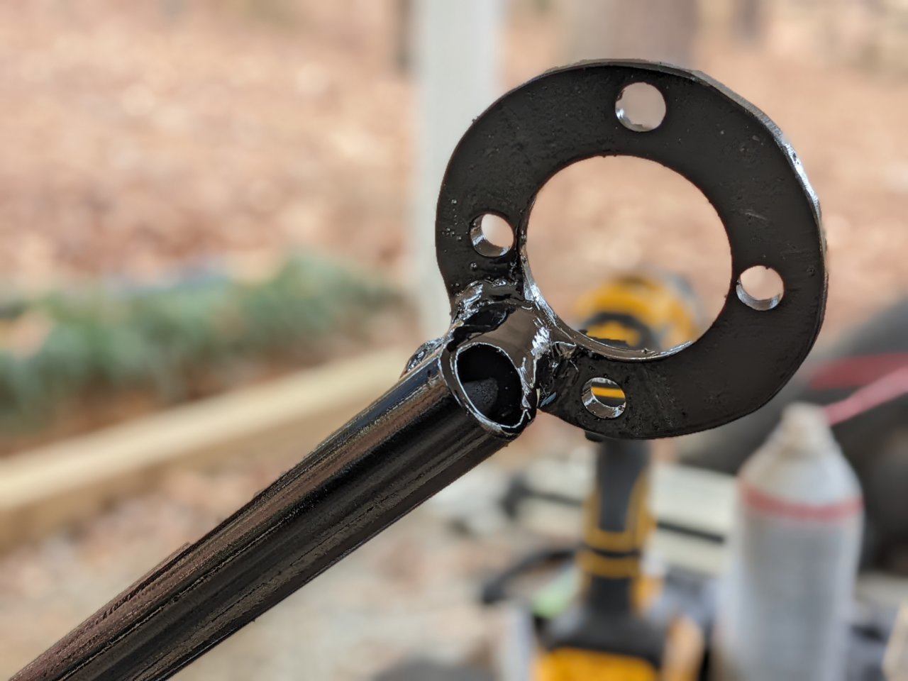

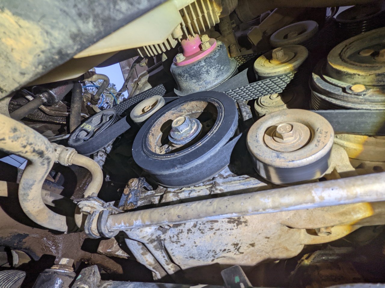

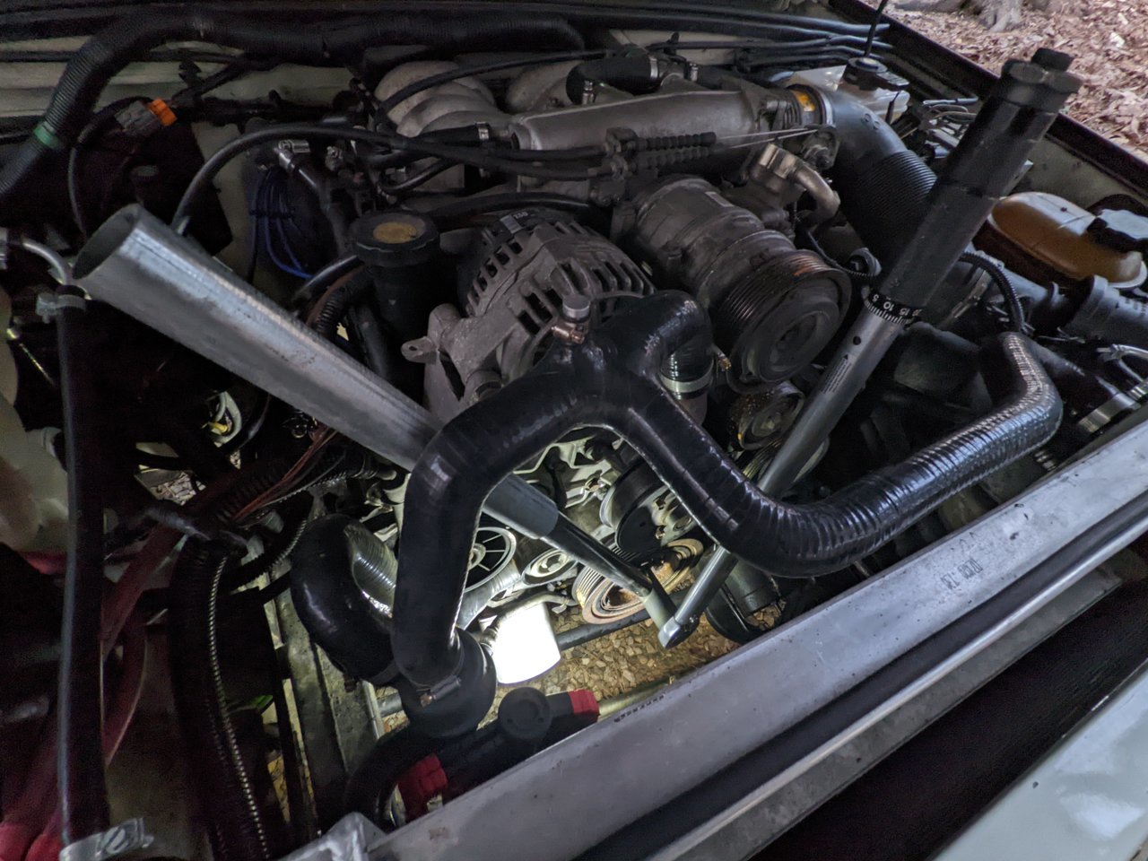

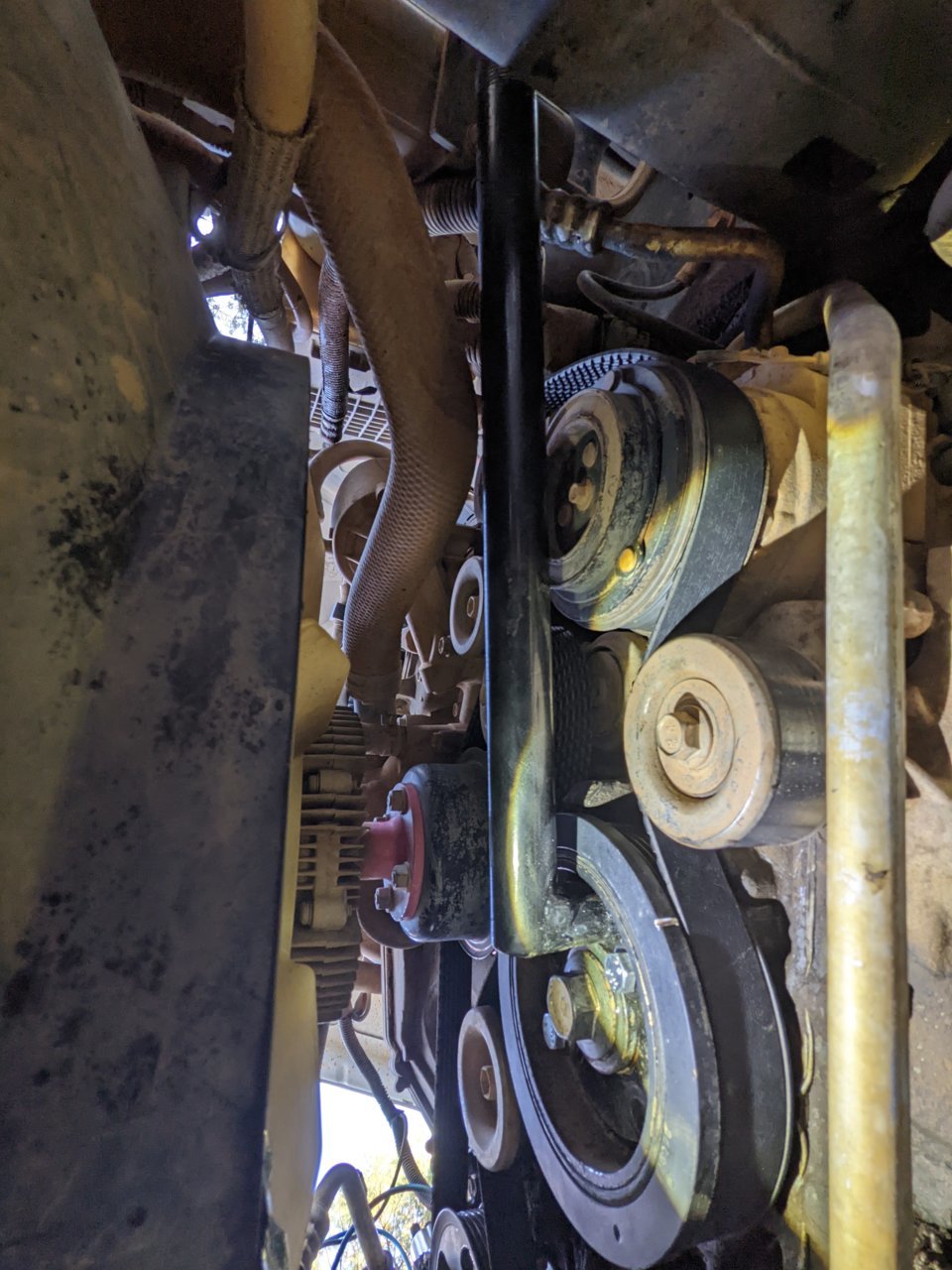

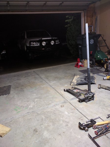

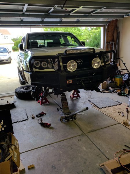

    Getting ready to go after another oil leak, seems like the front crank seal is leaking. Just replaced the same seal on Her Majestys Jeep and made up this tool to hold the crankshaft pulley.

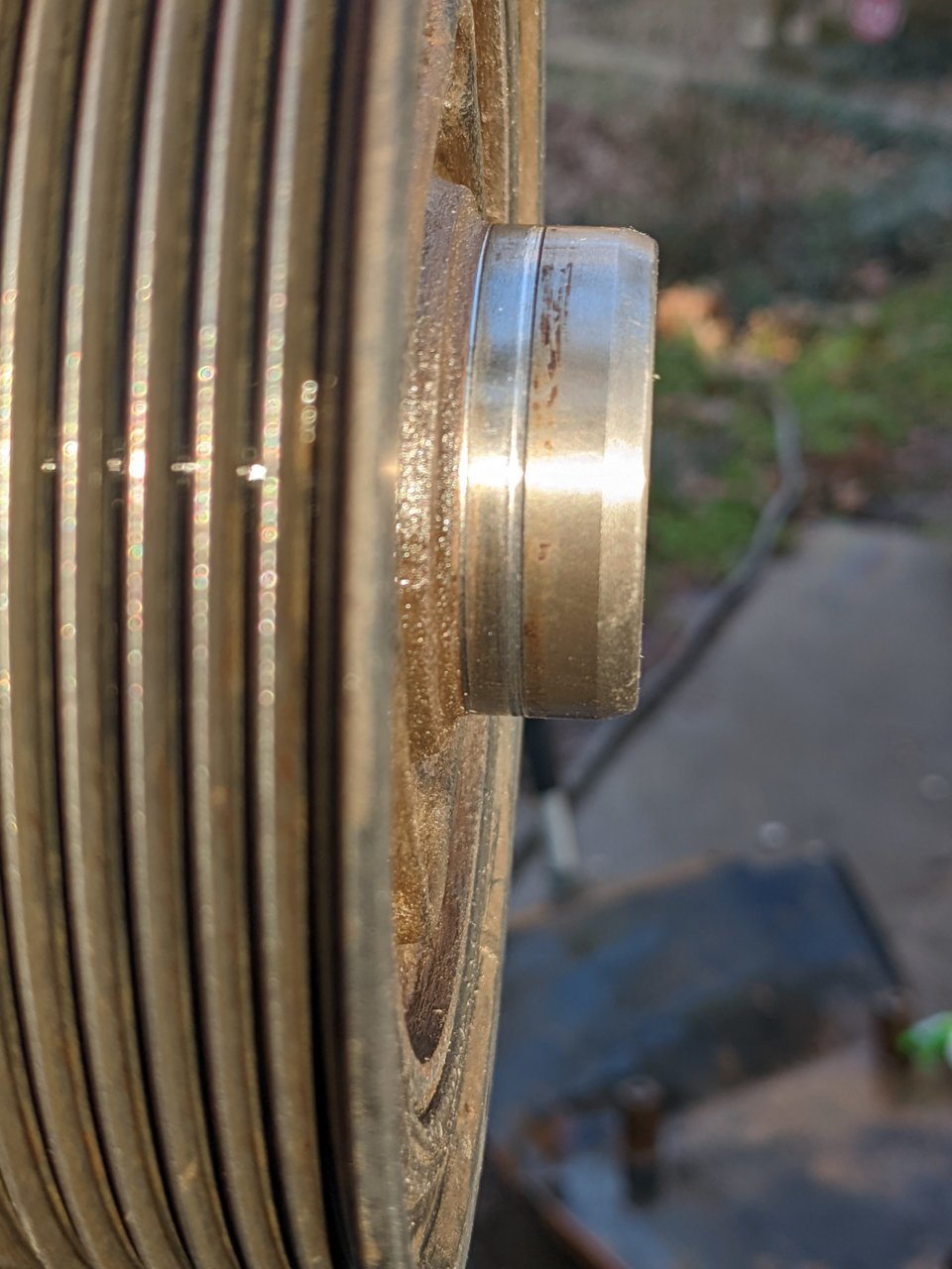

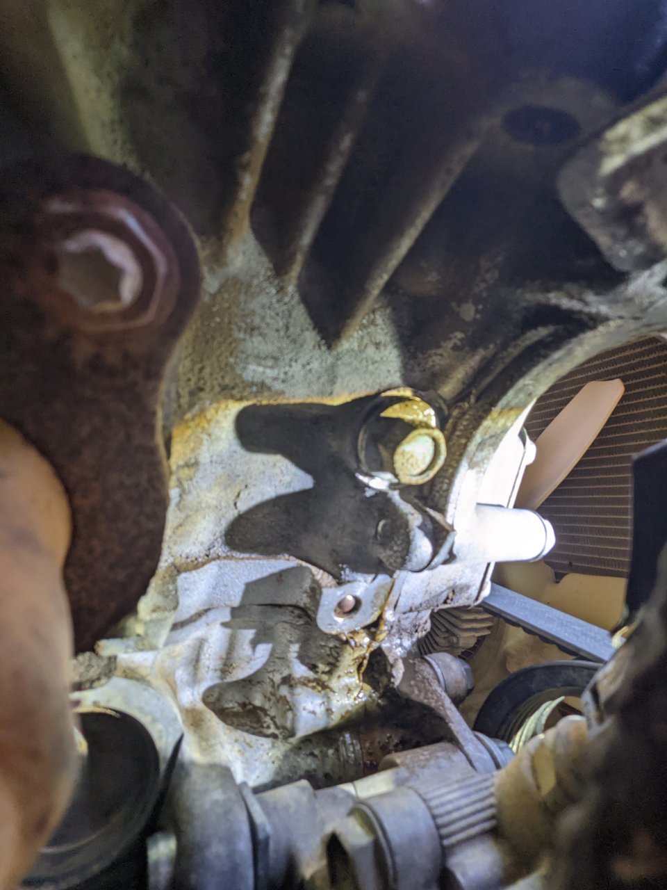

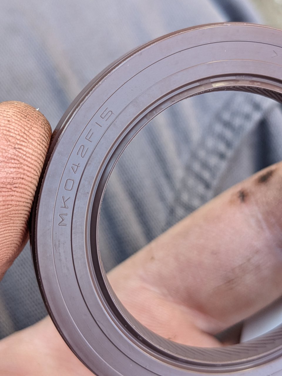

    Man I hate putting this skid plate back on... Got the crankshaft seal replaced and cleaned up a bunch of the caked on crud. In doing so I found another leak up behind the power steering pump on the timing cover.. There's also a bit of a Ridge on the snout of the crankshaft pulley, so we'll see how well the new seal works. The new seal from Toyota is a Koyo MK042F15

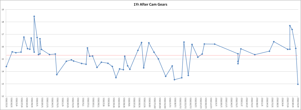

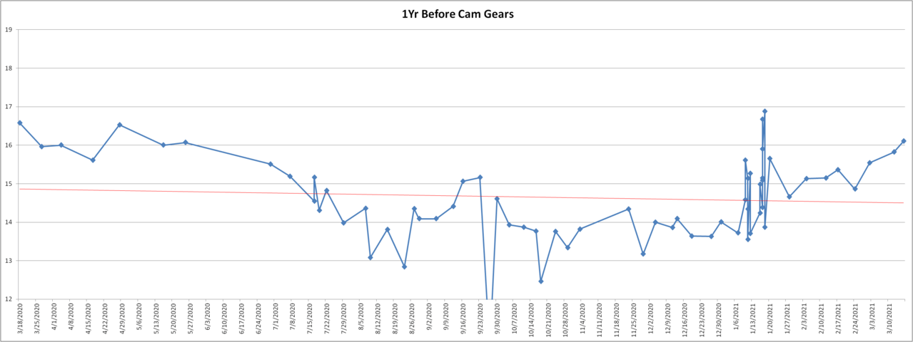

    3* Exhaust cam gear results. Here's my before and after mileage for a year. No real power gain has been noticed, less engine braking when letting off the gas gives a feeling of less rolling resistance.
    *I run 2 sets of tires 255/85/16MT and 265/75/16AT, some low numbers are offroad
    1 year before Cam gears Average 14.64397mpg
    1year after Cam gears Average 15.30167mpg

    On the one picture, I saw a large [​IMG]pipe going into your cab......what was it?

    So what is that pipe that looks like it's going into your cab? Is that an internal cab snorkel?
