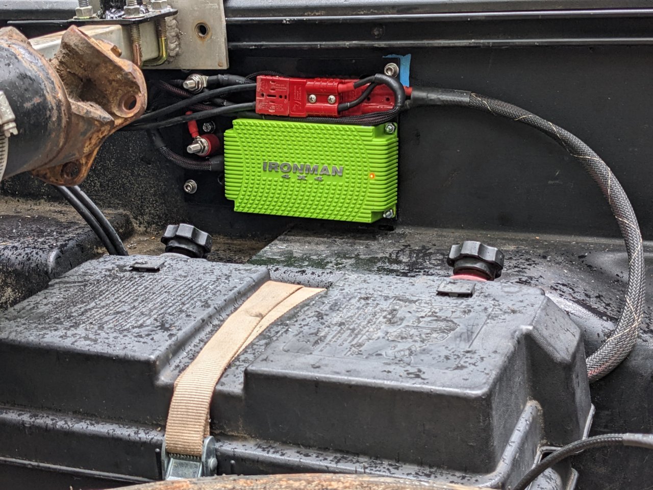

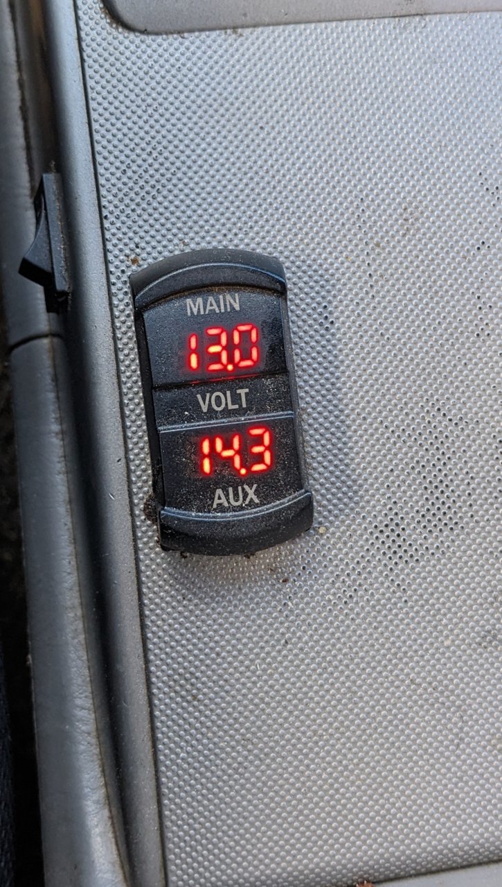

    Upgraded my charging system for my Aux battery from an SI-ACR to the Ironman4x4 DC-DC solar charger. If I left my fridge running for several days(parked at my shady house) with the ACR the 2nd battery would struggle to get the charge back up to the connection voltage and keep it there with the draw of the fridge for it to charge while driving(alternator charge).
    And now as far as I know, regardless of state of charge the DC-DC charger will boost the voltage from the alternator up to a set voltage. I'll be happy not to have to worry about this now.

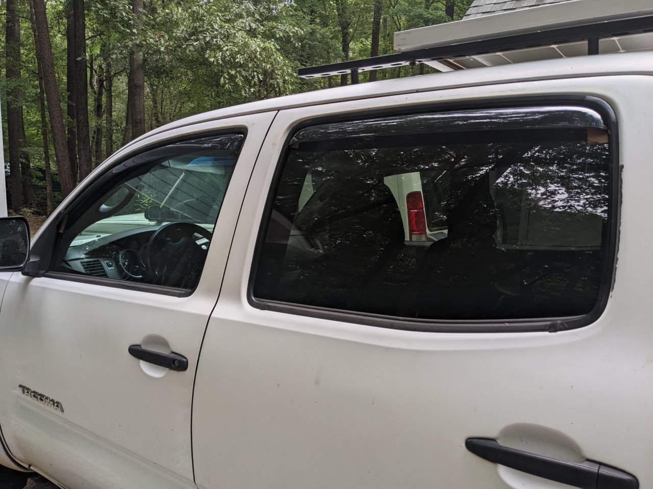

    New AVS in channel vent shades

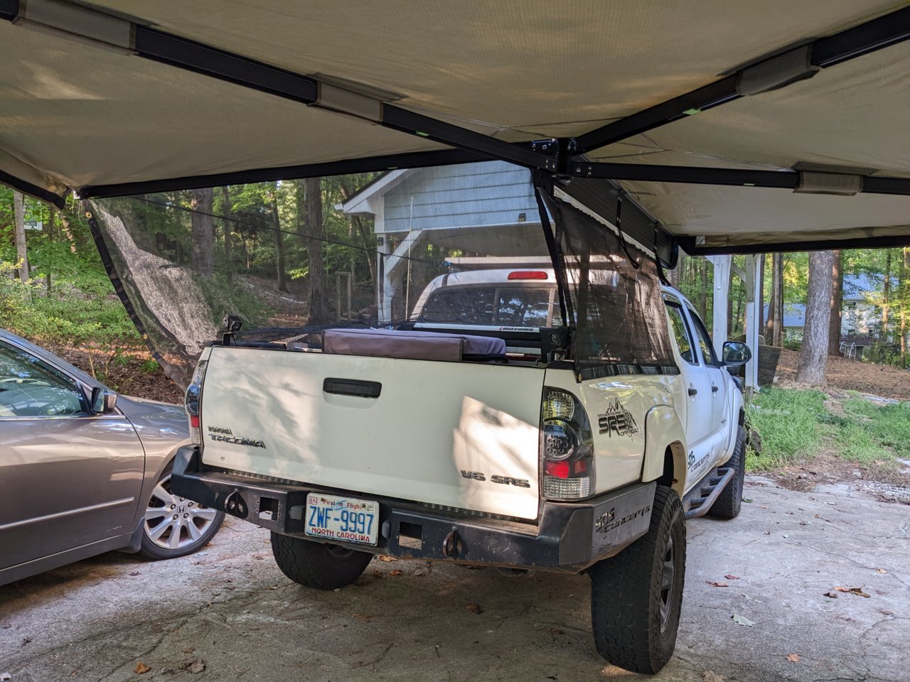

    Gonna be casting soo much shade with these HF mesh shade tarp panels

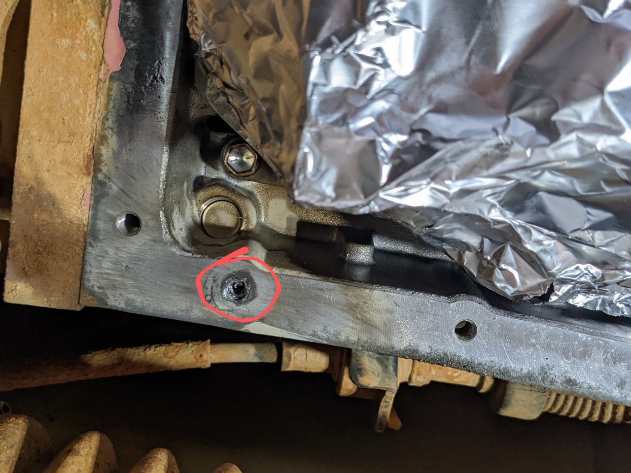

    Broken trans pan bolt better?

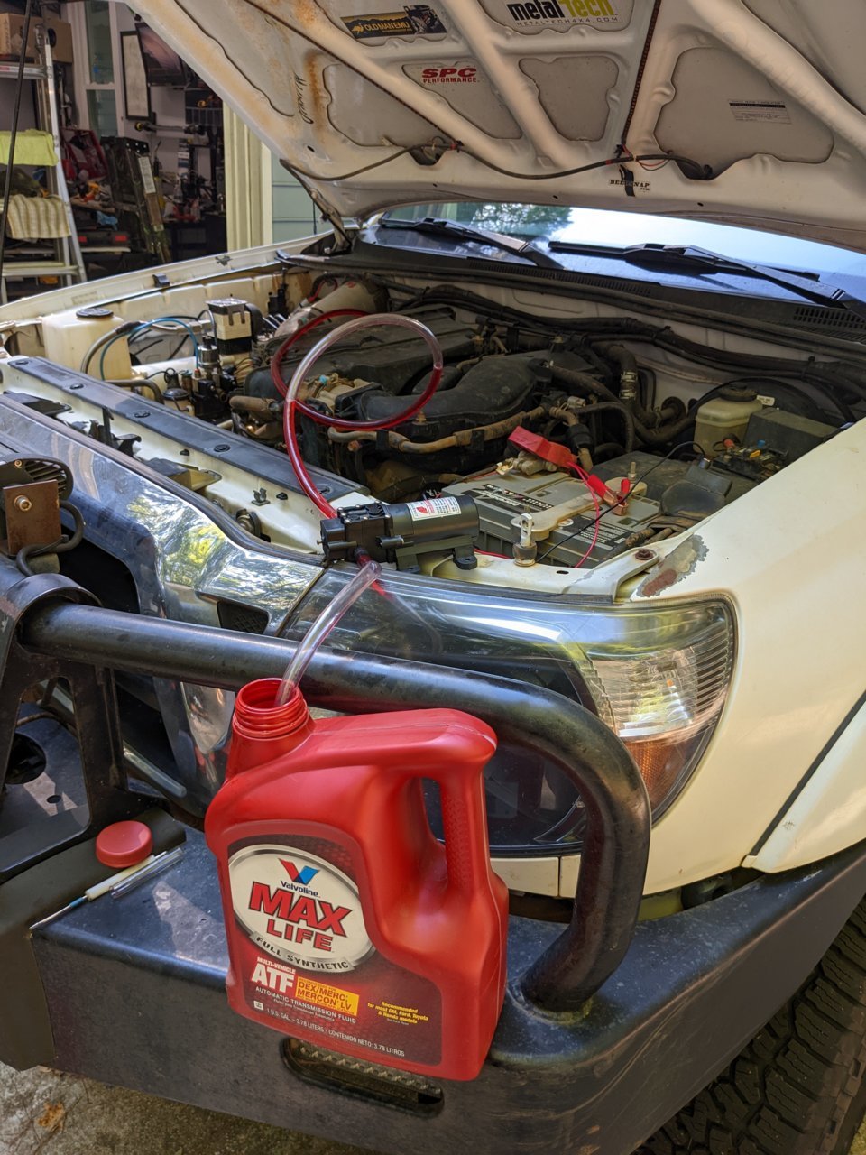

    303297 miles
    Transmission drain, filter change, fill
    Oil change

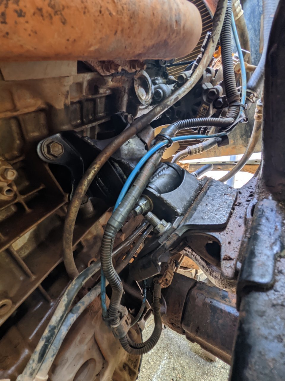

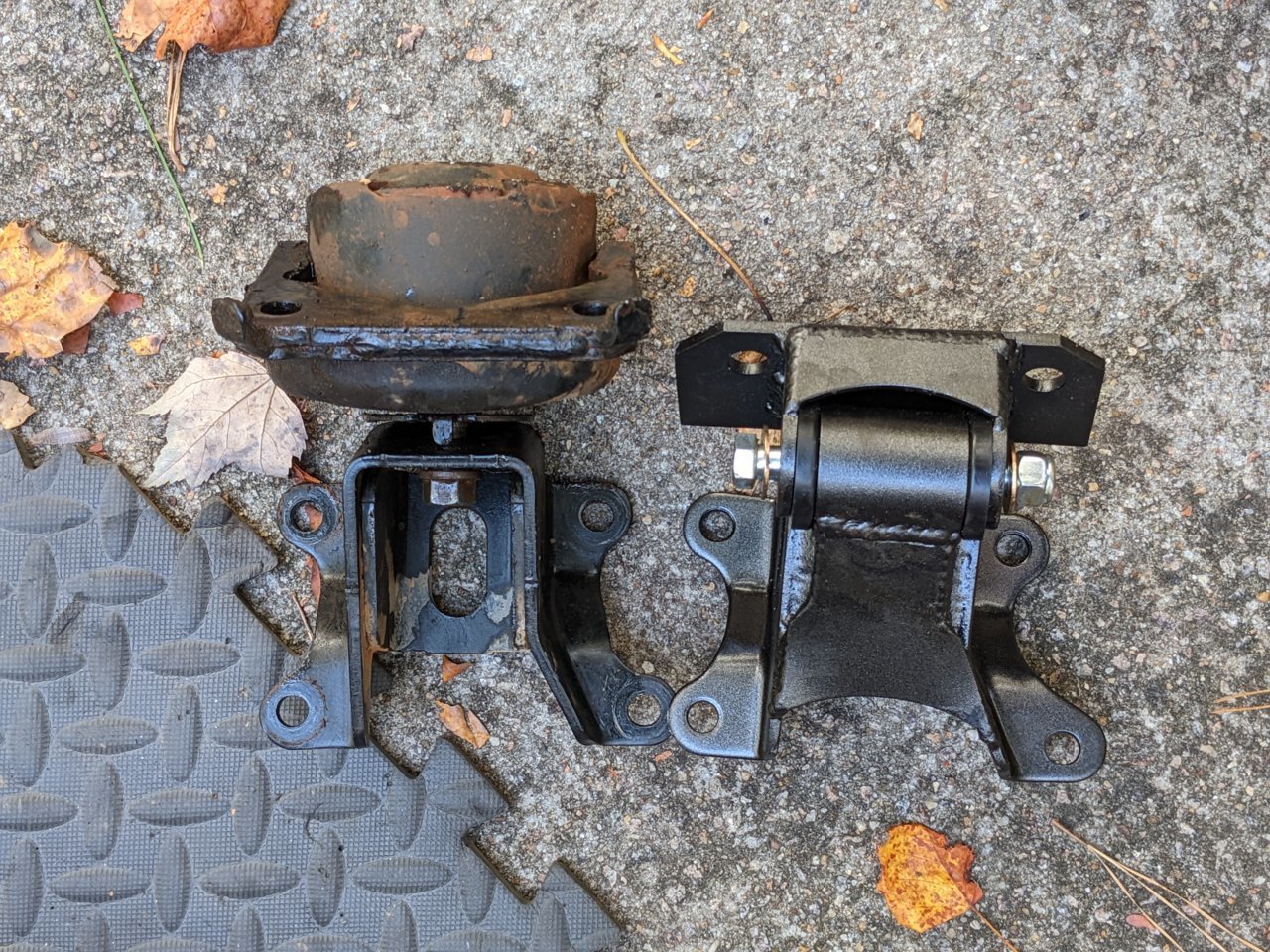

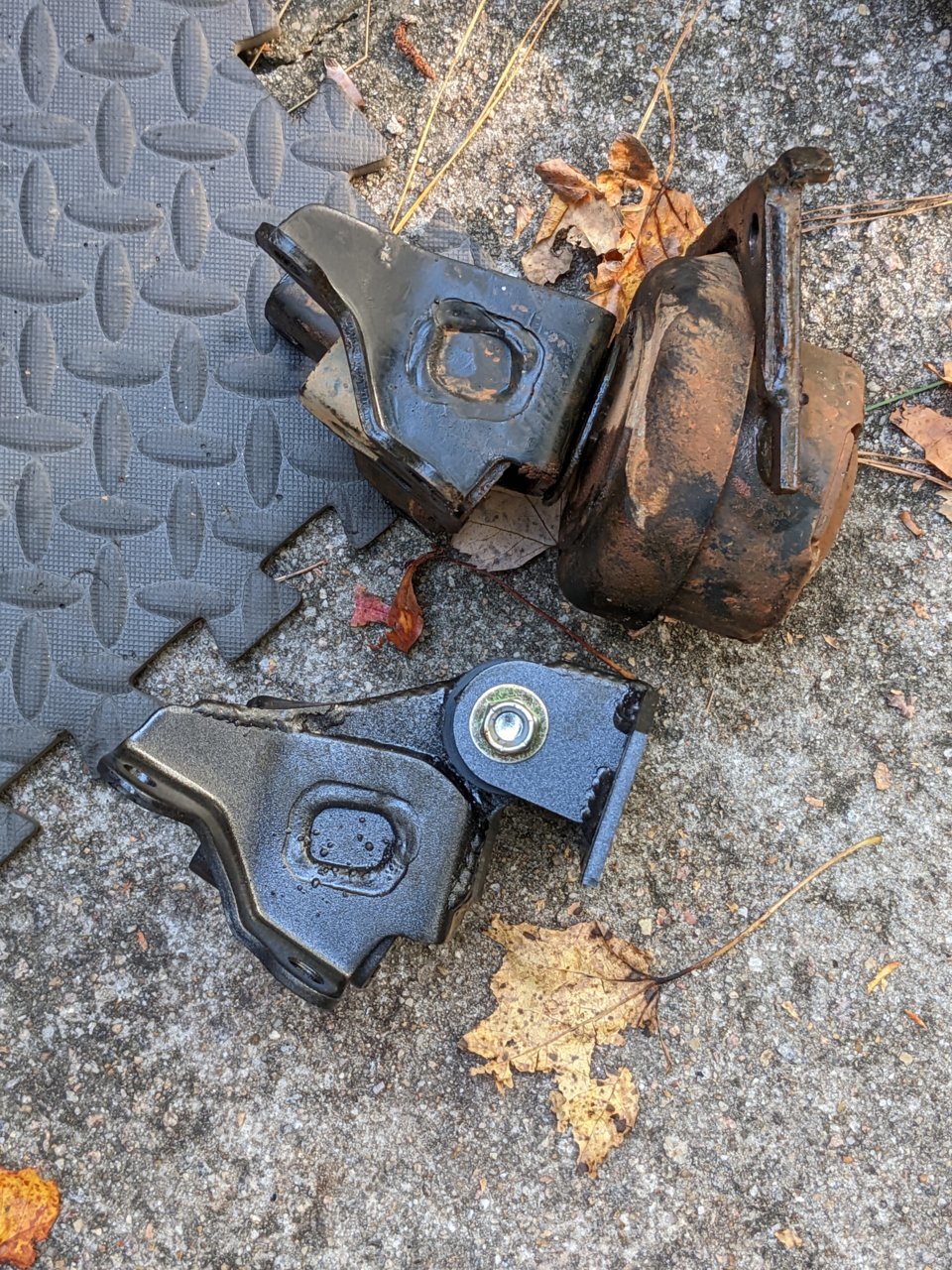

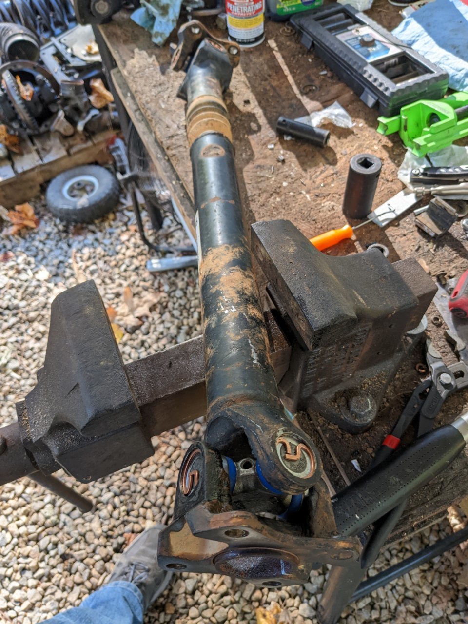

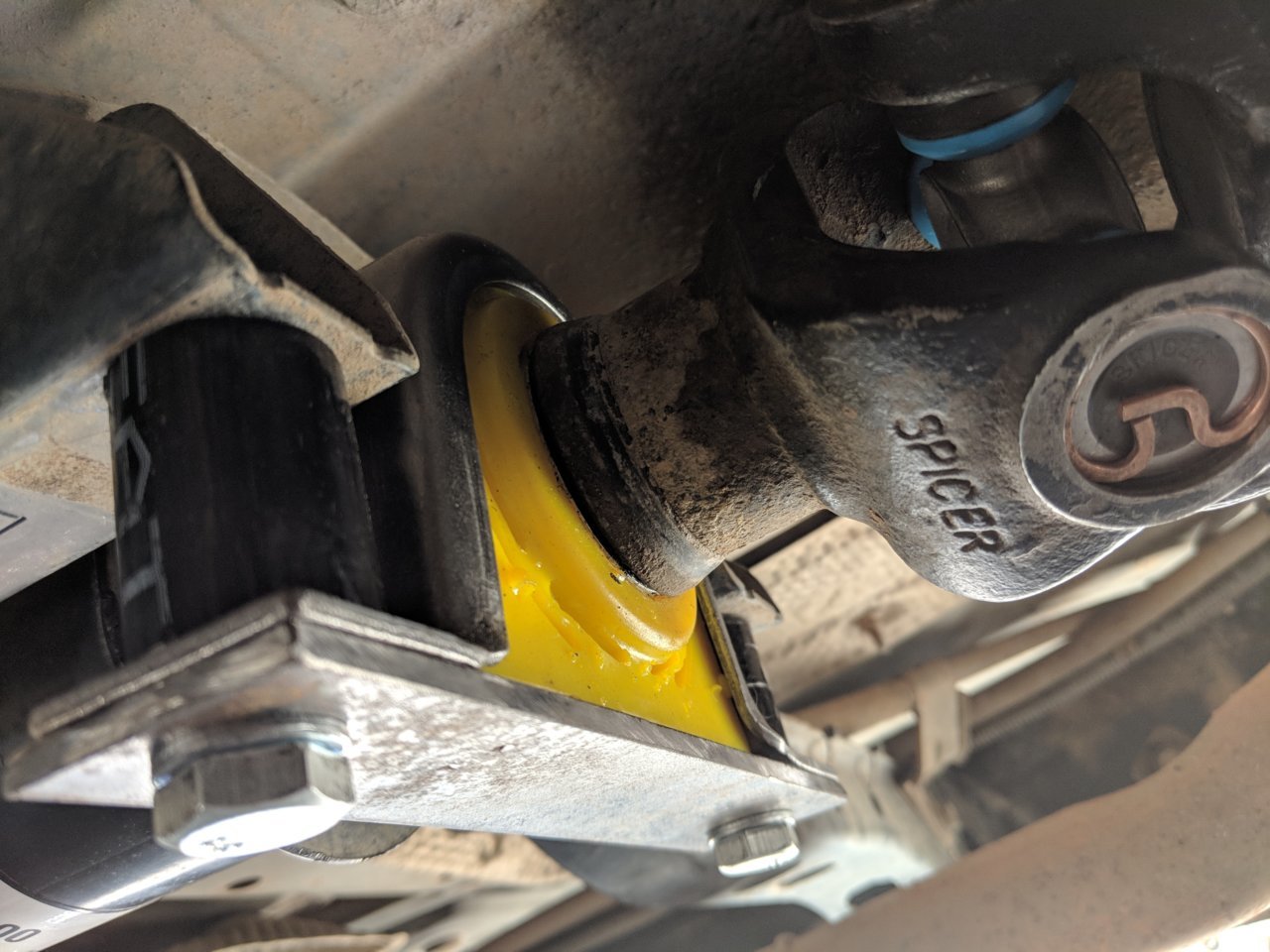

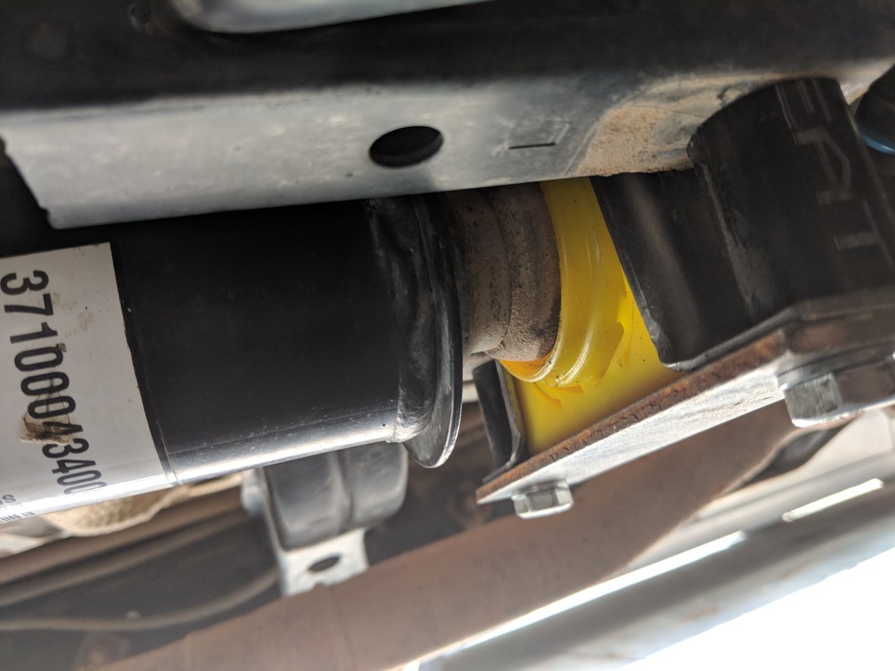

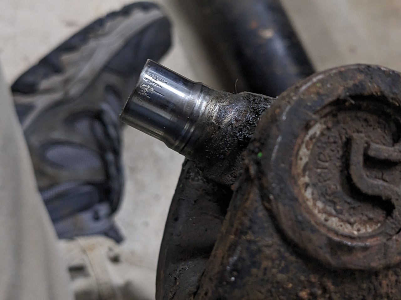

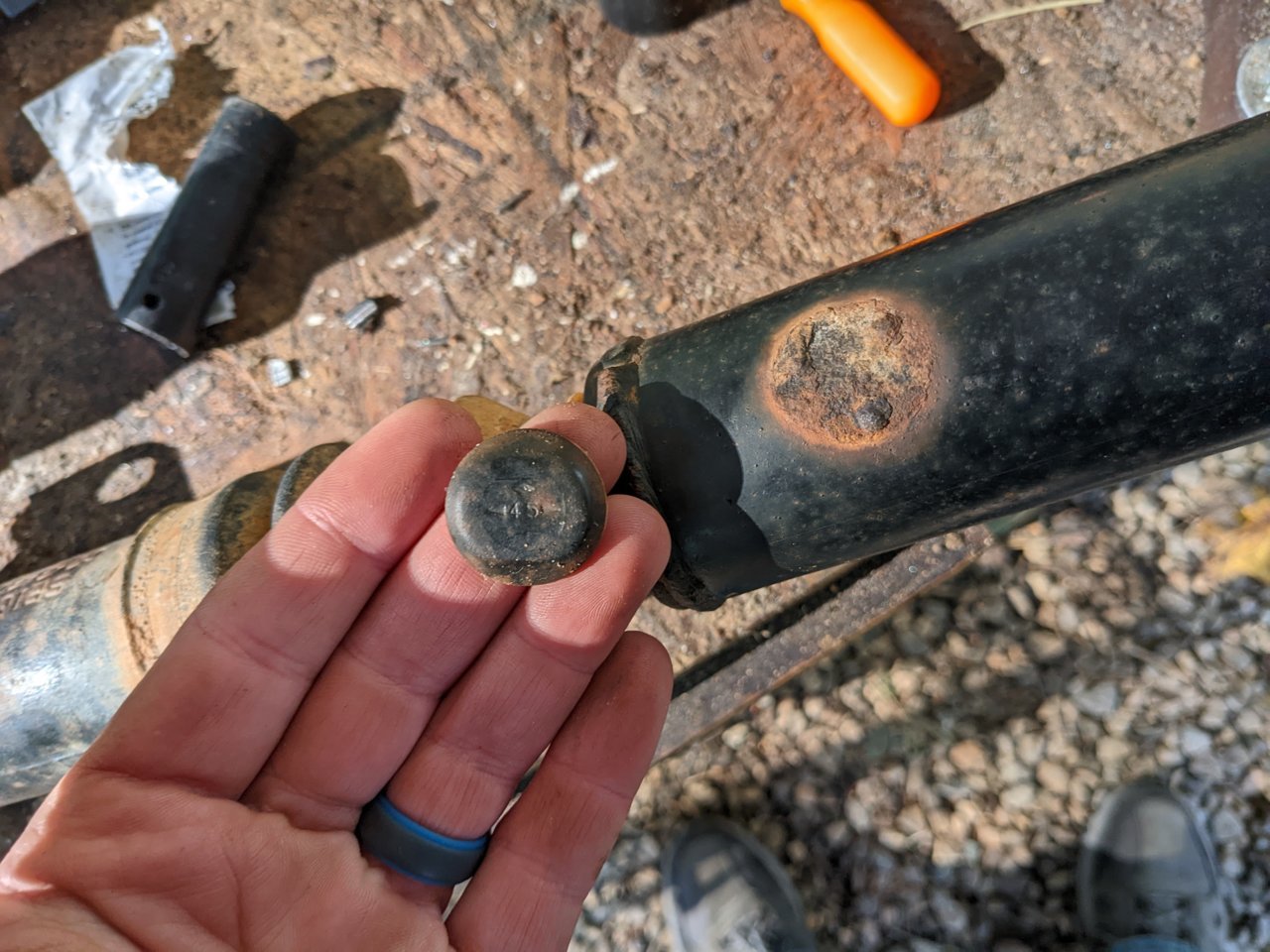

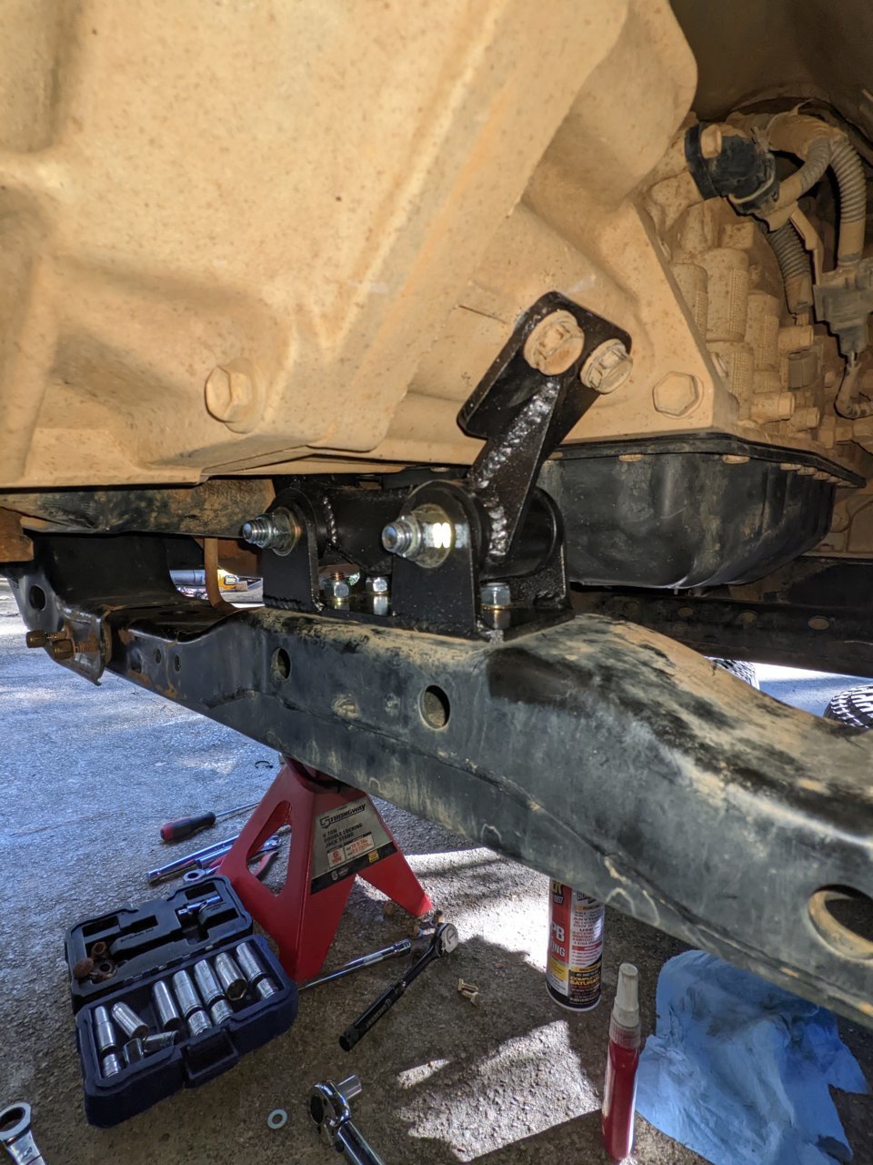

    305482 miles

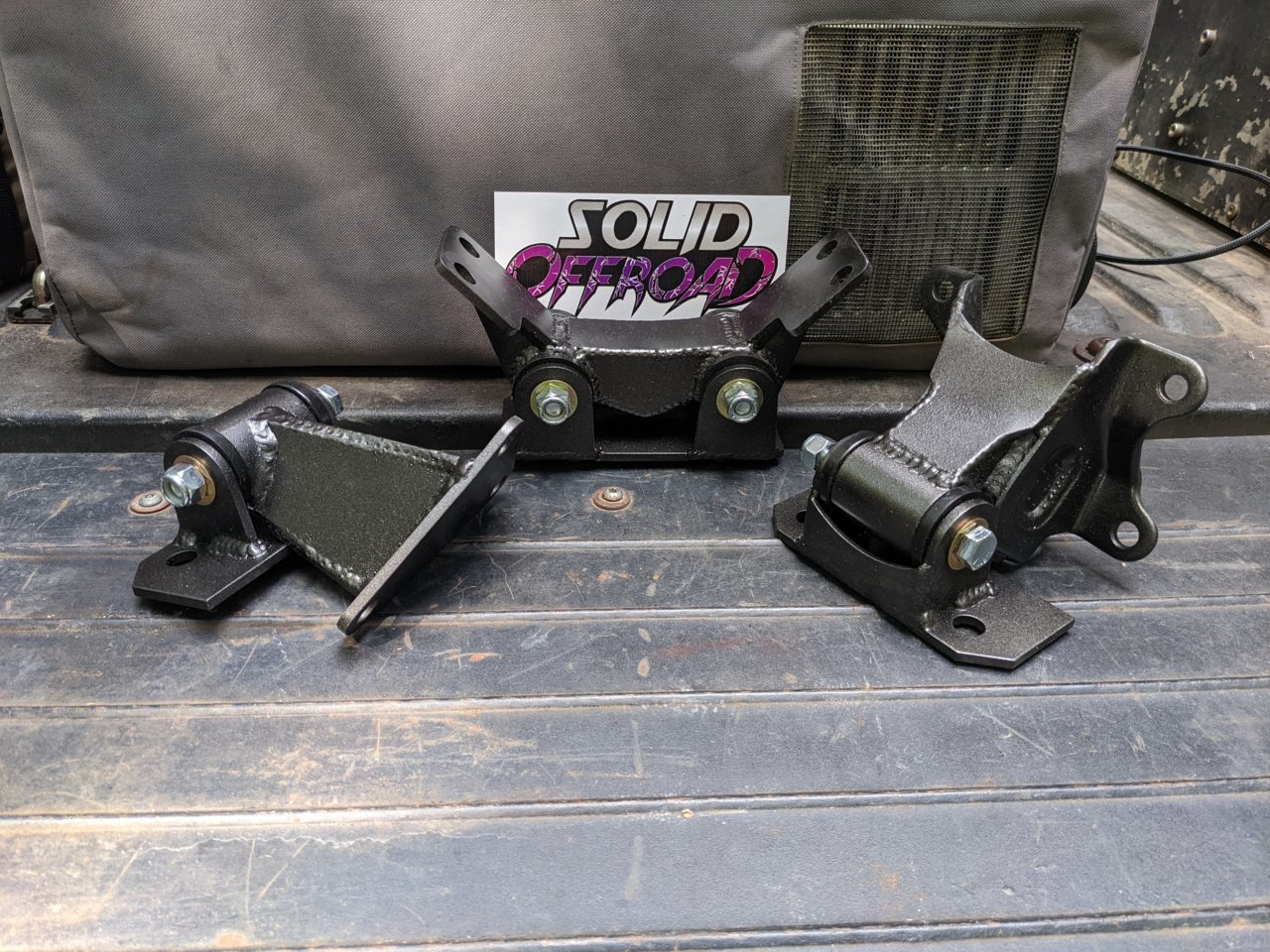

    Definitely feel a difference with the new mounts. It's a lot less like winding up a spring, but I do feel the extra vibrations. Mostly way low, pulling out of a stop but a little bit in all rpm ranges.
    PXL_20221017_200758833.jpg PXL_20221017_200812088.jpg PXL_20221017_205130498.jpg PXL_20221018_195457332.jpg

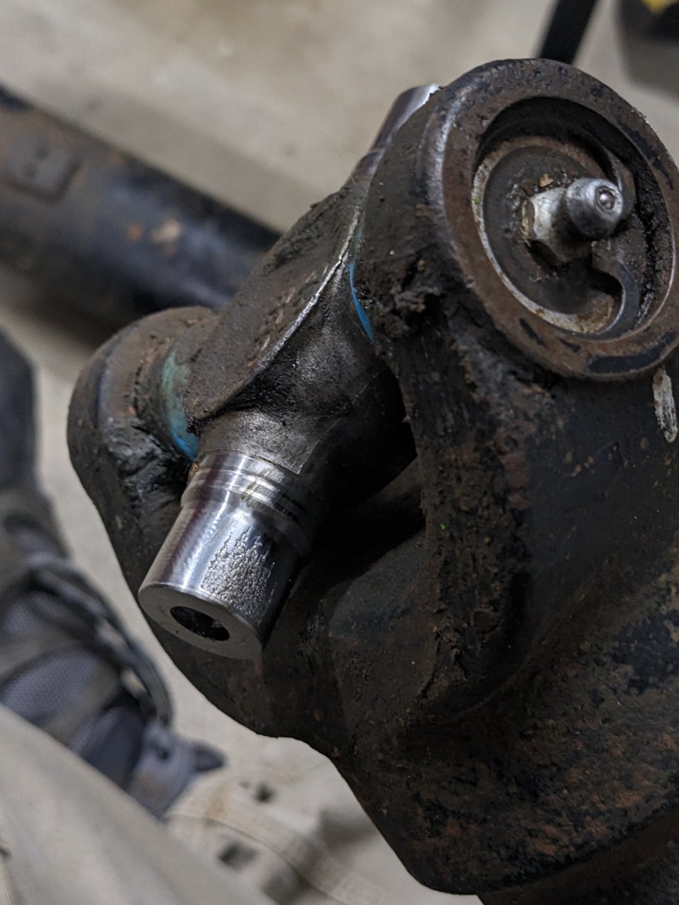

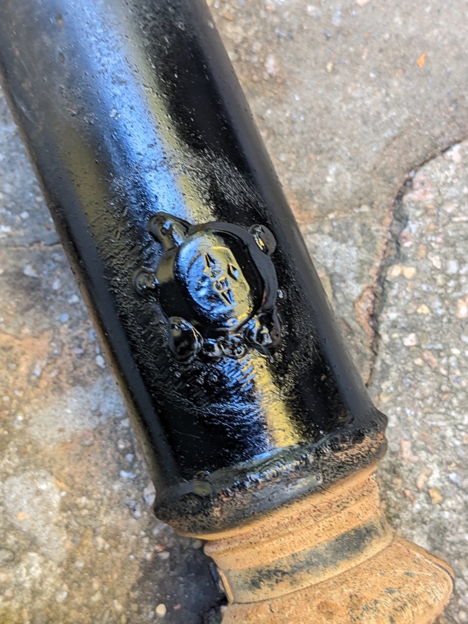

    And when I tried to grease the front drive shaft the u-joint dust covers broke and fell off.. So new u-joints got installed.. And when I was handling the shaft one of the weights came of... :turtleride:

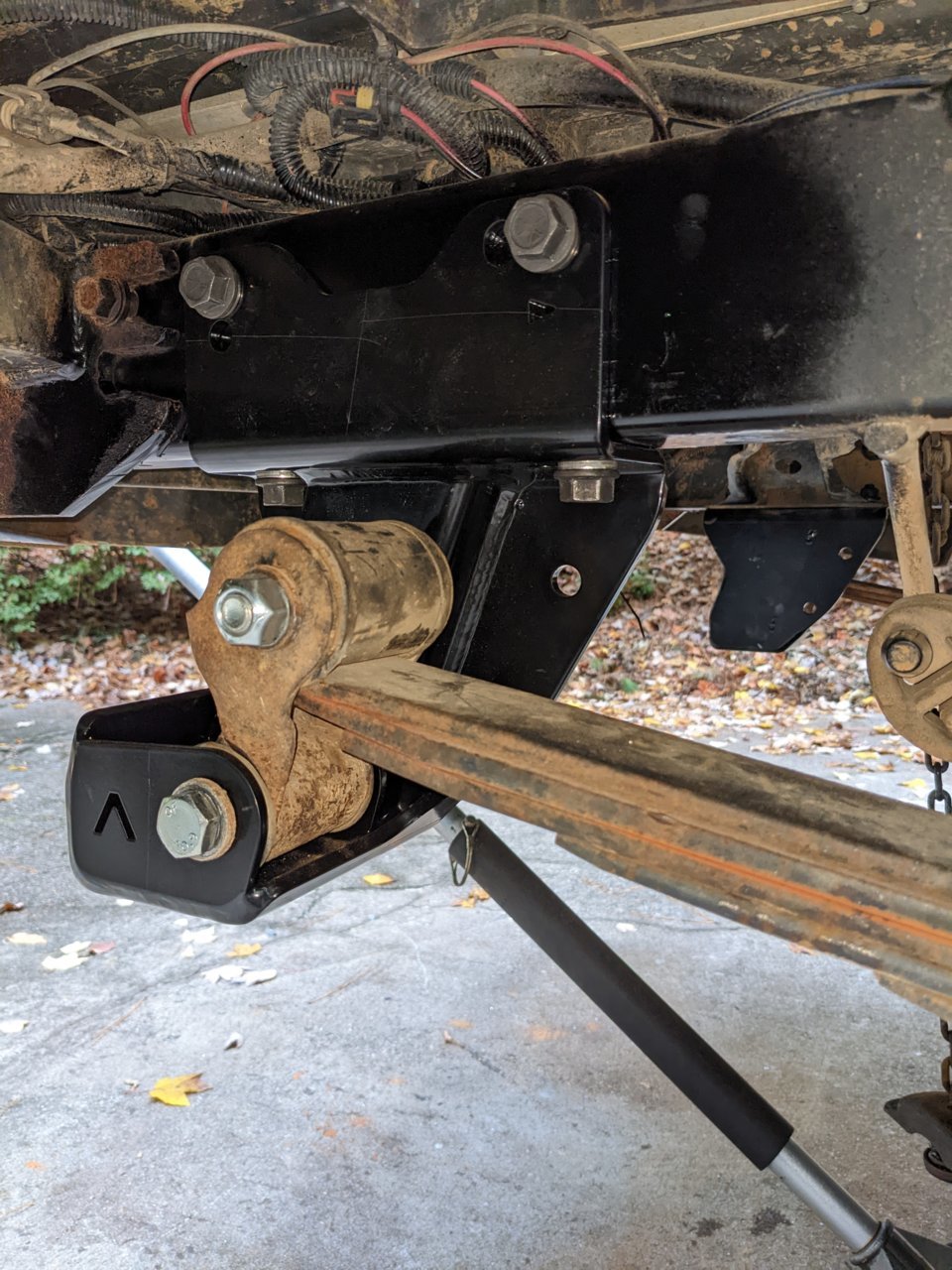

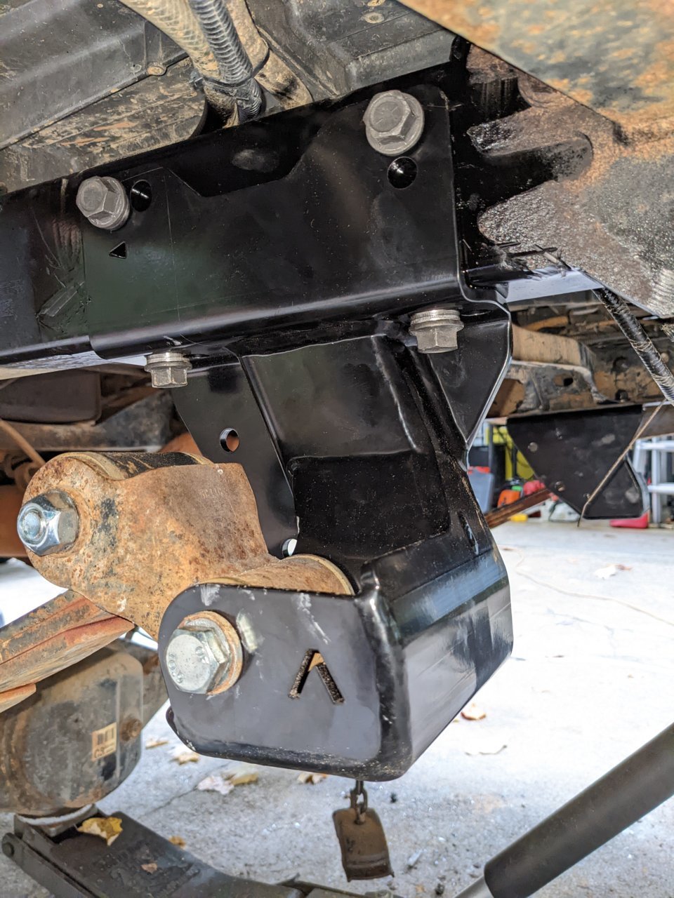

    @ARCHIVE garage rear shackles installed

    id have ocd with those brand new hangers i need new shackles as well. Id buy new OEM ones and throw in some poly bushings in them to help with droop. Looks good though.
    fatfurious2 likes this.
  12. Oct 27, 2022 at 4:10 PM
    #1972
    Sandman614
    Sandman614 [OP] Ex-Snarky TWSS elf, Travis #hotsavannahdotcom
    Oct 26, 2010
    #45273
    36,043
    Tim
    Garner, NC/Boone, NC
    '06 SR5 Off Road
    But then if the shackles were new, I would have to get a new Axle, and if the axle were new I would have to get a new driveshaft, and at that point I would have to put a supercharger on.
    I do already have poly bushings front and rear of the leaf pack.

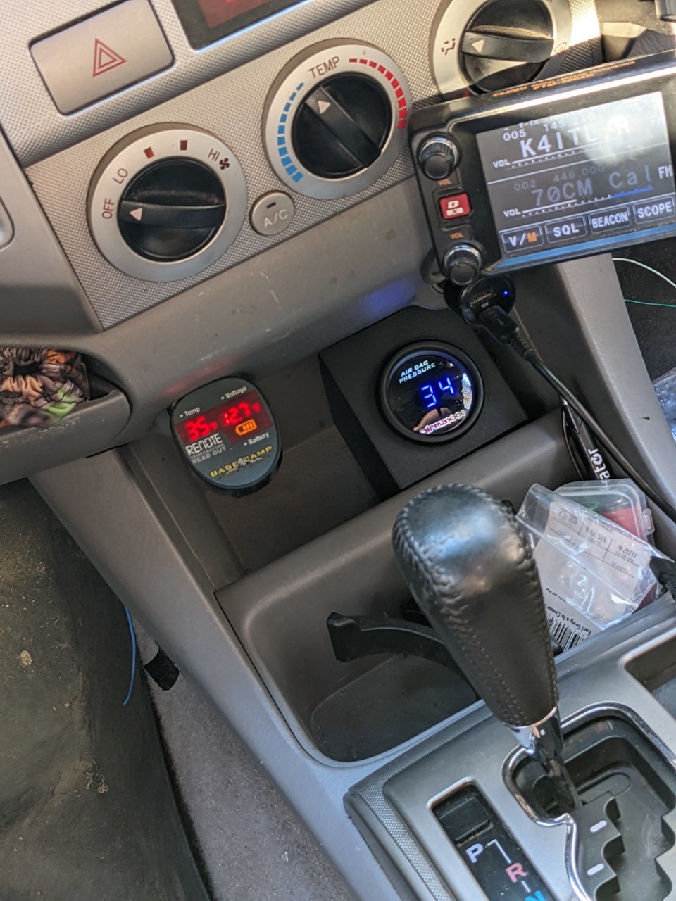

    New psi gauge, now I need boost psi maker!

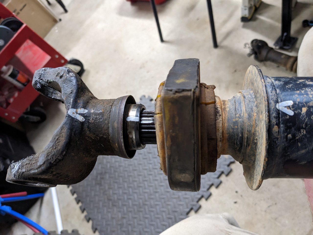

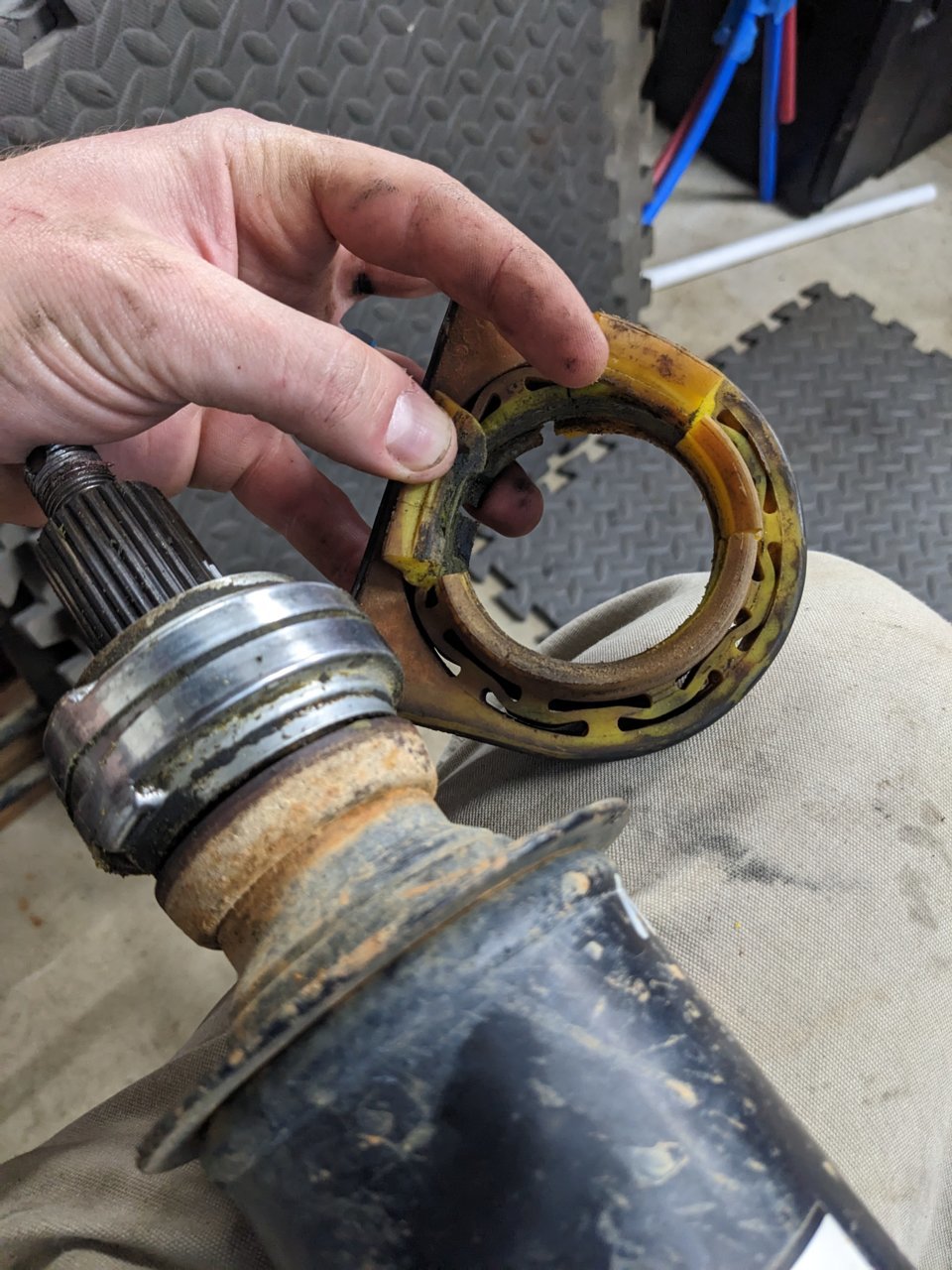

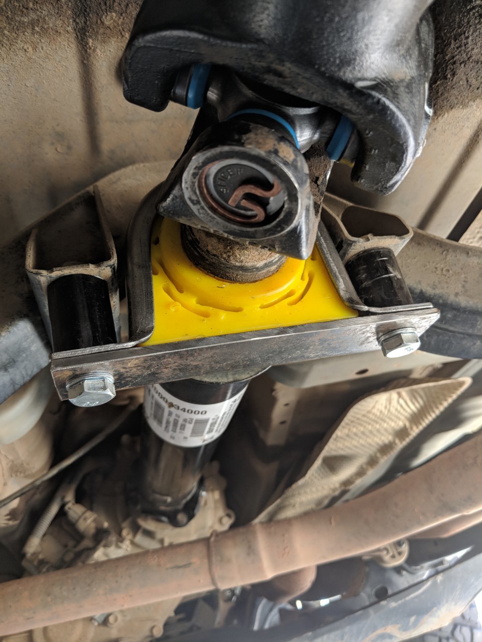

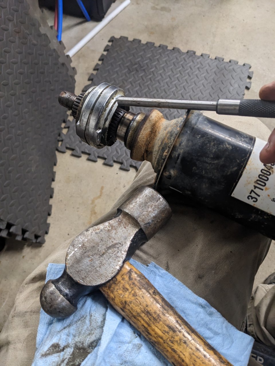

    307566 replaced the carrier bearing and center ujoint while I had it half way apart. The polyurethane flanges were cracking and falling off but what I couldn't see while installed was the ring holding the bearing was also cracked through. It's also weird replacing the joints before they're dried out and disintegrated. You can see where the bearing surfaces were starting to get a little crunchy.

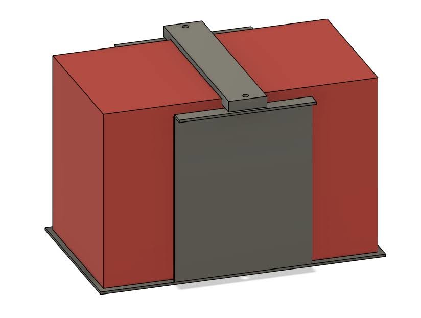

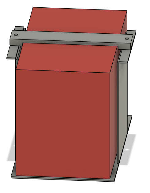

    A little bit of playing around in Fusion360

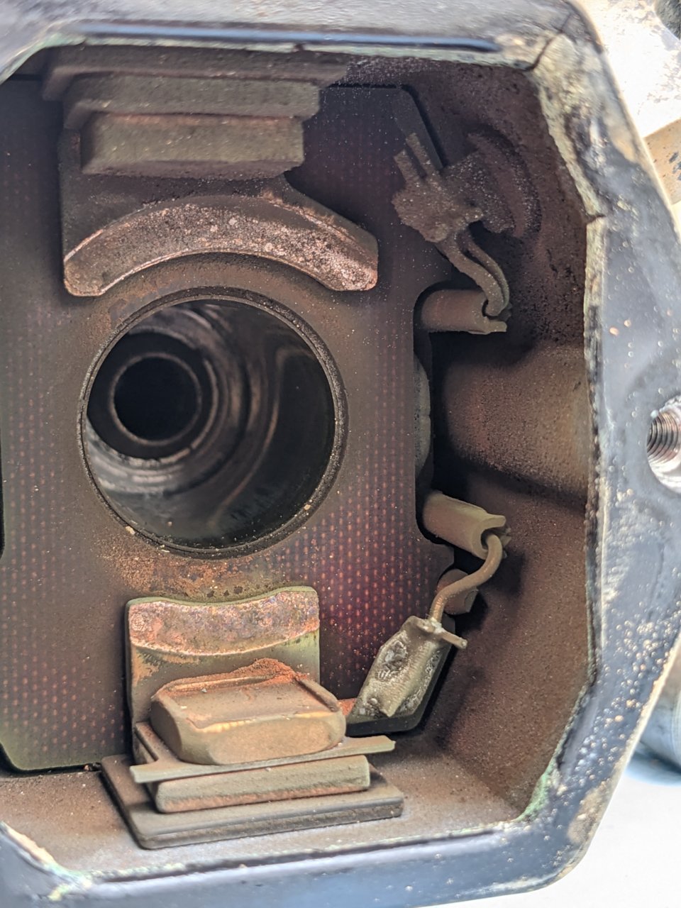

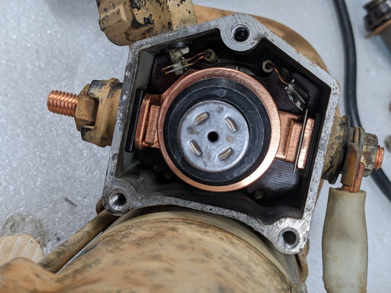

    '06 SR5 Off Road

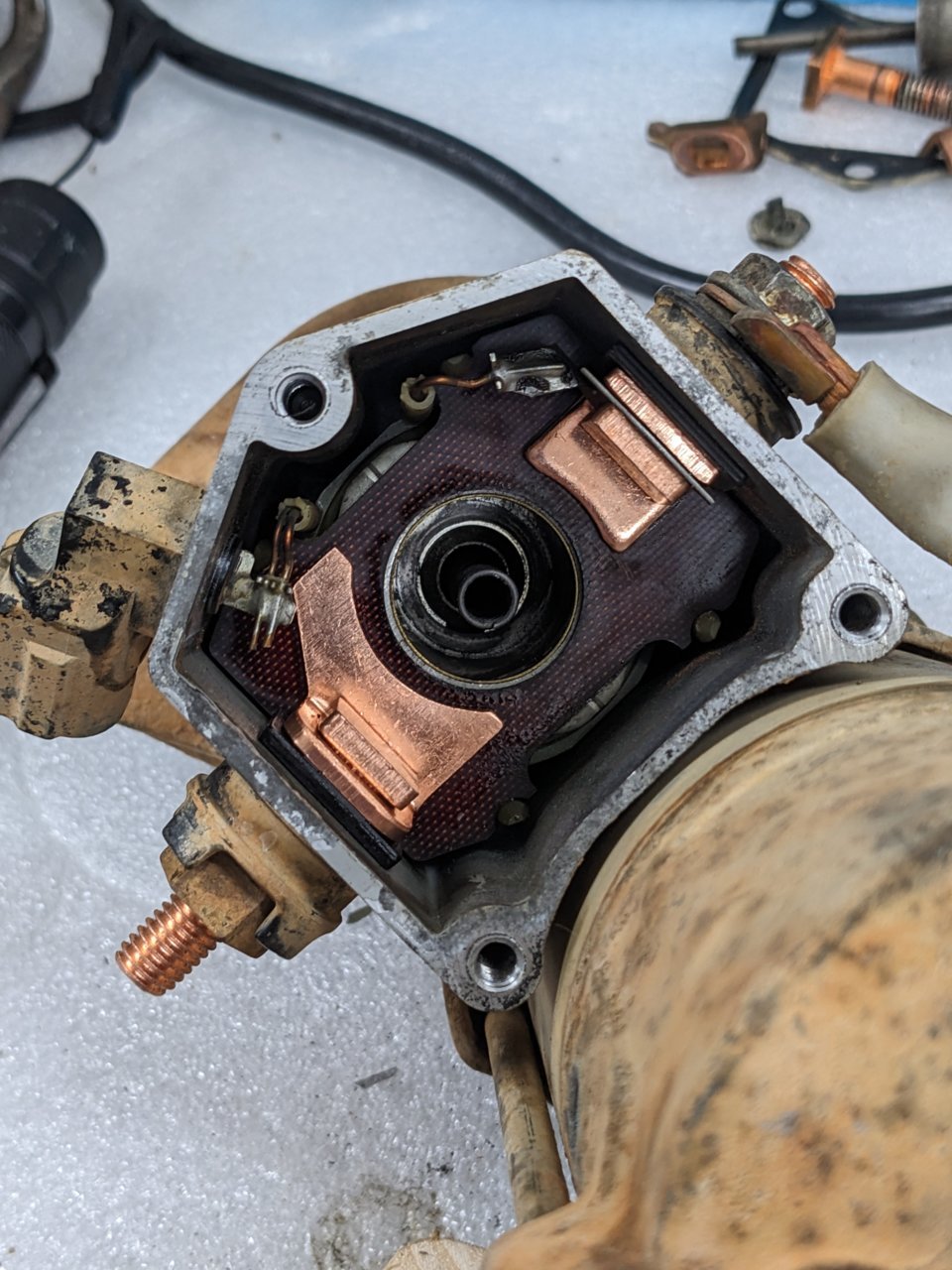

    The starter started to become more and more click unhappy. I ordered a couple kits from Amazon but they had the wrong size plunger. Ordered some more parts from maniac electronics for the right size plunger but didn't like the bolts I received from them so I just pieced it together from all the kits. No more click so far.

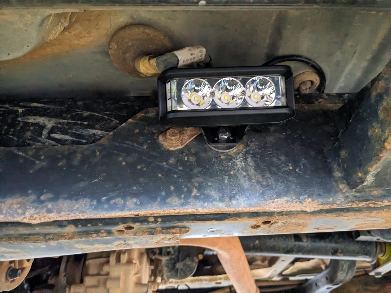

    Finally decided to get rid of a rattle coming from the passenger side. Crawled under and the heat shields on the passenger side were loose so I fixed those and went for a ride, still hear the rattle. Remembered the mid rock light was loose once, it was loose again so I fixed that, and no more rattle... Too bad the light apparently doesn't work anymore :anonymous: ordered new lights
