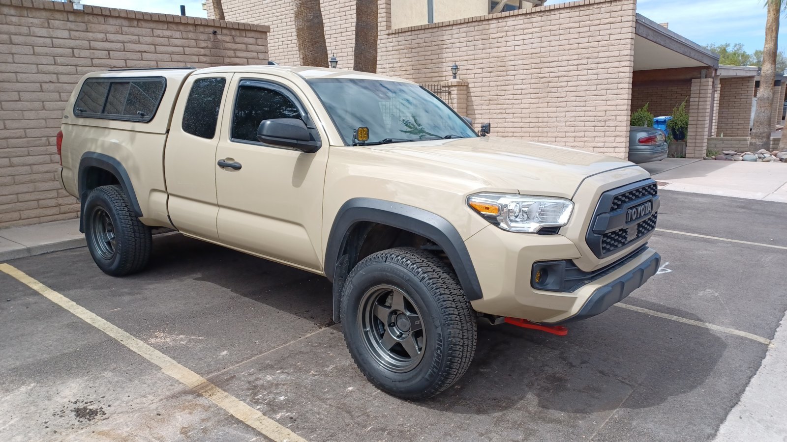

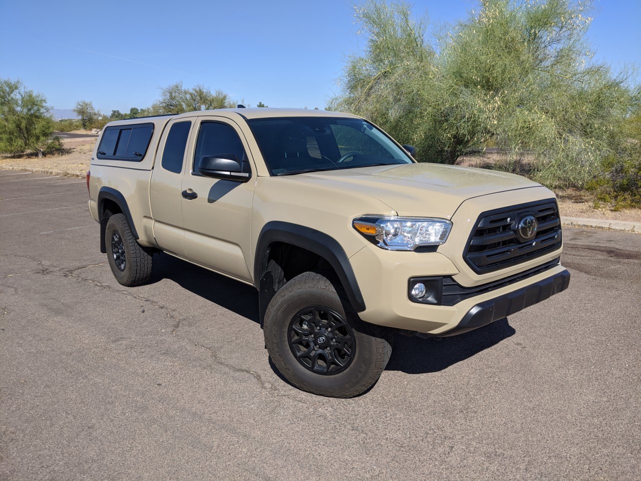

    So as of a few days the truck has officially been with me for a year and I have one of the first big mods in the pipeline that might end up making a few waves so I figured it's time to give Sandra a build thread.
    2019 Tacoma SR with SX Package, 2.7 I4 4x4
    How she sits presently (6/26/2020)

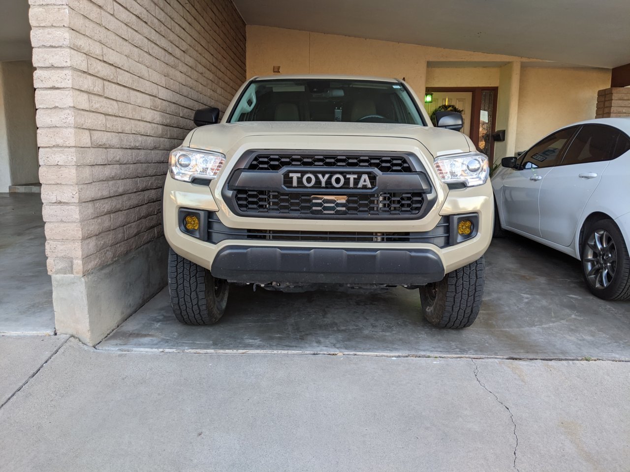

    Mostly smaller stuff for this one, but with the help of some fellow members, I was able to fill out the audio (Round 2 of 3)
    Bought some fog lights off a local member on Facebook. I'm not super proud of this mod, because at the time of this writing, I still need to add the fuse and switch, so for now I'm just posing.
    Added @MESO Map and Dome lights... and realized that the SR doesn't have a black headliner like the TRD's get! Had never noticed despite having spent significant time around other 3rd Gens. These things really are bright as hell.

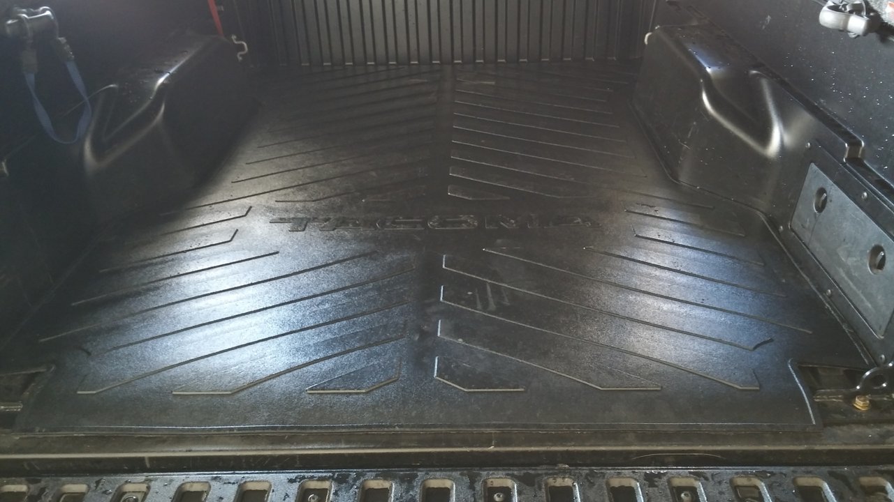

    And to cap off round 2, I got a bed mat at long last. Was an awesome birthday gift from family!

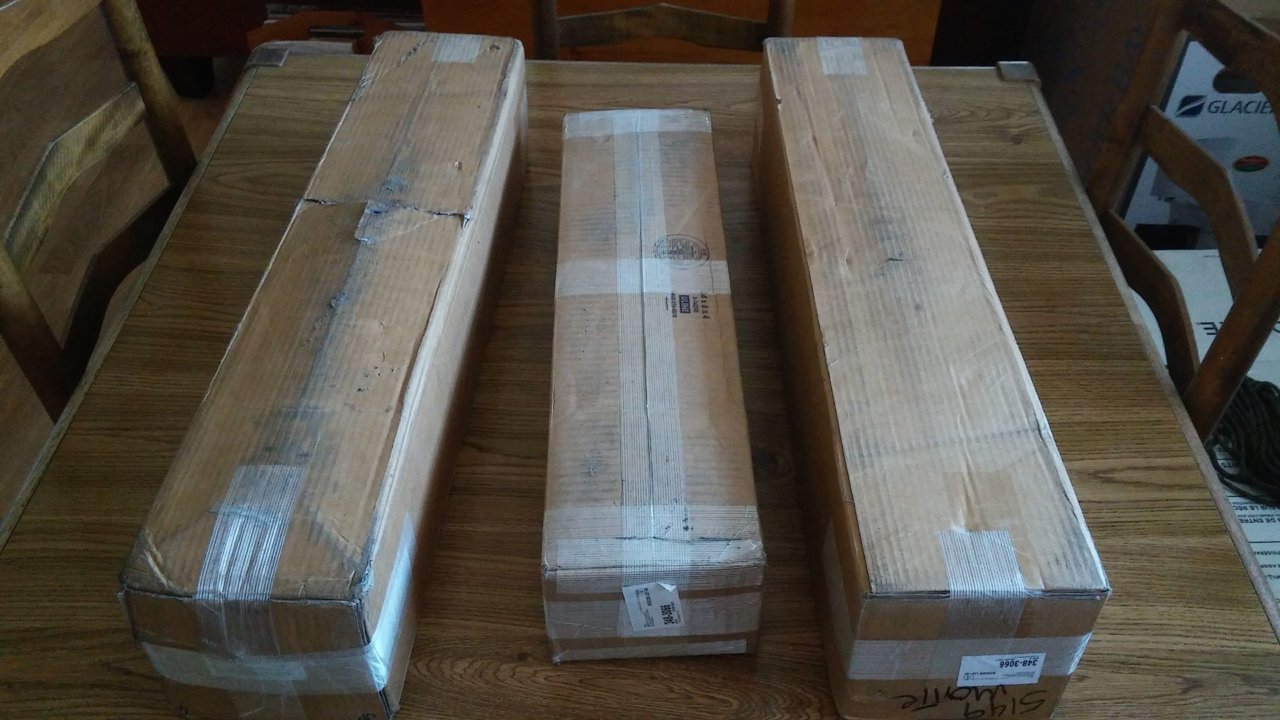

    So this is a pretty common picture, yeah? We've all gotten boxes from the Purple and Orange Santa's before haven't we?
    But nobody (that owns a Tacoma) has gotten what's inside these boxes before...
    More details to come!

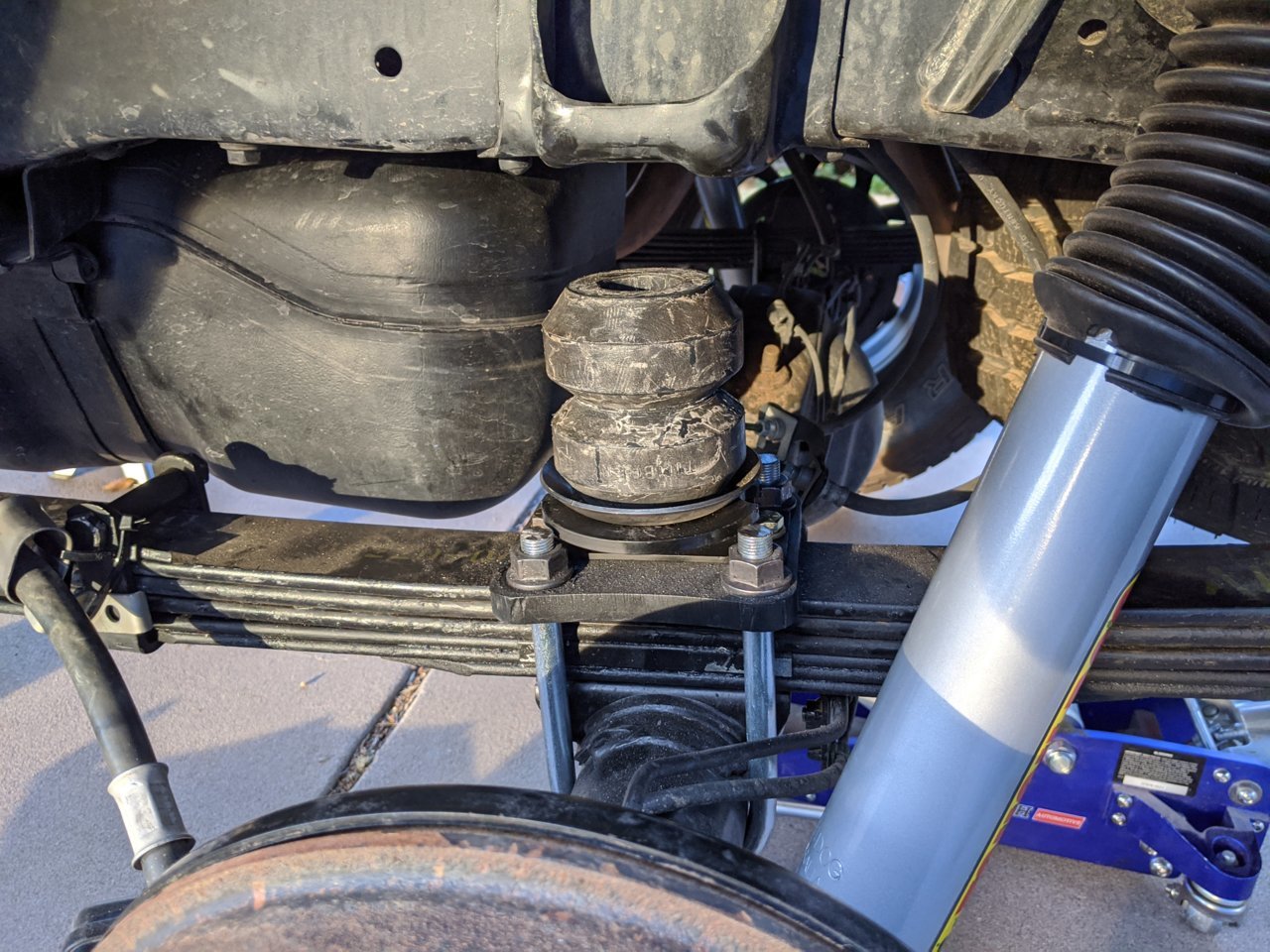

    So suspension pieces are starting to pile up. This wasn't the plan, but I don't have the facilities or resources to put things together all by myself, so it's just a matter of waiting for the stars to align to get it done with the help of friends and other forum members.
    Meanwhile, I always kinda browse Craigslist in the hopes of finding a gem of a steal, and boy did I find one on Wednesday. Some kids had listed "Timbren U-bolt flip kit with bumpstops for 2nd gen" for $40. The price was so low it was almost too good to be true, but I emailed him anyways and inquired. It was a genuine kit, had never been installed and was for a truck that had been sold as his brother now owned a 3rd gen. Of course, in my head, I thought 'well, it should still work for the third gen' but lord knows I wasn't going to tell him that. So I carted my ass to the other side of town and a cursory glance seemed to have everything check out. Brand new U-bolts, brand new Timbren bump stops and all the fixings for $40. Done deal. (Sidenote: It ended up being an All-Pro flip kit with Timbren bump stops)
    Winding the clock back to earlier in the day, I recently got a new phone and was struggling trying to email this young fellow about his bump stops when in pops a Tacomaworld notifcation from the AZ Classified thread in our regional forum. For the same reason I browse craigslist, I looked into the thread and damned if my buddy @TACOVRD hadn't listed his Wheeler's front bump stops for $40 as well! I picked up the craigslist purchase then rendezvoused with him on my way home and got back a happy, thrifty clam.
    But then I opened up that Timbren's box and looked at the invoice (which was conveniently included) and to my dismay, learned that the u-bolt flip kit was for a first gen. Also, the four pieces of hardware to fasten the bumps to the plate were missing. In my excitement, I could've haggled, but I was blinded by the savings.
    Poop.
    All was not lost, however, as I noticed the mounting plates seemed generous with their holes and sure enough, the included invoice confirmed that these were "universal" mounting plates. A cursory look on All-Pro's website revealed these were identical to those included in the 2nd/3rd gen kit, and All-Pro sells U-bolts for that kit to boot! So I ordered replacement u-bolts for my truck and now it's just a matter of finding some bolts and washers to fasten the bumps to the plates and I'll be right as rain and that little bit more ready for my lift. The longer I wait, the more prepared I'll be, but damn if I can't wait to get my stuff on my truck!

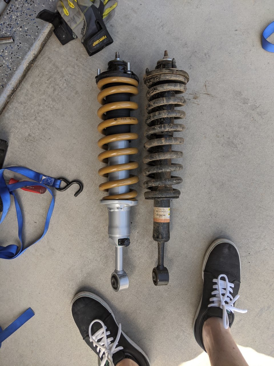

    So I spent all day (9am-7pm) yesterday with @Man of Steel TRD and had @TailHook join us for the rear half of the truck which was where we really needed him!
    Installed items list:
    • Tough Dog 40mm Adjustable Extended Travel Foam Cell Shock and Spring (Front)
    • Tough Dog 40mm Adjustable Extended Travel Foam Cell Shock (Rear)
    • @HeadStrong Off-Road 3-leaf AAL
    • Wheelers Offroad Front Bump Stops (Thanks again to @TACOVRD )
    Pending:
    • All-Pro U-Bolt Flip Kit with Timbren Bump stops as the new U-bolts haven't come in yet and I haven't sourced hardware to fasten the Timbren's to the mounting plate.
    Jeremy (Man of Steel) was a gracious host and had me over to his well-stocked-with-tools garage. He had recently repaired one jack, bought another one, and then I had also borrowed one from a co-worker. This seemed like overkill, but it actually made the whole process go that little bit smoother having three jacks to pick from. I also brought my jack stands since Jeremy is currently working with the recalled Harbor Freight ones (I bought him some new ones as a thank you).
    We started on the fronts, and that went fairly smooth with the drivers side, taking care not to let the driveshaft flex or pull too much. The Passengers side had a hiccup as the shock's top mount wasn't rotated properly. A quick trip to Autozone to rent a spring compressor and a lot of sweating and cussing from Jeremy and I and we managed to rotate it into position and install the shock without further fanfare. Side note: The stock bash plate really does suck on these trucks. Skid plate soon, when my wallet recovers.
    Wheeler's Superbumps also went in and man what a pain in the ass those are to install, but what a huge upgrade they are over the stock ones.
    Next was the rears, and Alan (Tailhook) showed up just in time. Jeremy only has experience with installing full leaf packs on Taco's and my memory of helping Alan with his Add A Leaf install was hazy at best. To boot, Alan had gotten the older Headstrong AAL pack, so there was some amusing quips in regards to that. The drivers side install was a pain in the ass. A little kicking, a little maneuvering, some pulling and more before it finally went in. By comparison, the Passenger install was a breeze, which was a relief because Jeremy and I were whipped by the end of it. Big thanks to both of them for the help and I couldn't have done it without them, at least not in a day!
    The lift was a huge boost for my rear suspension. The rear leafs on Taco's suck. I'm sure you've heard that before ad infinitum, but with all of my tools and the new suspension and jack, my bed was sagging pretty bad. When the new AAL's went on, it perked up impressively. Very, very happy with the improvement and looking forward both to some trail raiding, but also commuting!
    Ended up netting 1.75" of lift in the front, and 2" of lift in the rear. Expecting to settle to 1.5" and 1.75" but we'll see! The truck rides like a sports car now, yet is still quite comfortable. The adjustment I made to the shocks for the rear seemed a little tight, and the bed hopped around like it didn't have a fiberglass shell on it. Once I loaded it with all of my tools, however, it went back to riding like a dream. I'll play with rebound while empty to see where I want it exactly. Super happy to get my truck a little bit closer to a "finished" state. Skid, sliders, Racks, Lights, Seat Covers.... still a bit more to go. Damn this hobby and passion.

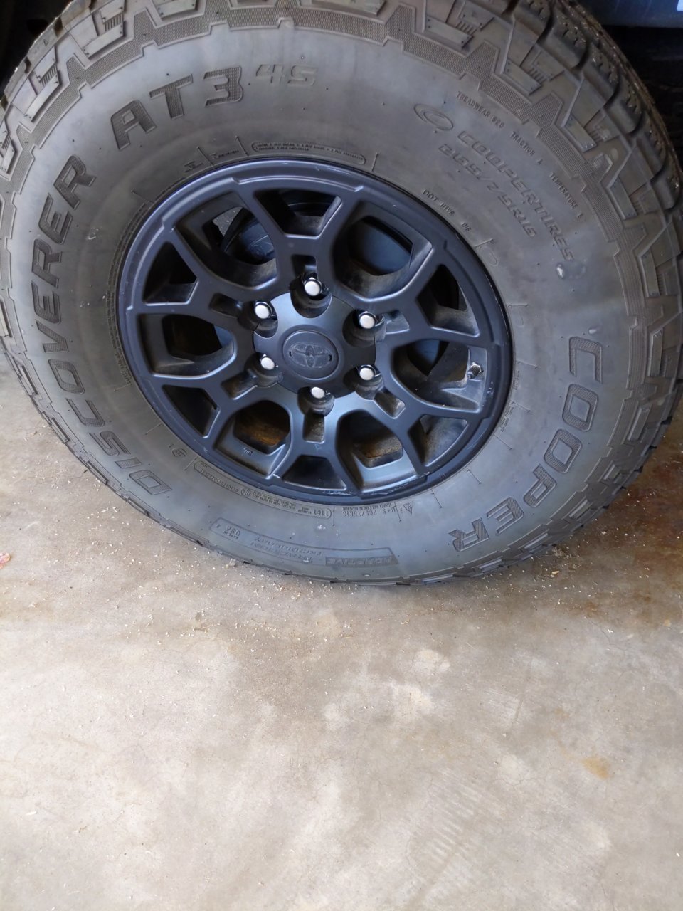

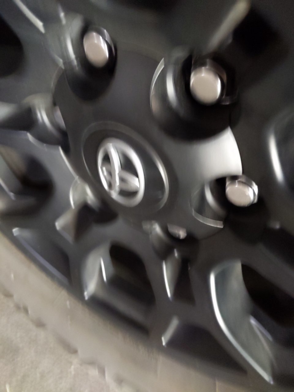

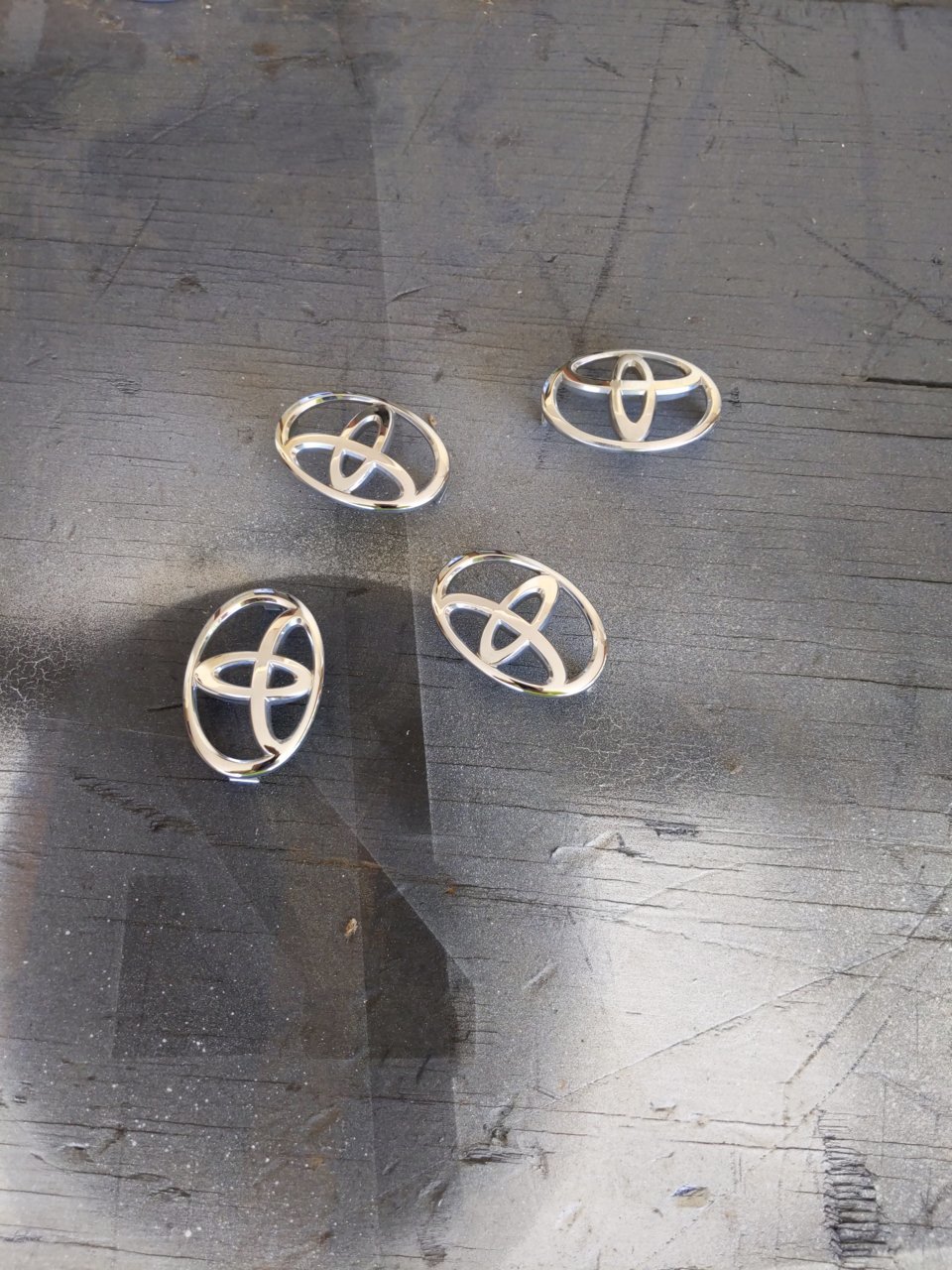

    Popped out the hub caps logos and soaked them in soapy water. Rinsed them well and then hit with a few layers of metallic silver and then a few layers of flat clear.
    The change isnt dramatic, but I like the look more than the flashy chrome. Just gotta get some black locking lug nuts and I will be happy with these wheels for a few more years.
    EDIT: Oh god, this picture is even worse on desktop. I'll get a new one.

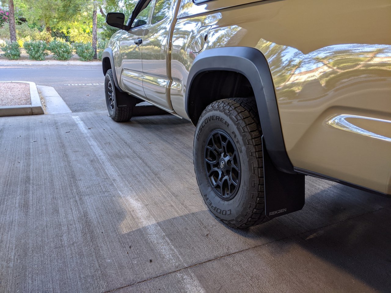

    Also installed some REKGEN mud flaps my brother got me for my birthday belatedly. The truck looks much more purposeful. Going to see how they fare on Bulldog Canyon this weekend. Pictures of that sometime next week.

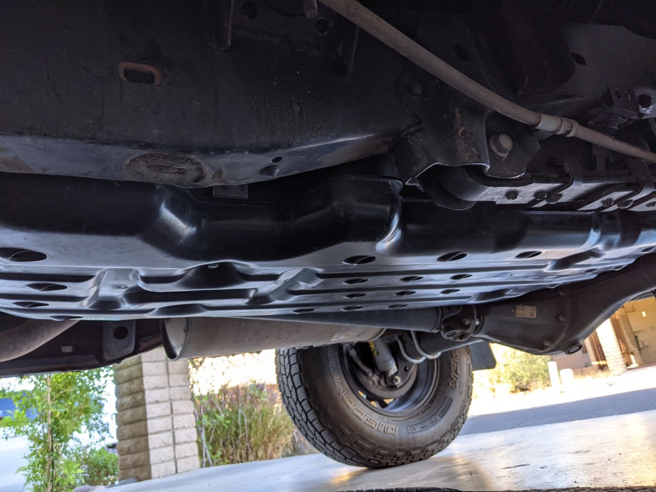

    Scored a free TRD Off Road gas tank skid from a local member. Got some threaded straps off Amazon for $52. Installed in under an hour. With a cargo strap, needle nose pliers and basic sockets it was easy to do solo.
    Might upgrade to a steel skid down the road, but this is better than nothing for now.

    Haven't updated this in awhile. Aways back, I got a TRD Faux grille from @TailHook that came off of @OmegaMan73 s truck. Price was too good to pass up so I snagged it even though it wasn't a high priority item for me.
    I love the way these trucks visually widen without the big sombrero on the front, though, so it was worth it to me.
    Also and far more recently, I swapped in some Diode Dynamics SS3 Sports in place of the OR fogs I got awhile back. It's another thing that was much more cosmetic than functional, but it also inspired me to get off my ass and order the fog stalk... Since I'm still posing.
    I also finally got my DMM installed. It's nice to be able to have google maps in my line of sight, among other improvements. Definitely must-have for SR owners and others. It's super easy to do with the right, basic, tools. Even just the single phone mount they offer is worthwhile if you don't have other plans down the road.
    Not done with lighting upgrades, so stay tuned.
