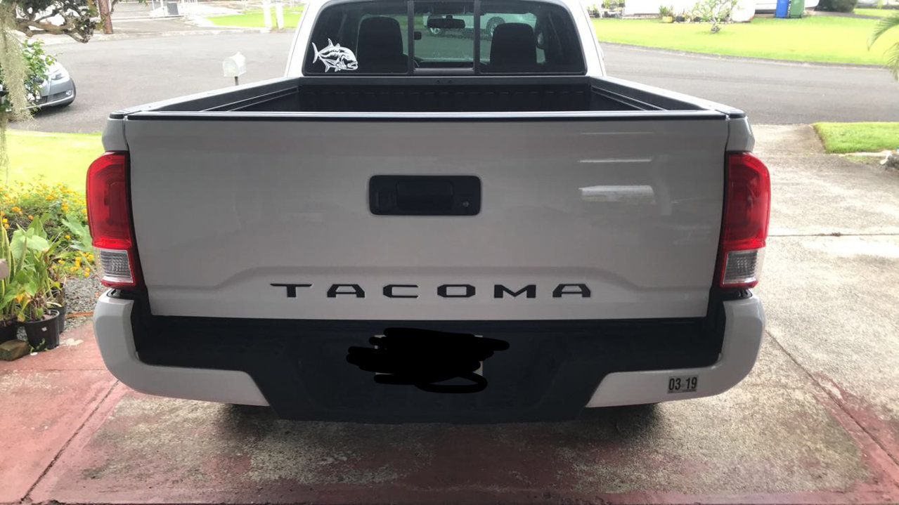

    4. Black TACOMA letter inserts

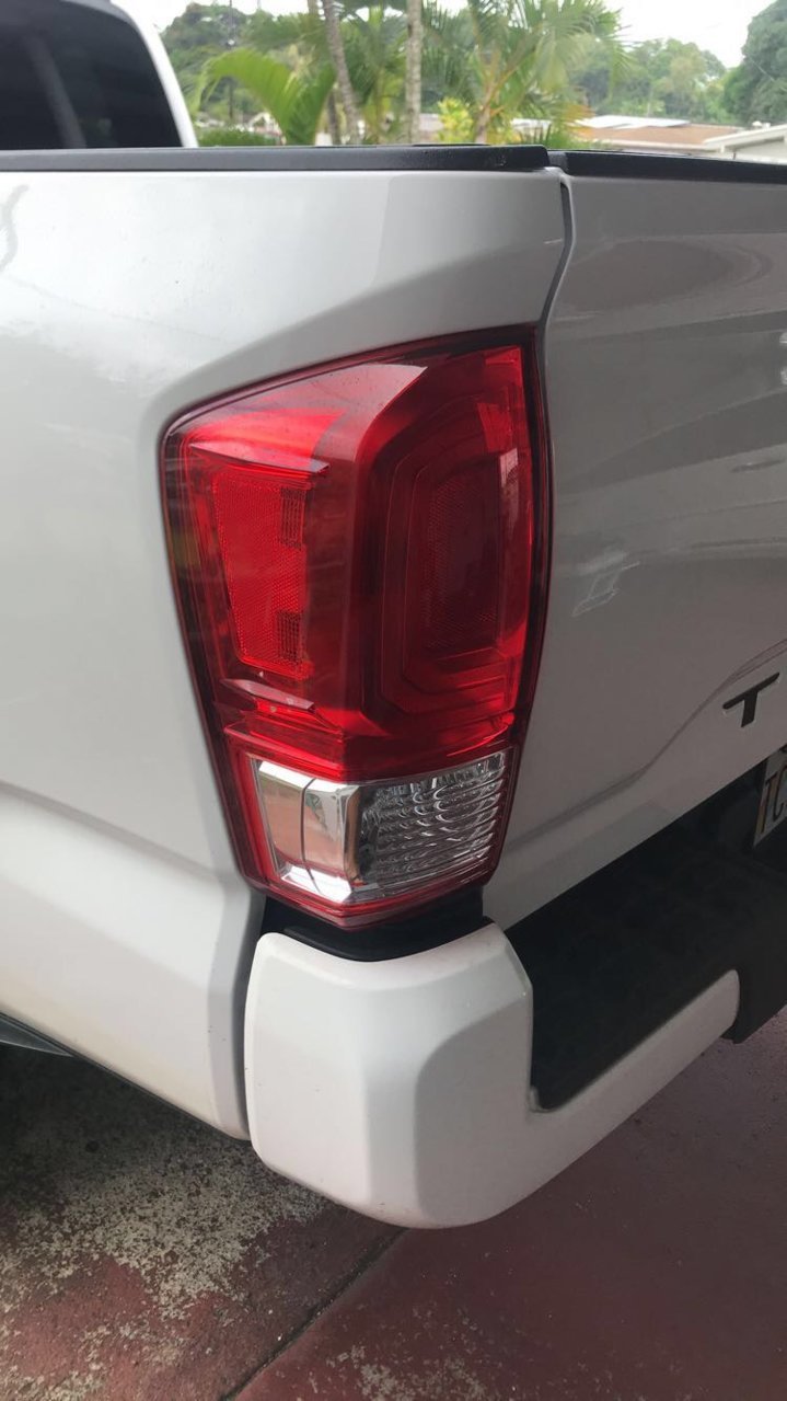

    6. Blacked out chrome tail light markers

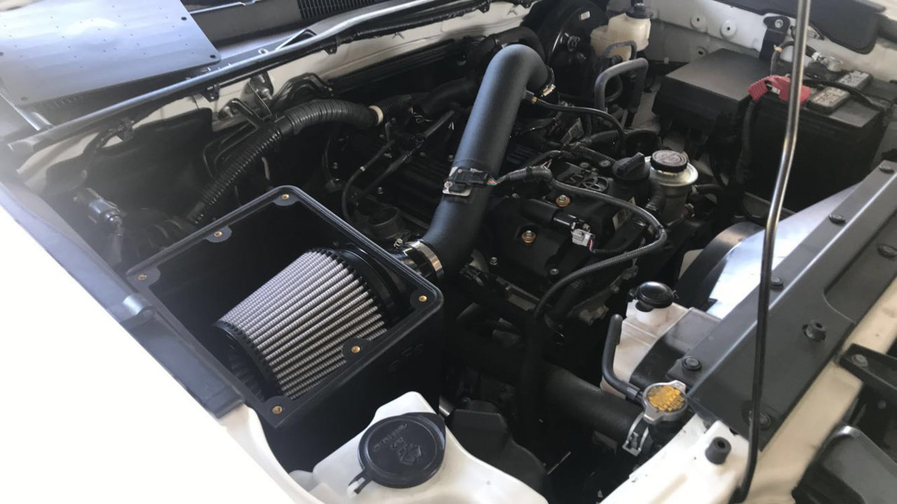

    9. aFe PowerMagnum FORCE Stage-2 Si Pro DRY S Cold Air Intake System (Part #51-82722)

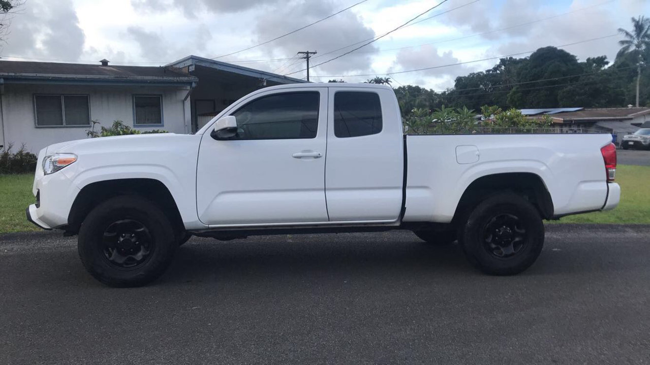

    PHOTOS

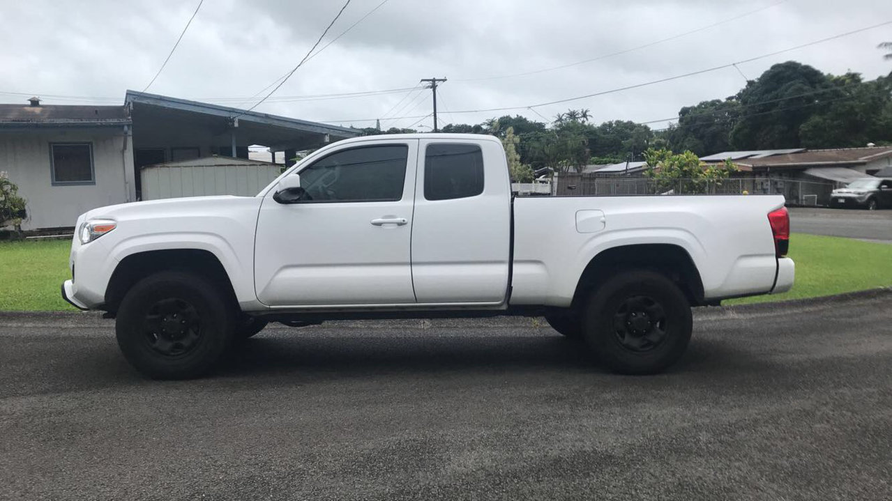

    The day I brought her home (3/30/17)
    Today
    (8/25/18)
    MODIFICATIONS
    Plasti-dipped Steelies
    TACOMA letters

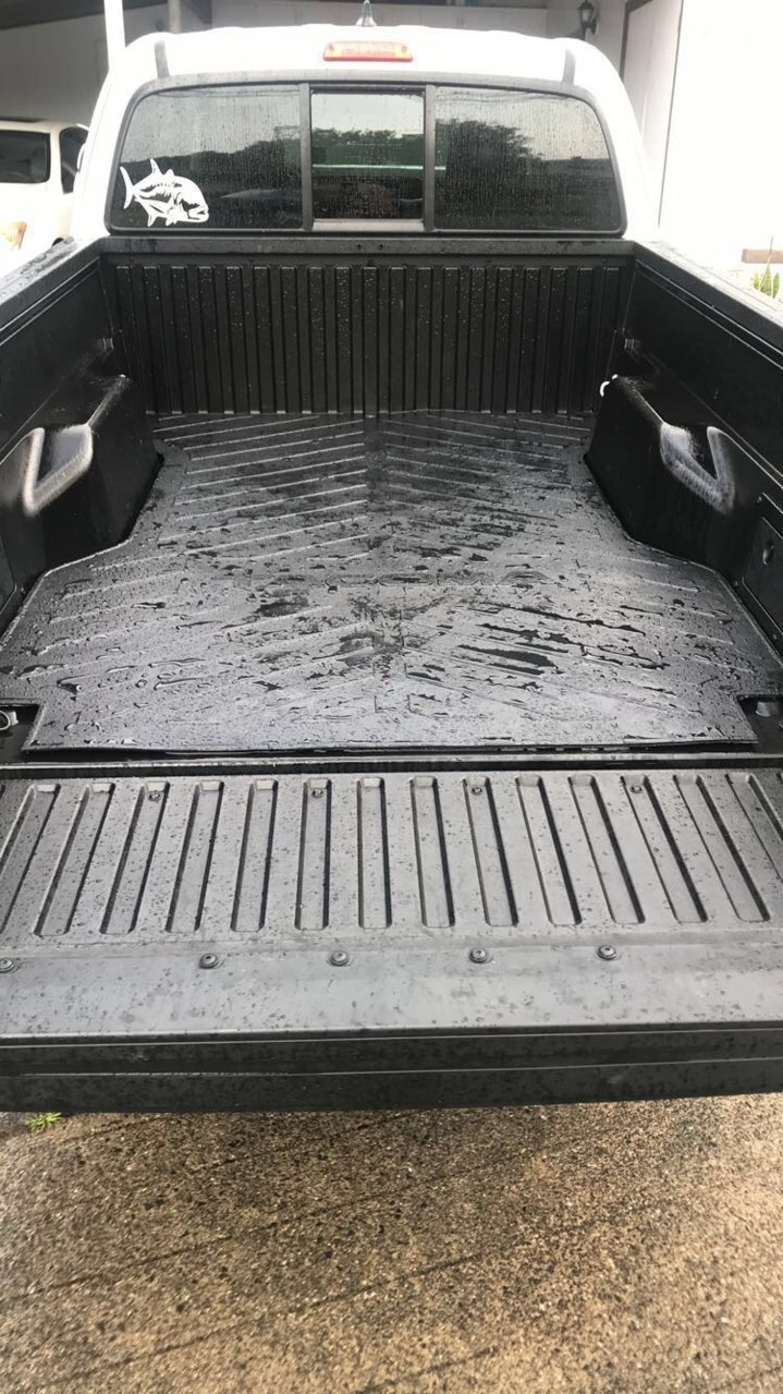

    Long Bed Mat
    Bed Mat Thief Prevention

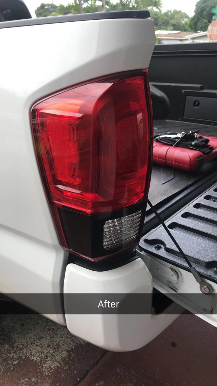

    Tail Light Chrome Black Out (before)

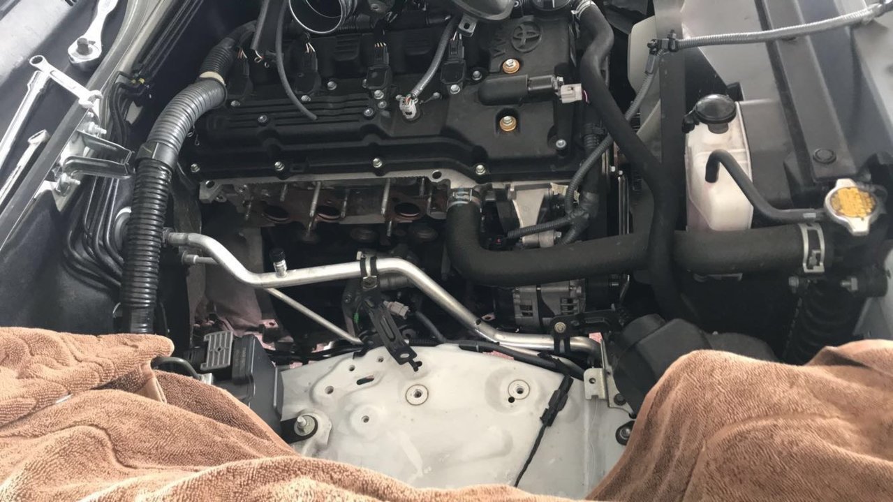

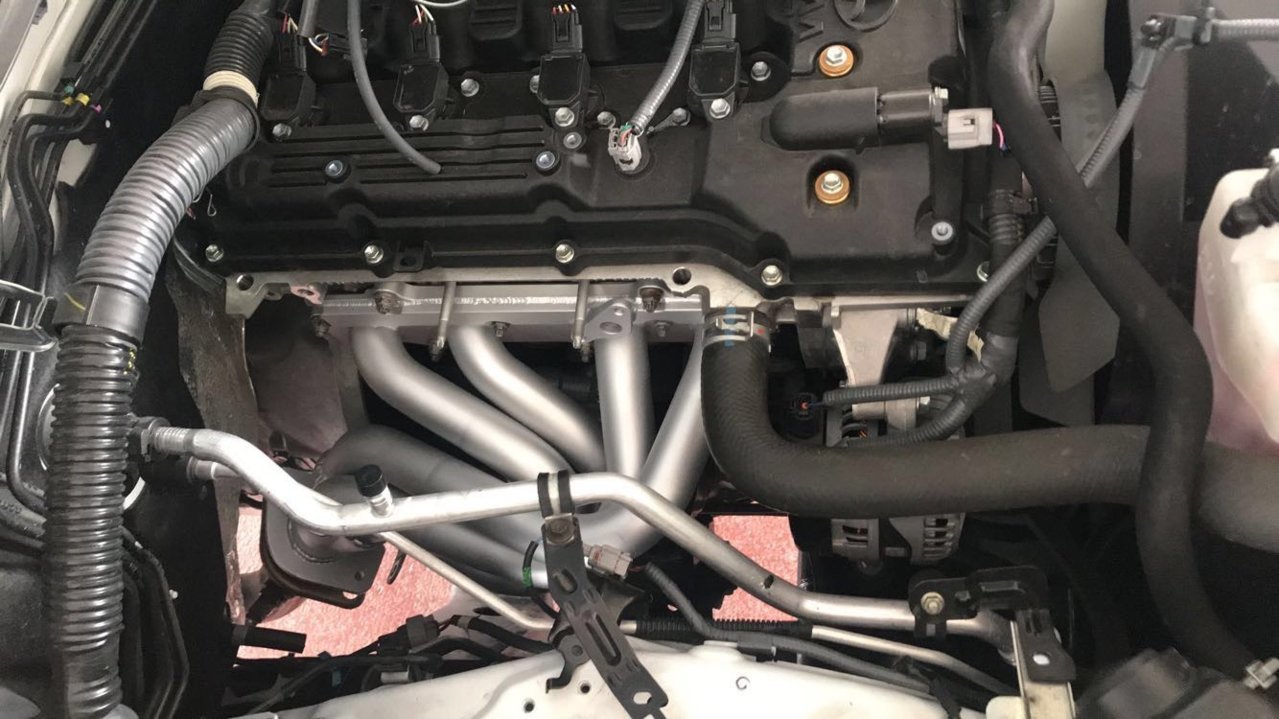

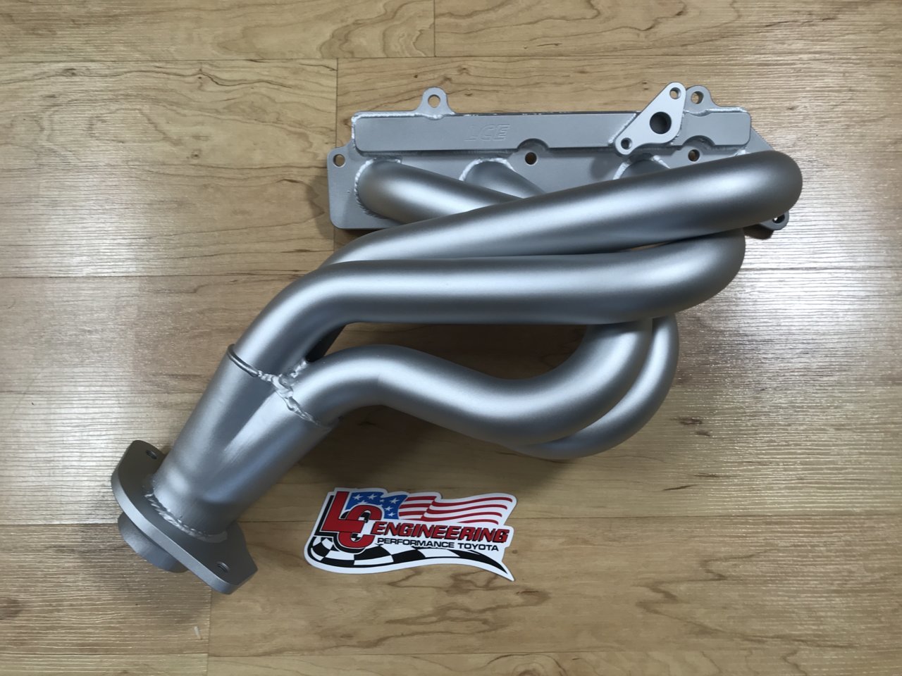

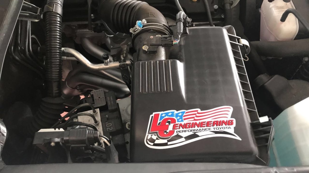

    LCE PERFORMANCE HEADER!!!
    Old header removed
    LCE header installed (pre ac drain mod)

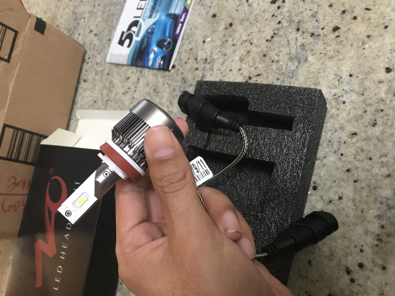

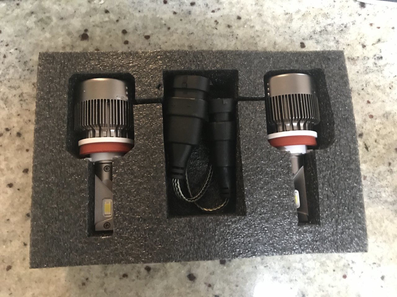

    NAO H11s LEDs
    NAO LEDs are nice upgrade compared to the OEM lights, they are bright and provide full coverage of the road.

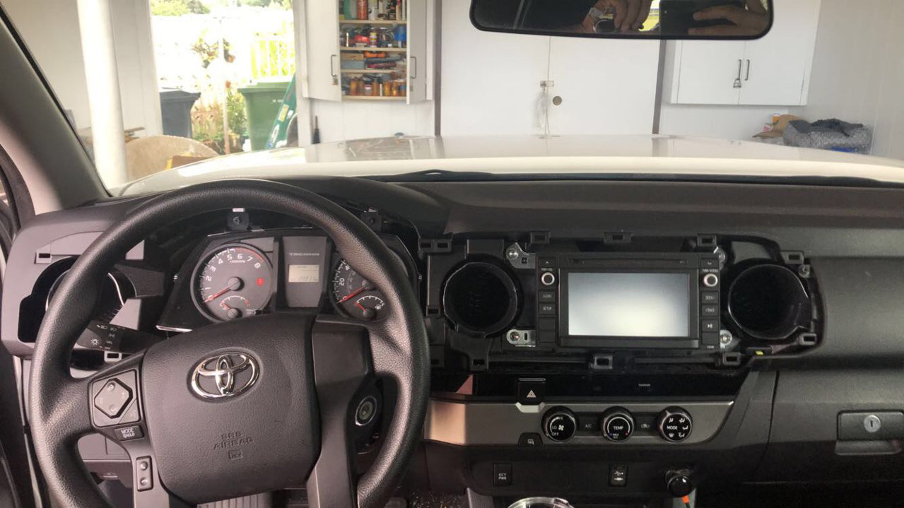

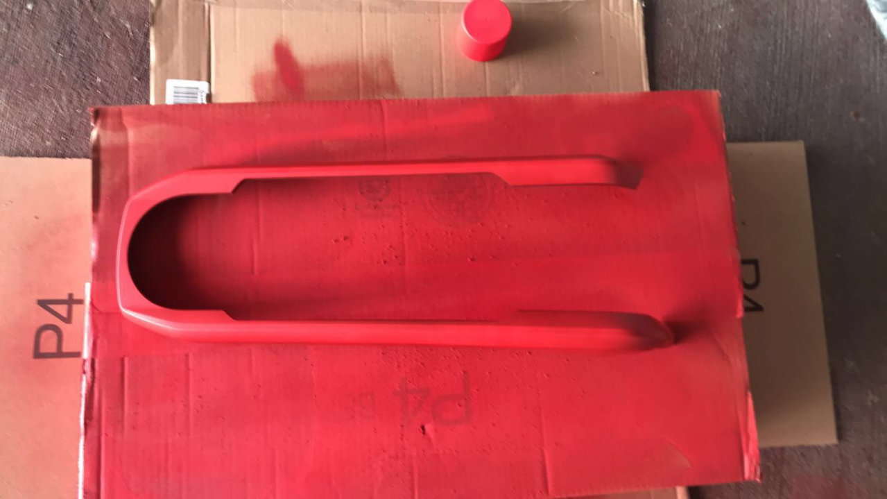

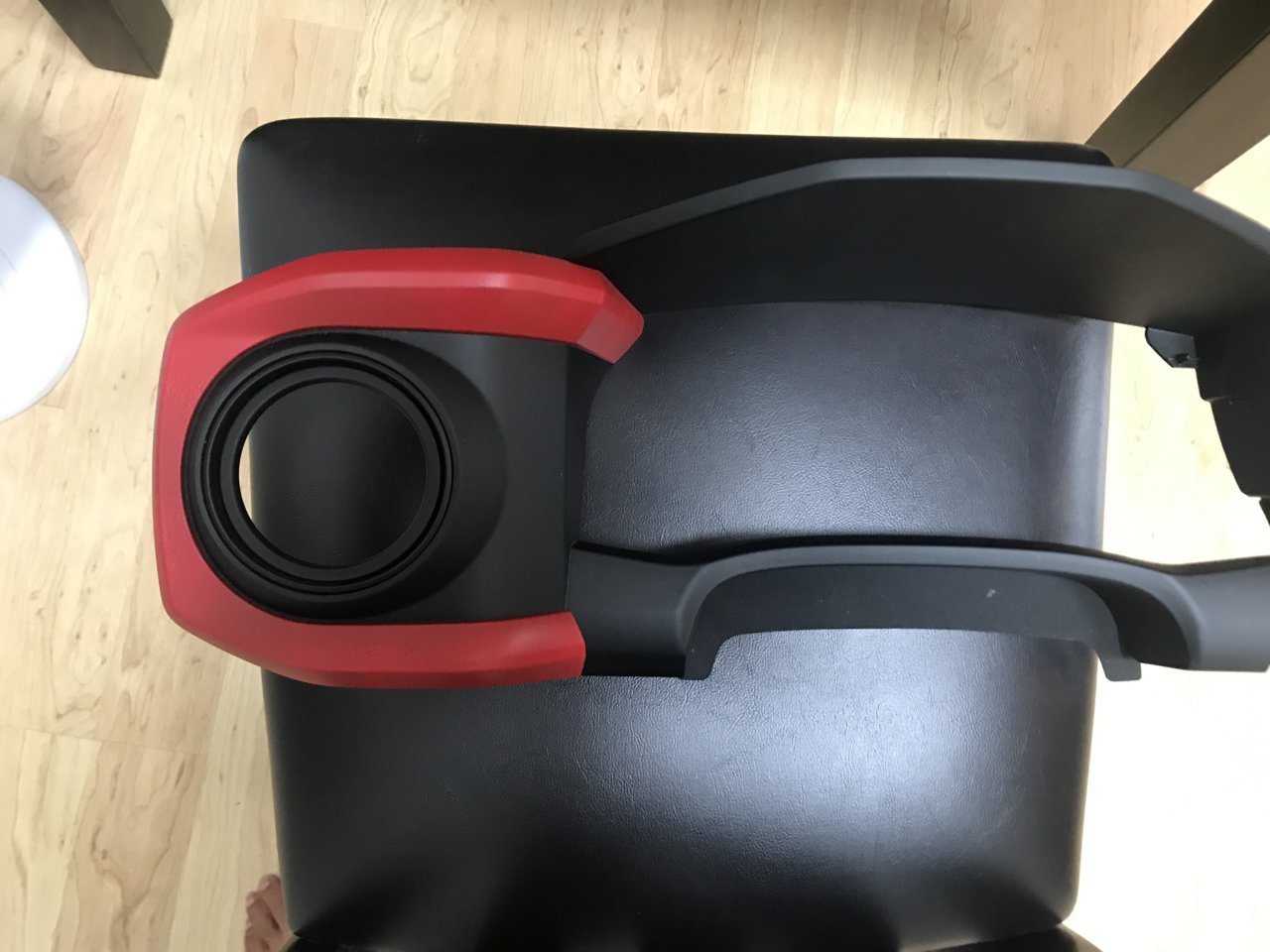

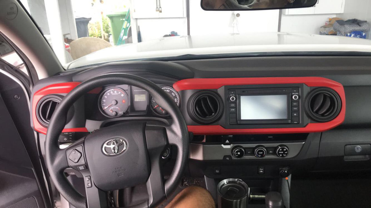

    Plasti-dipped bezel
    My camera doesnt do it justice. The red enhances the dash
    (bezels removed)
    Final product

    Looking good. Did you notice a difference when you installed the LCE headers? Did you just do the headers or did you swap out the exhaust too?

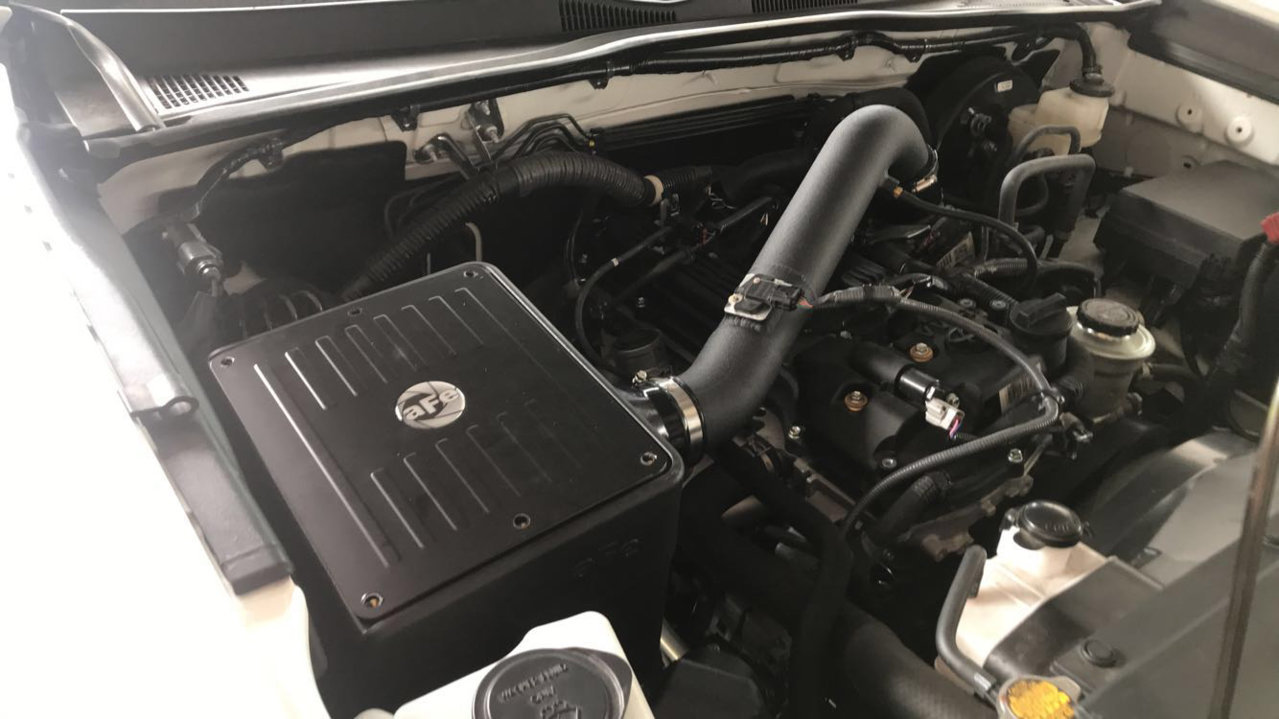

    I did notice difference with the header as in more power, my truck was able to get up to highway speeds quicker (sluggishness went down) and was able to hold gears better as well, not skipping around as much. I also install an afe power magnum force stage-2 Si Pro DRY S CAI, and that greatly helped the engine "breathe" better, my throttle response also increased. Swapping out my exhaust is my next mod.
    My goal with my truck was to get the this bulletproof engine performing at its best before suspension and wheel upgrades

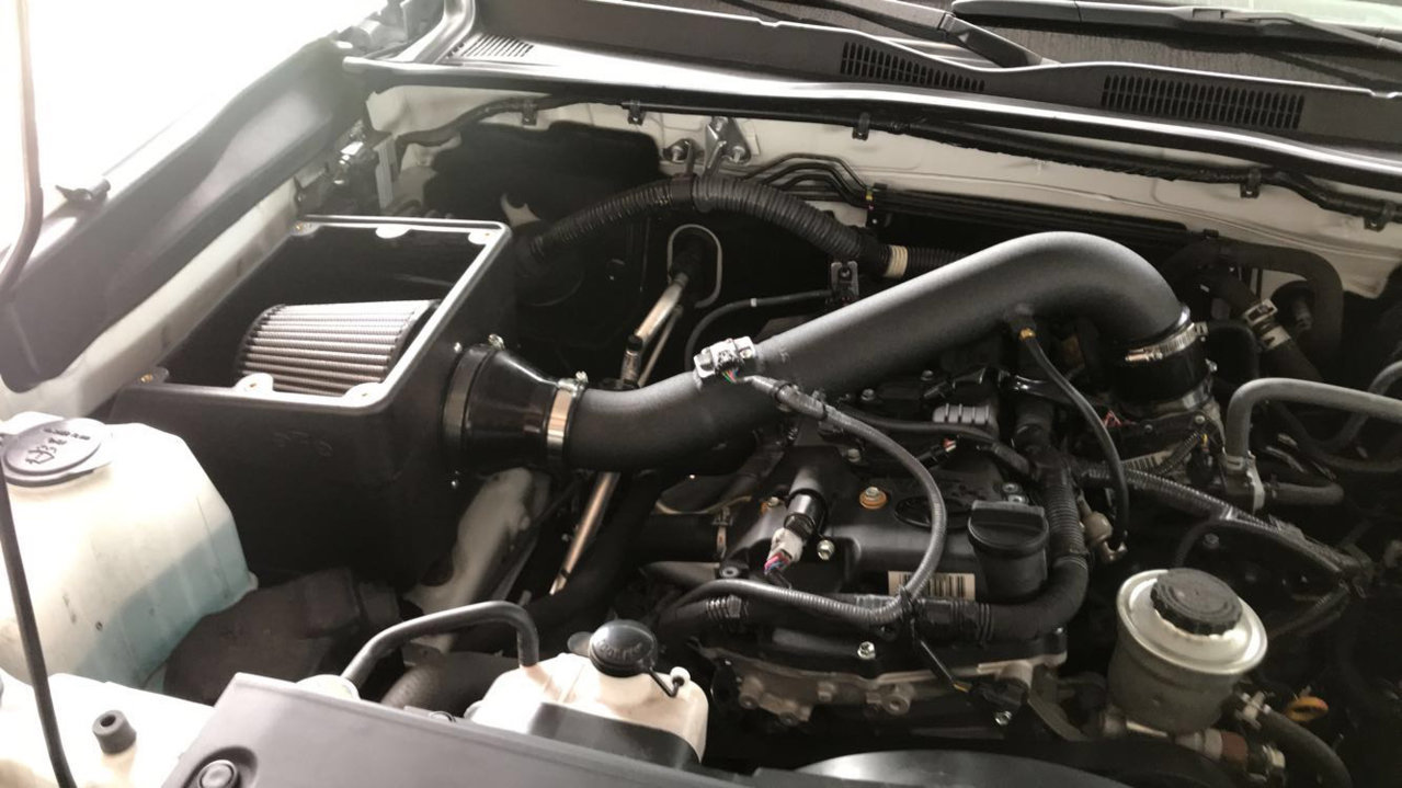

    As in my previous post I installed aFe Power Magnum FORCE Stage-2 Si Pro DRY S Cold Air Intake System (Part #51-82722).
    Riding with the with the new intake for a couple hundred miles now I can say that my trucks throttle response/sensitivity has increased and my with my LCE header the engine performs better and breathes a lot easier. Less sluggishness around town and getting onto the highway.

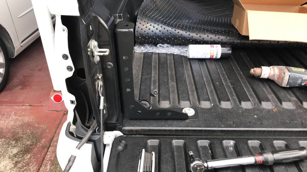

    I also got around to installing CALI RAISED Bed Stiffeners. Since I have a long bed and use my bed frequently I wanted to take precaution and protect my beds integrity for the future. The install was pretty easy and straight forward

    Would you recommend heat wrapping the headers for those who are considering this mod?
  8. May 18, 2021 at 6:42 PM
    SandysTaco
    SandysTaco [OP] Member
    May 11, 2017
    #218815
    20
    2003 Red TRD offroad
    Sorry for such a late reply, I didnt wrap them, the engine bay temp was normal from what I could feel. I dont think youd need to wrap them tbh
