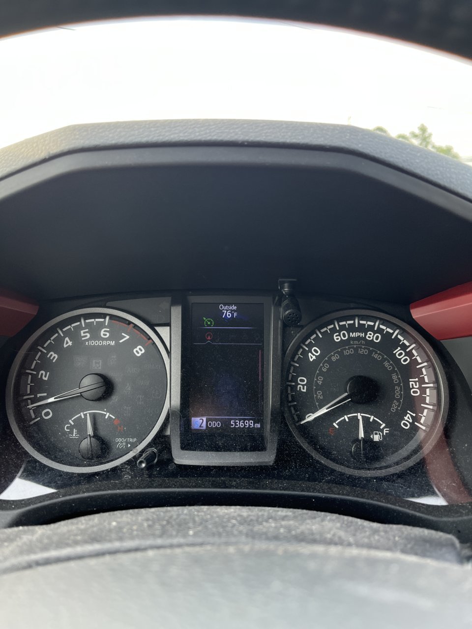

    For the best results, put the mic right in front of you. I always put them back inside the gauge cluster cove. Works as a funnel to get your voice into the mic, and prevents echo from the speakers.
    you can see mine hiding center/right
