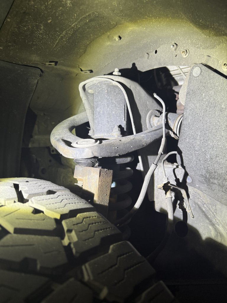

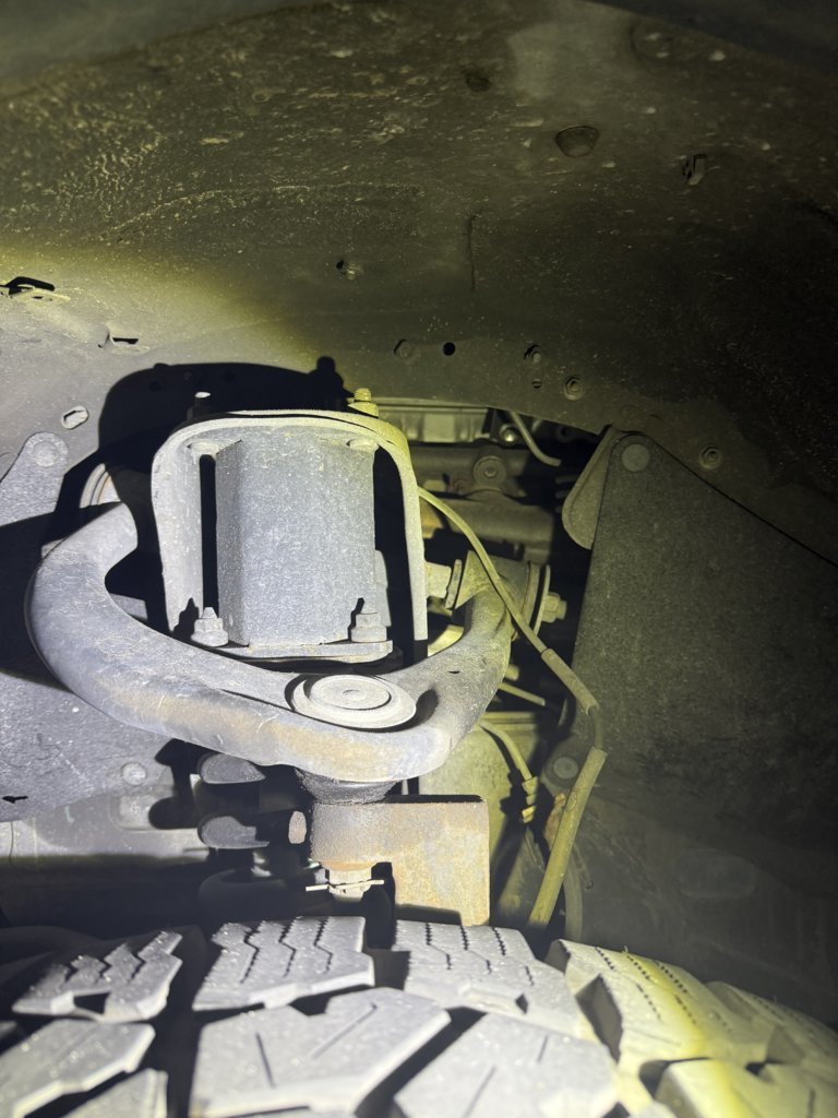

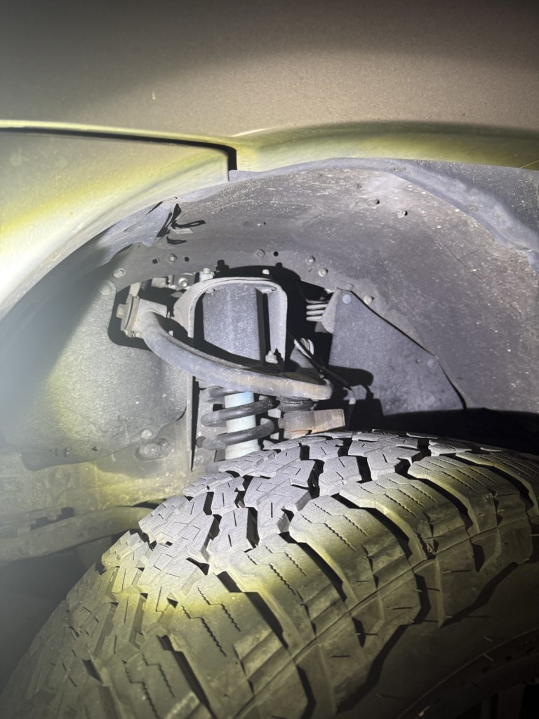

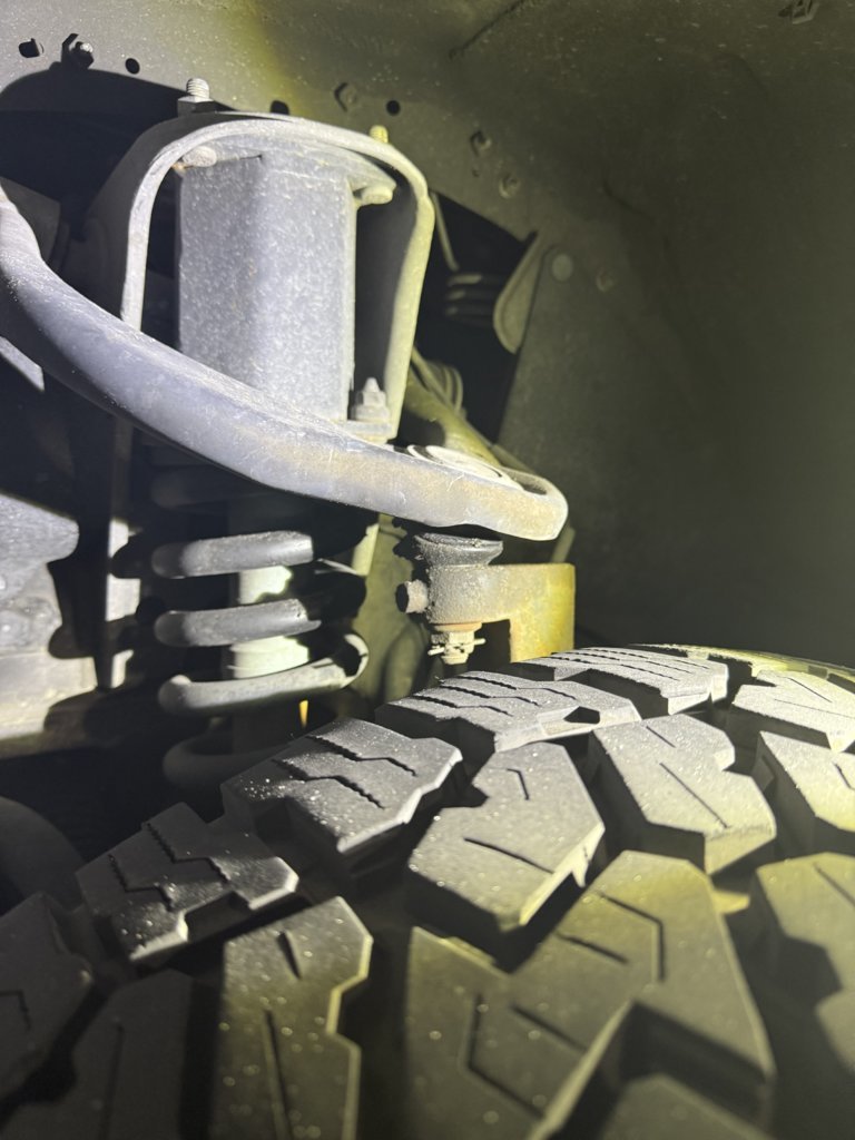

    2012 TRD Sport DCLB: I have a 6" Drop bracket lift with 33 x 12.5 x 20" on 20 x 10" Wheels. I have had the truck since 2015 I installed the lift the same year. The lift keeps the stock UCA in place as the Suspension geometry in theory so be close to stock and have had no issues with the UCA hitting the springs or the tires since 2015. I am looking to replace the UCAs as one of the boots is broken and a bushing in the back is wore out. I would like to get some aftermarket Adjustable UCAs. I should be able to get stock ride height arms just with an adjustable setting.
    Any Recommendations? So far I've read SPC, JB Fab any others?
    Below are some picture of my truck the way it currently sits, i dont think the angle is too severe but if im wrong please let me know.

    Looks like the ball joint itself has been hitting against your coil (and would be why the boot is torn and leaking). Its got quite a lot of angle (Rough Country went pretty aggressive with that on their 6" kit, the drop brackets themselves only drop down 3¼ inches, so angles are the same as you'd have at 2.75" lift w/o DBs).
    How come you don't have the droop stops (extension limiters) installed? (that might've prevented the boot from getting torn)
    As for aftermarket arms, you definitely can put them on there no problem (and probably should), but you'll likely still have to install the droop stops too because the new UCAs may end up doing the same thing. If you don't have the droop stops anymore, then limit straps.
    (some UCAs such as SPC are thinner, so it's possible you'll need a taller bumper to go on the droop stop mount, see this post).
