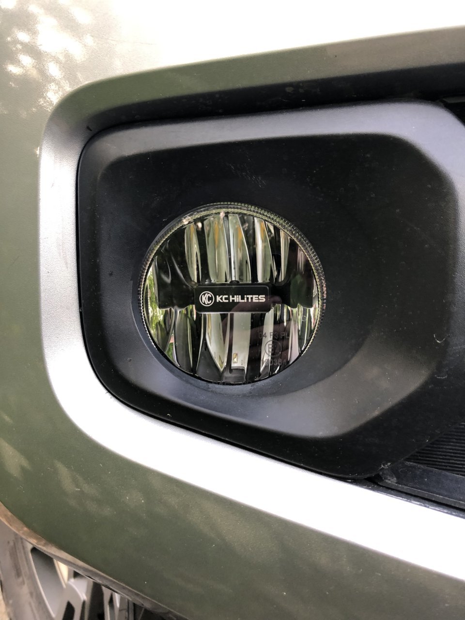

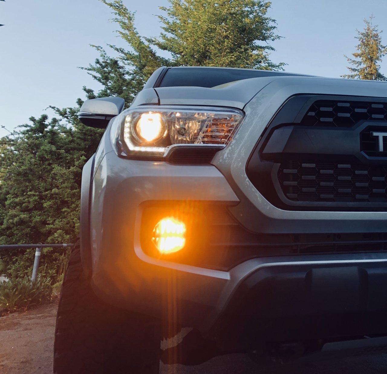

    Photo of them off?

    B9337201-64FA-4FE5-B657-7EA90BB33F1B.jpg 4E5AE5AF-B75E-46C8-B83A-EC54E6271827.jpg

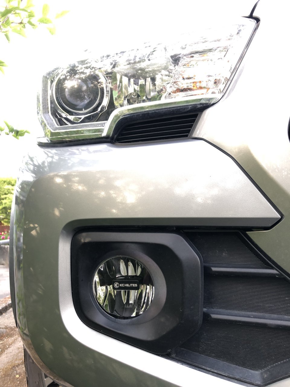

    Can you do a full front photo? Block plate

    I will get some snaps tomorrow. I’ve only got the one PS G4 light installed so I can compare stock beam height to the new G4 and set them the same.
    Both OEM and G4 are adjustable in vertical plane for aiming, but not left-to-right. Once I match the new lamp aim height on PS to the existing lamp on DS I’ll replace the DS.
    I’ll take a “full frontal” then. Likely tomorrow.

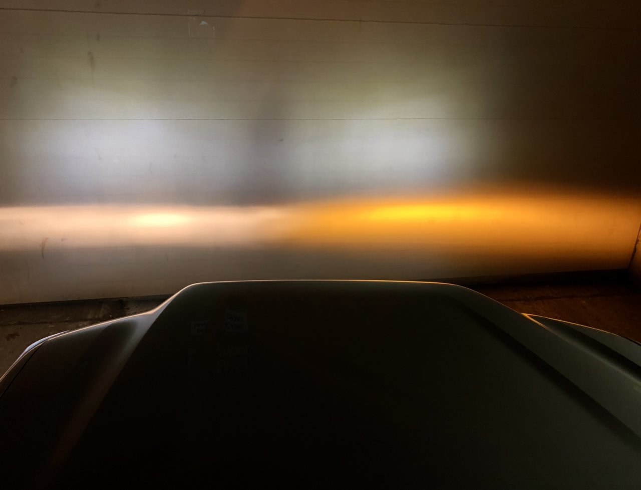

    I did some testing tonight with one OEM fog and one G4 and will probably just update my first post when I have time.
    One observation I’ll share now, is the forward beam pattern of these G4 fogs matches the OEM almost perfectly, indicating they are SAE/DOT compliant as stated by KC and are not going to blind oncoming drivers, or create a lot of scatter in fog, dust, or rain/snow. The G4’s have more side-wash, and a little less upwards glare. Brightness is about equal, but I’m digging the Amber big time.
    On the left is OEM halogen, and on the right is G4. Shining on a white wall. The white blobs above are from the LED DRLs.

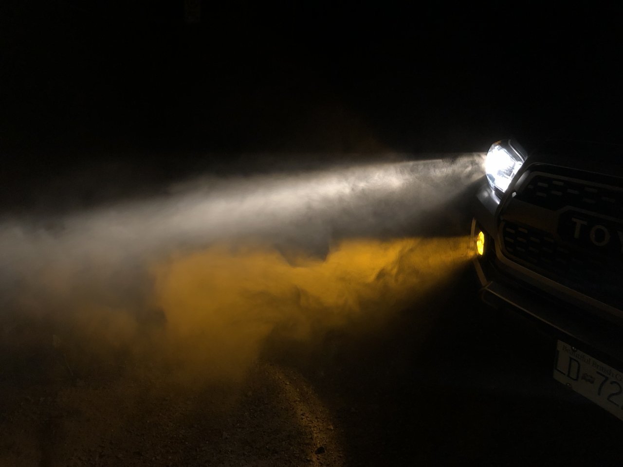

    Some other fun I was having testing these out ;) vvvvv
