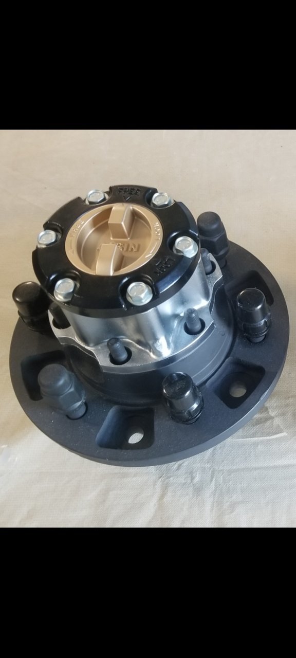

    I had ifs hubs on my fj80... they bolted right up.

    How did you make the fj80 rotor stay? The bolt for the rotor go through the hub to the threaded rotor end. Not a slip on rotor

    Ah, I used ifs lockout hubs, not wheel hubs. Sorry I skimmed the previous posts, my bad. :crazy:

    Yea, that will fit for sure. 30s regardless. Only difference is the 4 notch on the 80 locking hub to match the hub vs a full circle/round

    Yes the lockout hubs are ifs not spindle/hub
