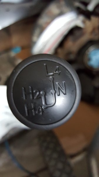

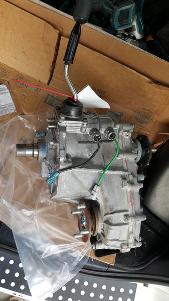

    Anyone know is FJ Cruiser and 4Runner transfer cases are interchangeable? #361003d470
    If you guys could direct me where I can find info. I found a 2011 4 Runner transfer case to do a manual transfer case on 07 Tacoma

    It has a shifter and I checked with the dealer, they share the same part number

    The SR5 4Runner has a shifter, the limited is full time AWD, and the trail is made of unicorns and witchcraft with knobs for each terrain you want to dominate.

    So then is the SR5 with shifter 100% same as FJ? Do you know?

    The guts may b the same but those sensor bungs are on the wrong side. They are on the passenger side for the taco & FJ.

    not like u cant just extend the wiring.

    I don't recall but I thought you use the Tacoma sensors where they are positioned on the Taco and block the extra off! There is one hole with a sensor on the other side too... I'll find out soon enough :)

    The Tacoma tcase has two sensors on top of the actuator. The FJ case has three, two on the driver side and one on the passenger side, just like the 4Runner case that was pictured.
