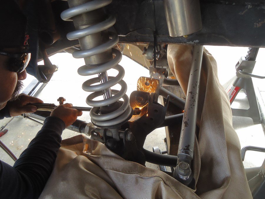

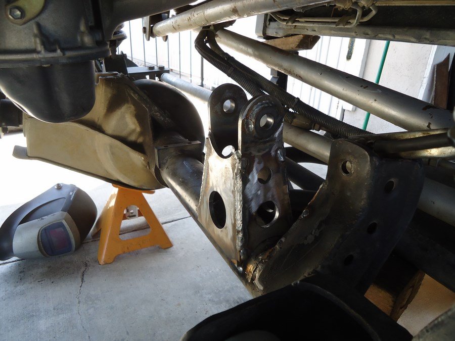

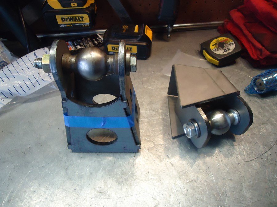

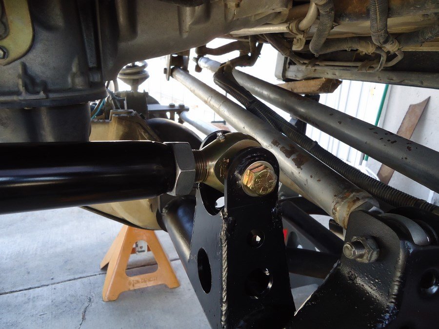

  18. Jul 27, 2014 at 8:07 AM
    #138
    awsumdc
    awsumdc [OP] Well-Known Member
    Jan 3, 2009
    #12156
    1,674
    O.C. Cali
    SASED '05 Taco
    SAS, crawler box, 14" coilover shocks, 39.5 tires,dual batteries, and a bunch of other stuff
    OK, so after wasting my time with a number of machine shops I finally found the Top link mount I want for the axle on this kit.
    I've even put it on my truck this weekend and it really changed the way the truck behaves. It rides and drives better now and it drove good before. It incorporates all the aspects that we put into Rays truck which this kit is built from and adds another element that makes it just a tad better.
    This is just the basic kit which is more complete than most companies complete kit.
    it includes the joints with jam nuts, links with bungs and the links are cut to size and the bungs are tacked in, all the mounts that you will need for the links and all of them will have weld in washers for extra strength tacked in already, all the frame plating in the front which will include the steering box plates and sleeves, it has the panhard bar mounts and panhard bar with bungs tacked in and the joints for it, as well as the draglink and tierod with joints. These wont be tacked into the tubes or cut to size as this kit needs to be as universal as possible and some people wont use the Currie Rock Jocks. It will also have the drop pitman arm too and the steering shaft and joints. It will come with the coilover towers and lower coilover mount tabs as well. Then it's completed with instructions to show you where all this stuff goes.
    The basic kit will come in around $1695.00 plus shipping, ( price subject to change) and it will also have my personal phone number just in case you need some moral support. :p I'll have some pictures up of the kit as soon as I can and will give you guys a heads up when it's ready to ship.
    I'll get the next phase, the medium kit up soon and then the full kit with absolutely everything you'll need to do an RST front SAS.
    Here are some pictures of the last piece of the puzzle for this kit from this weekend. I cut off my old mount and put the new one in with the new joints and link. Started to get cramped for time so we just painted it up before cleaning it good. I'll get to that next weekend and fix it up.
    This is the top link at the axle I'll be using. I wont be using the frame mount you see next to it. It's not good for the type of quality kit i'm looking for. All the mounts will be tacked together so that all you need to do is weld them up and weld them on.
    In the medium kit you'll have your choice of either grade 8 or F-911 Bolts in the kit. The basic kit you'll have to supply your own hardware.
